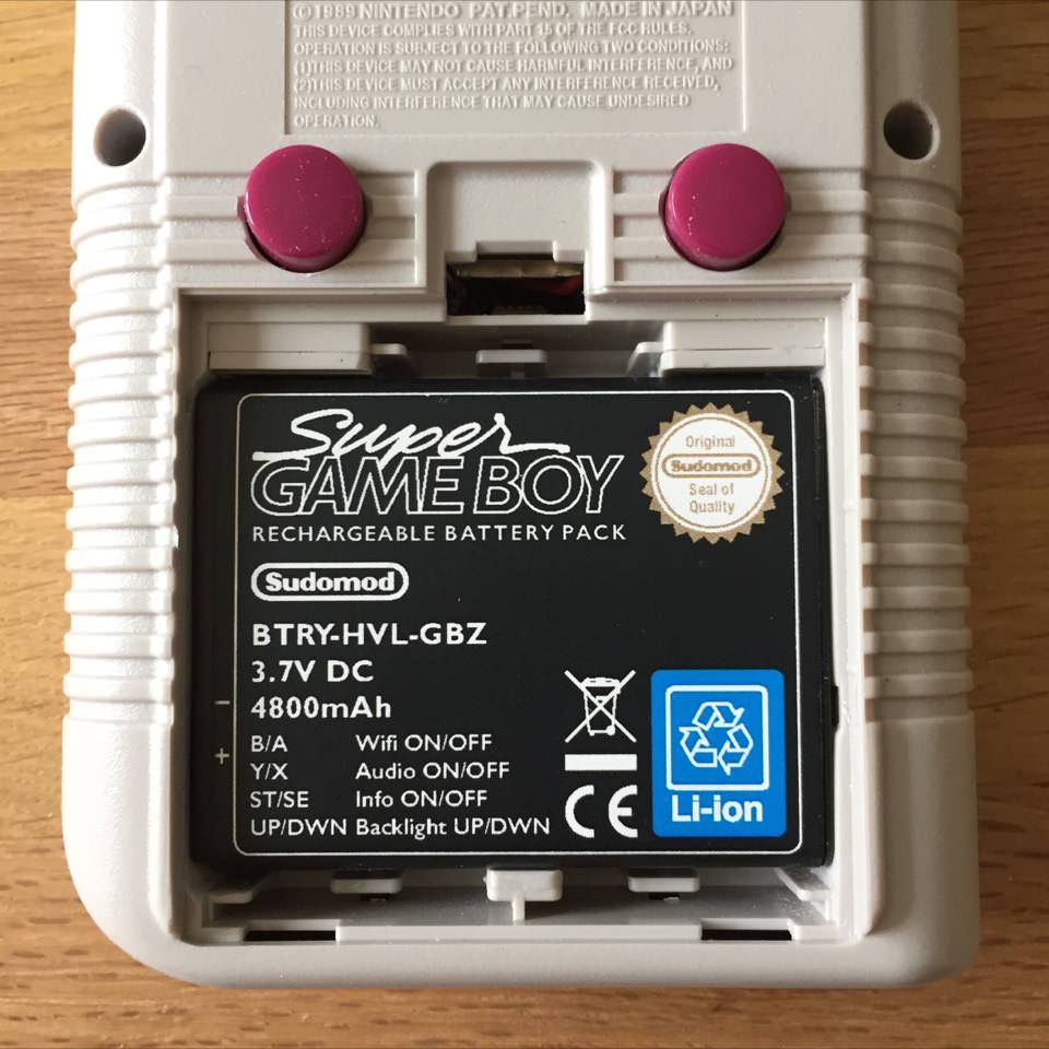

OK, anyone who builds their GBZ will sooner or later come across the battery problem. My first build used a Samsung S2 battery which fit almost perfectly.
S2 removable battery in a DMG-01Show
Some minor (yet still annoying) alterations are enough for it to fit, and if you add pogo pins you can have a very nice removable, super clean looking battery. But the S2 is from 2012 and the batteries may (or may not) be at the limit of their shelf life. The huge 4800mAh battery many of use have used is already out of stock in many places.
So, is there any other battery we could use? Something that may fit even better? It would be nice to a) find a battery that fits and b) find one that has a "large" aftermarket version with 3000 mAh and more. I'll use this thread to collect battery dimensions and if anyone is willing to help or measure their own smartphone batteries, it's very welcome.
Gameboy DMG-01 Battery Cartridge Dimensions
It's by far harder to add a longer battery (first value) than a wide battery (second value). The long (~6 cm) S2 battery needs you to shave off parts of the GB shell, whereas you'd only need to cut off parts when adding a wide battery.
5,75 cm x 5,02 cm x 1,14 cm (default)
5,85 cm x 5,58 cm x 1,38 cm (max)
Battery dimensions
The dimensions are first results and should be rechecked. I also didn't check (yet) whether there's huge versions.
Probably a perfect fit:
5.8 cm x 4.3 cm x 0.5 cm - Galaxy Ace
5.7 cm x 4.3 cm x 0.5 cm - Galaxy Ace 2
Might fit with alterations to the case:
5.8 cm x 5.1 cm x 0.6 cm - LG Optimus 4x
6.0 cm x 4.5 cm x 0.5 cm - Galaxy S2 (tested)
6.0 cm x 5.0 cm x 0.4 cm - Galaxy Ace 3
6.0 cm x 5.0 cm x 0.4 cm - Galaxy S3 Mini
Doesn't fit:
6.320 cm x 5.008 cm x 0.441 cm - Galaxy S3
7.1 cm x 5.1 cm x 0.4 cm - Galaxy Ace 4
... to be continued

@0xF0F0F0:
If you cut the little plastic lip from the downside of the battery (Galaxy S2) you get the missing 2mm to fit. I did it without problems.
But.... I also have bought the 125054 and putted the Galaxy S2 Battery away... I think it is the better way.... :-)

Hmmmm, the 125054 does fit perfectly, right? Hmmmmmmmmm, maybe a 3d-printable "enclosure" that hides the cables could be an alternative... I really don't like the look of that foil wrapped battery, and the sticker doesn't change much, haha.
@cybergenetic, you have kite's board, right? I have a separate loader for the S2 battery and I'm not sure whether the board managed to load the battery on its own (it always felt as if it didn't). Could it? And the 125054 can be loaded by the board, correct?
