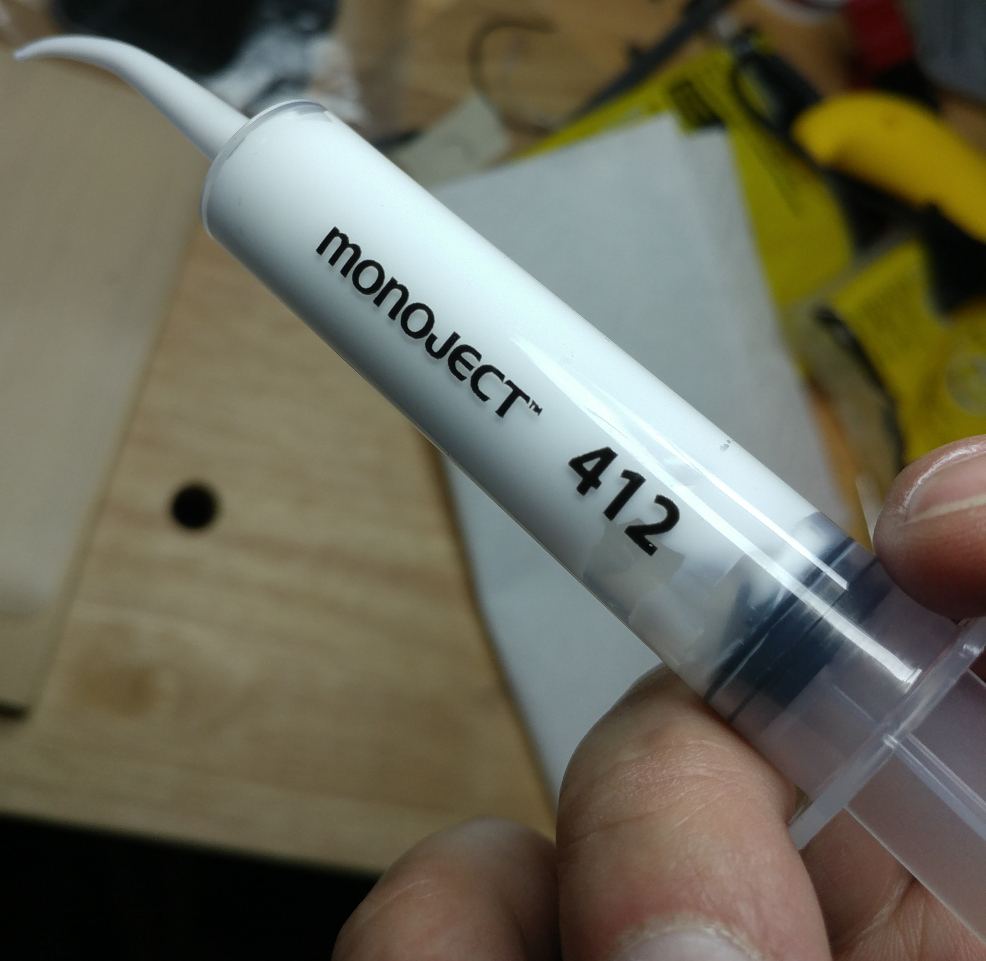

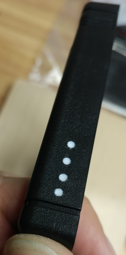

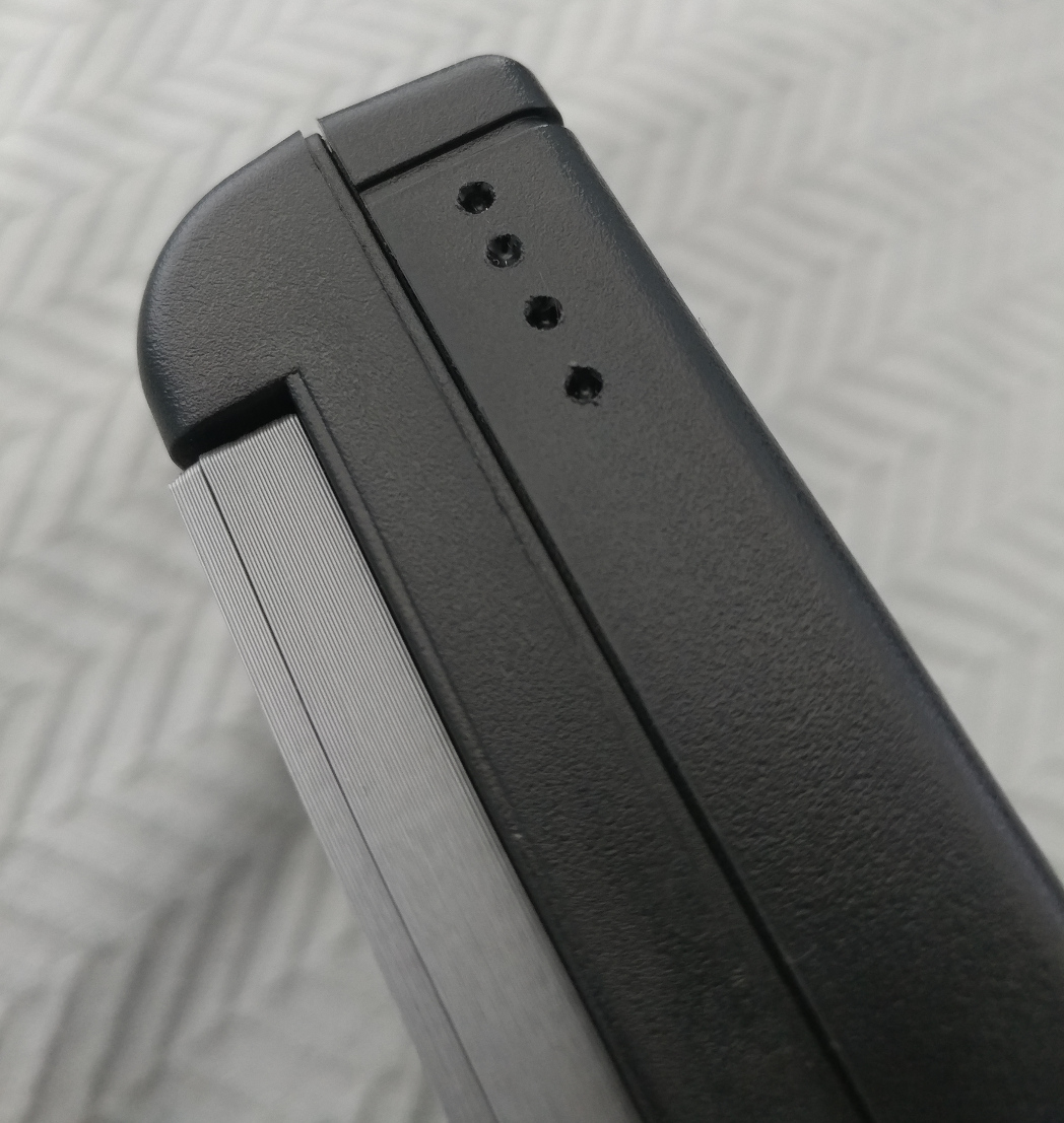

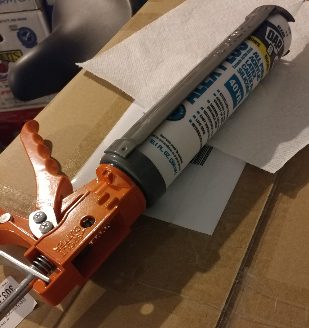

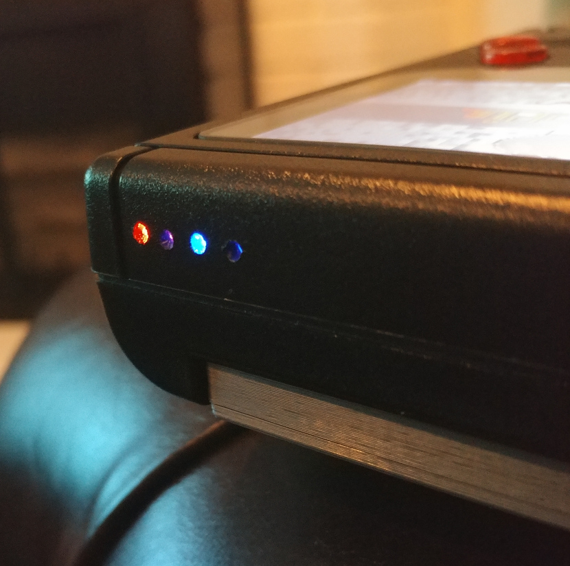

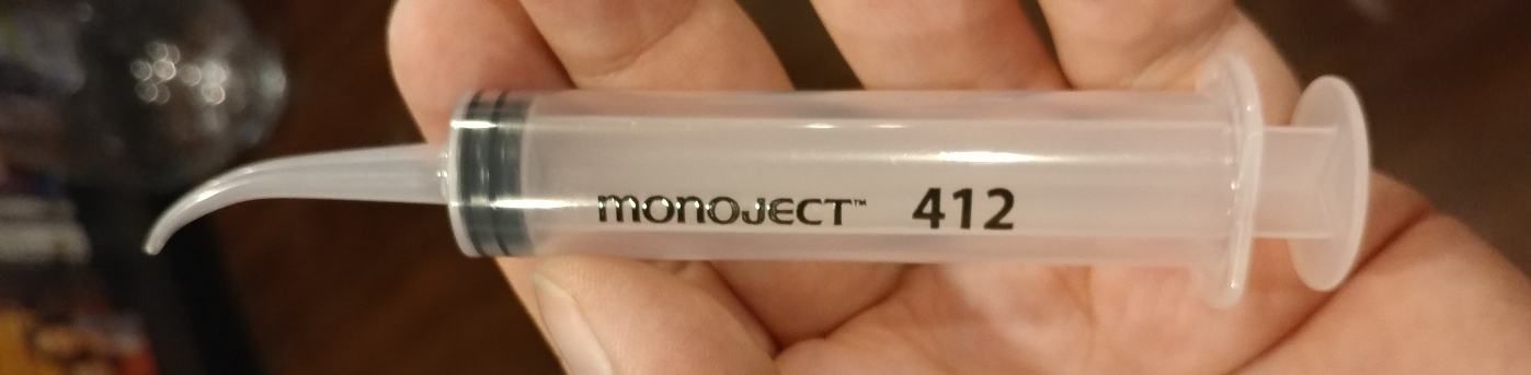

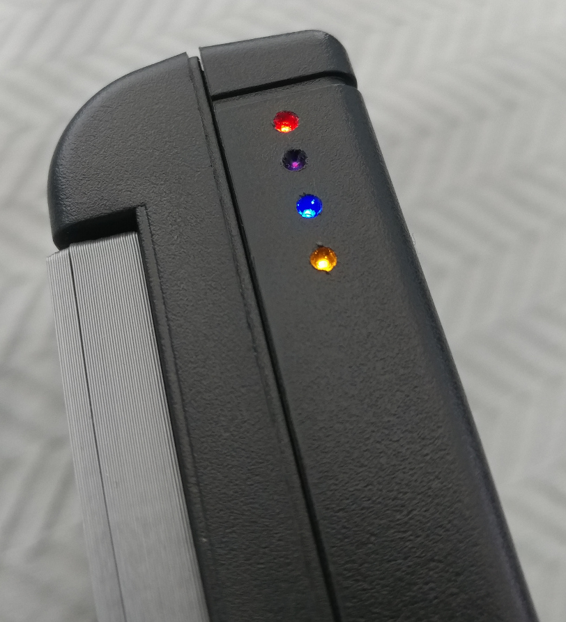

Working with hot glue is kind of a pain and messy, not to mention the stuff is really hot! I still wanted to have the LEDs visible outside so I decided to try an idea that another forum member mentioned, filling the holes with acrylic caulk. This stuff is really easy to clean (wipes away with a damp paper towel). The consistency is kind of like a lotion. It goes on white but dries clear. I like how it all turned out and I'd probably do it again.

  1. I did have to do two applications as it shrunk a bit after drying.

  3. These are the irrigators I used
  4. This is the caulk I used

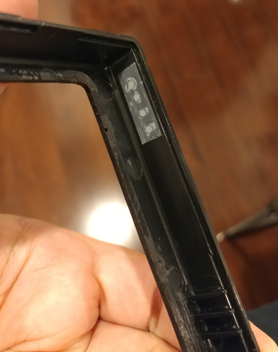

  5. I left the tape on the back after everything was done

Taping the Back
Oral Irrigator
Acrylic Caulk
Irrigator is Ready
Light Holes Filled (note: the white turns clear as it dries)
Dried
Light in Action (Day)
