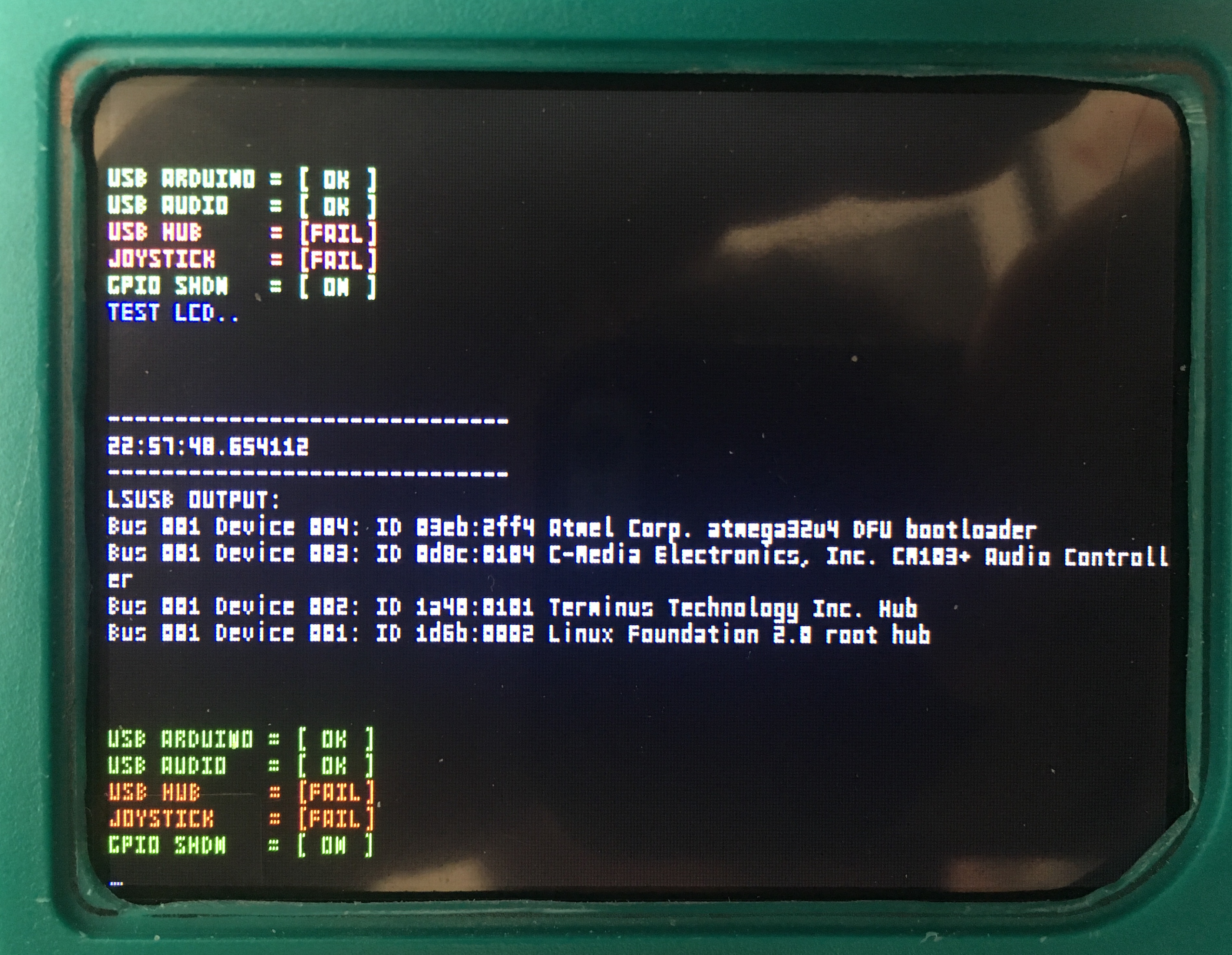

I booted the Pi in Tester Mode and received the messages:
[USB HUB FAIL] and [JOYSTICK FAIL].
According to the wiki, this CS version shouldn't require anything besides the SD image and USB-C power, right?

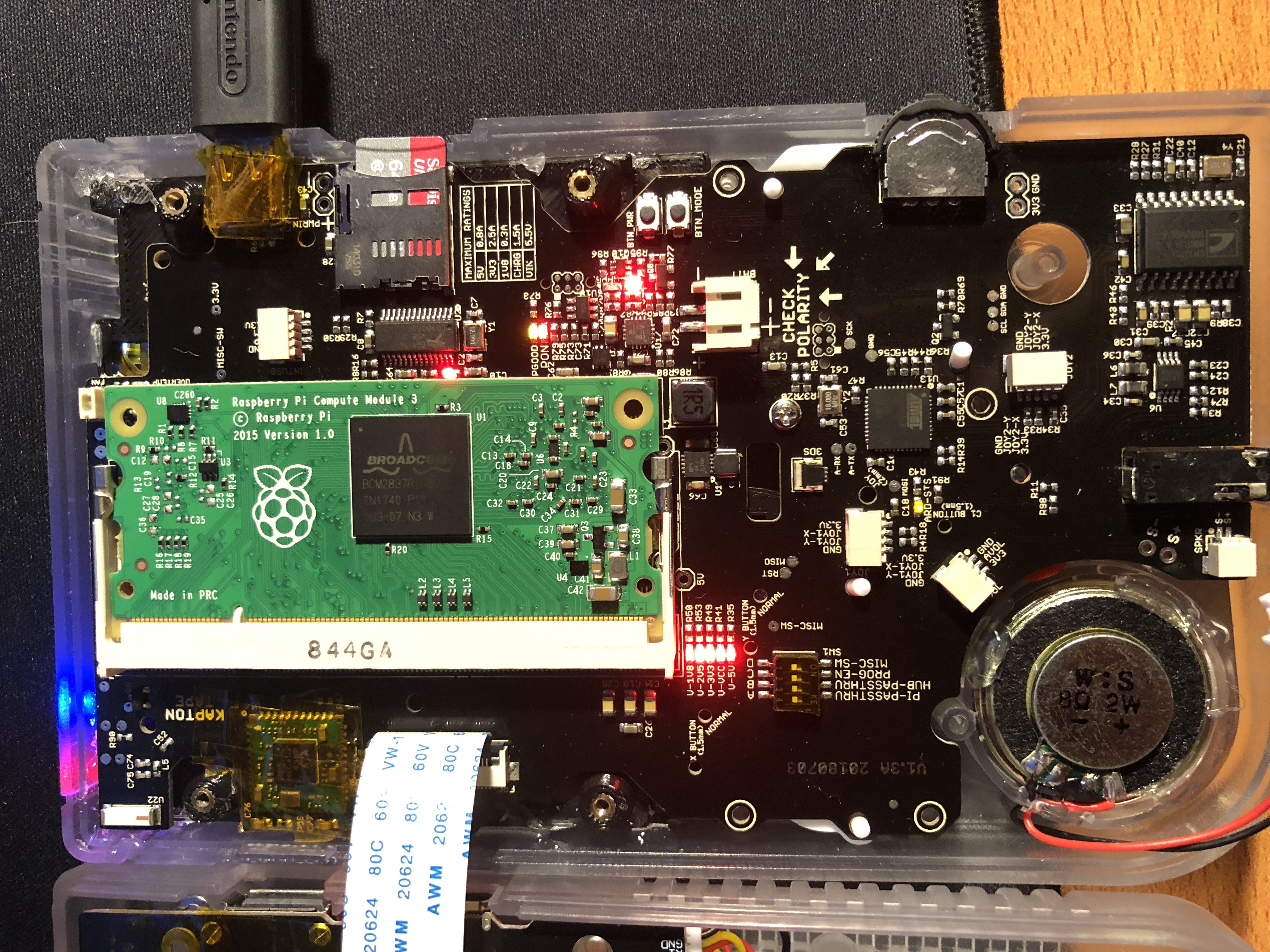

I have attached images of the back of my board while Tester Mode is running and the error on screen I can see.

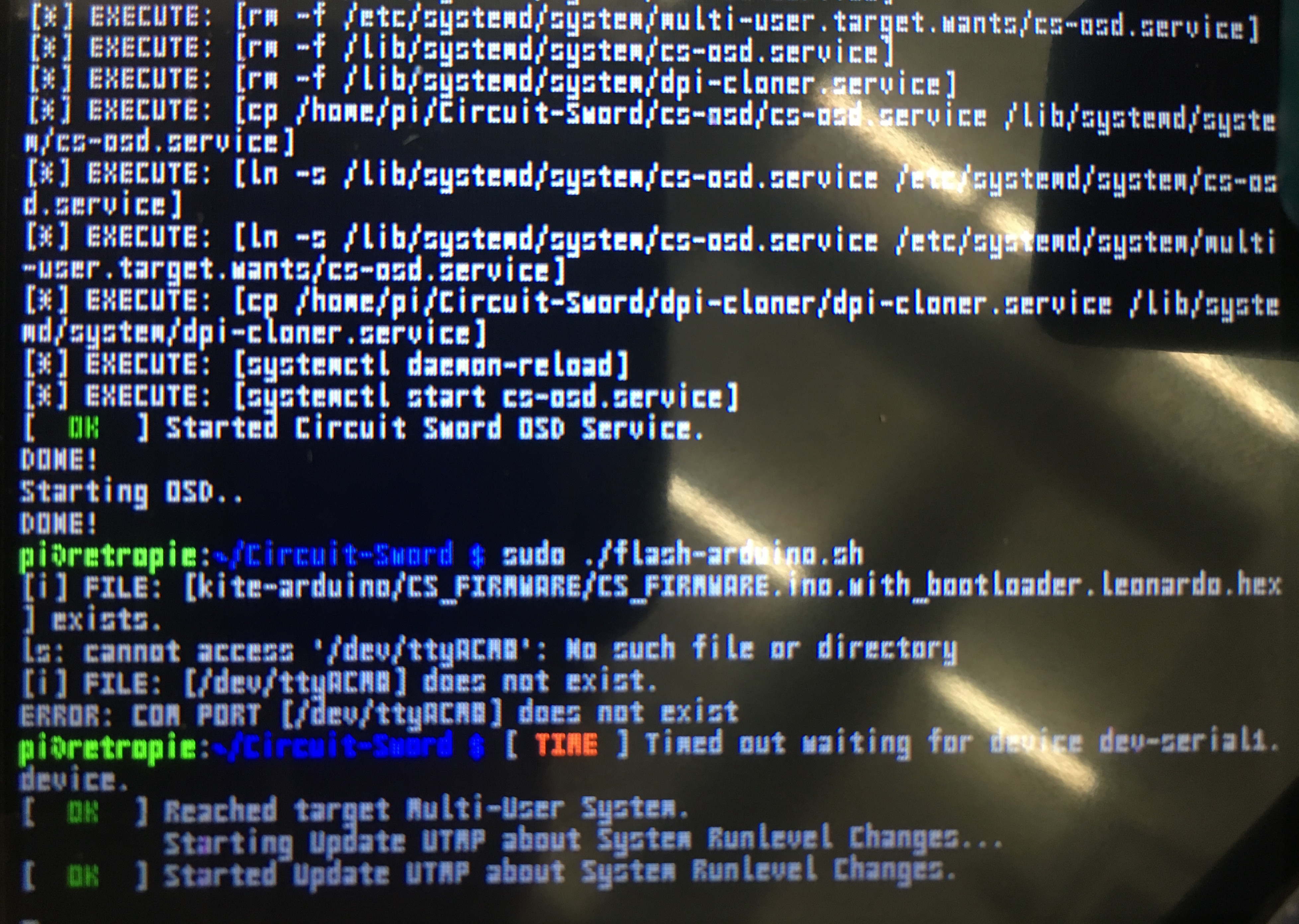

The flash-arduino.sh script fails with the following error seen in the image below.

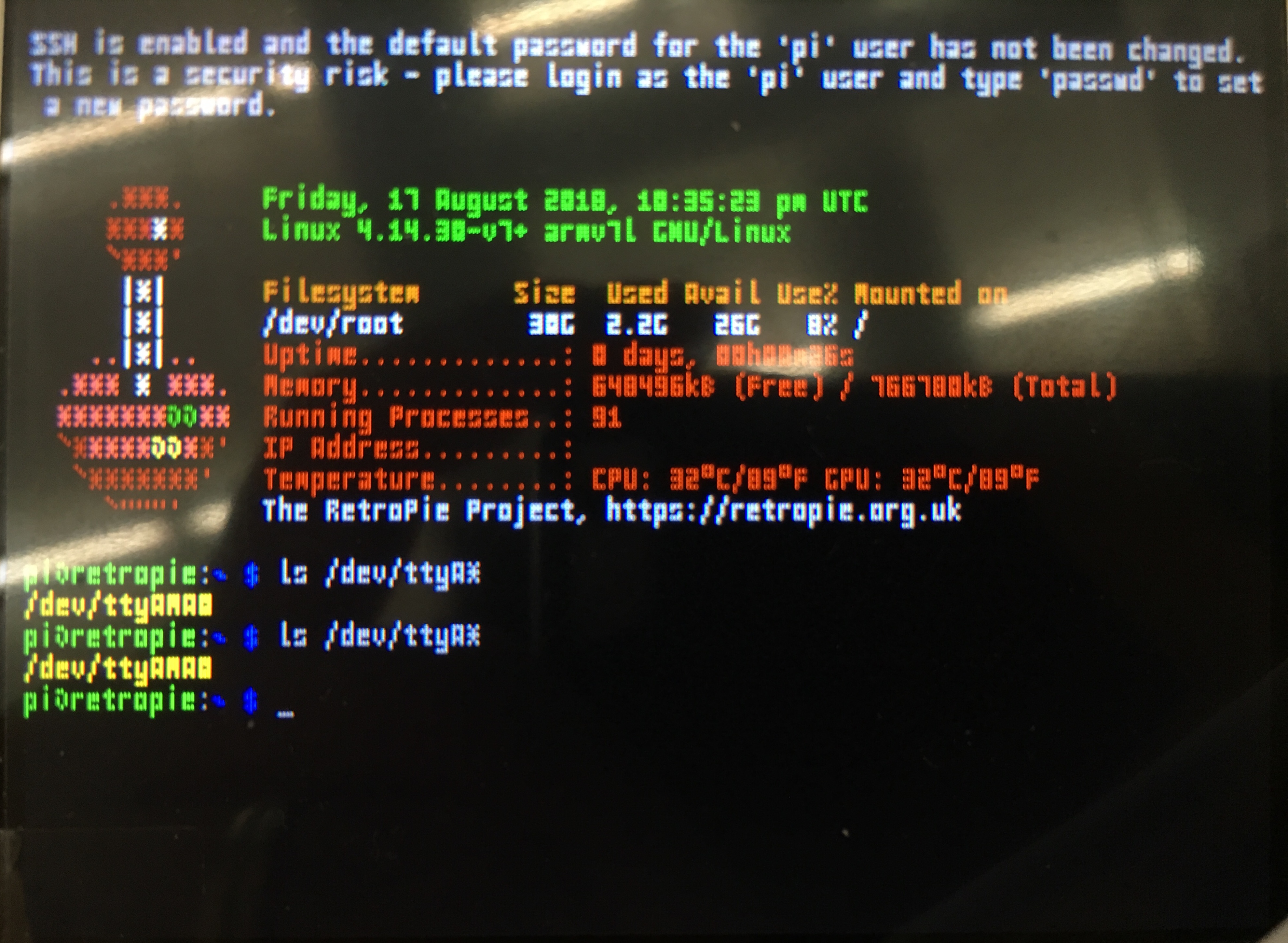

If you plug in in a keyboard and press F4 to get to console (or ssh instead) and run (this is case sensitive):
what does it show?

PS the 'USB HUB FAIL' is actually a bug, your USB hub is working fine on the CSO
ls /dev/ttyA*

Hi Kite, thank you for your support! It did arrive like this, and I wondered about the Arduino not running any code... I looked with a microscope around the board and Arduino chip but did not see any solder bridges that might be causing this issue. It just seems like the Arduino chip is blank and does not contain a bootloader, so I am unable to upload the firmware via the Arduino PC app or RasPi.
It looks like it sayskite wrote: ↑Tue Aug 28, 2018 6:43 amIf you plug in in a keyboard and press F4 to get to console (or ssh instead) and run (this is case sensitive):what does it show?Code: Select all
ls /dev/ttyA*
ls /dev/ttyAMAO
I did try it on a few different hubs and USB ports just in case that was the issue, but I have the same result on each of them. Flipping the USB C cable didn't help either, unfortunately.
