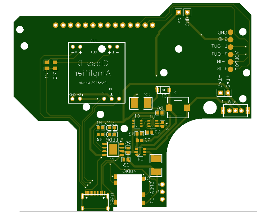

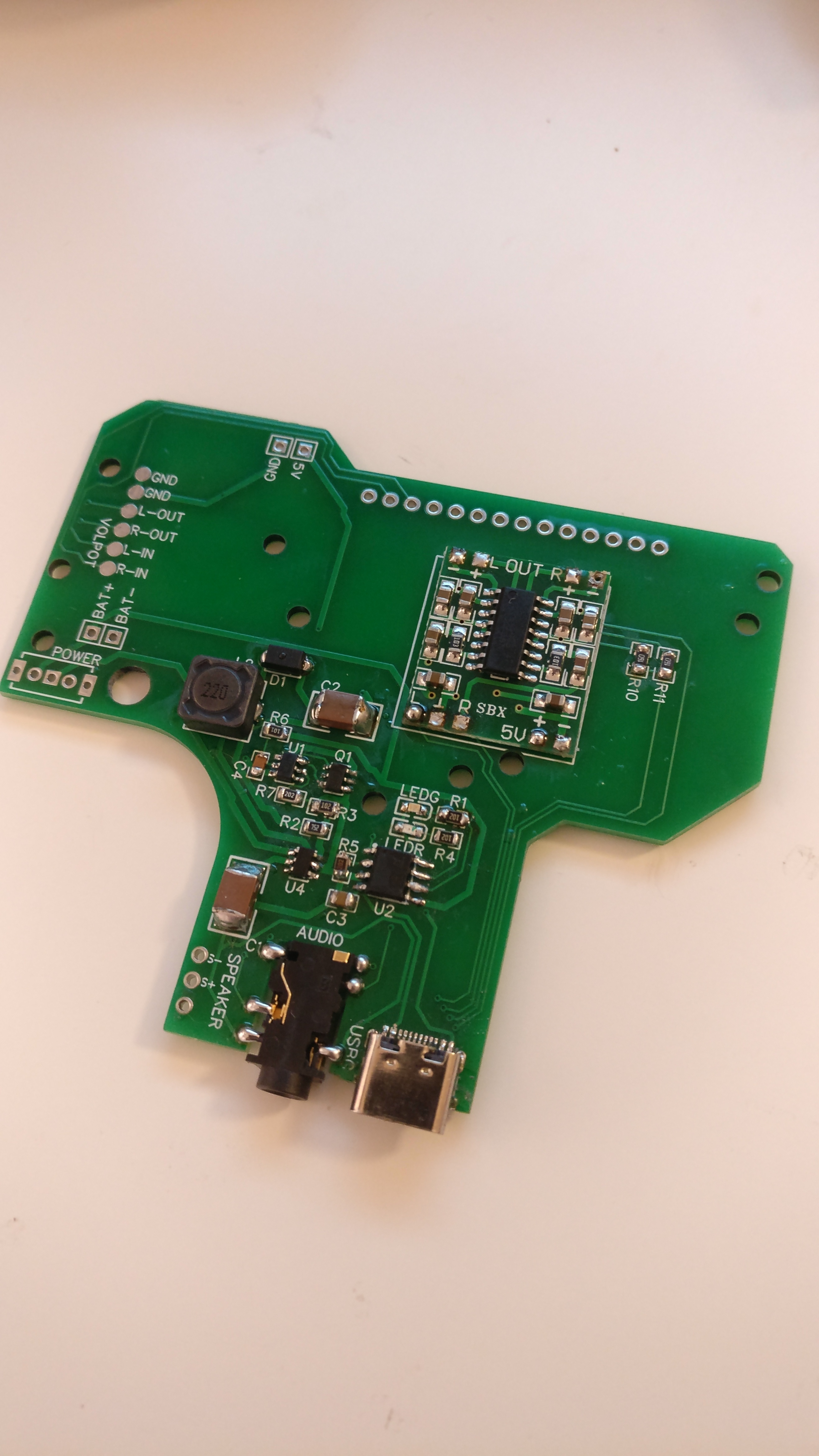

I recently designed my own Button PCB for the Gameboy zero with integrated charging circuit and Audio circuit (newer version but not tested yet with safeshutdown). I don´t want to sell the boards or anything because there are already good options out there to buy (and to make your own boards where you have to think about the layout and the parts is really funny, interesting and instuctive) So I thought it would be a good idea to make the design files and gerber files available for everyone who would like to build his own PCB and add some custom stuff. So this is more intended for the DIY people out there, who want to try/test something new rather than these who wan´t right from the beginning a really good working board which you can buy from various members here in the forum. I think the board I designed isn´t a bad starting point and maybe someone is interested in that.
here are some pictures of the board:
