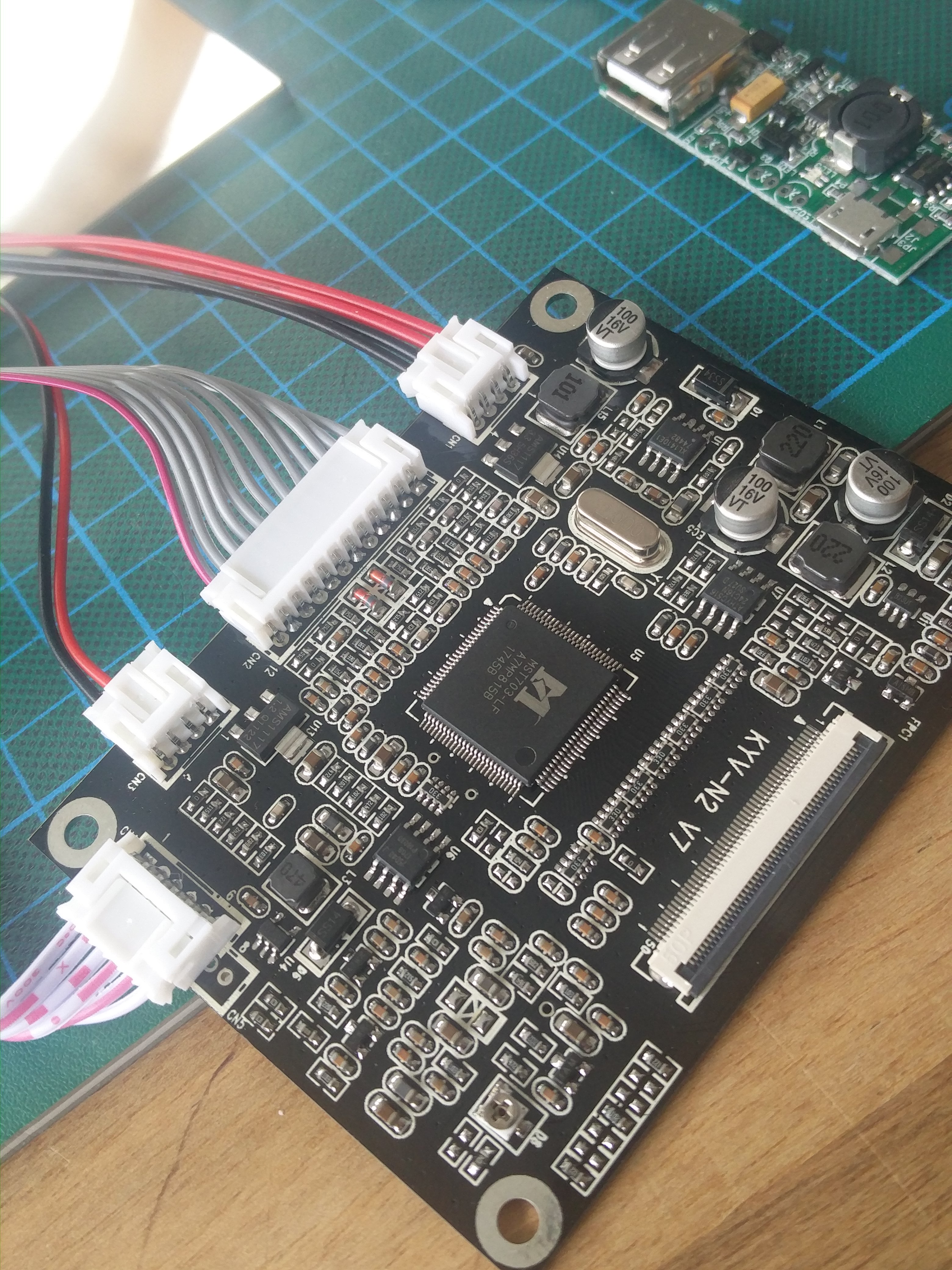

I used a pi zero W with a 3.5" screen, apparently a 640X480 VGA screen (although I just used composite for connecting to the pi). It's really crisp and runs out of the box on 5V.

Jeez. Just noticed this a month later...oops. I just used the composite out of the screen. Yellow av wire to the pi's av port. Then power and ground to my power strip. Just like any other composite screen.
I removed the vga connevtor. But you could use that if you have a vga to hdmi adapter and coils make it fit.

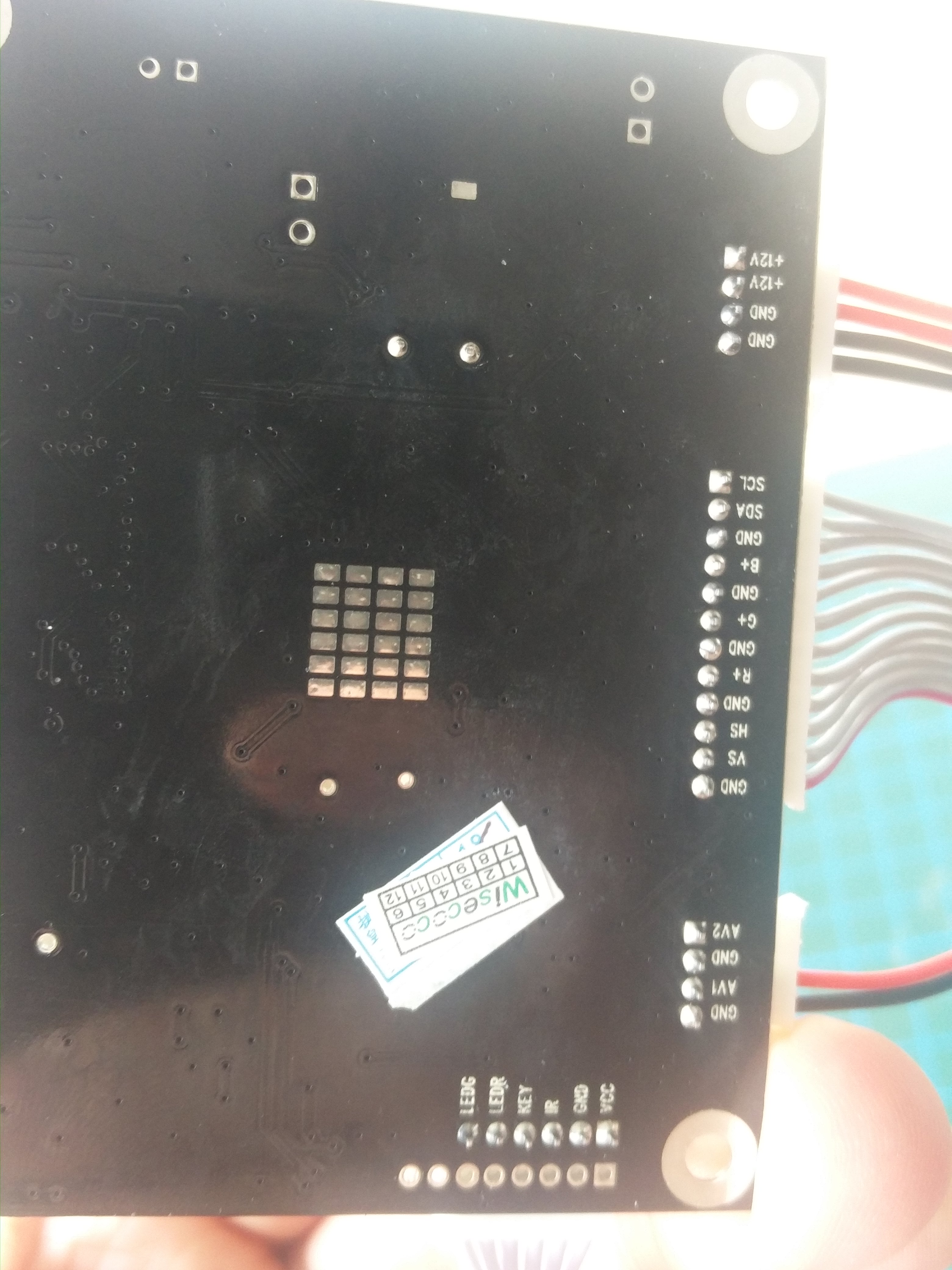

Rowi
Posts: 32
Joined: Sun Jan 27, 2019 1:41 pm
Re: GameGear Zero
Post by Rowi » Sat Apr 13, 2019 4:57 am
hi do not have a yellow out wire :(

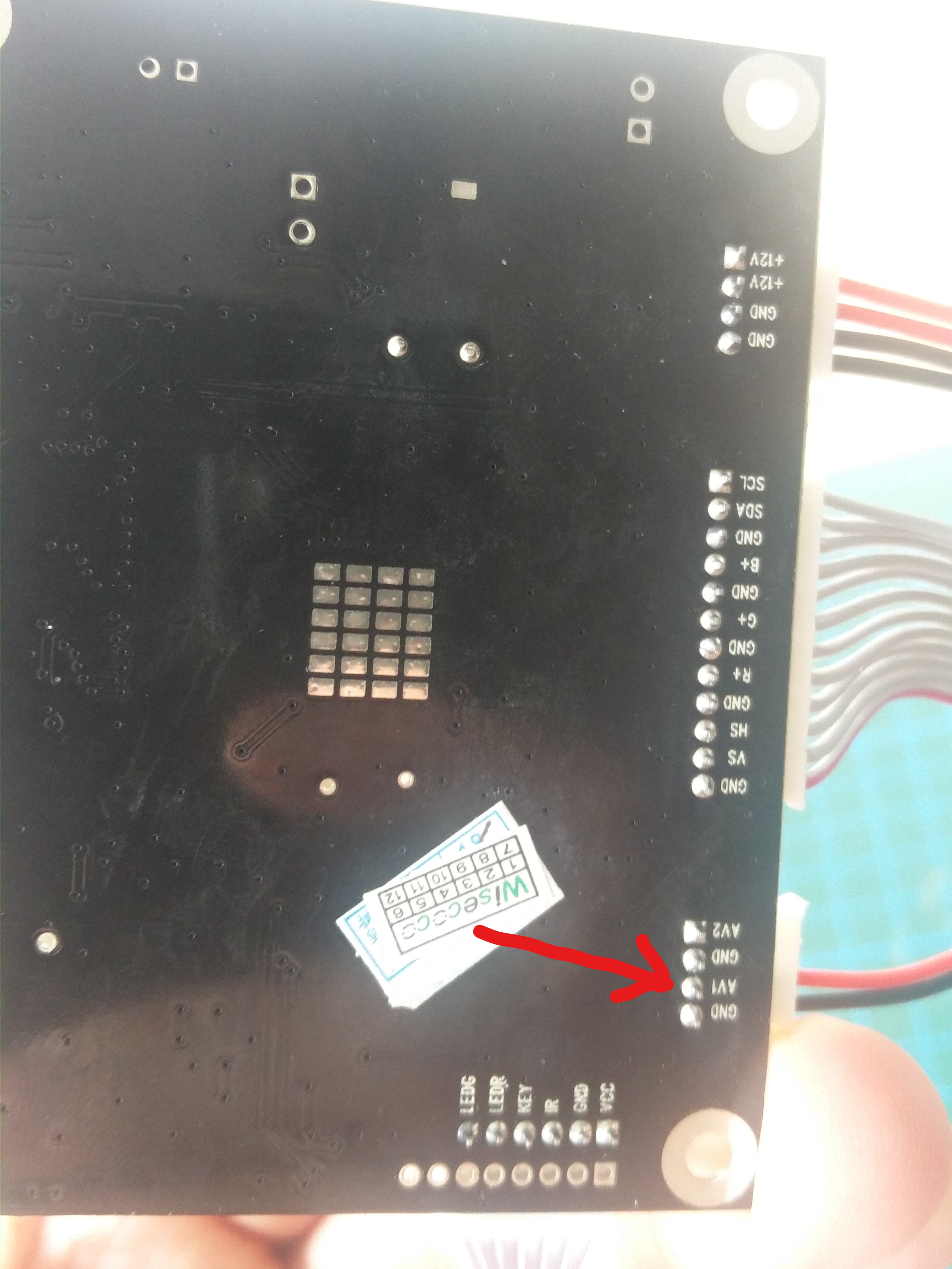

Re: GameGear Zero
Post by VeteranGamer » Sat Apr 13, 2019 6:17 am
AV1 is your "yellow out wire"
