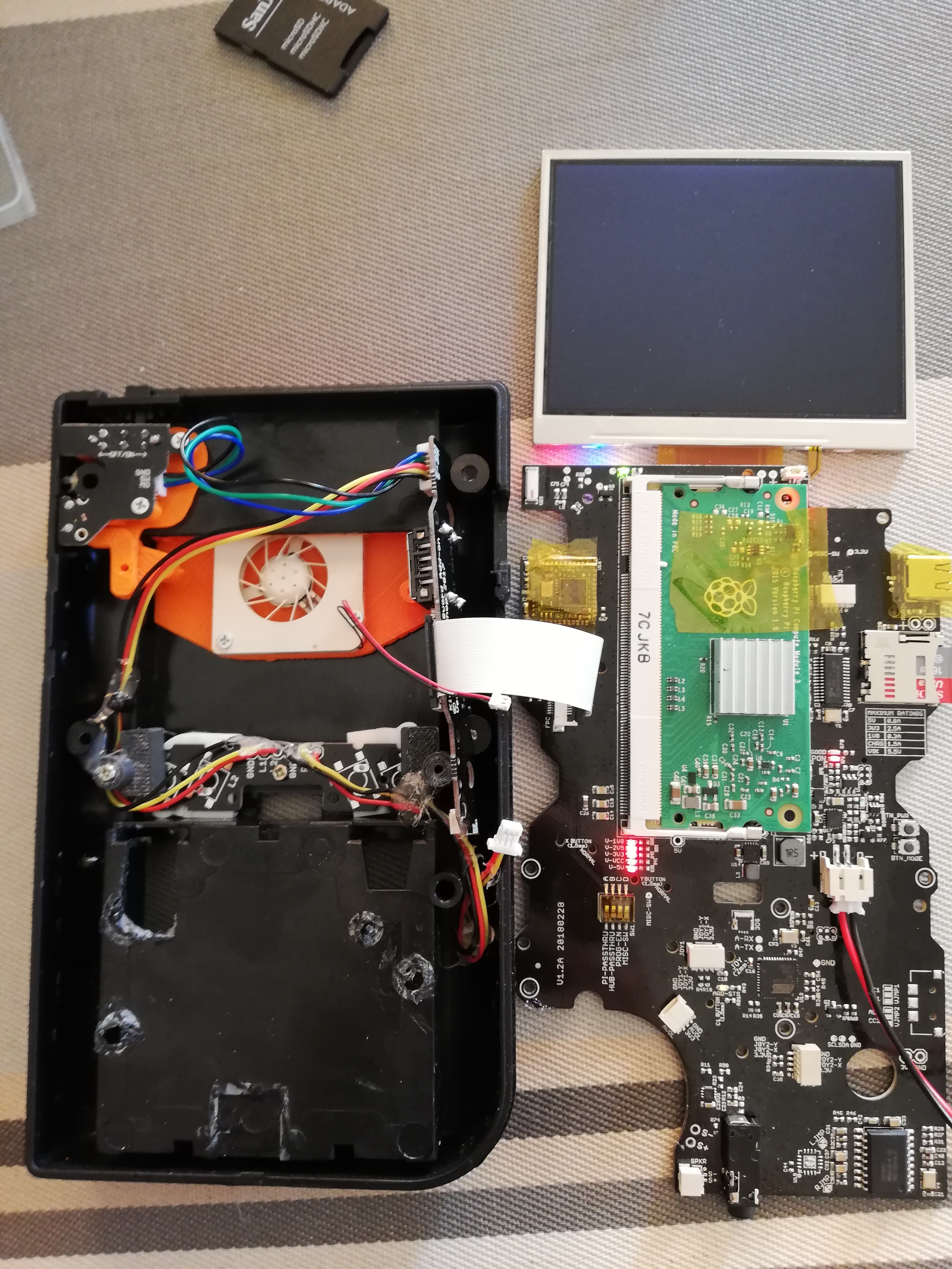

Hello,
It seems that I'm having another issue with the board.
It worked for a few hours, than, since I closed the case, it will not boot.
I tried restarting from the electronic test, but nothing seems out of place.
I've unplugged / unsolder the L/R pad, nothing...
I've tried another SD card, but the result is the same : a black screen.
Does someone knows what the problem could be ?

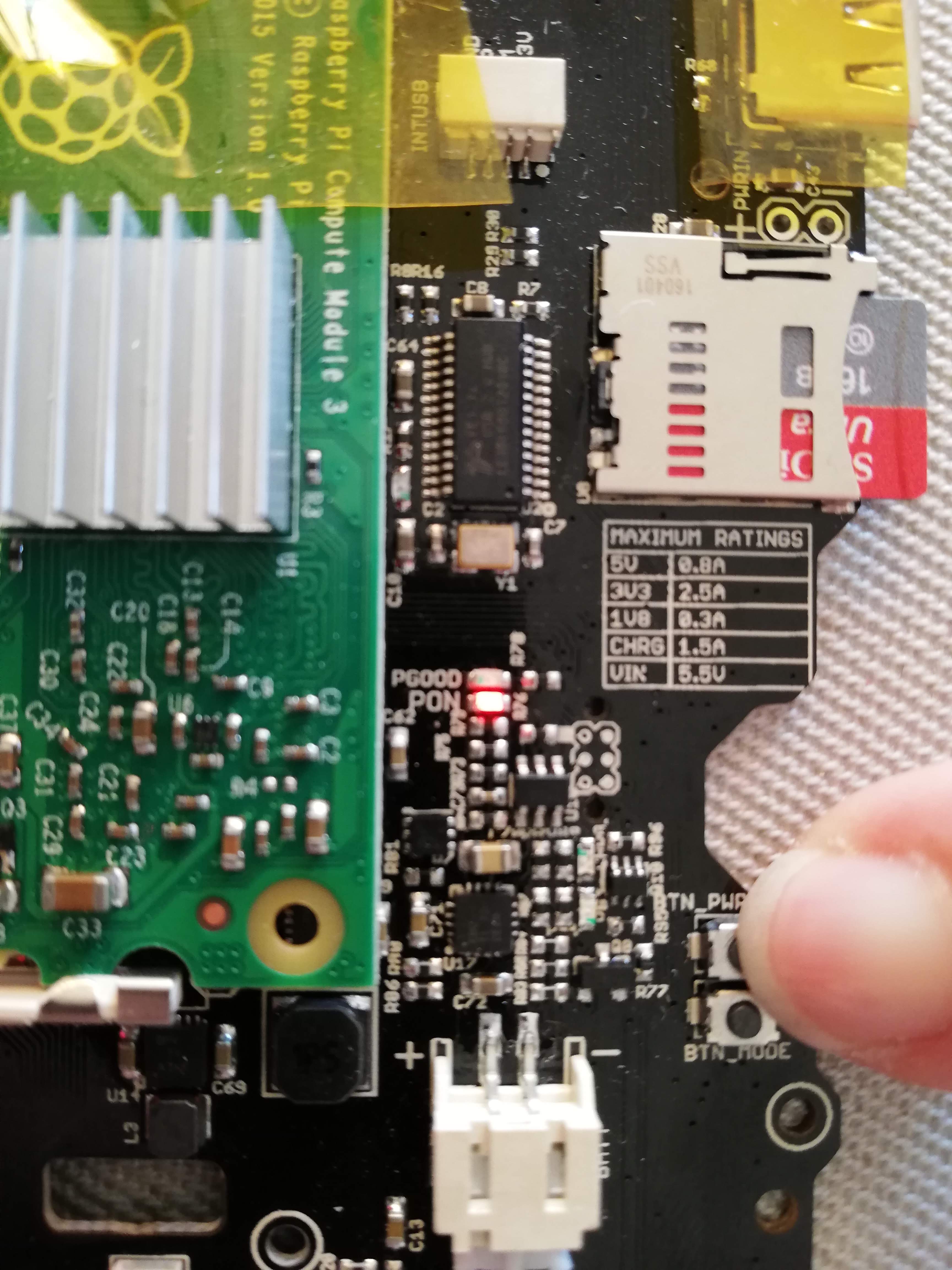

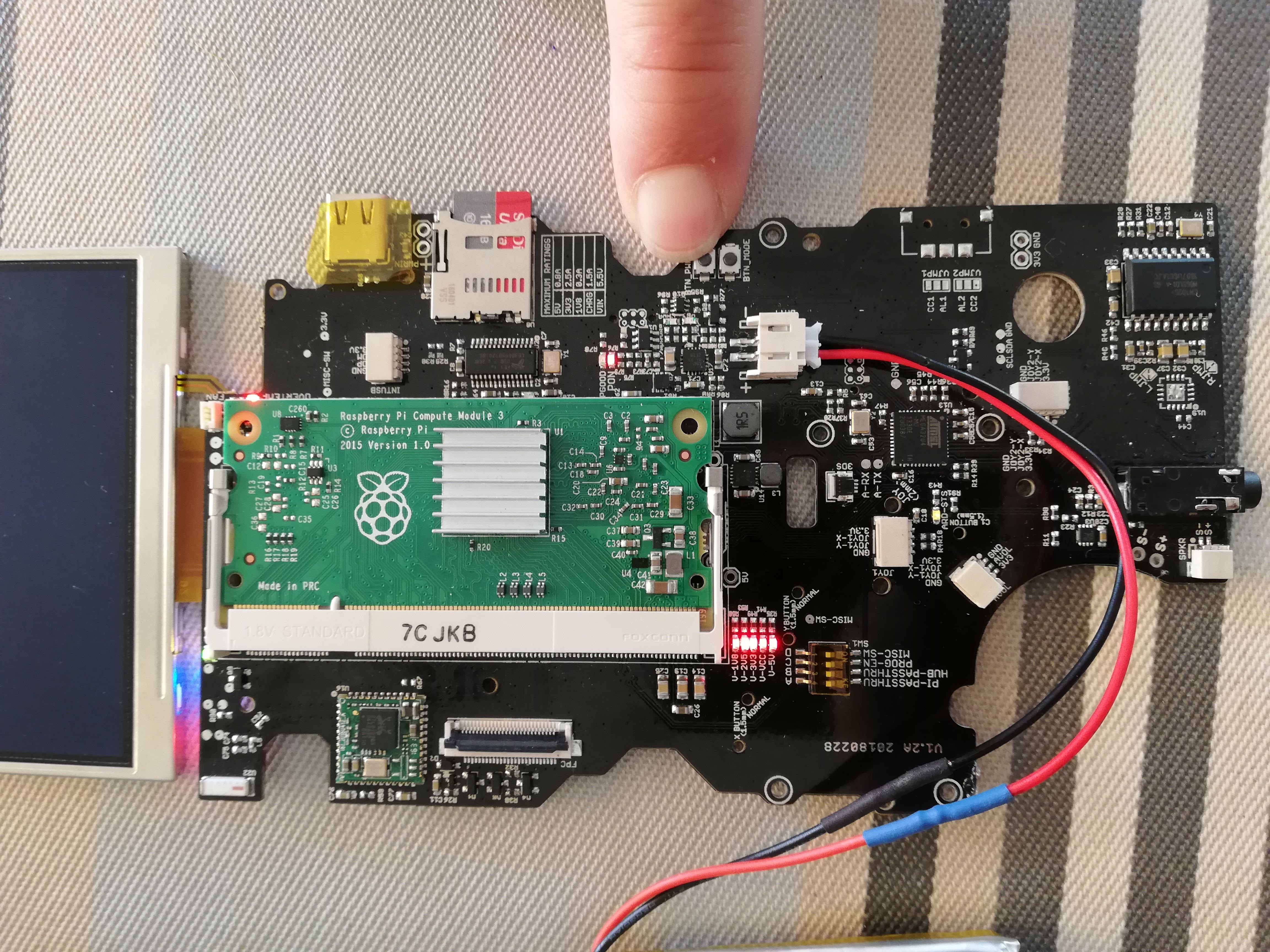

If you unplug the back board ribbon, and power on with the button, what happens? Have you done a fresh image again? the 'PGOOD' LED which is green isn't on, when booted ok this comes on about 1 sec after power is applied

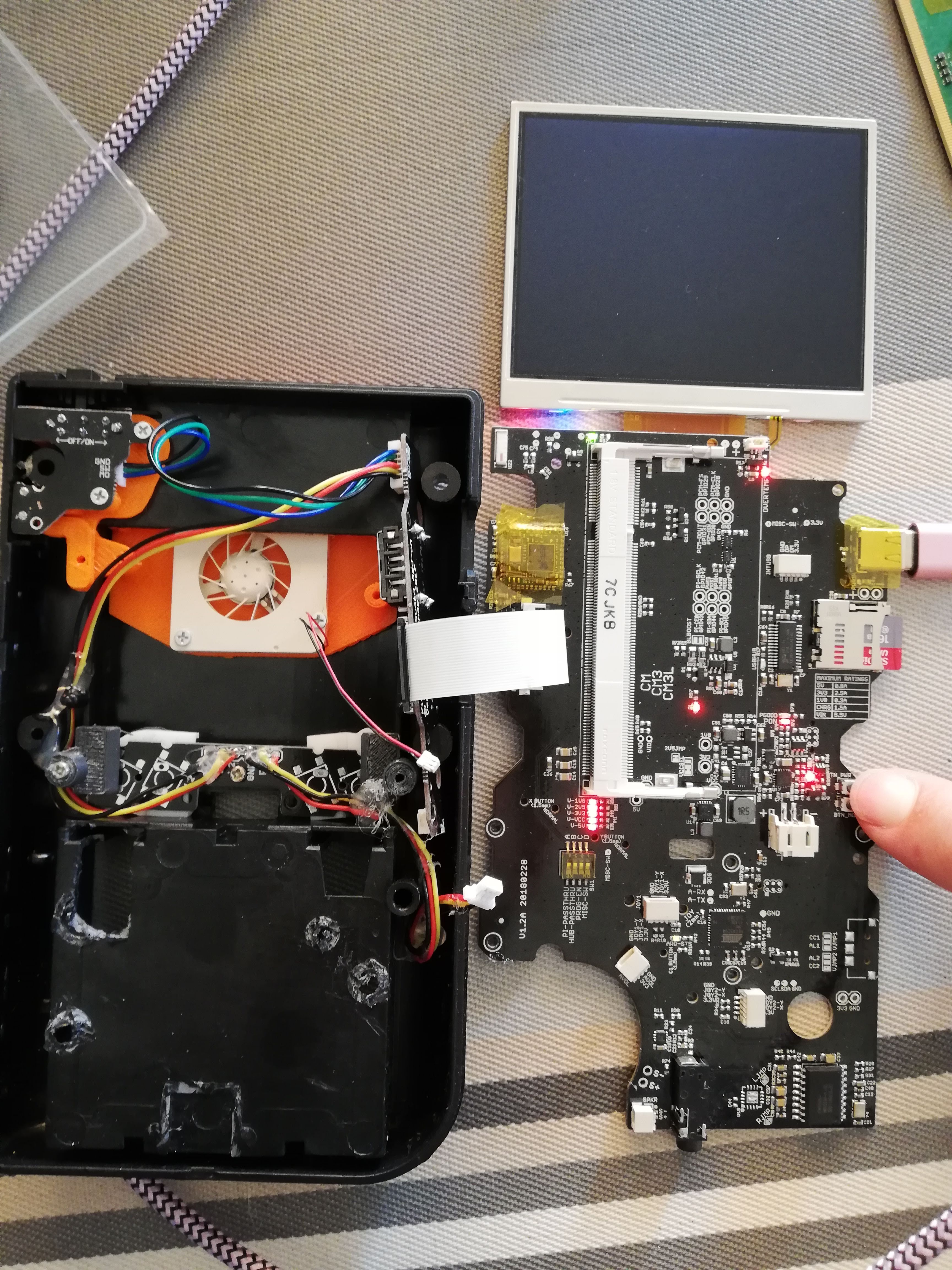

I tried booting without de backboard ribbon, nothing. I got the same black screen.
The PGOOD Led does not light up.
I tried 2 differents SD cards (that works, I tested them in another Raspberry), with a fresh image each time. I flash the image with Win32DiskImager.

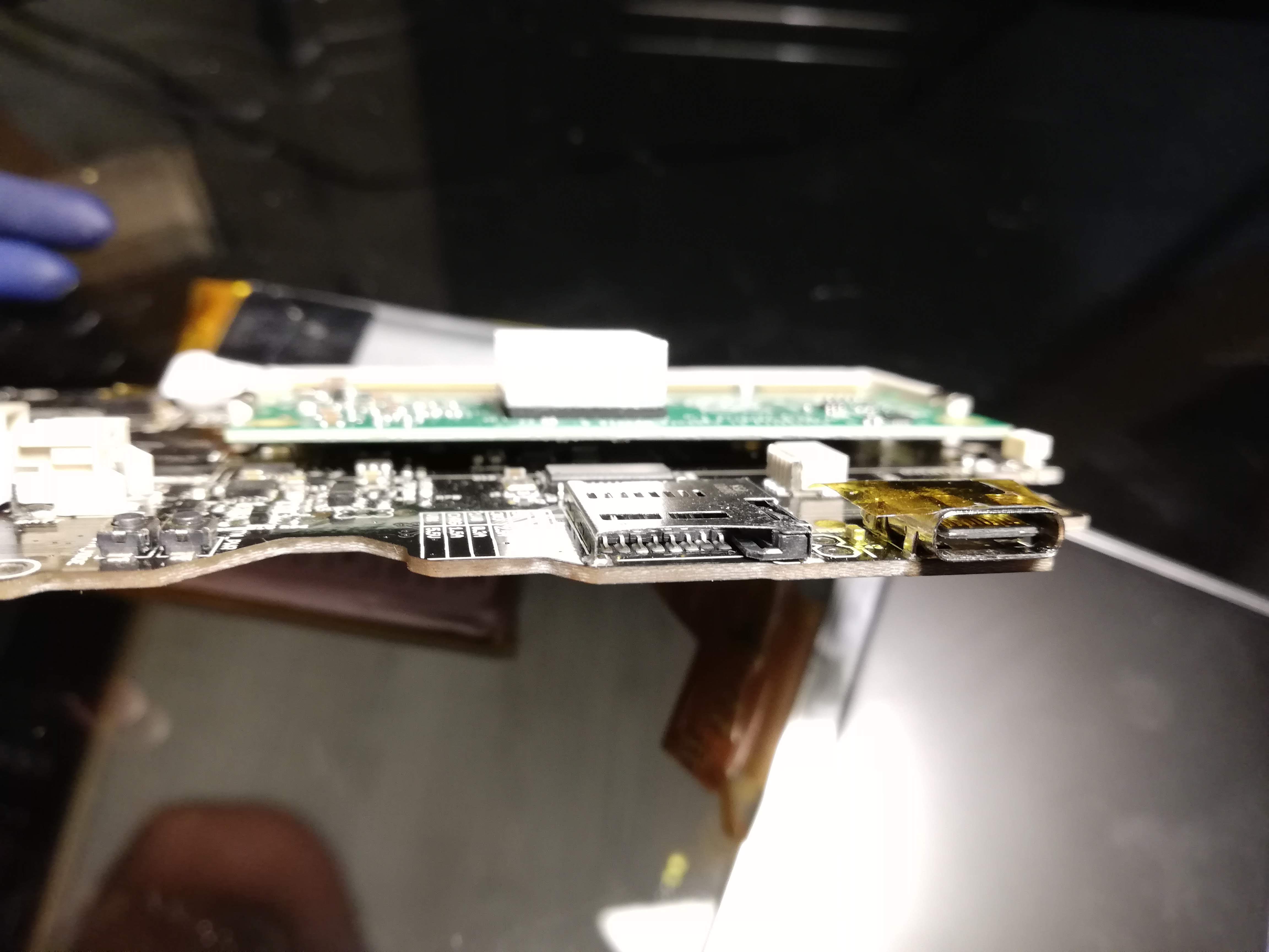

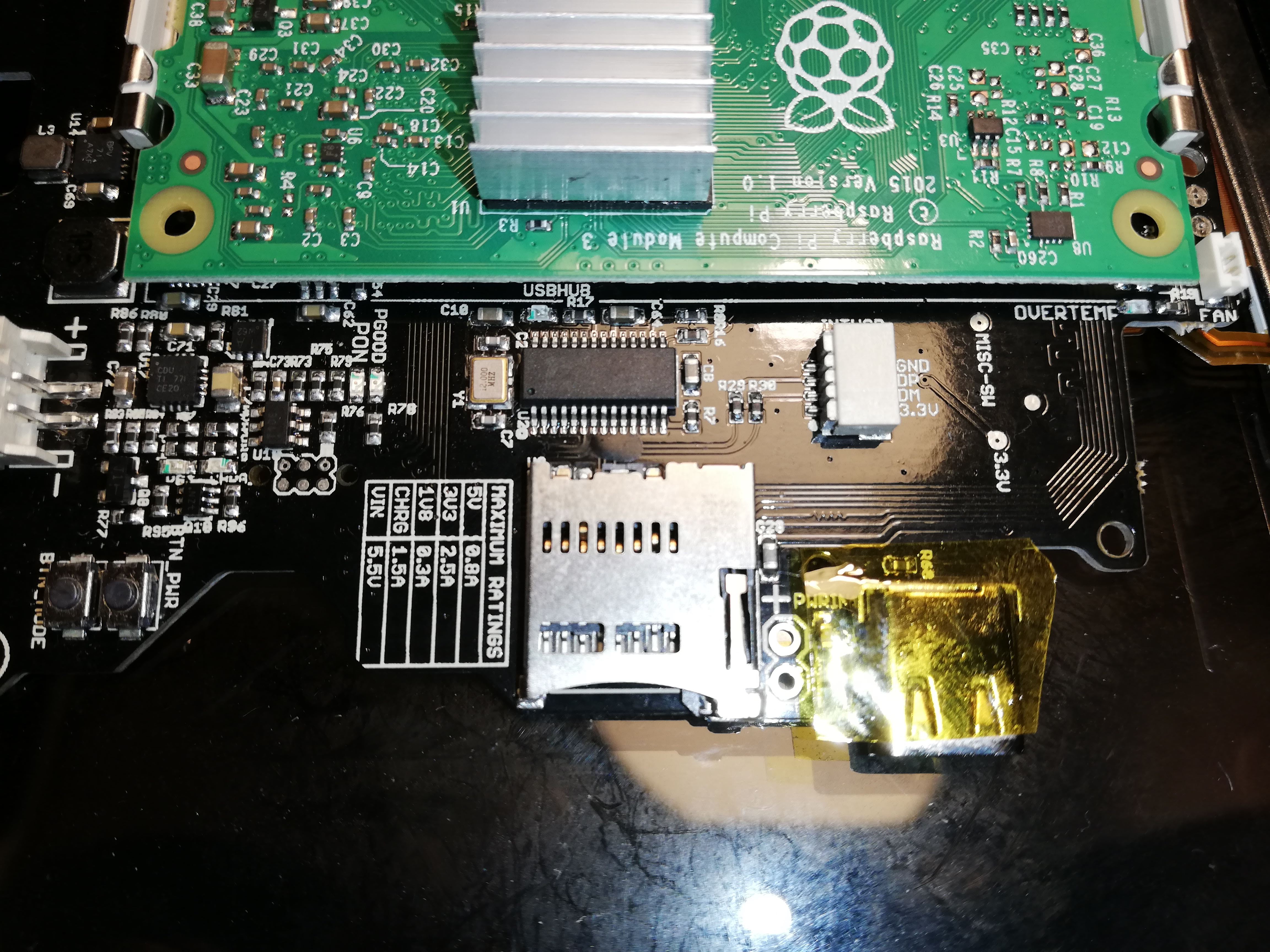

Can you unplug the SD card and take a picture of the SD card holder. What I am interested in are those series of holes on the top of the metal, these allow you to 'see' the SMD contacts that touch the PCB. I've seen one case where this wasn't actually soldered properly! (like no solder at all). So if you can try and take a picture of this, and if you your self try and look carefully and see if it appears to be soldered or not. It should look like all the other components with a slightly shiny molten solder look about them. If they look kinda perfectly square and no solder on the surrounding pads, then that might be something causing this!

Post by Denver » Wed Sep 26, 2018 9:57 am
It looks like a gold connector is misplaced.
The soldering looks fine to me, but I'm no expert ...

Post by kite » Mon Oct 01, 2018 8:38 am
Nice pics, soldering looks good, I see what you mean about that gold connector.. i'll need to check later on mine but from the looks of it that could be it. At this point it's probably worth sending me an email and we'll sort out a return.. if you think you have the ability to try and move that connector into place so that the SD card can contact it, that might be worth it (i will likely have to replace the SD anyway)
