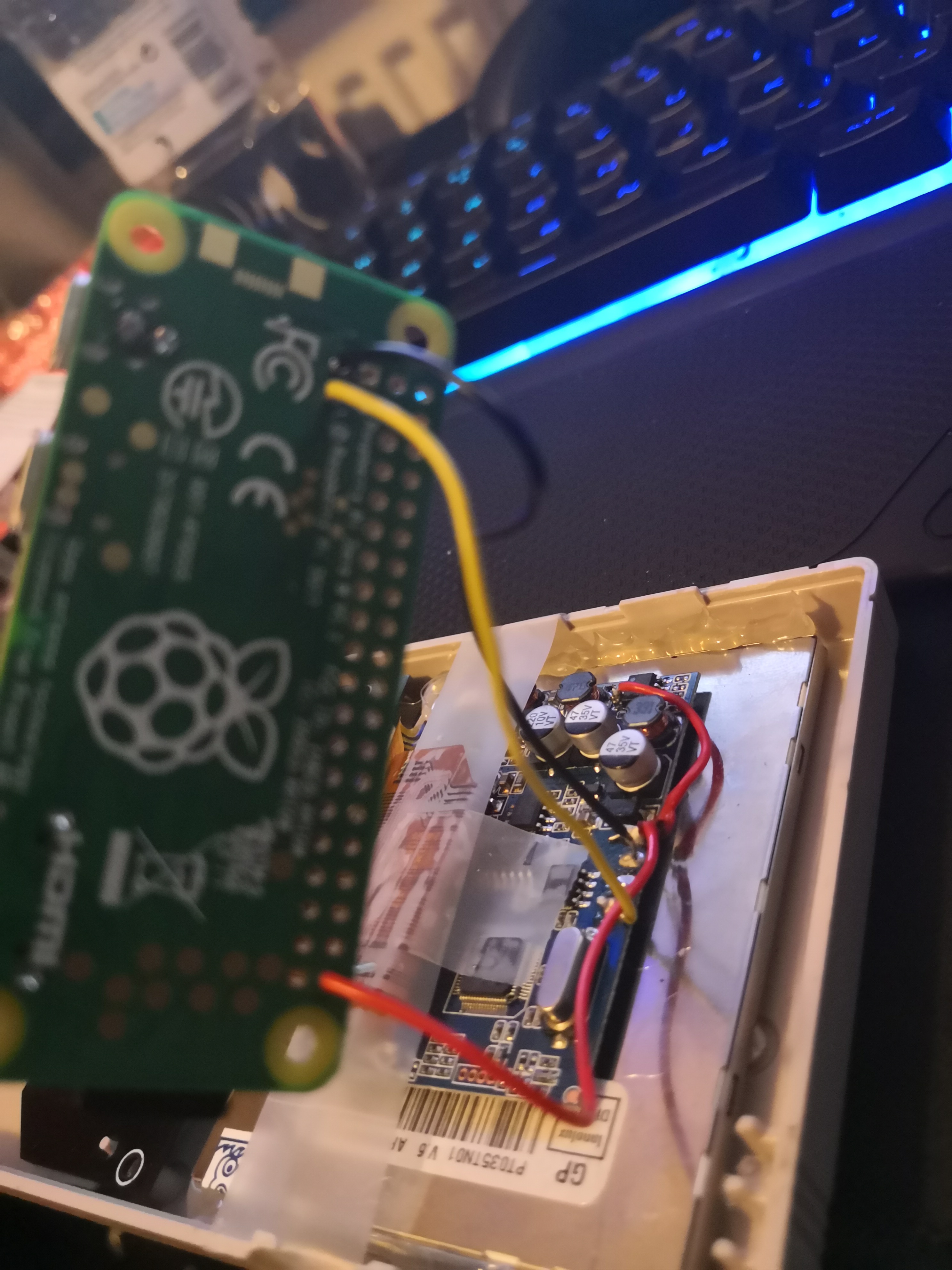

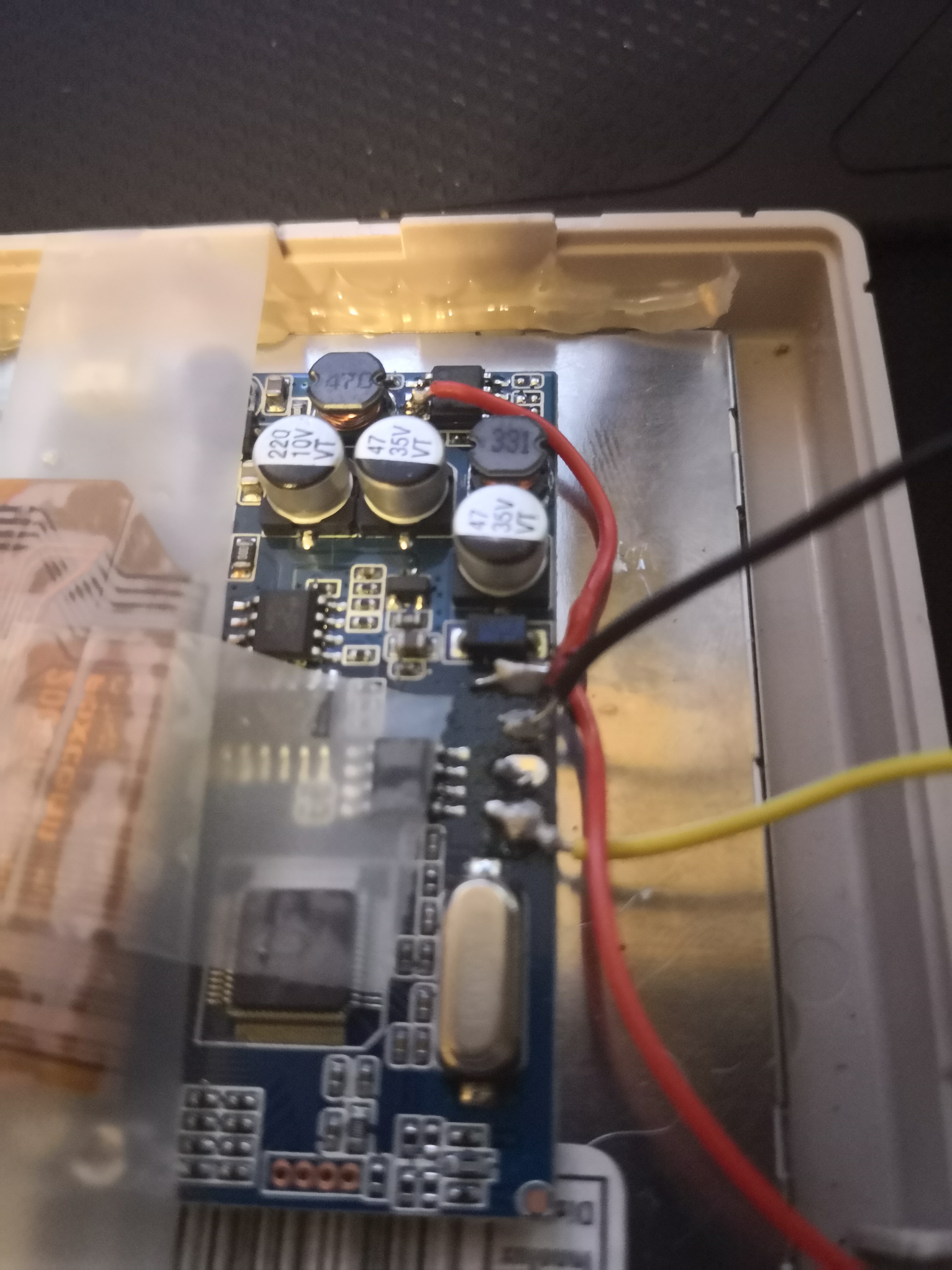

Hey guys need abit of advise and help if possible
I have a 'InnoLux' Ebay screen which i am having problems getting power to via the raspberry pi zero board, the screen has been tested with a direct input from a megadrive and plugged directly into a 5v supply after doing 5v mod and worked completely fine, however when it on the raspberry pi i am just gettings a black screen.
Ive tried two different wiring types, one from wermy guide and also the guide from Fleder also.
The pi itself is flashing green but not a peek out of the screen.
Any help would be great
Thank you very much :)
CmdPopNFresh199
Joined: Tue Oct 09, 2018 5:05 pm
Re: Screen issue
Post by CmdPopNFresh199 » Wed Oct 10, 2018 12:54 pm
Also tried both white and yellow wires to video output with no luck :(

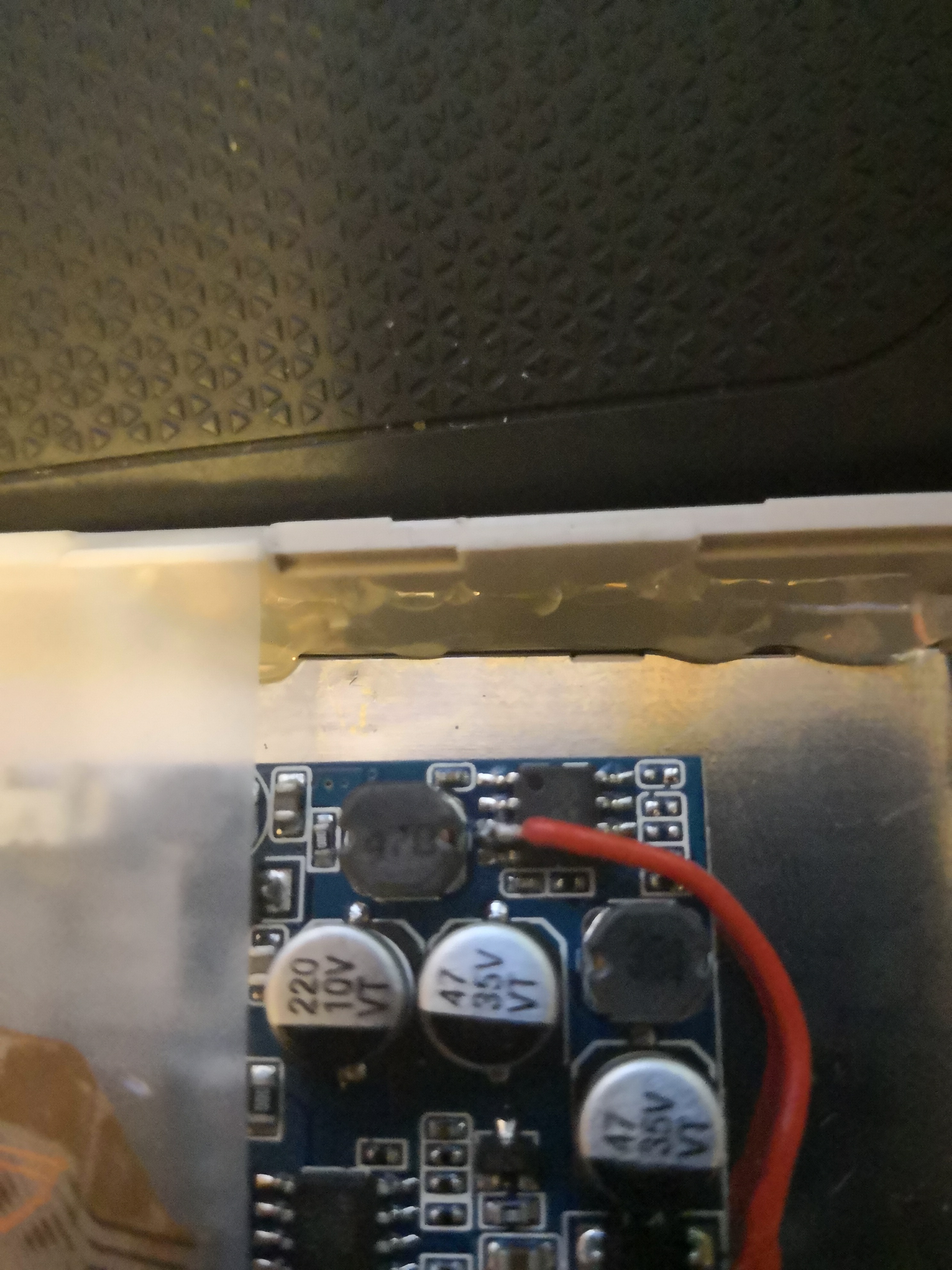

Hello, hope you figured it out already, if not try using a multimeter to see if you have a good connection to the chip you soldered onto, also don't bridge the red wire just hook straight from the chip to the pi zero. Anyways I hope this helps, please post an update, good luck.
