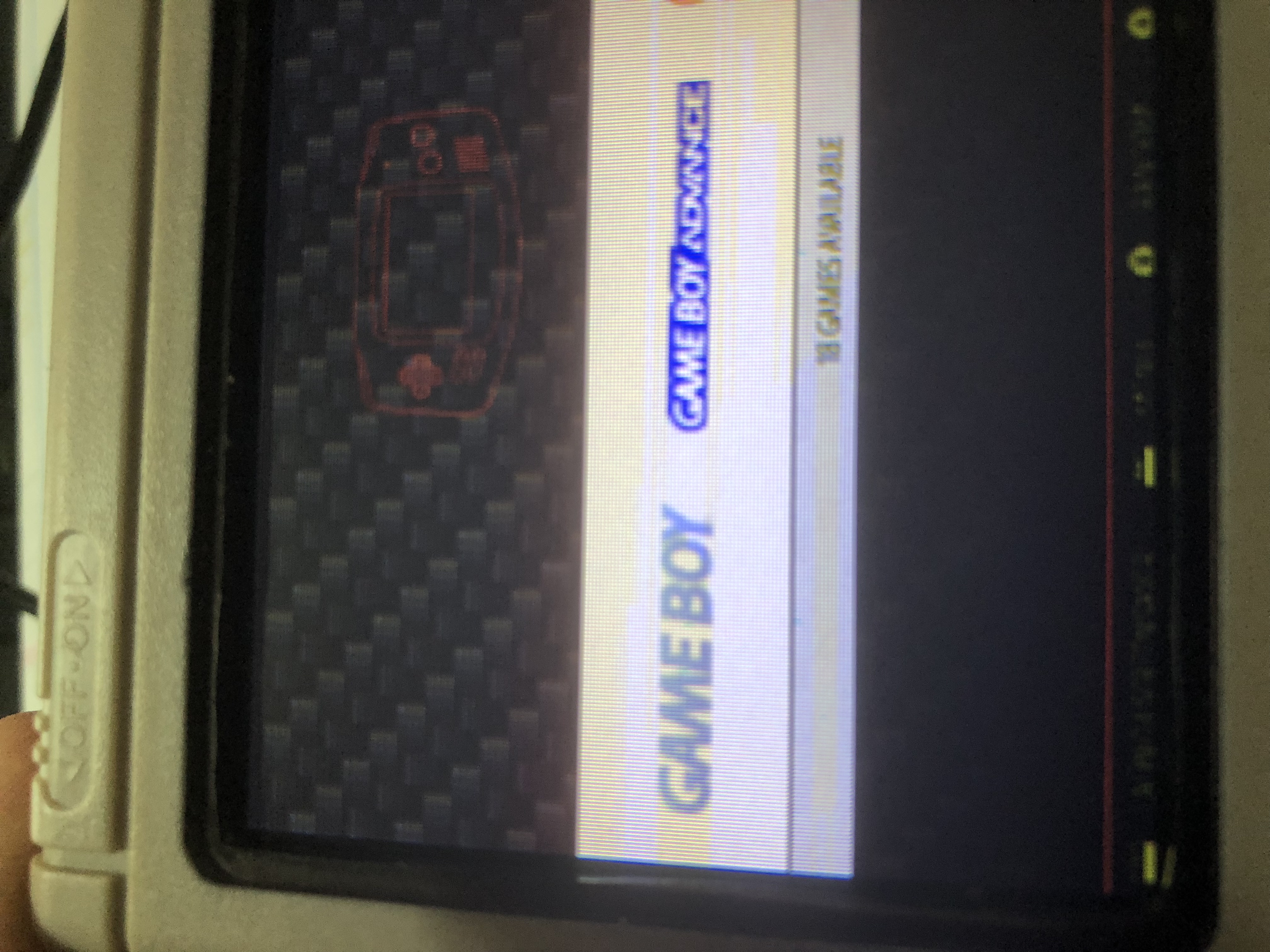

So my screen has a yellow tinge to it in certain screens and some horizontal banding issues very similar to the issue I see on the cm3 sword.
My eyes aren’t the best but I can not (at least easily) see any bridges on the ribbon connector on the board.
Any ideas to help me out?
Thanks!

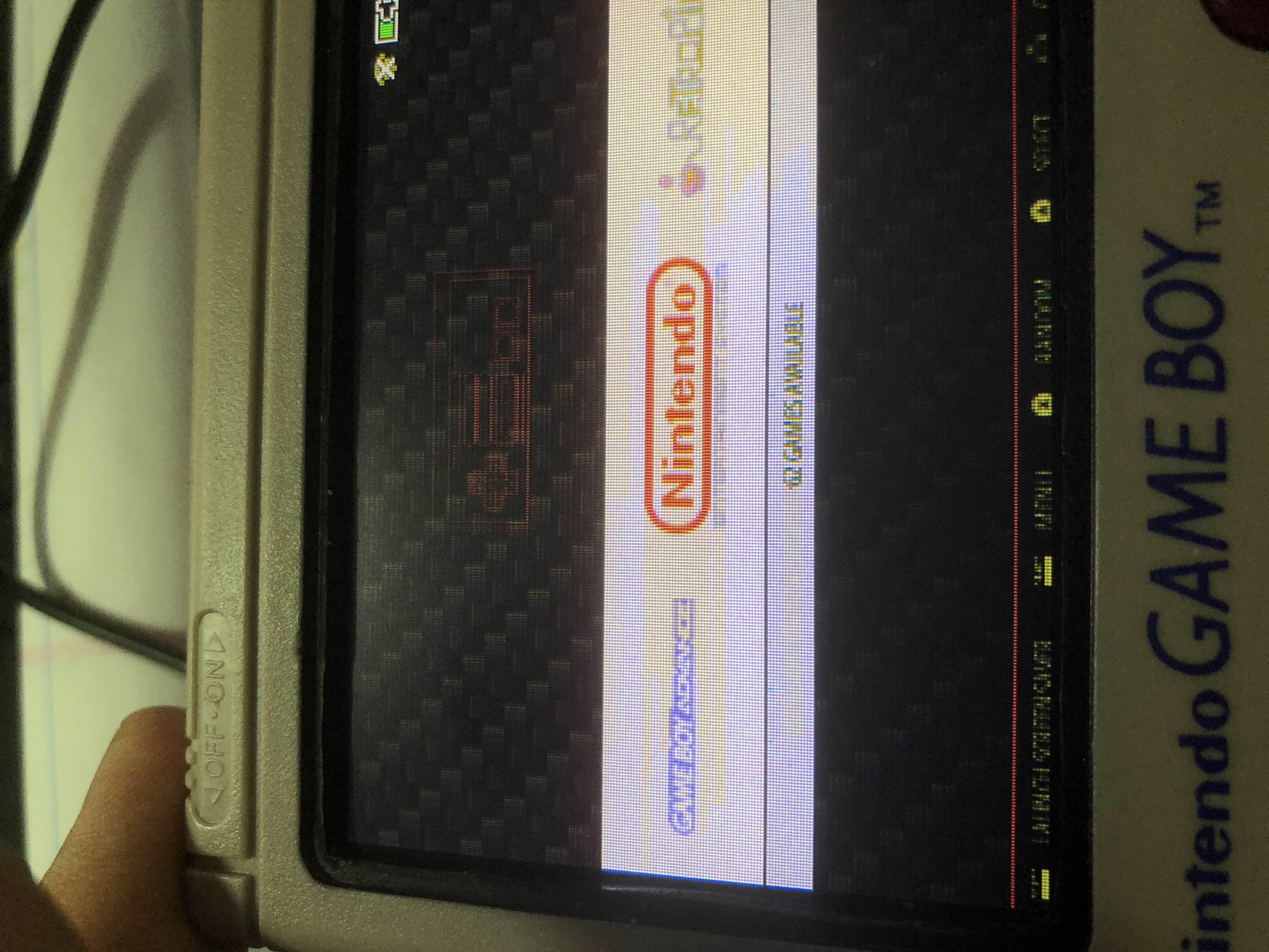

Here are a couple shots...
The menu is static so it’s eaiser to get a clean pic.
