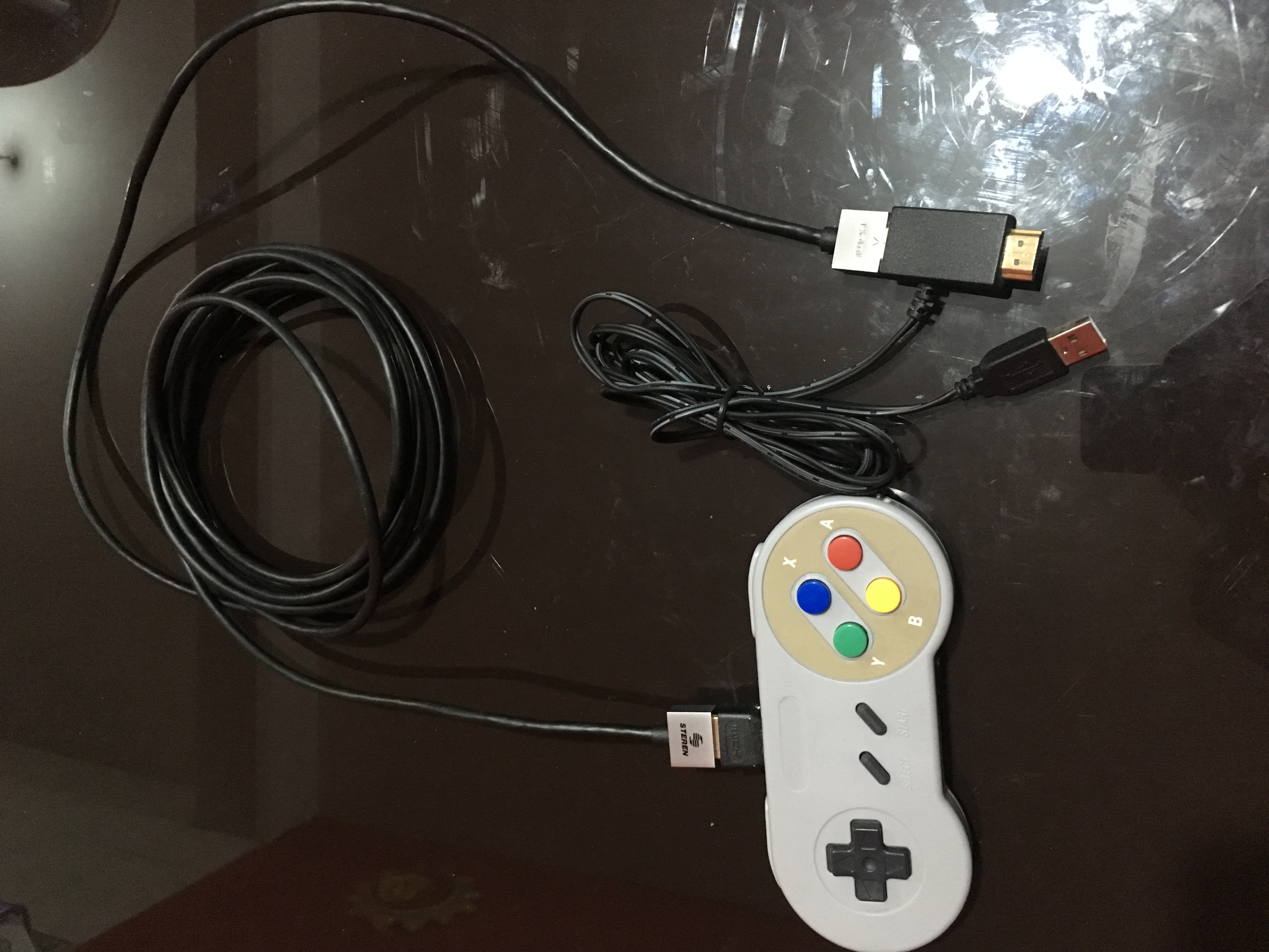

I wanted to take only one cable (Video) from the controller. So I had two options, struggle an iphone 5 battery because of it´s low proflile or the HDMI powered solution.

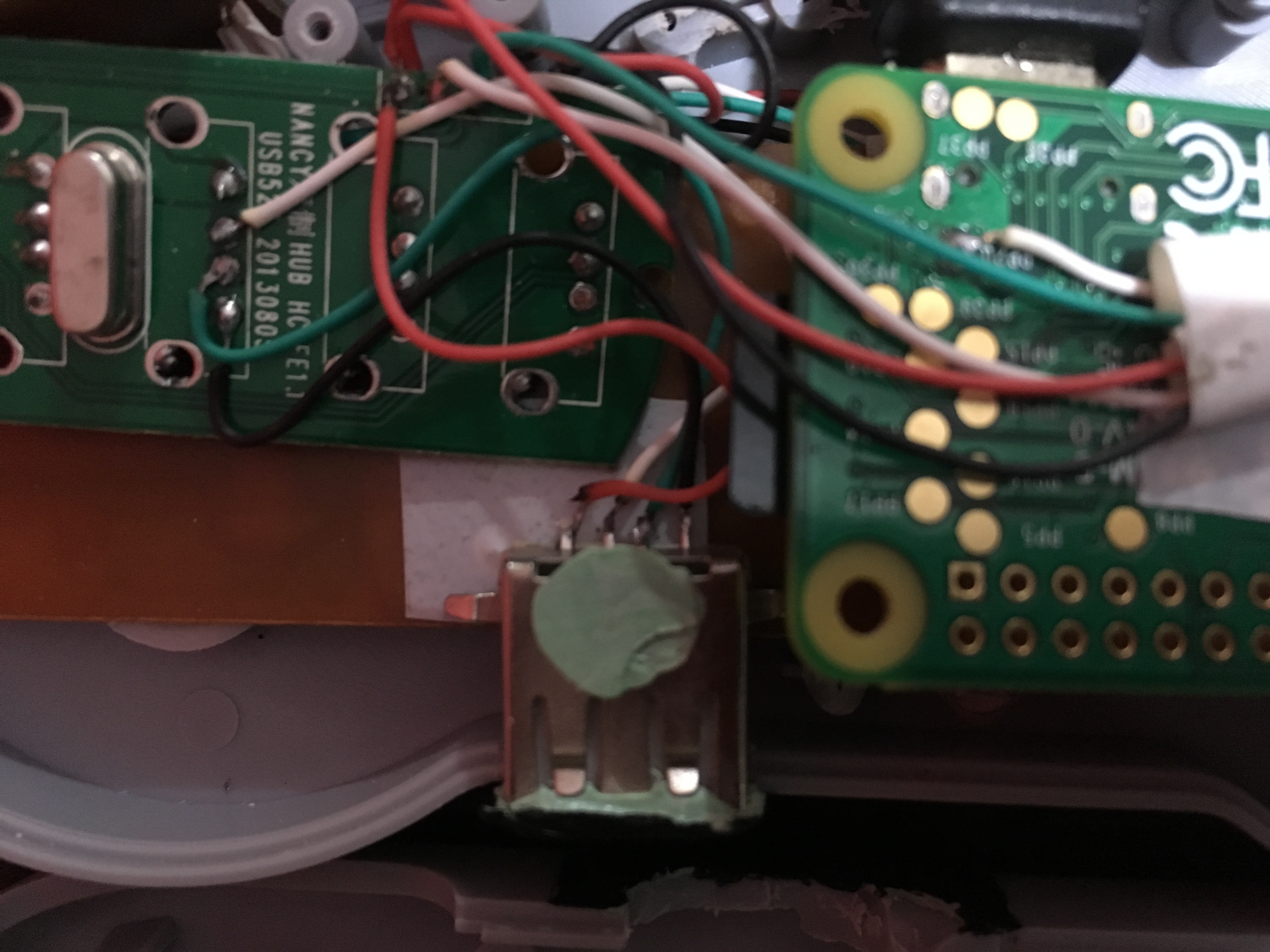

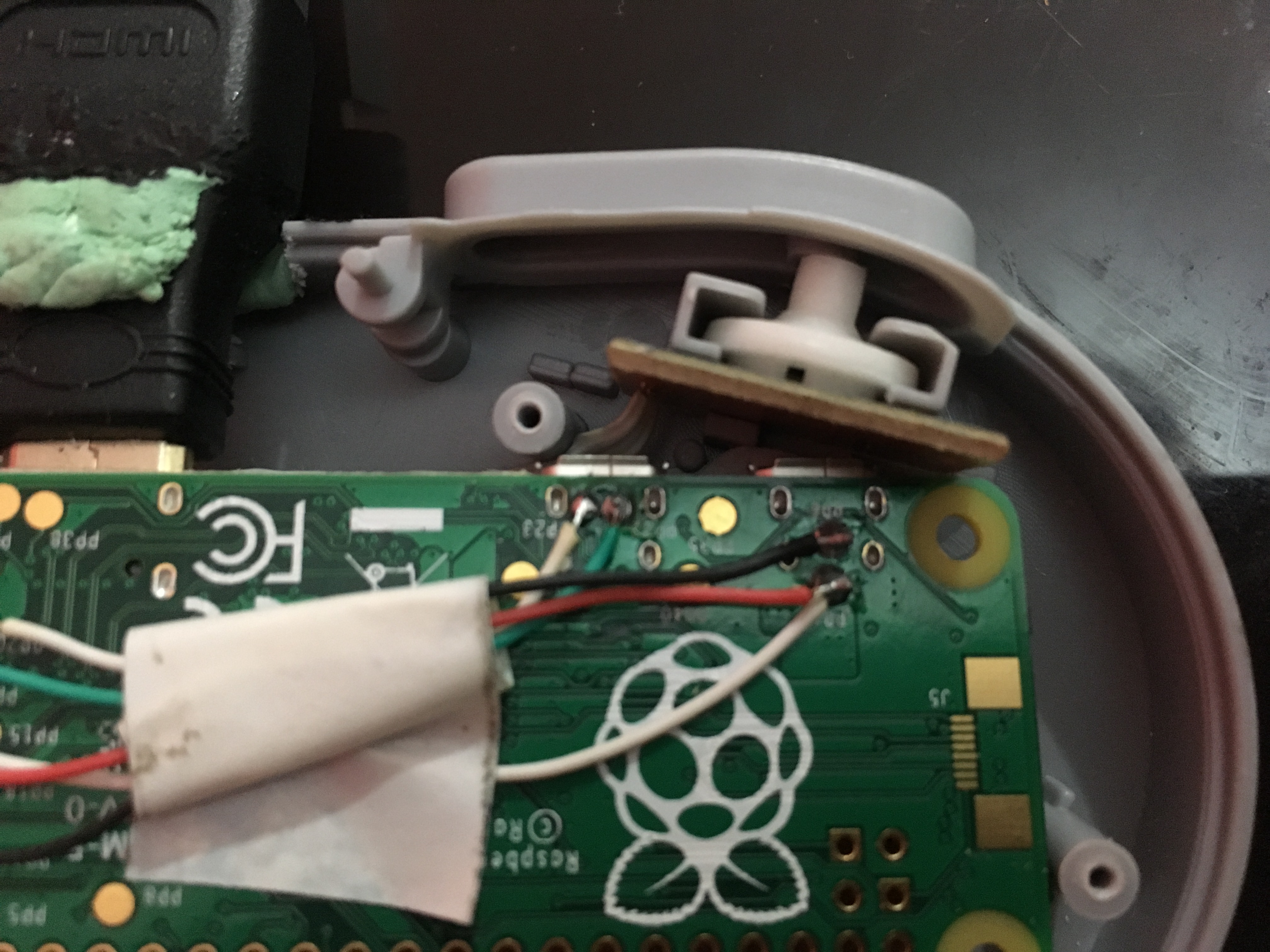

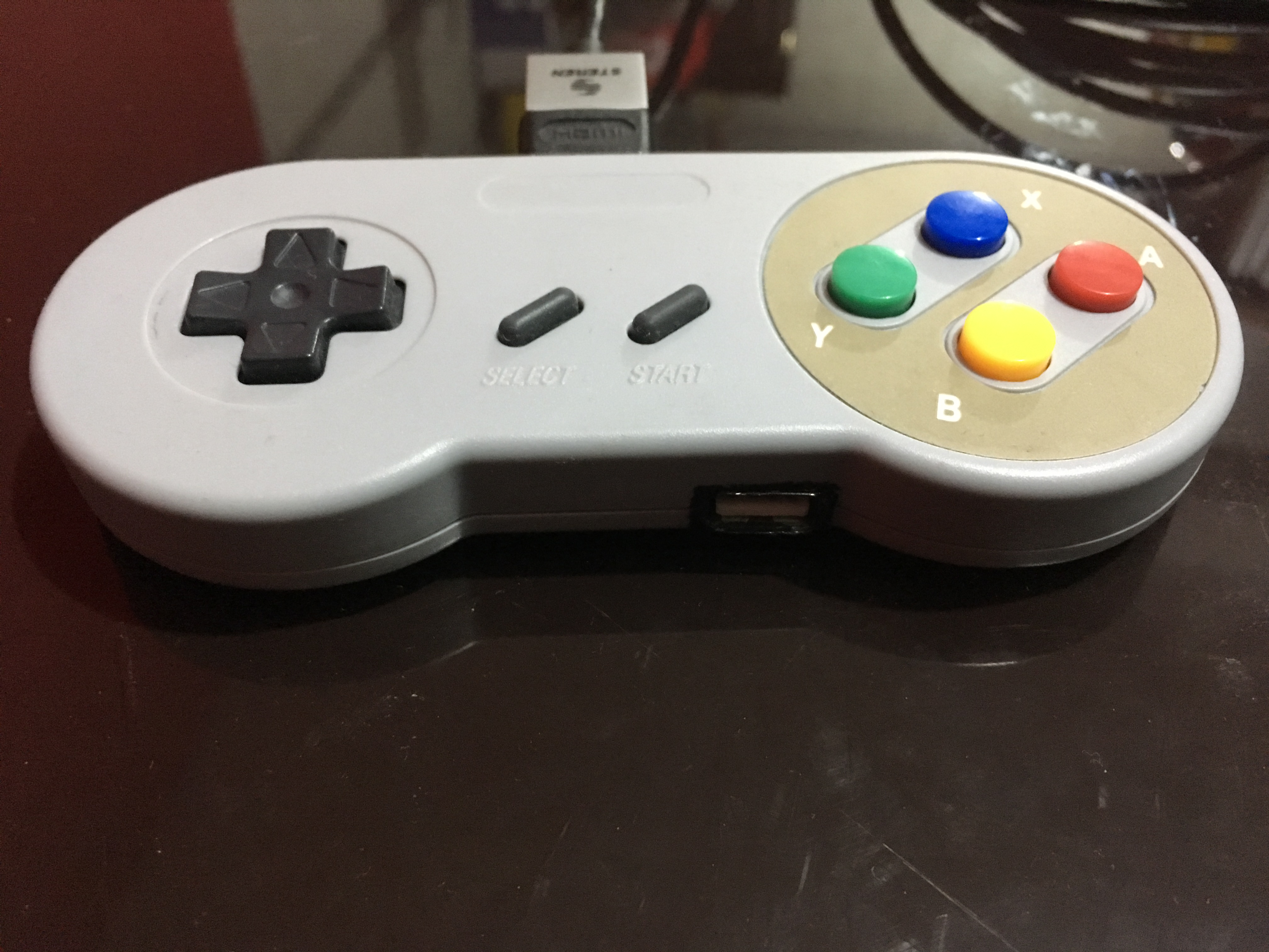

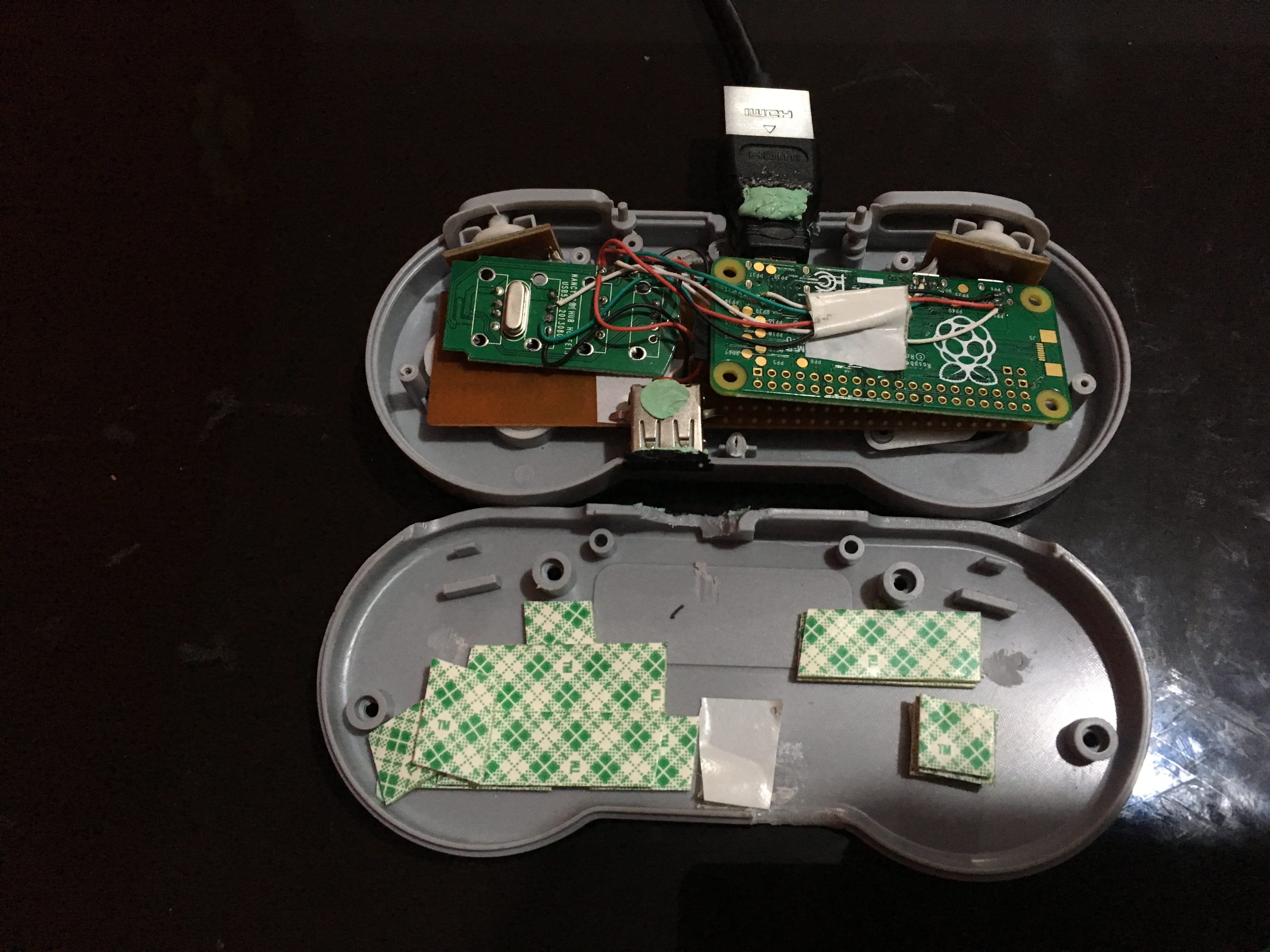

I started by desasembling and desoldering the USB hub, it was a four port type, then i disasembled de USB controller, taked out the usb cable (the four coulored cables were usefull to connect everything), relocated the capacitors, resistors and L/R cables and solder it again on the other side of the PCB, removed the plastic separators , then I cutted the space for the HDMI and USB ports and put the double side tape for give some feedback to the buttons.
The HDMI power inserter had to be open to solder the diode to prevent unesesary voltage in the HDMI out.
The green epoxic plastiline was for repair my poor cutting and the black paint to make it less horrible.
This was my first raspberry proyect and I´m very happy with it, up to two players can play using the USB port (i use a xbox 360 controller) and I can add games by usb or even use a normal keyboard to modify anything if I need.
I also tried to use a PI zero W but the power by the HDMI wasn´t enought, I guess that by removing some services on retropie can work, also use a good HDMI cable, i had three qualities of cable and only the cheapest and the best did the function.
