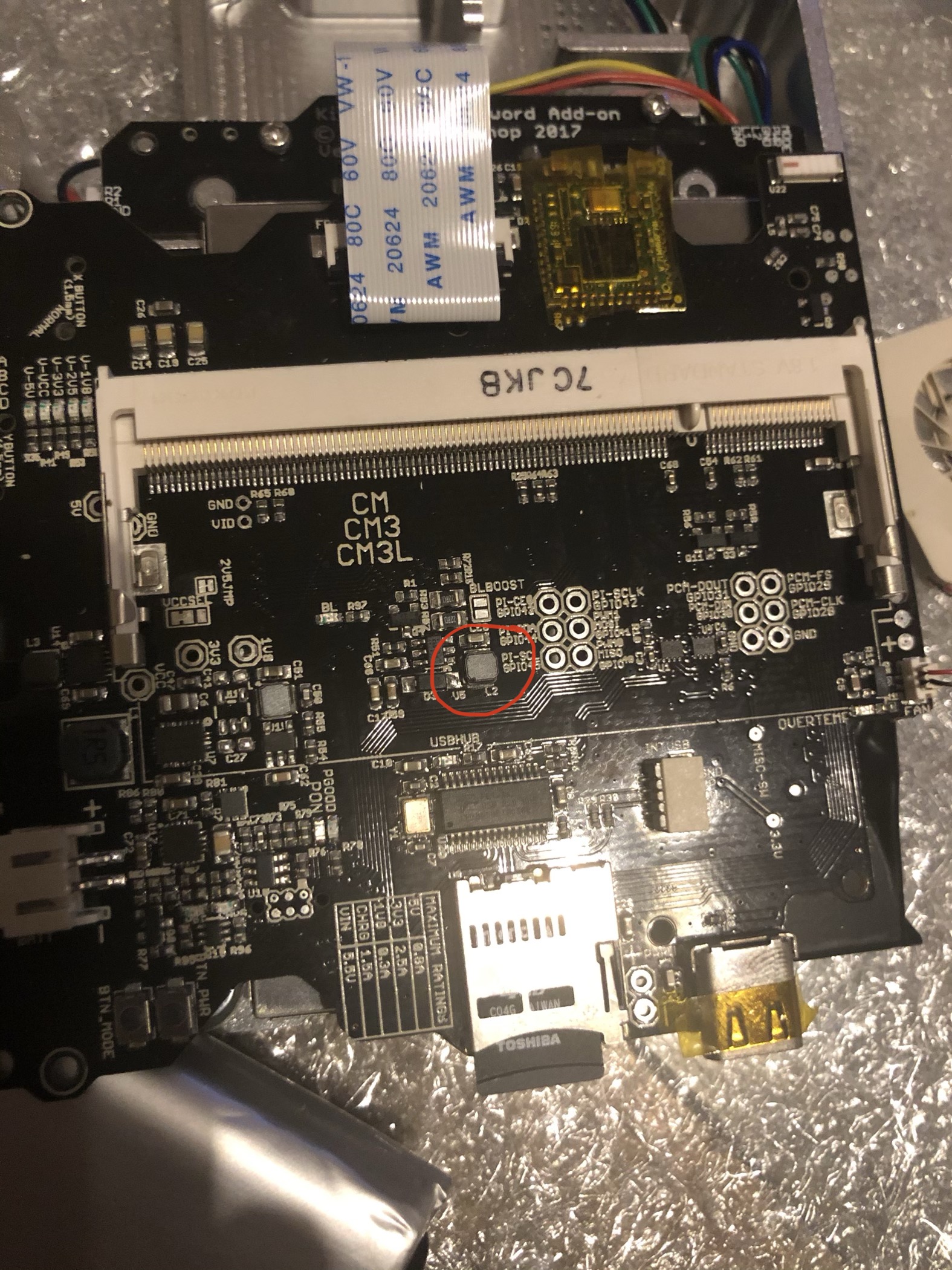

Re: LCD blinking
I just tried turning it on with the battery and the CM3 board removed.
Unfortunately, the screen keeps blinking (it appears gray, blinking ...)
And indeed, under the CM3, there is a chip (or several, I don't know) in the "L2" area that is really hot...
