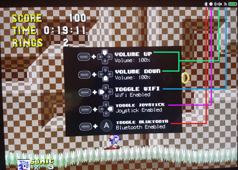

and just wait a few weeks and the next batch of Kite Circuit Swords will start to be delivered to the pre-orderers...
just from the several previous pre-orders
the are gonna be a lot of people that orders these months ago, but will now put them up For Sale...
either because they've
Lost interest....
Have more important things to get on with (or dont have the time)....
would like to release the money tied up in it (maybe a bit of buyers remorse)
what ever you intend to build...
is gonna cost about the same, if not more as your getting somethings that can be done a lot cheaper
and more importantly
isnt gonna have the functionally or performance
as one of Kite Circuit Swords
(and as the case your getting is ones that's been butcher (IMHO)... IMHO that's not style)
The CSO has better....
Screen
Performance (Pi3 capabilities)
Functions (Safe Shutdown, Battery monitor, HDMI out.... just to name a few)
and its a complete AIO
(can be put in a Clear Case for that extra "Style")
just throwing it out there....
but if I was a "man of style", I'd know what I'd go for.....
Lost interest....
Screen
