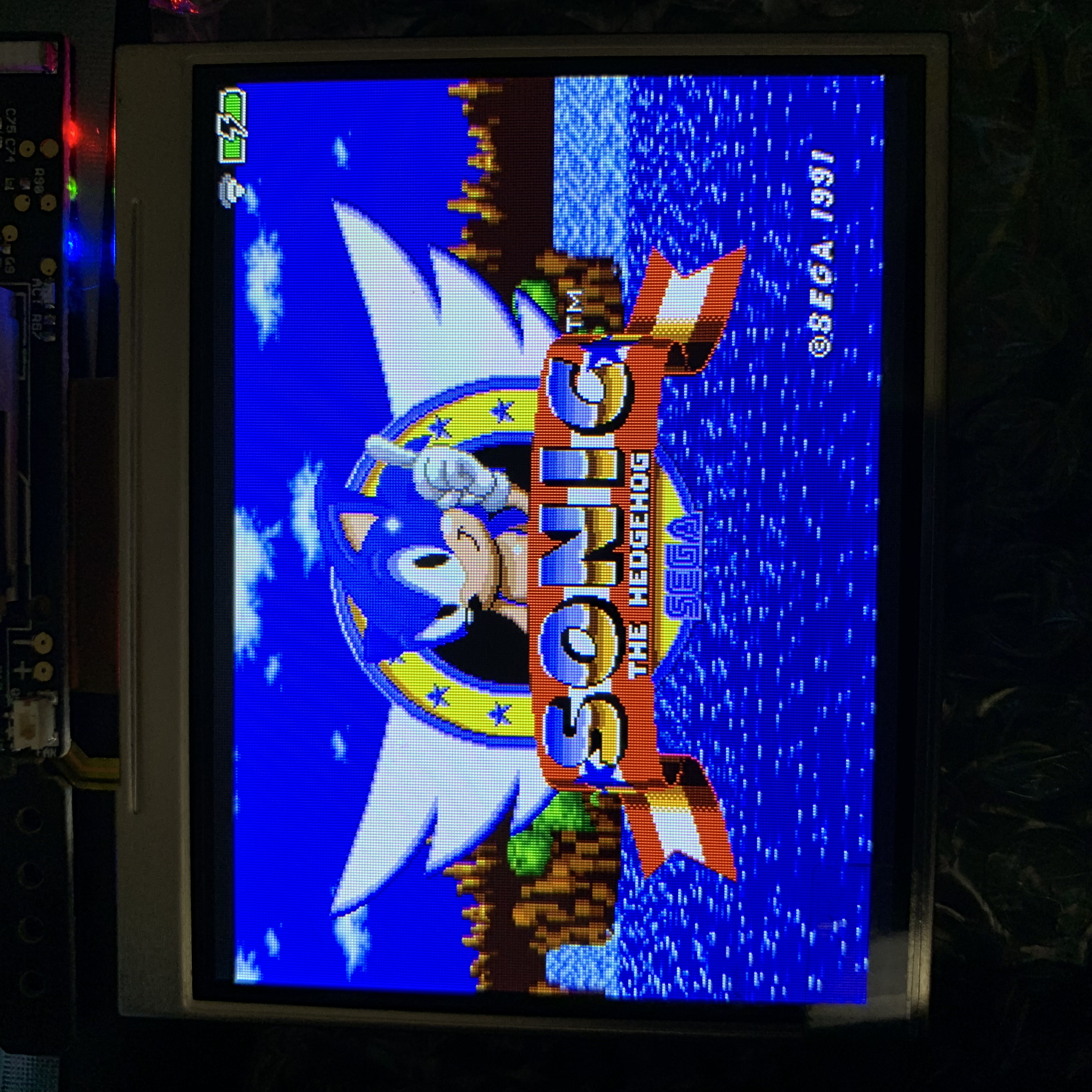

If you’re talking about the 320 screen from Kites build then it’s definitely easy to look at - compared to my other VGA version it’s super clear and text is nice to read too.

Thanks for the photo - looks razor sharp!
Is it just me, or does the screen have a blueish tint to it? I've noticed it on other pictures here, but maybe it's more down to the cameras taking the photos than the screen, or what do you think?

Post by BenOfTheNorth » Tue Feb 19, 2019 3:27 pm
I’ve not noticed a tint myself - might well be down to cameras
