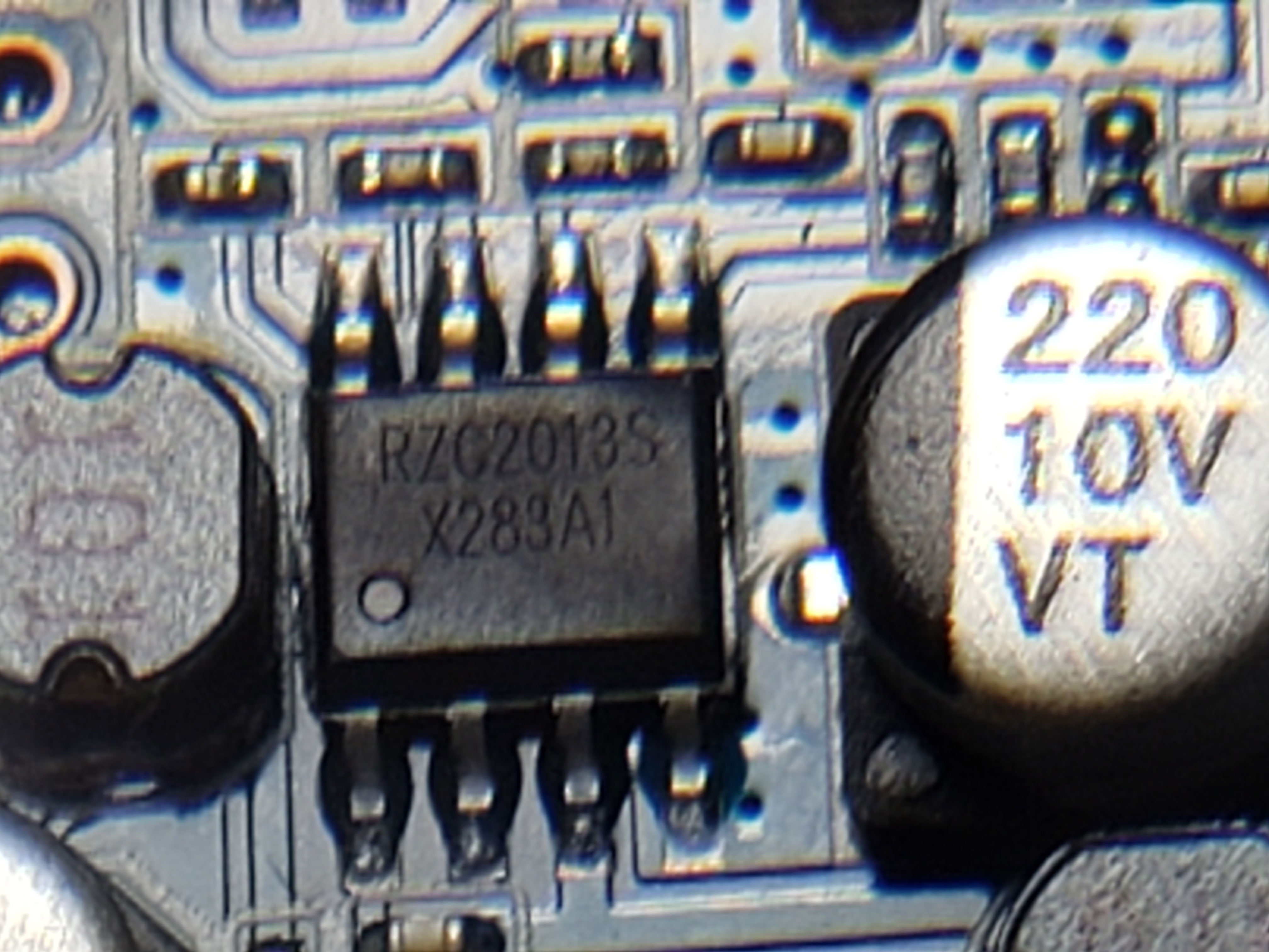

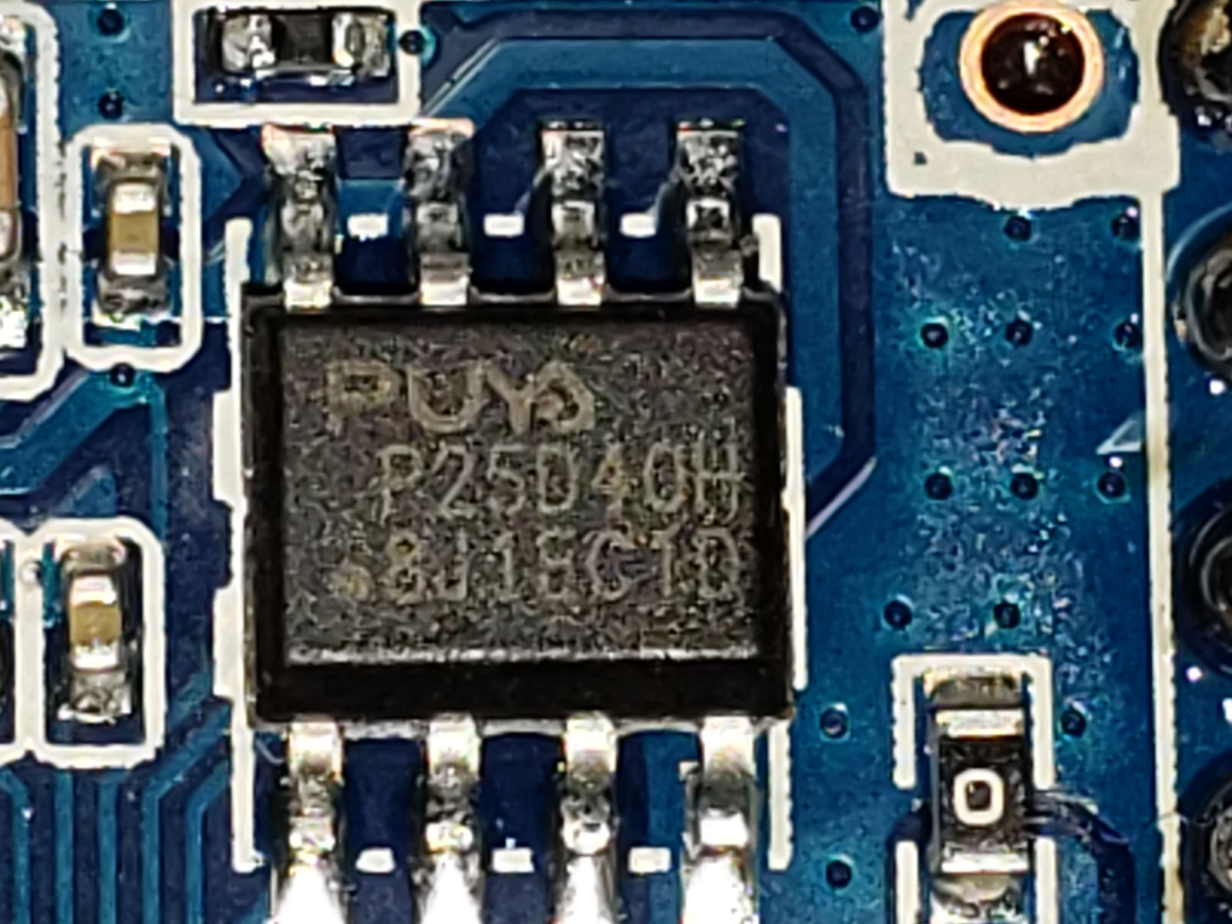

I'm working on my first GBZ project and I got my screen in today. I bought the recommended Amazon screen. BW brand. However I can't find the variation on the Wiki. I even checked the numbers on the chip and I don't see anything similar. PLEASE SEND HELP!
I think I need to do the 5v mod on one of these two chips.
RZC2013S
X283A1
P25D40H
8J1EC1D

PIN3 on the RZC2013S
SW
Power Switching Output. SW is the switching node that supplies
power to the output. Connect the output LC filter from SW to the
output load.
So wire vcc to pin3 (3rd on the bottom from left to right on your picture)

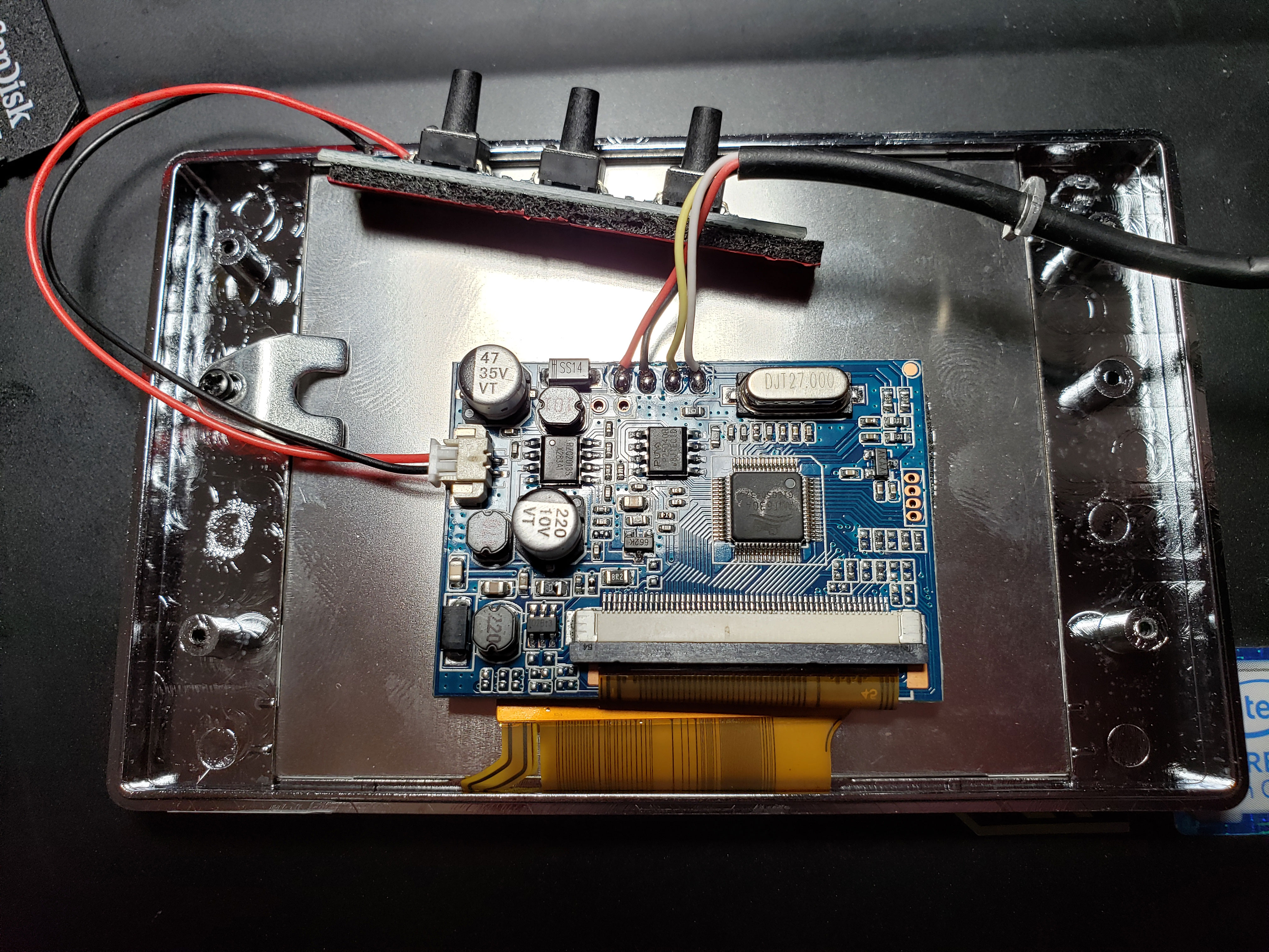

I have the same version. Desolder the power (red) from where it is and resolder onto that chip, as correia5022 said. It will work, but be careful since it is such a small area to solder. also, once it's on there really nail it down with hot glue, otherwise it can twist around and pull off the pad (see my post above "Toasted driver board") Major sad face.

Here is a picture to help. I don't think you need to remove the chip. I was having some issues that I believe ended up being improper grounding, but had removed the chip by then.

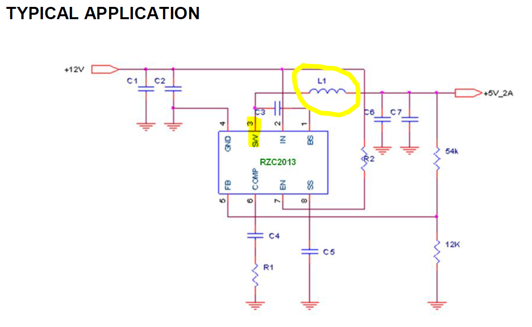

Actually, I would recommend to perform the 5V mod by soldering to the inductor pad, as shown in my picture:
Reason:
The inductor is in series with pin 3 of the IC an therefore creates a high impedance on the power supply line of the screen. Depending on the rest of your power network, that could cause unstable power supply for the screen. In my case the picture was flickering and the screen regularly shut down. Now it works like a charm ;)
