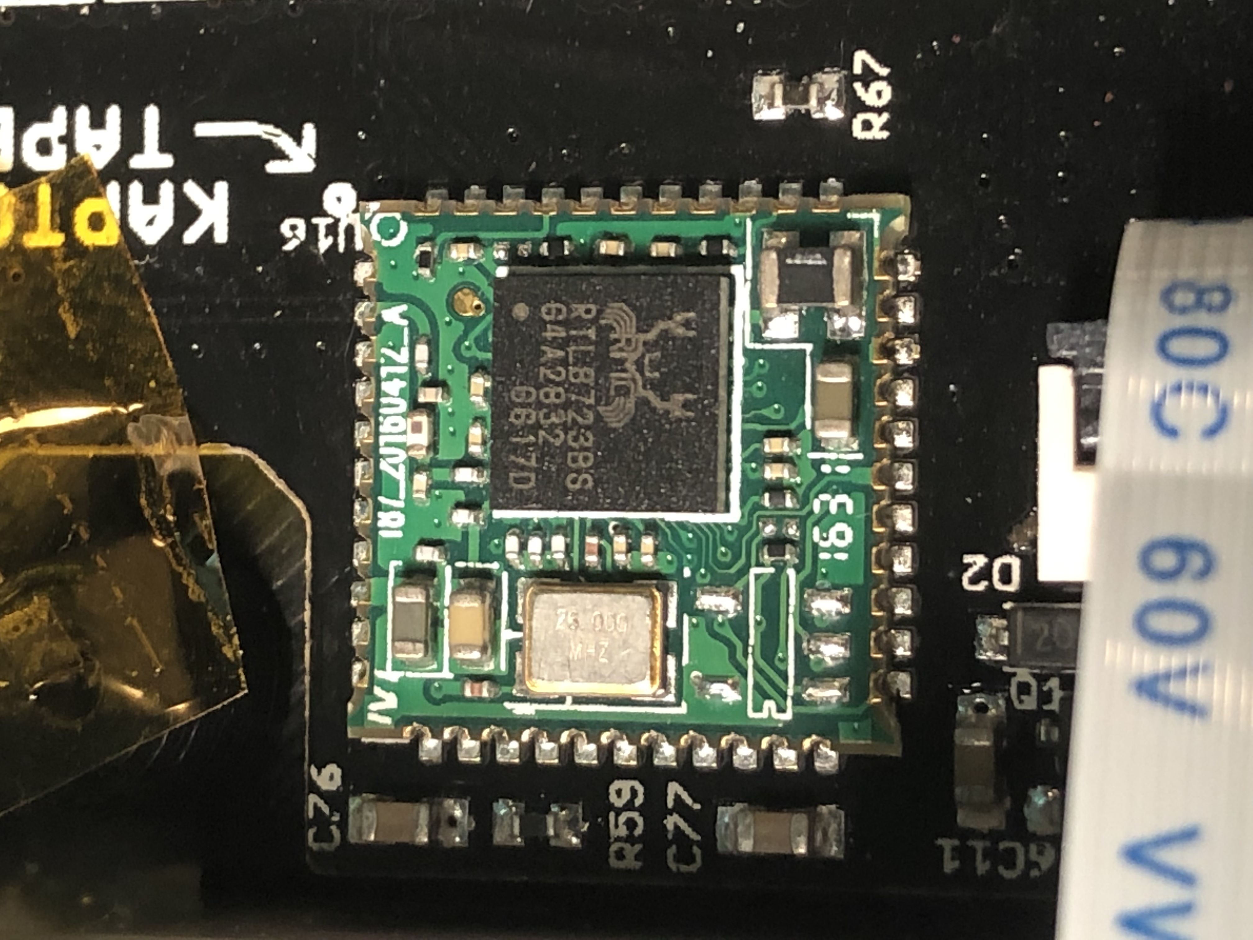

You've built a few by the sounds of it so this likely isn't the cause but it's worth me asking anyway: does this exact behaviour still happen when 'not inside a case' and the halves of the board are apart from each other?
Could you remove the kapton tape from the module and have a poke at the larger components, are any cracked/loose/broken? If anything breaks it's usually the largest capacitor nearest to the FPC connector (although these wifi modules seem to change design each time i order them!).

Second question: I have had other boards that when closed had WiFi issues due to solder joints from the back board shorting the WiFi chip. (Sometimes even though kapton which is why you suggest multiple layers) But no, problem persists open or closed.
Question 3. Components look ok. I have attached an up close shot of the chip for you to see

Ok cool, I had the same conclusion with the person via email and the exact things happened (100% stock image without configuring wifi would switch between X and ! on reboots).
Could you please send me an email referencing this thread and include your full address and I will send you out a replacement main board. Once swapped over and confirmed working you can return the faulty board to me for debug (and I'll pay postage) so i can hopefully work out why it's doing this with both the boards that I'm expecting!
