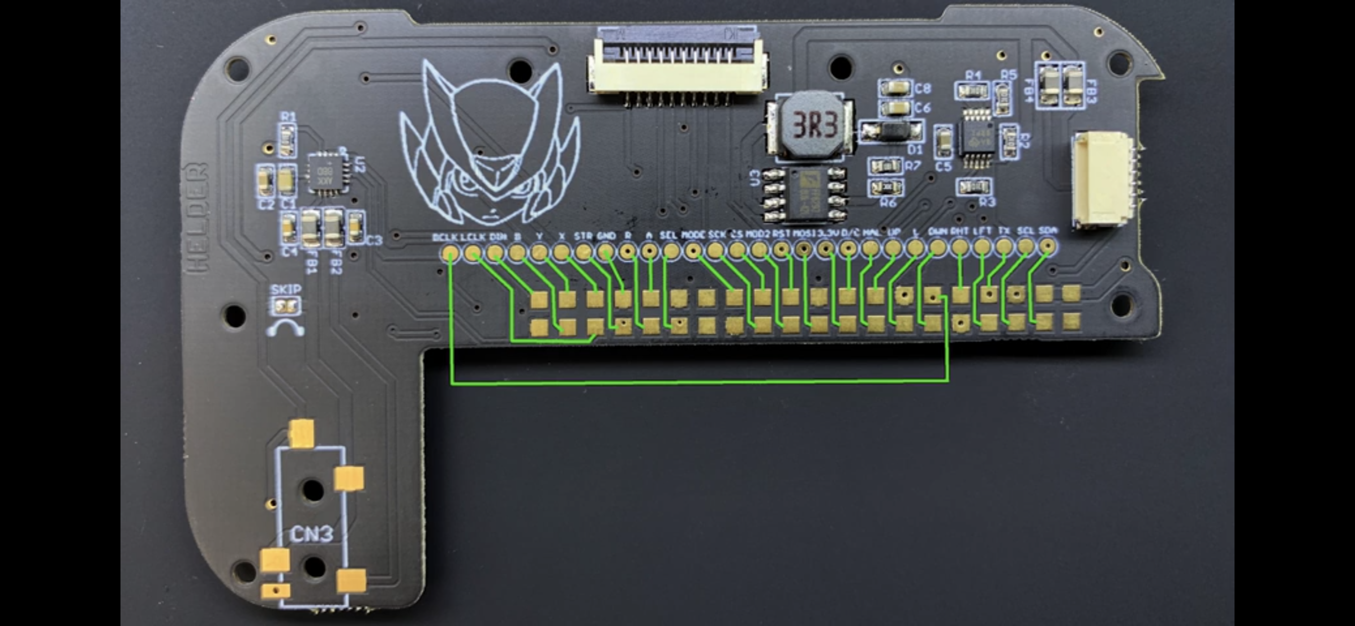

Hello All,
As you probably noticed with the new mintyPi V3 the test pads are in a different location. I wanted to post the map of which test pad goes to which GPIO port on the raspberry pi.
This was a screenshot from Wermy’s YouTube tutorial:
