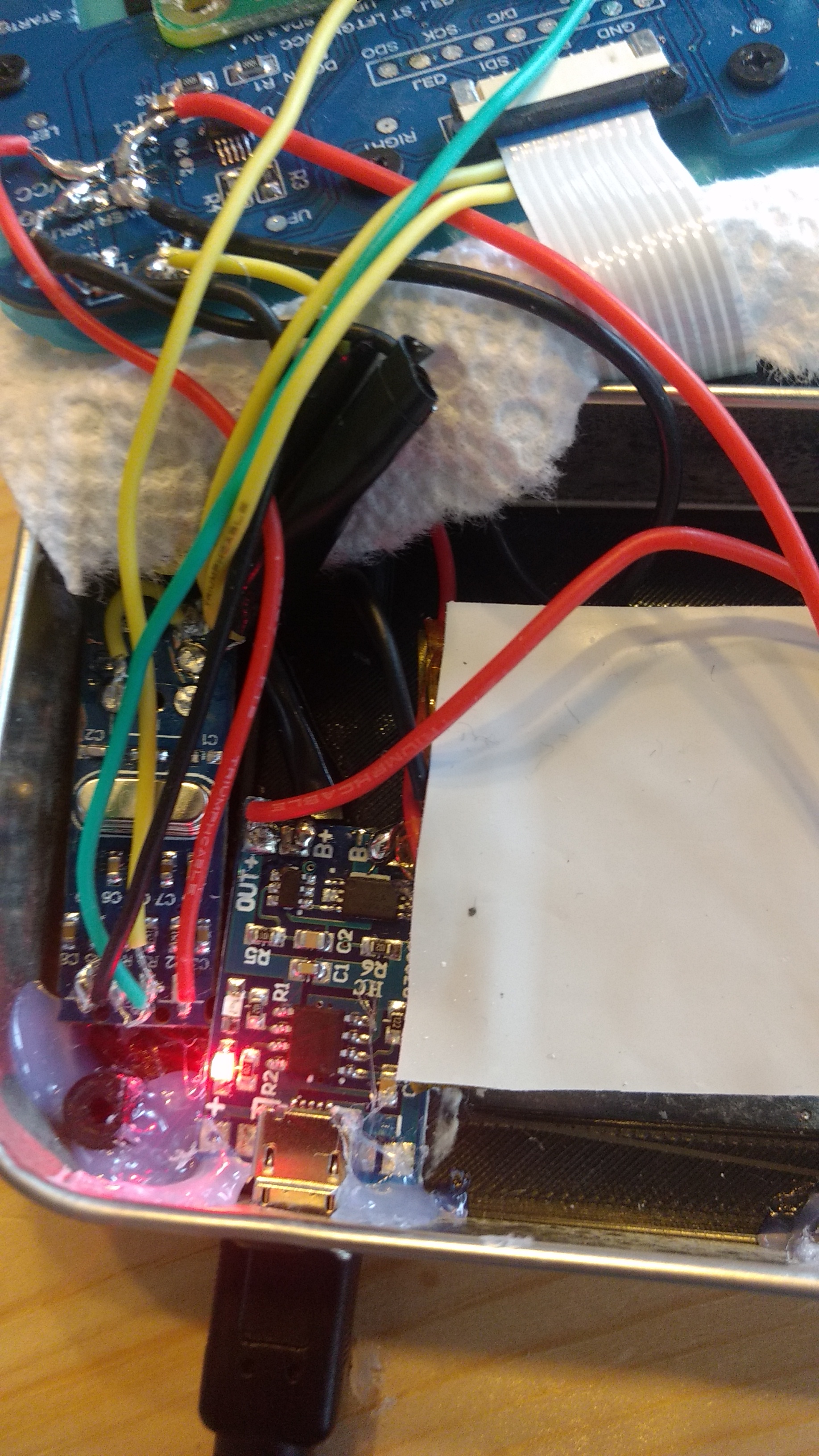

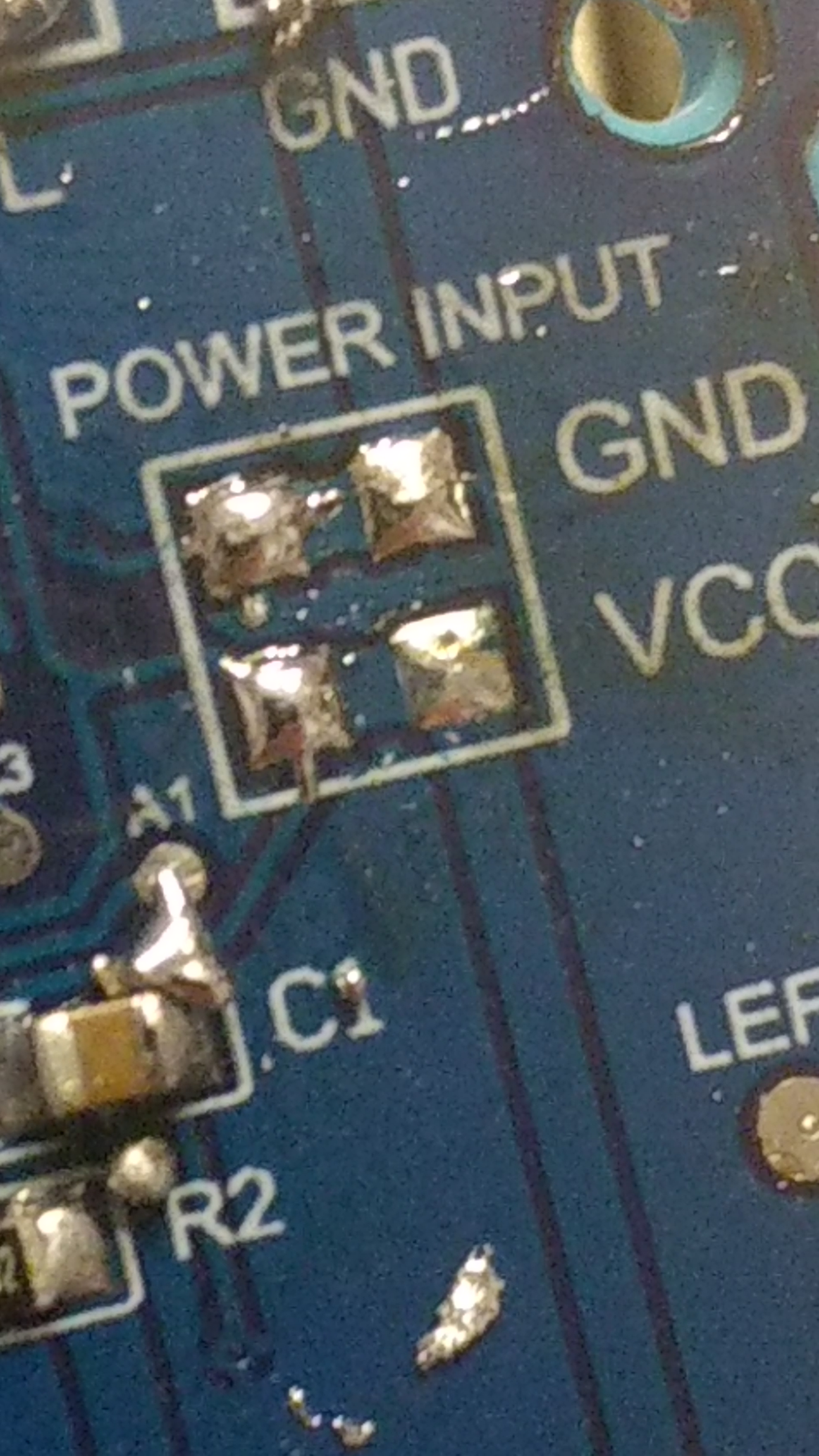

What wires do I solder here?
I don't know what wires I need to solder here. I do know one wire is from the charger, and one is from the power switch, with the other two coming from the sound card. In the videos, there are only two pads, and each has two wires. I need help figuring out which wires go where. Also, my sound card was heating up. I think this is why but I'm not sure.

Re: What wires do I solder here?
You run power from the switch to VCC (OUT+ or B+ from the charger to the switch, then to the board). And ground (OUT- or B-) from the tp4056 charger to GND.
You can use the other VCC and GND to power the sound card. Make sure you have that wired properly. If you reverse it you may destroy the sound card.

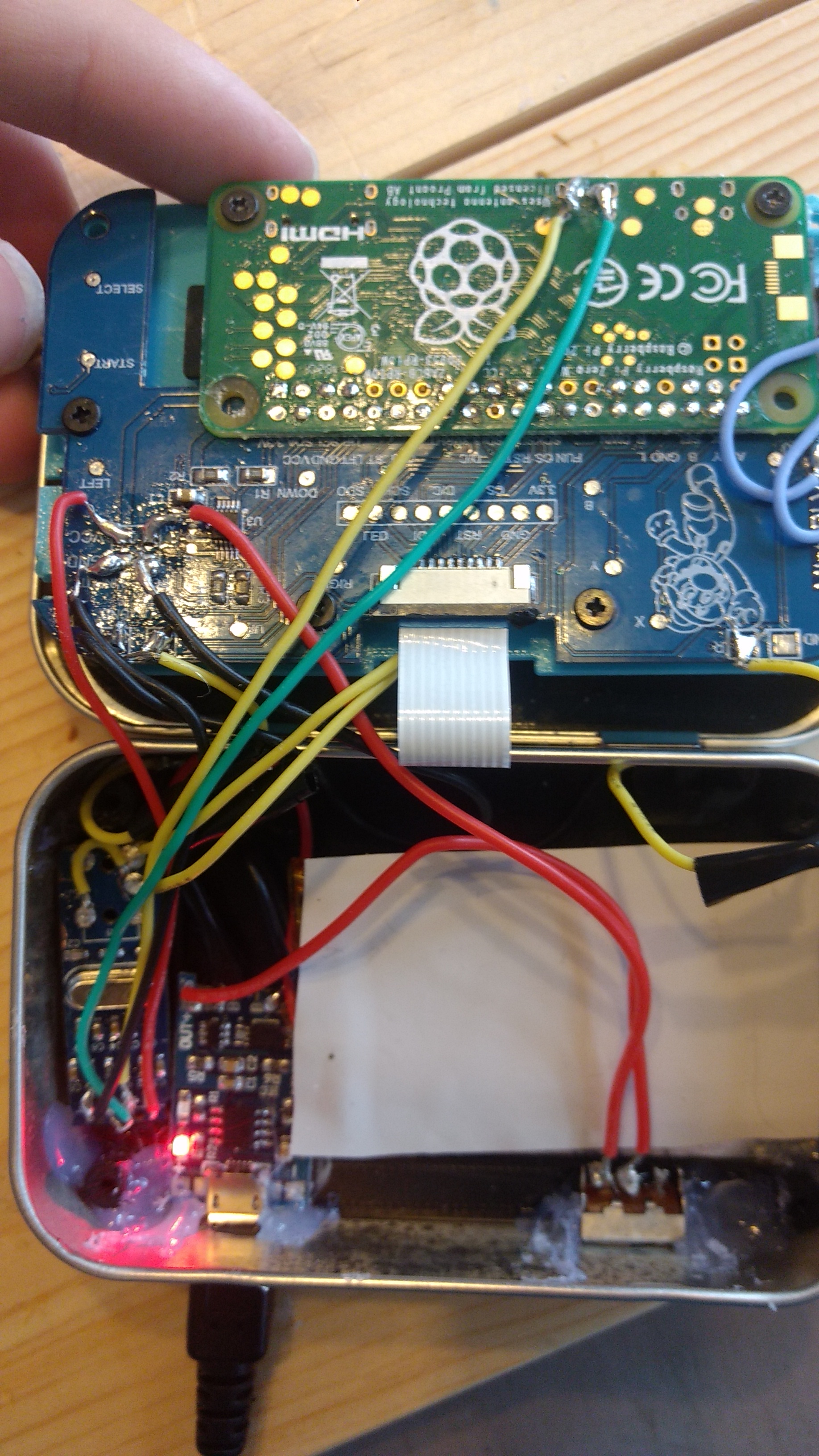

I've put everything together, yet it still doesn't work. It won't even turn on. Any Ideas?
- IMG_20190310_123511055.jpg (2.65 MiB) Viewed 5921 times

Re: What's wrong with my MintyPi?
Gonna be honest. Your soldering on the data pads on the pi looks really bad, and same with all the power connections. Clean those up.
Does the pi boot? Does the pis green status led light up? Does the screen show a white background? Or not power up at all. Need some more info to help.
It wont turn on at all. And for the soldering, I somewhat expected that. This is the first time I've done something like this, and that's about the best I can do.
Yeah. So if the pi isnt booting I can assume it is your soldering. Desolder the power connections from the pcb, and plug the micro USB into the pi. See if it boots?
