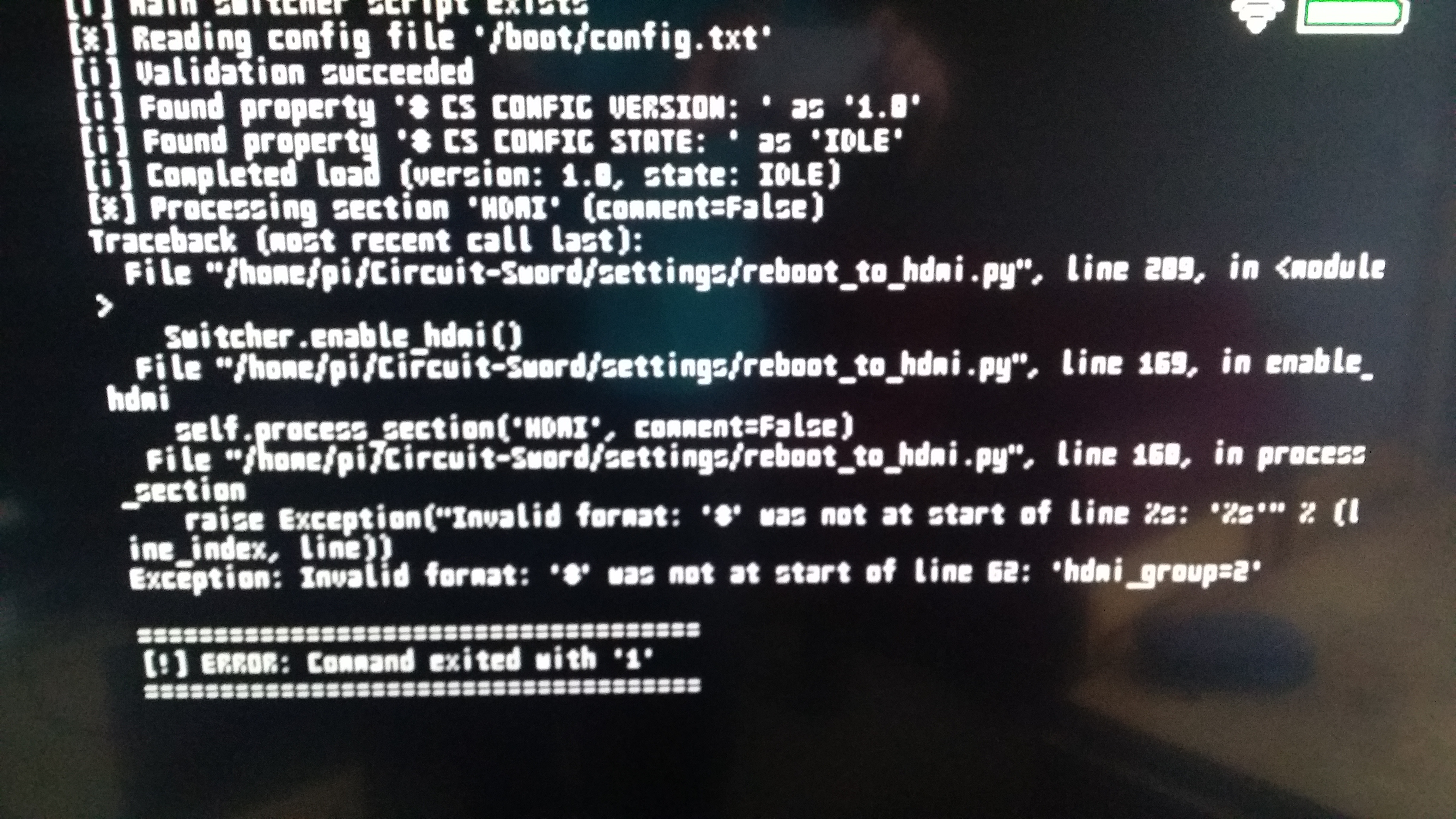

My Circuit Sword Game-boy works fine and i' m very happy with it.
Yesterday i would try to play on the TV using the HDMI output.
I would play on the TV in 1080p but when i plug the HDMI cable to the TV i think the output video is 640x480.
Using the "one time reboot to HDMI" command in retropie, It looks like there is a problem:
Any solutions or, do i use the wrong method ?
Thank you !

Did you edit the config.txt file? Can you upload it here please

Yes i have edit the config.txt file because my first time plug with hdmi to TV was' not a success.
My config.txt:

of course i would like a 1920x1080 display ...

Hi, read that 'NOTICE' at the top of the file, you have broken it by removing the # symbols from HDMI config..
See here for the original: https://github.com/kiteretro/Circuit-Sw ... config.txt
Basically, if you have "#" in front of the line, it will get enabled when you do "one time reboot to HDMI"
If you have "##" (two hashes) in front of the line, it will NOT get enabled when you do "one time reboot to HDMI".
You have instead removed all the hashes.. if you want 1080p, then add a # to the lines you don't want and remove ONE # for the 1080P lines..
Does that make sense? It's slightly confusing, but what happens is when you do "one time reboot to HDMI" it goes through the HDMI section and REMOVES 1x # for EVERY line.. hence why the above logic works
Specifically, you should not have:
hdmi_group=2
hdmi_mode=4
instead:
#hdmi_group=2
#hdmi_mode=4
and then also change:
### Set HDMI output to 1920x1080 (1080p)
##hdmi_group=1
##hdmi_mode=16
to:
#hdmi_group=1
#hdmi_mode=16
To enable 1080p

stevieboy84 wrote:
Mon Mar 18, 2019 12:06 pm
@kite in that last code block you didn't remove the comments completely. Was that intentional?
Yes i did, see how it changed from "##" to "#" for certain lines, that is how it's meant to be if you read my complete description of how it works (and why the difference between "#" and "##" is important)

hi,
thank you for the explanation ! sure that i wanted black and i wrote white and vice et versa in the config.txt.
Ok now i' ll try to re edit it with correct arguments... and also try to speak english a little better ;-)
You understand me and it is already good !
