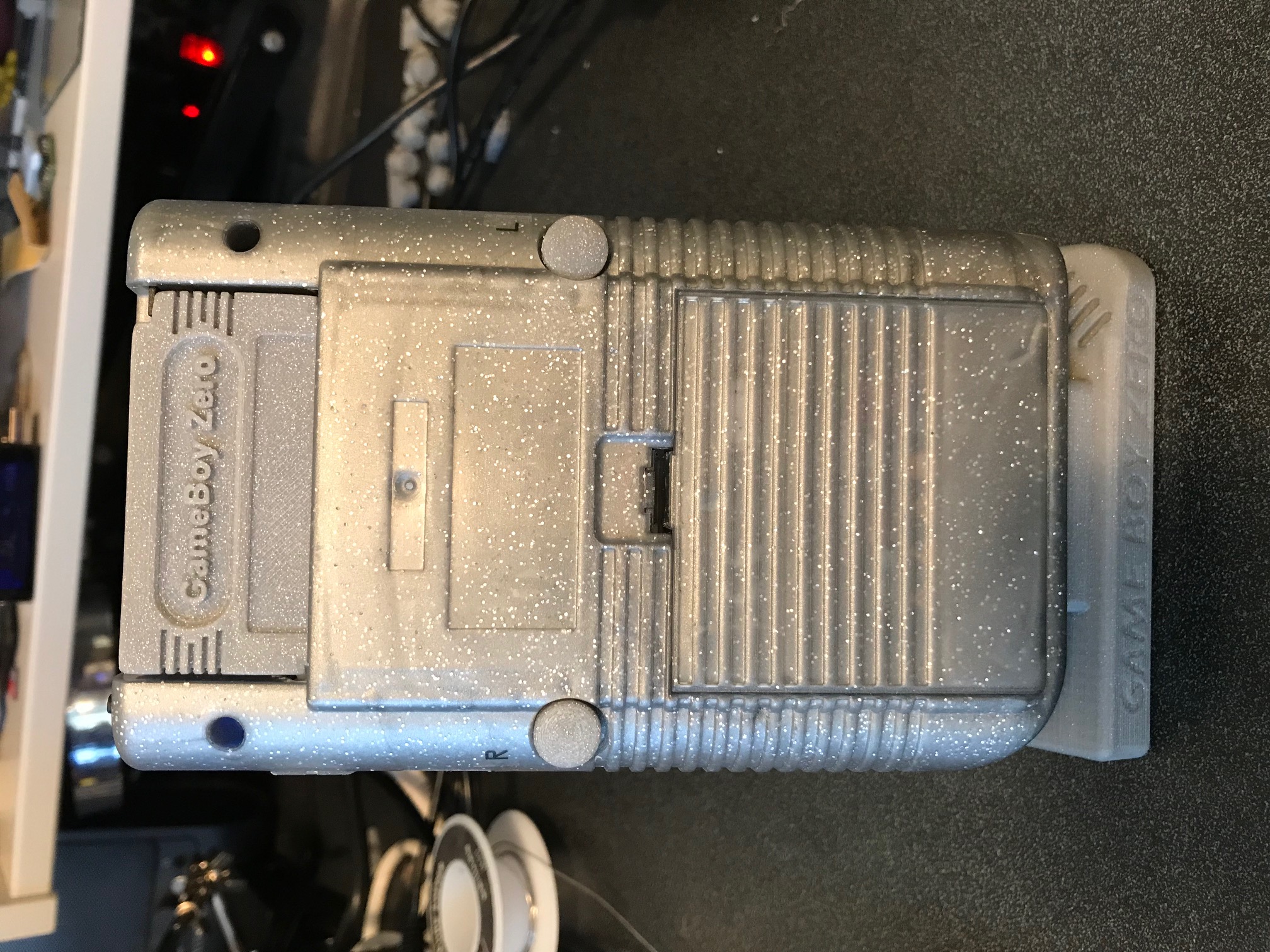

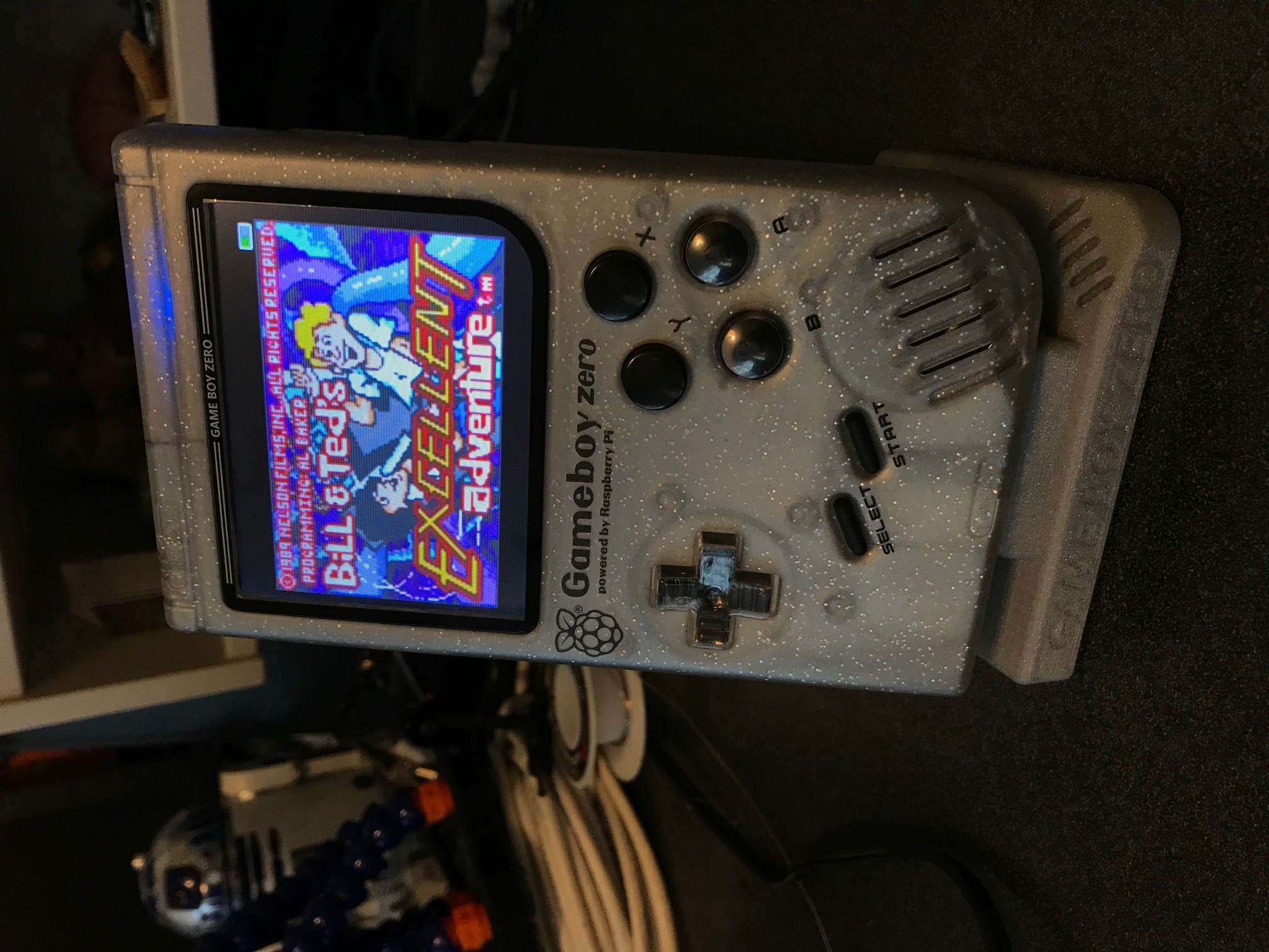

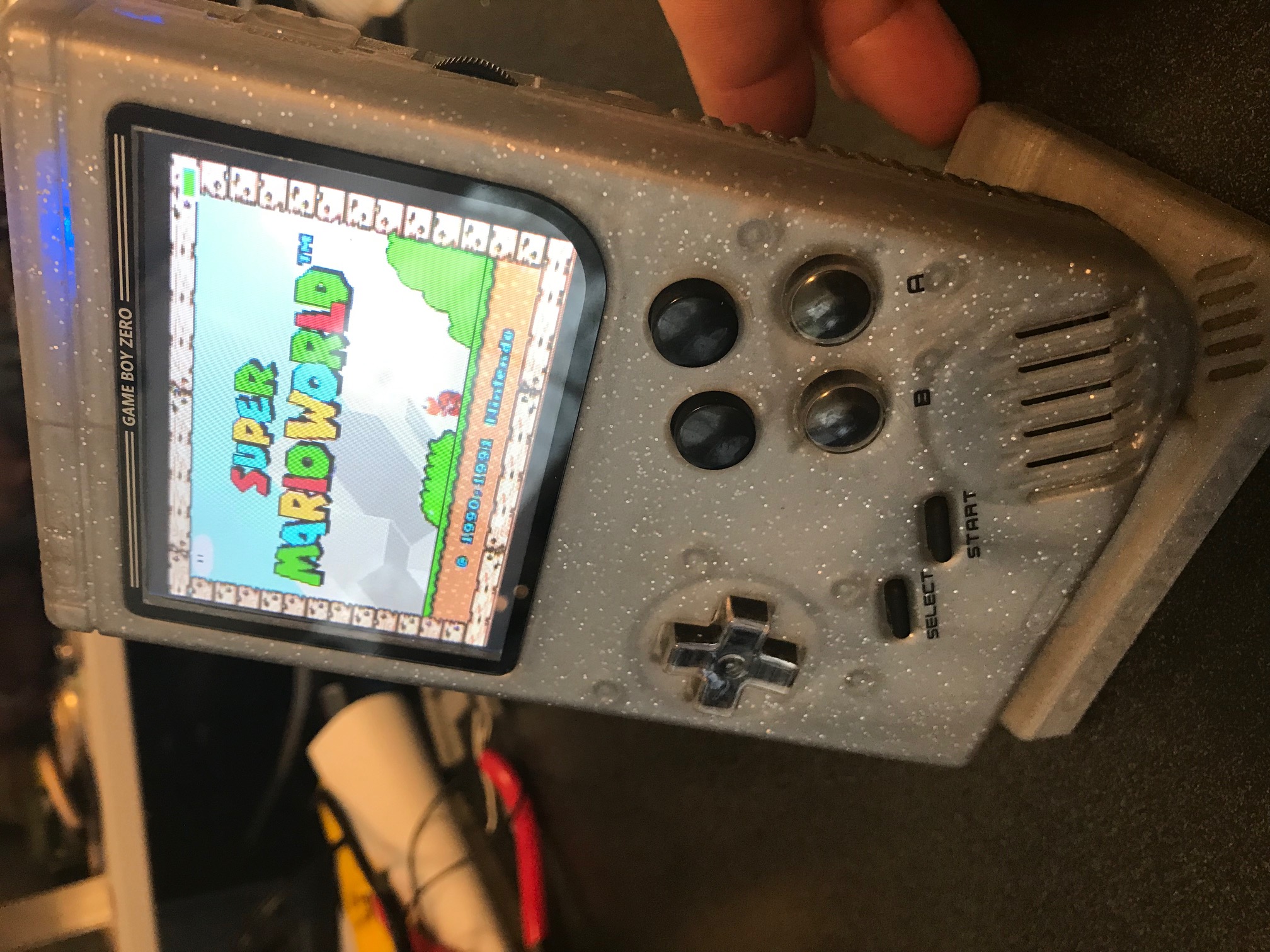

This is almost, not quite, done, but I think it's in a show-off-able place, and I wanted to share these buttons that I made, because I think they turned out pretty neat, especially for my first-ish 3d design (not counting a few super simple brackets and stuff). They are definitely my favorite shoulder buttons I've done yet, hands-down.

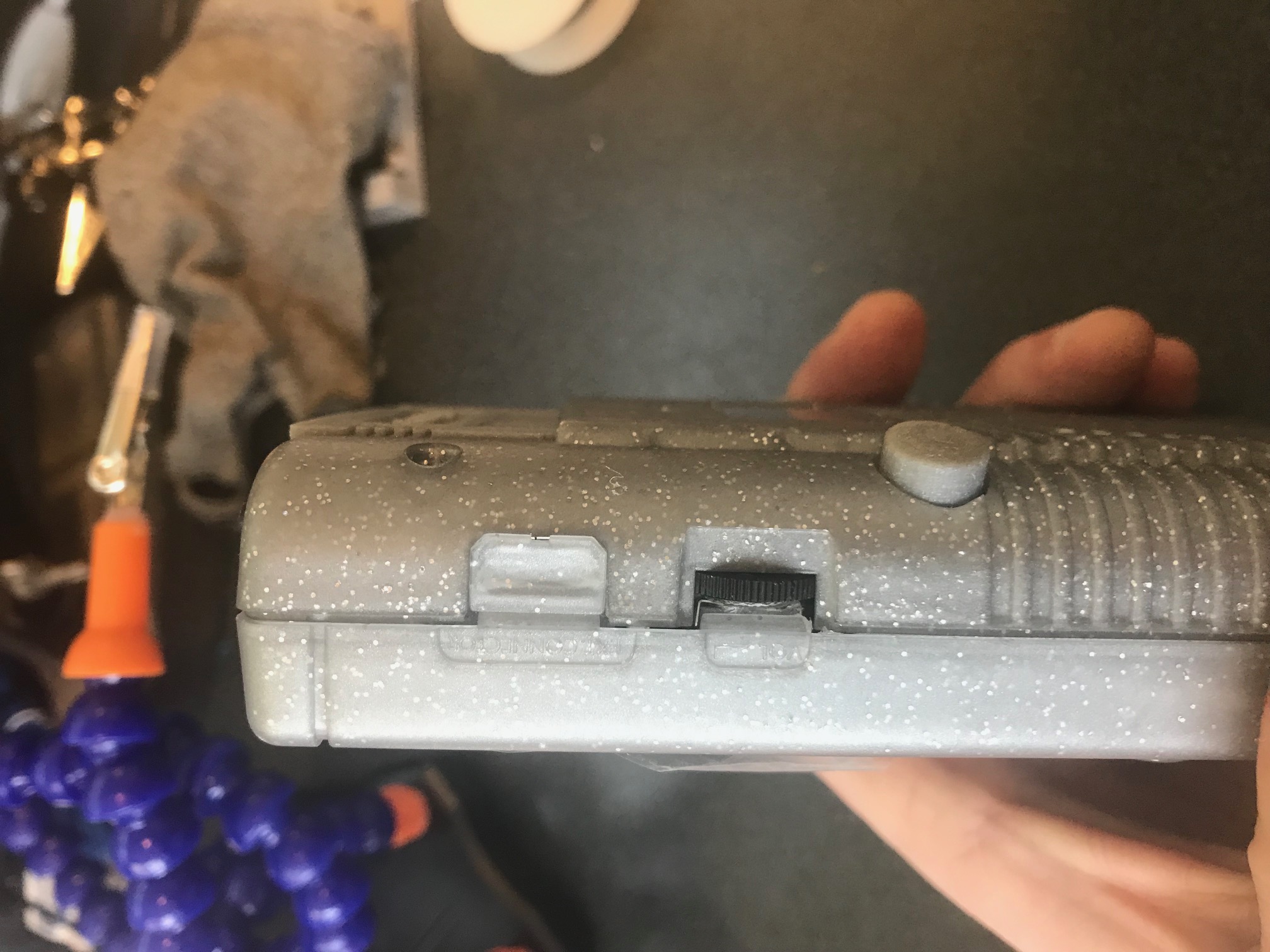

I did two custom builds that I had to shelve because I couldn't fit the case together in the end, and end up breaking connections loose and generally messing them up trying to get the case together, so I wanted to do one I thought I had a reasonable chance having enough space in. So, all-in-one it is, but I still had to "challenge" myself so decided to make some rear buttons to go with the soft-tactile buttons mounted on the screen bracket. I gotta say, they feel incredible, so I'll share my stl file if anyone else wants to go this route. I originally was going to design a button well instead for the original dmg style, but went this way with a solid button and using the pegs in the case as a guide.
the buttons sit straight, and don't protrude past the case, so you can set the gameboy down without hitting the buttons. The basically feel like dmg buttons, I think. I gave mine a light sanding and coated in clear coat, and they feel super nice. I just used the original screw holes as guides, and a step-up hole drill to get to the same diamter as the dmg buttons.

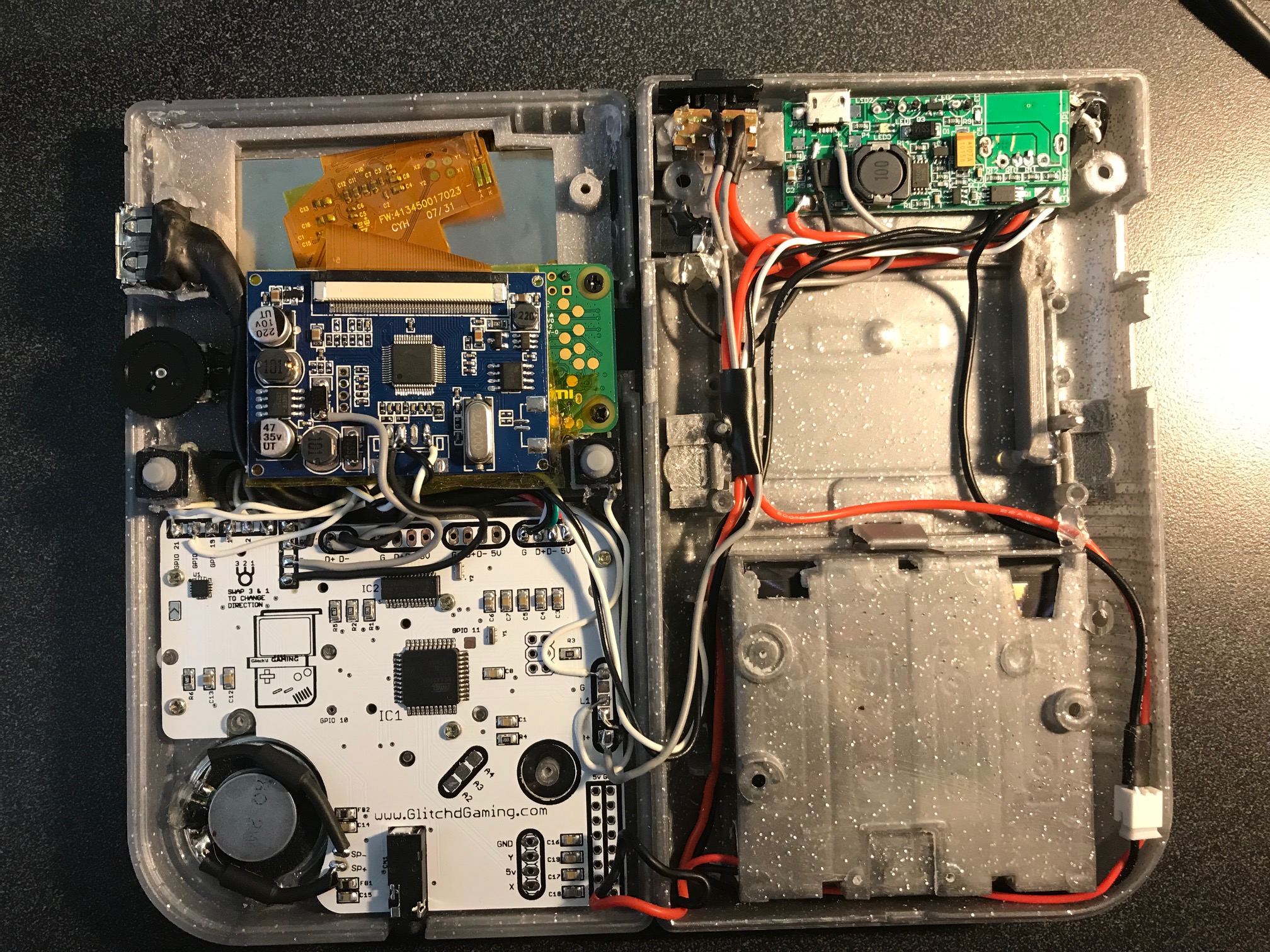

here is the build - i did have some extra leds in this first pic, in the cart, but i removed them since the one built onto the power supply looked good just shining through the case, once I had it together. these are also early version of the buttons
opened upShow

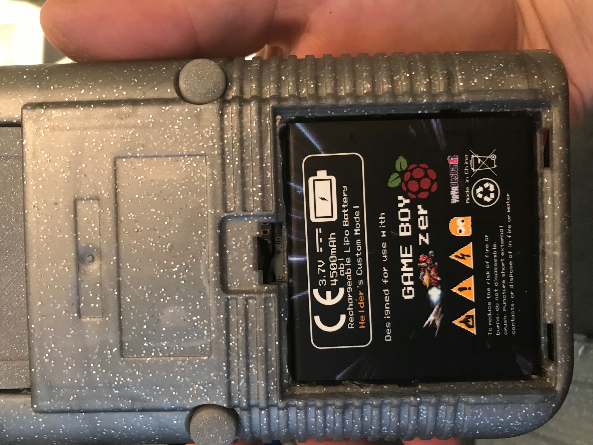

helder's 4500mah battery

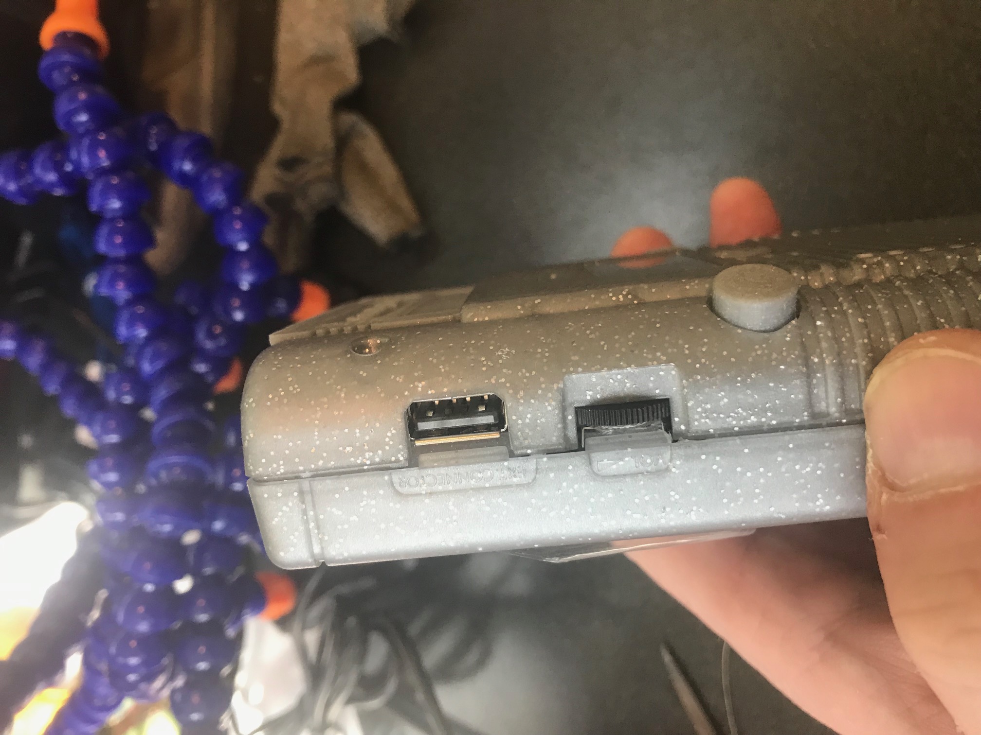

i used the original external connector cover, and clipped the tabs a bit to fit a usb port.
more pics:
side stuff (rear buttons in these are early, not final)Show

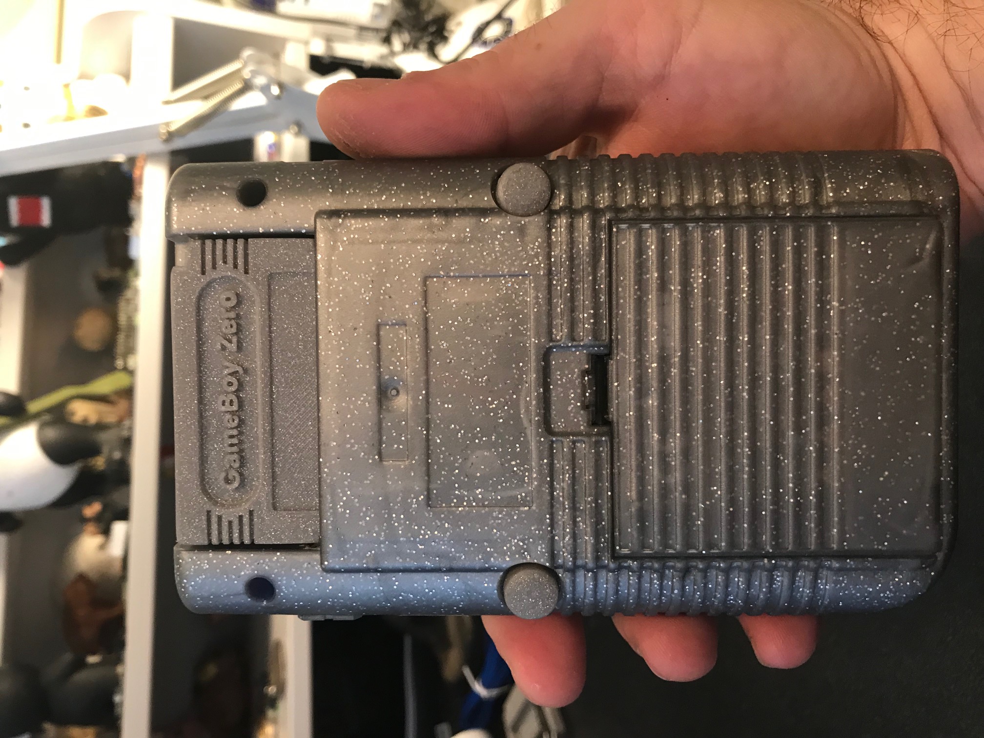

back of the caseShow

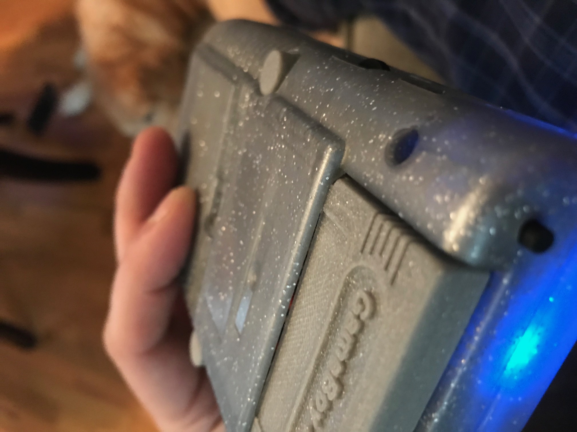

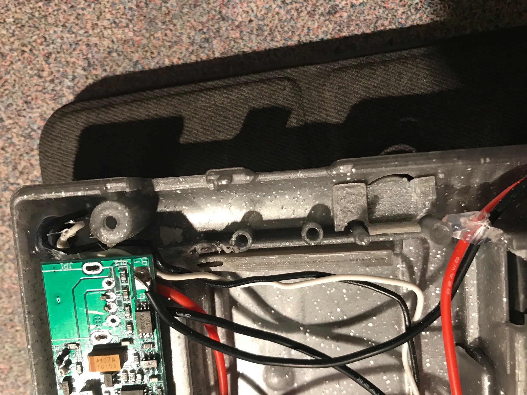

buttons from the inside / rearShow
batteryShow
For some reason that I haven't discovered, the audio isn't working yet on this build, so that might suck to figure out. I also just got some waterslide decals that I am going to start messing with, and hopefully I can add an "x" and "y" on here along with a couple other embellishments, however, in order not to ruin this one, I need to do a little practice first since I have not used those decals yet, but they sure do look good from what I have seen. I'm also still tweaking a custom splashscreen to match the sparkle and make it really personal.

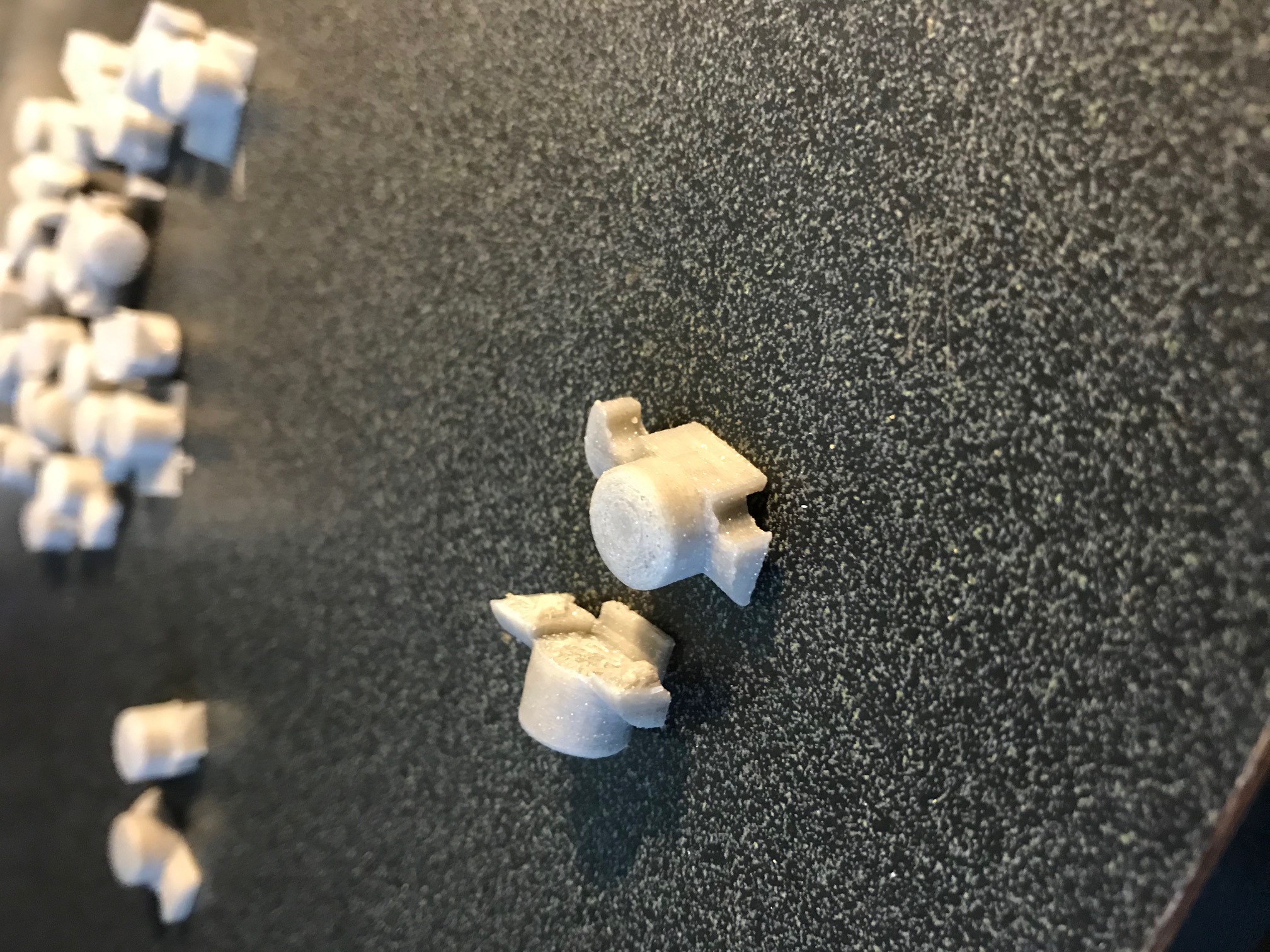

updated the button design a bit for better stability:
soft shoulder well buttons w guides.stl
(184.85 KiB) Downloaded 858 times

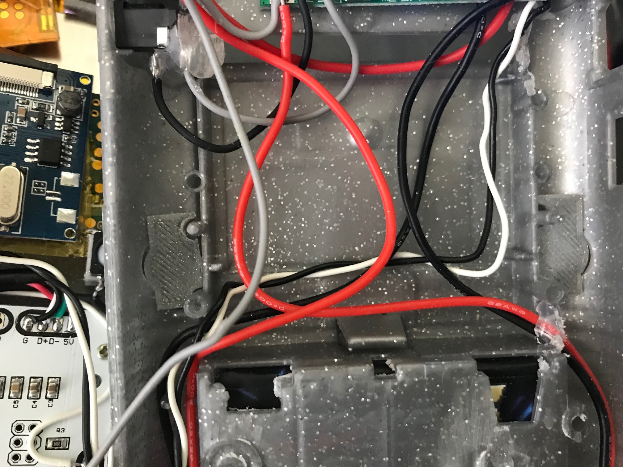

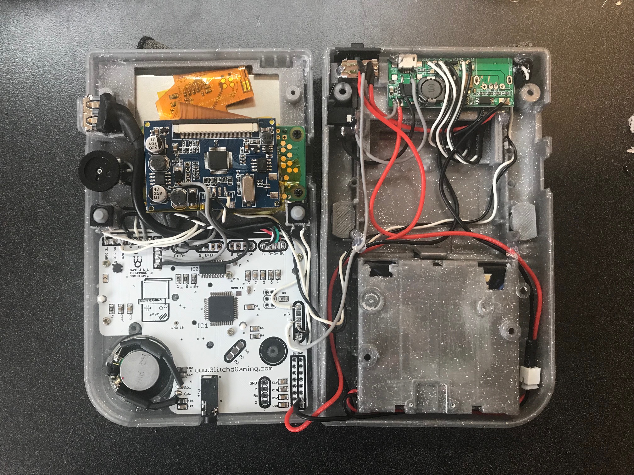

Here's the final inside layout, with everything working (great!) and most of the waterslide decals I was going to put on there. I have one more i want to put on the back, but I'm going to have to do the drawing for what I want there, so maybe this weekend.
all in all I really like this guy. The sparkly thing isn't really my style preference - it was a request from my wife - but it was pretty fun, and I really love how these shoulder buttons turned out. With the soft tactile buttons, they feel just like real gameboy buttons, with really satisfying action. Next I think I'll adapt the design to snap in dmg buttons for one of the custom builds I need to rework to get to fit.
backShow
opened up, inside - tidy, minimal hot glueShow
back of the buttonShow
