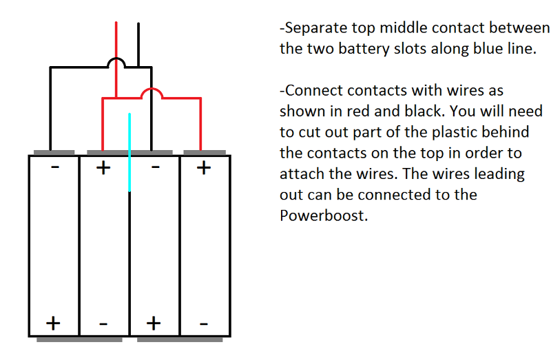

You would have to modify the battery bay if you use the powerboost either way. The contacts put all the batteries in series, which would create a 6V power source at whatever current the batteries are. That's too much for the powerboost, which expects 3-4V. I imagine you could take the top middle contact out and then drill a couple of holes into the the plastic that the contact was covering. You would then have to separate the middle contact. You could then connect the contacts along the top only (positive to positive with a wire leading out and negative to negative with a wire leading out). The wires leading out of the contacts could then go straight into the powerboost. You can do this with 2 (2 on the left or 2 on the right) or 4 batteries. That would give you a battery pack of 3V. The batteries may not last as long as the rechargeable options and you would have to modify the battery contacts in the battery bay to do this.

Post by Quatrerwin » Wed Jun 29, 2016 6:28 pm
The battery mod as I pictured it would be something like

That all makes sense and I think I'll do that split so it'll be 2 sets of AAs running at 3v.

The NiZn batteries would need to be wired the way I have pictured earlier in this topic. It would give you effectively 3.2V at 3000 mAh.
