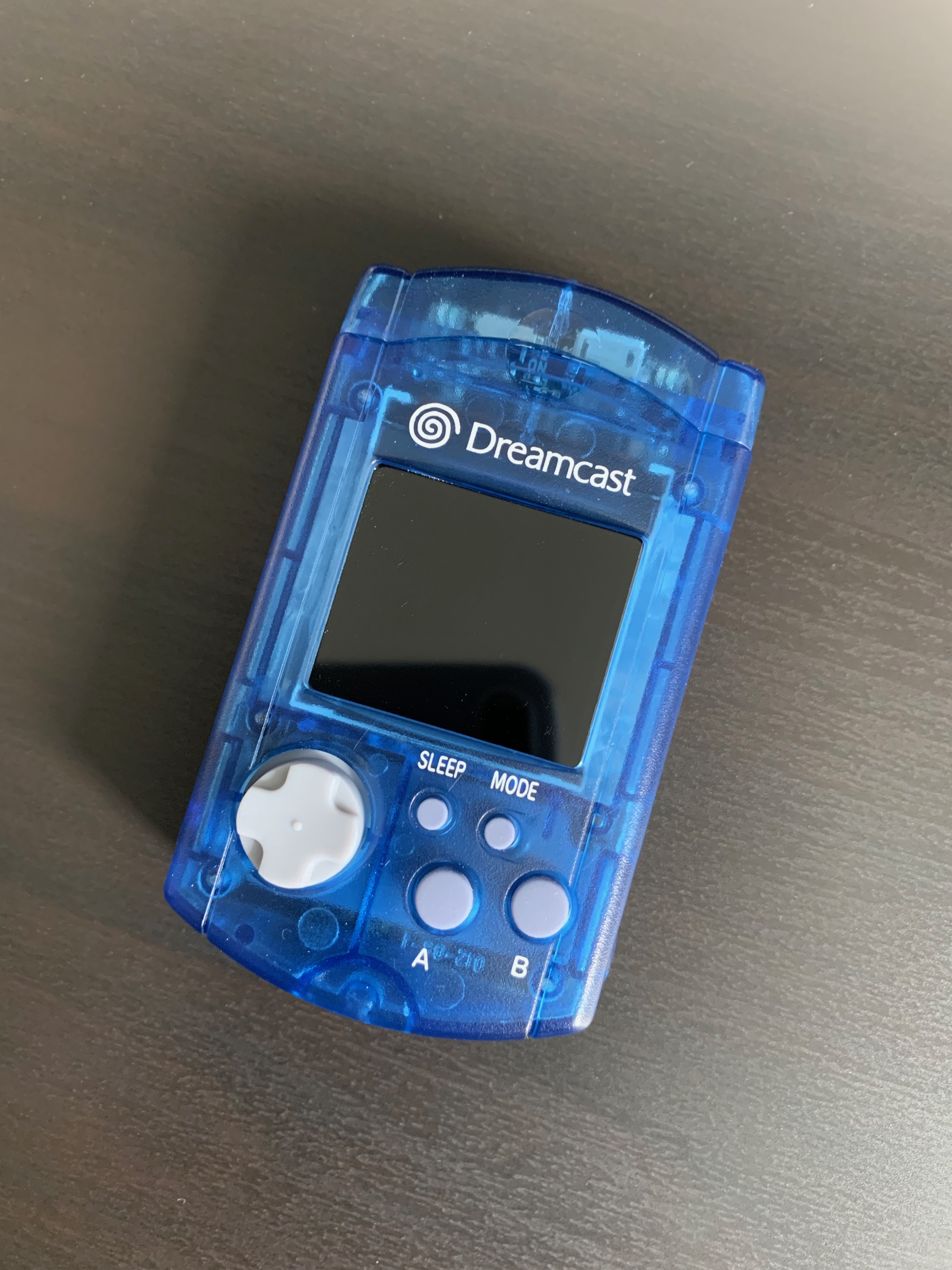

So this turned out to be a doozy of a project for me. First, the final results:

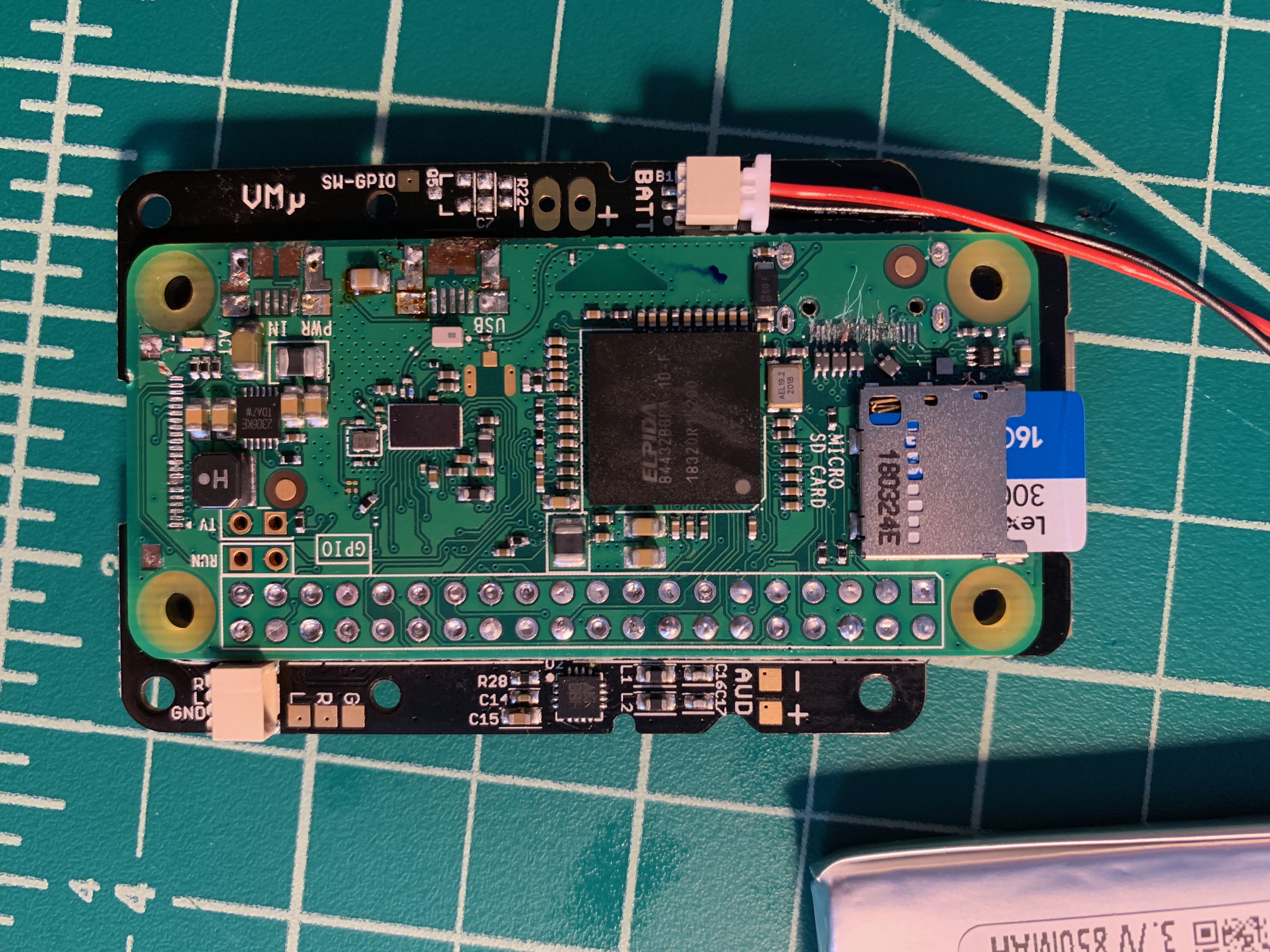

Started out by stripping down the Raspberry Pi, hoping to fit a larger 850 mAh battery in and got everything soldered together:

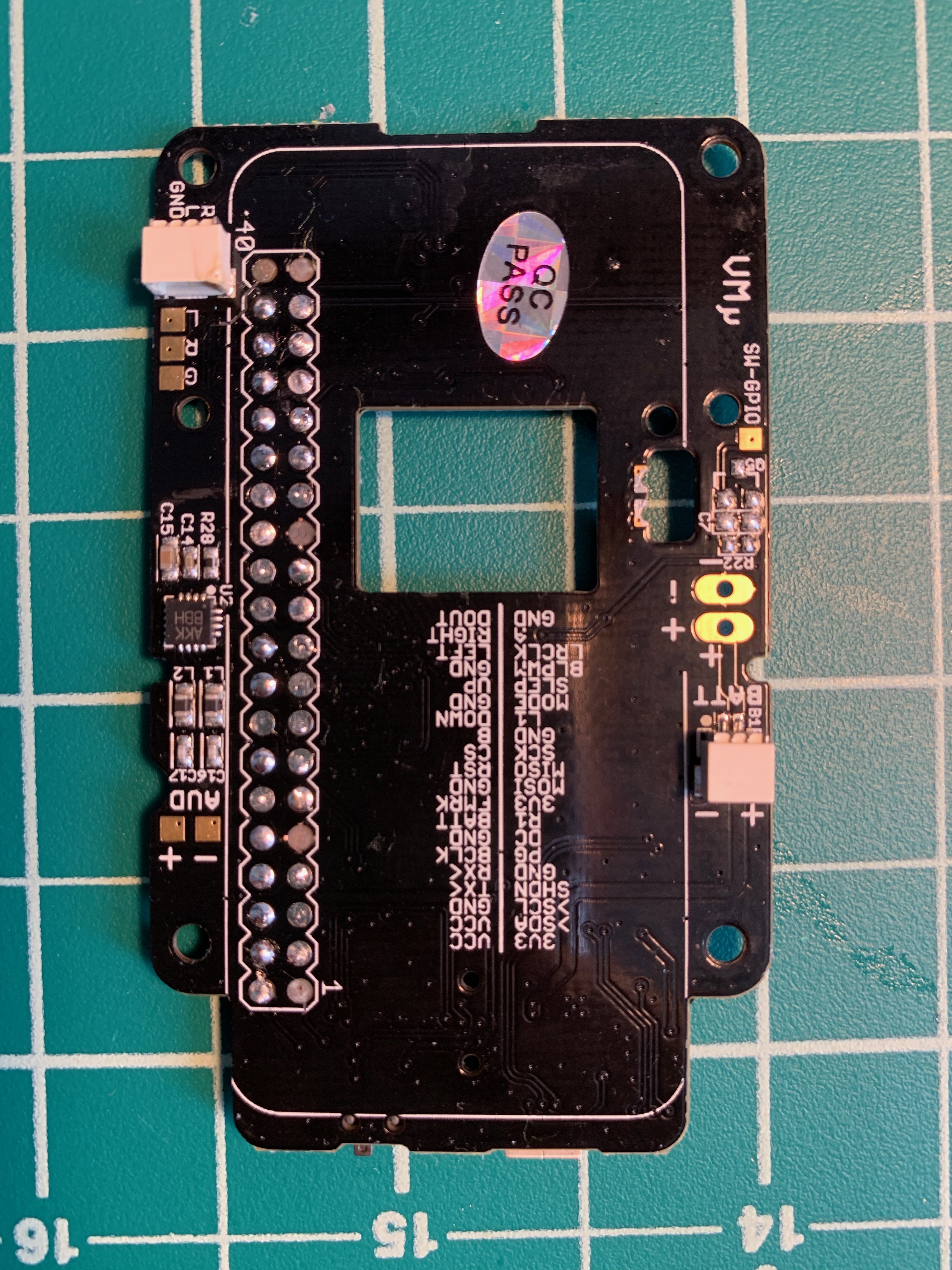

Came to find out I made some kind of mistake when stripping down the Pi and I couldn't get the Gem to turn on (all my connections checked out but there was a bridge between GND and VBATT that I couldn't resolve). So I wound up removing the Pi from the Gem using a hotair rework station and was pretty bummed when I wound up with this:
Nearly gave up after this but upon closer examination I only had one pad that needed to be rewired (rest were redundant GND pads)! So I carried on and got the Pi to boot! My next speedbump was no sound due to a blown speaker (I checked the resistance before assembly but somehow it got blown during testing / assembly). My solution was to fish out an old iPad speaker I had laying around and replace it with that:

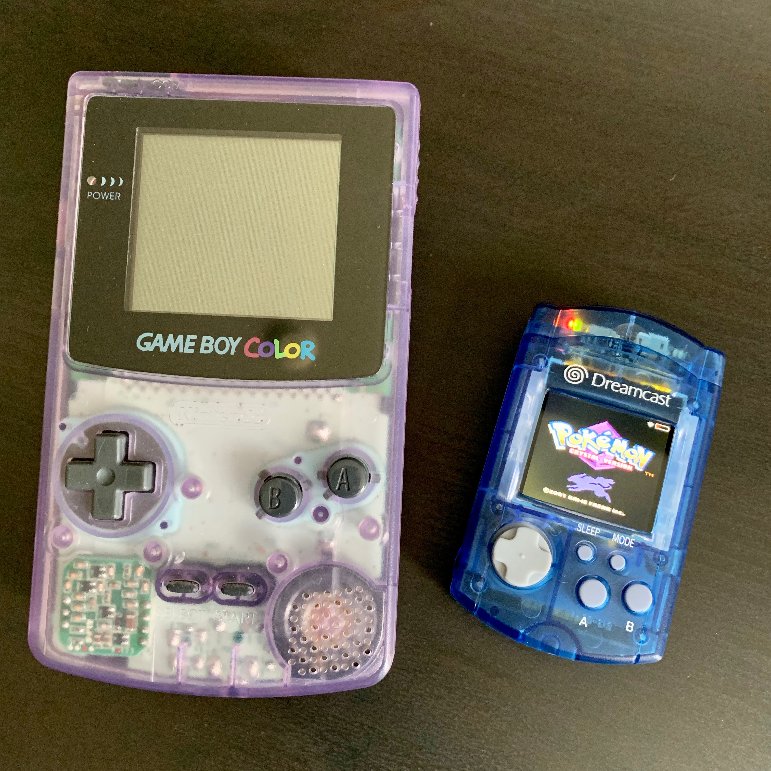

Finally buttoned everything up and have been pleasantly surprised how enjoyable it is to play so far!
Front View:
Back View:
Action Shot:

Nice redemption with those solder pads! Or just luck haha. Did you end up using the 850 battery?
I wish there were more case options or someone could make an stl for us to print. But for now, most of us have transparent blue. Just some have L/R and some don’t lol.
Anyways. Nice work.

Nice build, a few things, I had a similar issue, where the speaker arrived dead. The only other speaker I had on hand was a little round one, same as the minty pi speaker. i actually placed the speaker in the rear, since it was too big for the front. It fit nicely behind the original speaker grill, you could maybe move yours there if it's an issue under the screen.
