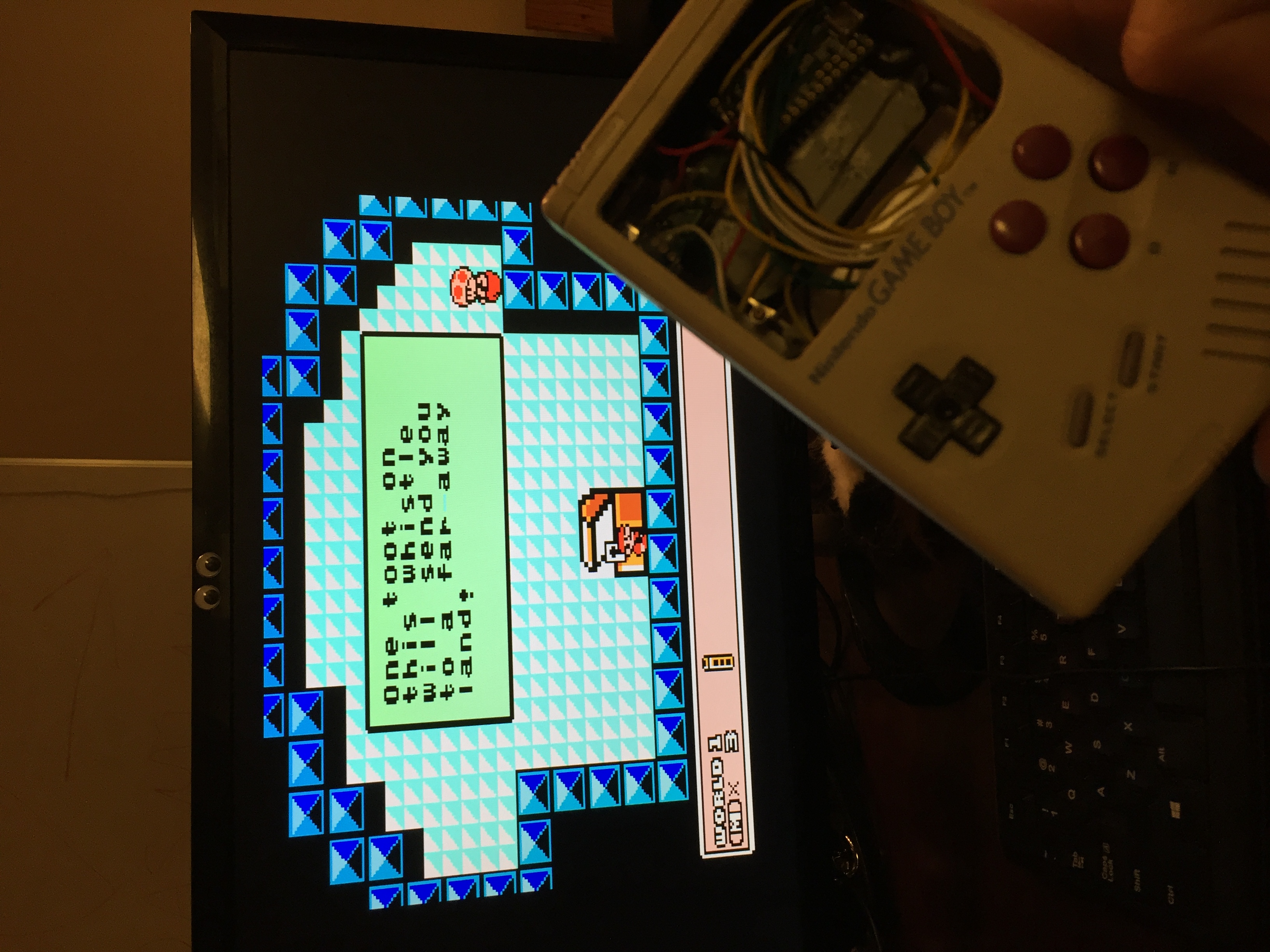

So that didn't work, but I did end up getting it working.
Power was the issue. I guess the pi zero doesn't provide power natively to the secondary USB port. I ran an OTG cable and gave the USB power and the GBZ and then emulation station recognized it immediately.

Thanks for the help :) let me pick your brain on one other thing regarding the SD card. I bought one of kitsch-bents cartridges and I'm having trouble wiring it up to my pi. It seems he calls that data_in and data_out test pads should be used to hook up the Sd card. Which is 22 and 23 respectively on the pi. It seems rather that you use those pads for USB.
he has a diagram for wiring on his website with the product but many names don't match what is on many Sd pin diagrams I see. Vss, data_in, data_out. I was assuming that was D+ and D-. But I can't get the pi to turn on with the Sd inserted in the cartridge slot. Can you verify for me at the least that the test pads you use are the only ones that should be used for the pi in its default configuration? All these SD card voltages and symbols make my head spin.....

Dat in and data out are pads 15 and 16 for the ad reader I think. Try that and see if it works

Okay. That wiring worked. Thank you. But now I'm getting kernel panic. "Kernel panic - not syncing. No init found. Problem after problem. The Sd card still works when put directly into the pi.
I was having the same issue with the panic. I tried a different SD card, different brand and size, and it worked fine.
