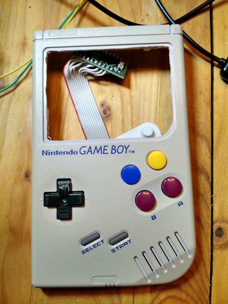

I got this SNES controller on Amazon hoping to use the buttons on my build. As you can see the buttons are very small compared to the DMG buttons. Should I just order another controller? Or is this the normal size for SNES buttons? I'm considering this controller Link reviews say that the size and color is very close to original. However if anyone that has built a gameboy zero with famicon buttons can let me know how close the size is to the DMG buttons I would really apreciate it.

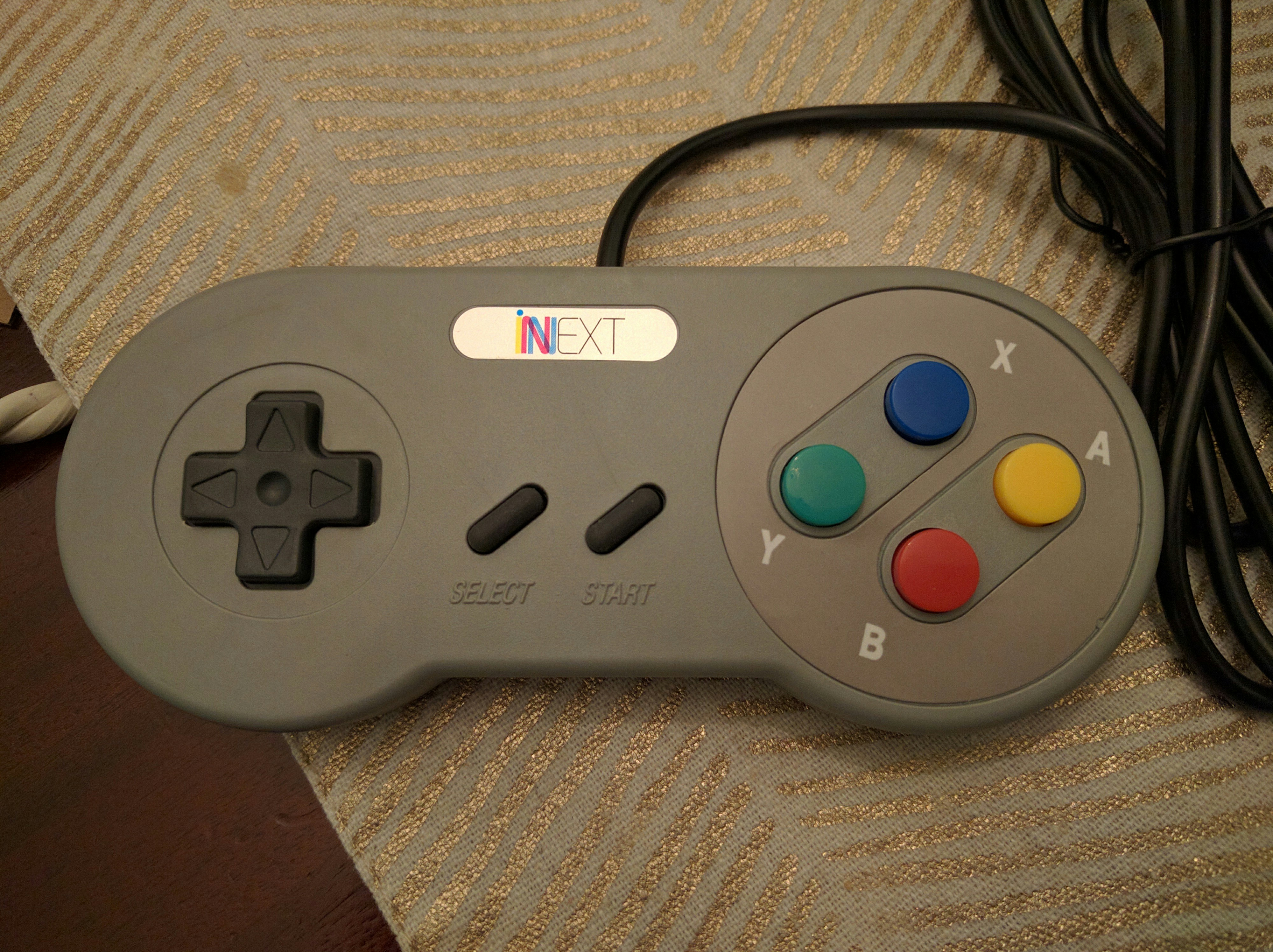

I bought this one on eBay some weeks ago.
http://www.ebay.es/itm/Super-Controller ... SwKIpWEntc
As far as I can remember, the buttons are exactly the same as the original ones. I can show you a picture when I get home from work this afternoon.

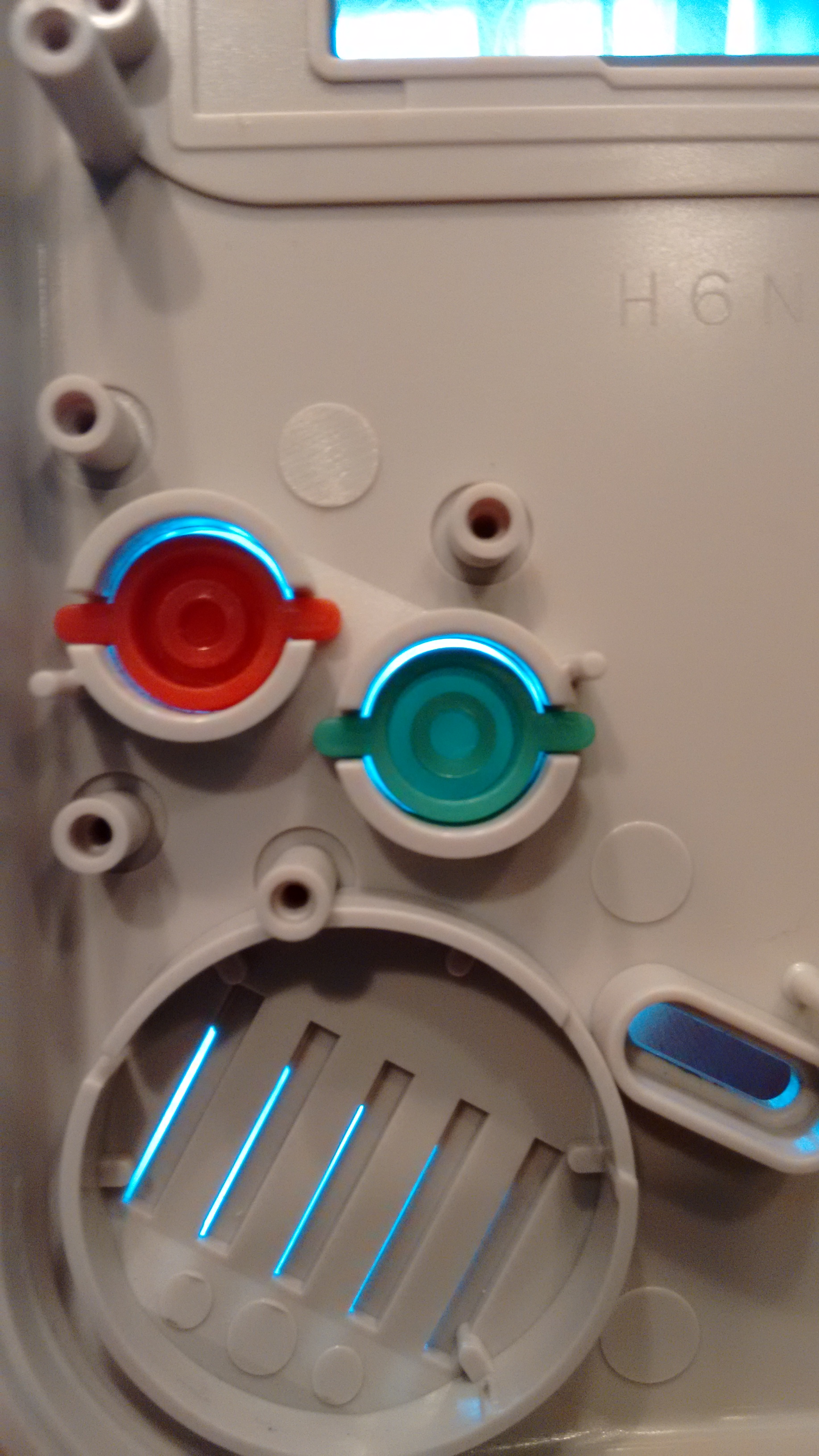

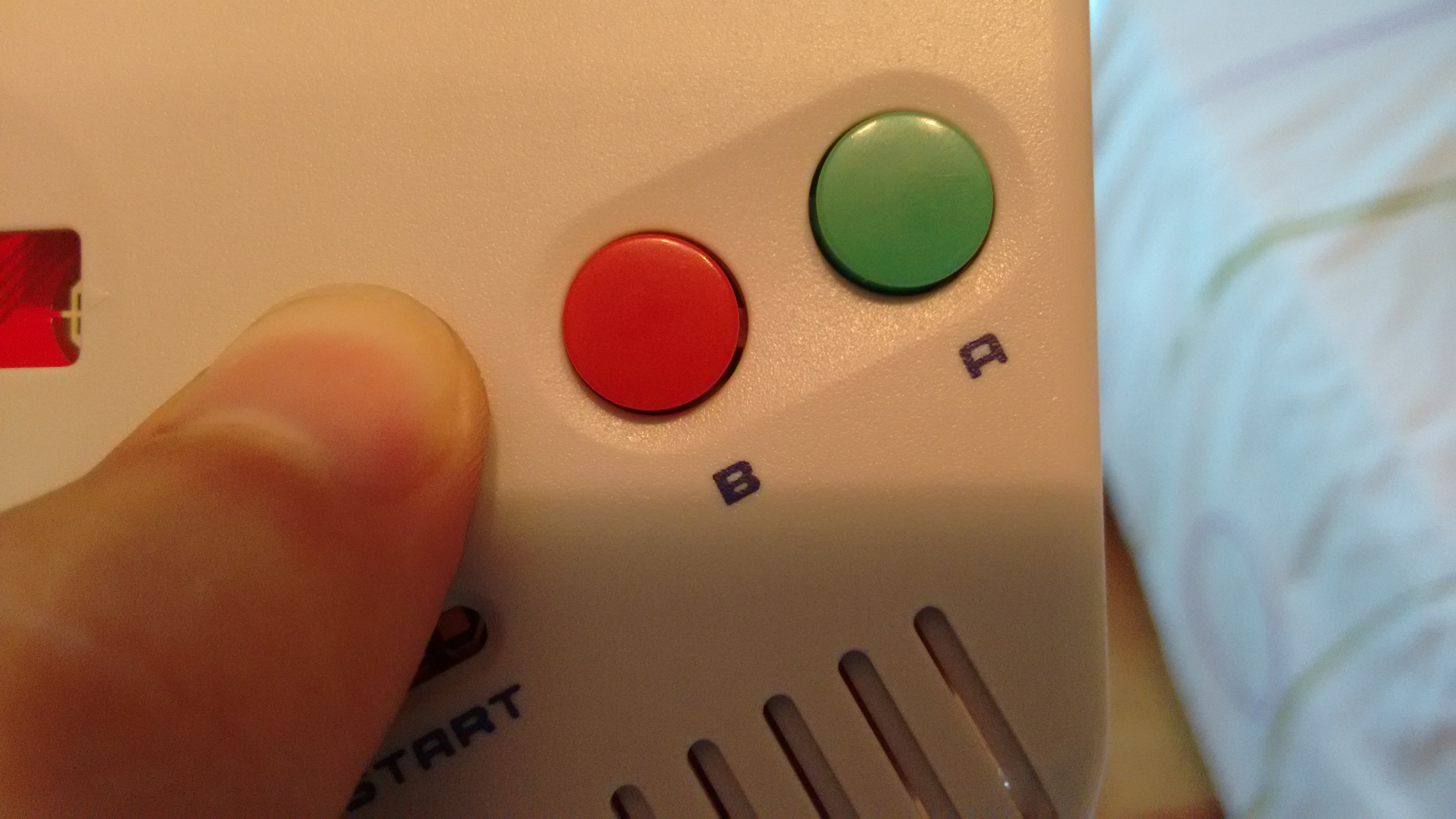

Tamasco
Posts: 67
Location: Spain
Has thanked: 34 times
Re: SNES Buttons
Post by Tamasco » Thu Jun 30, 2016 12:56 pm

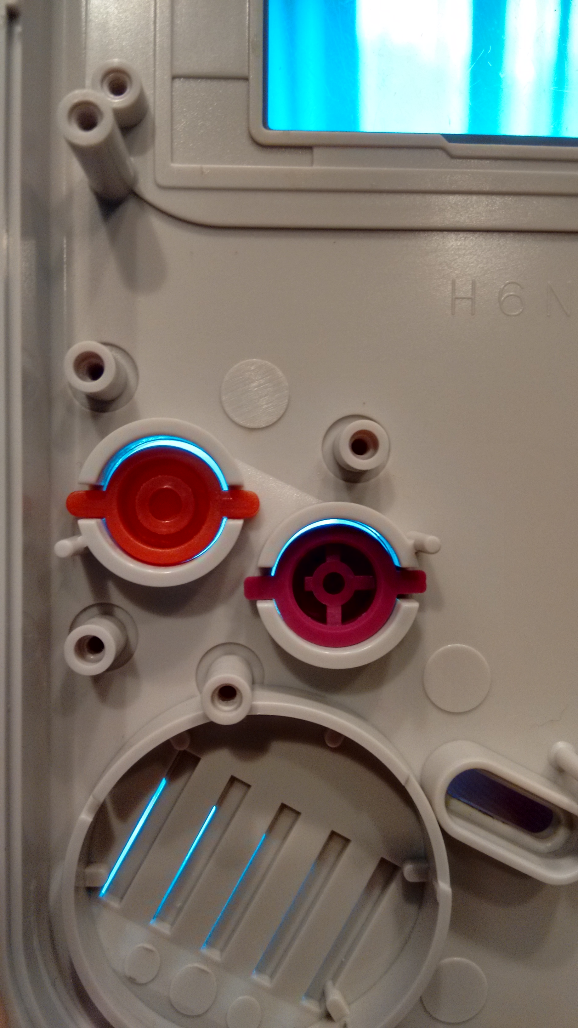

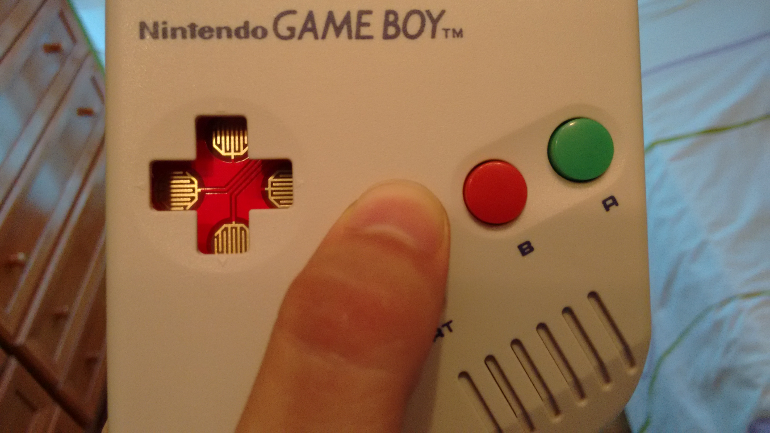

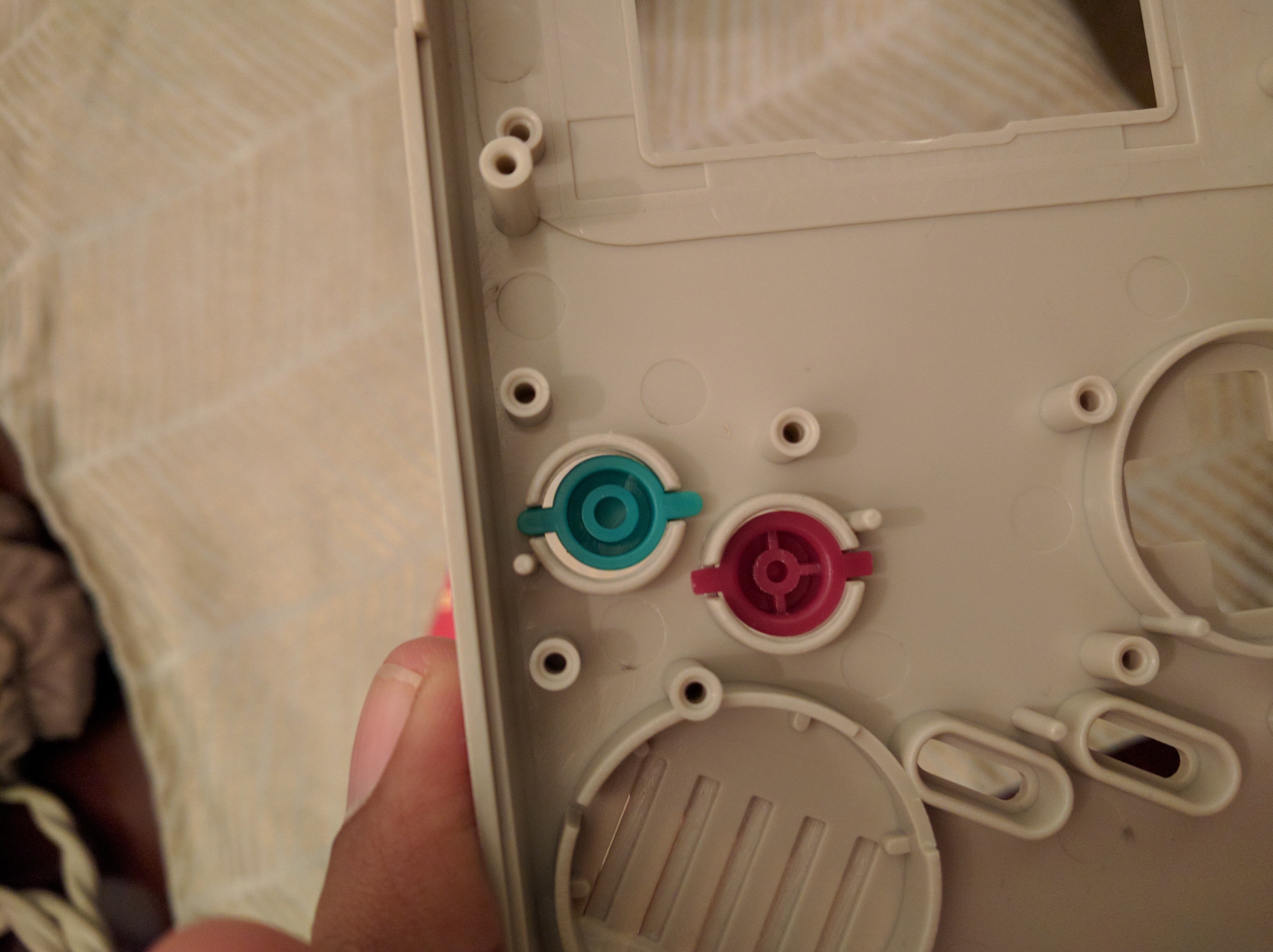

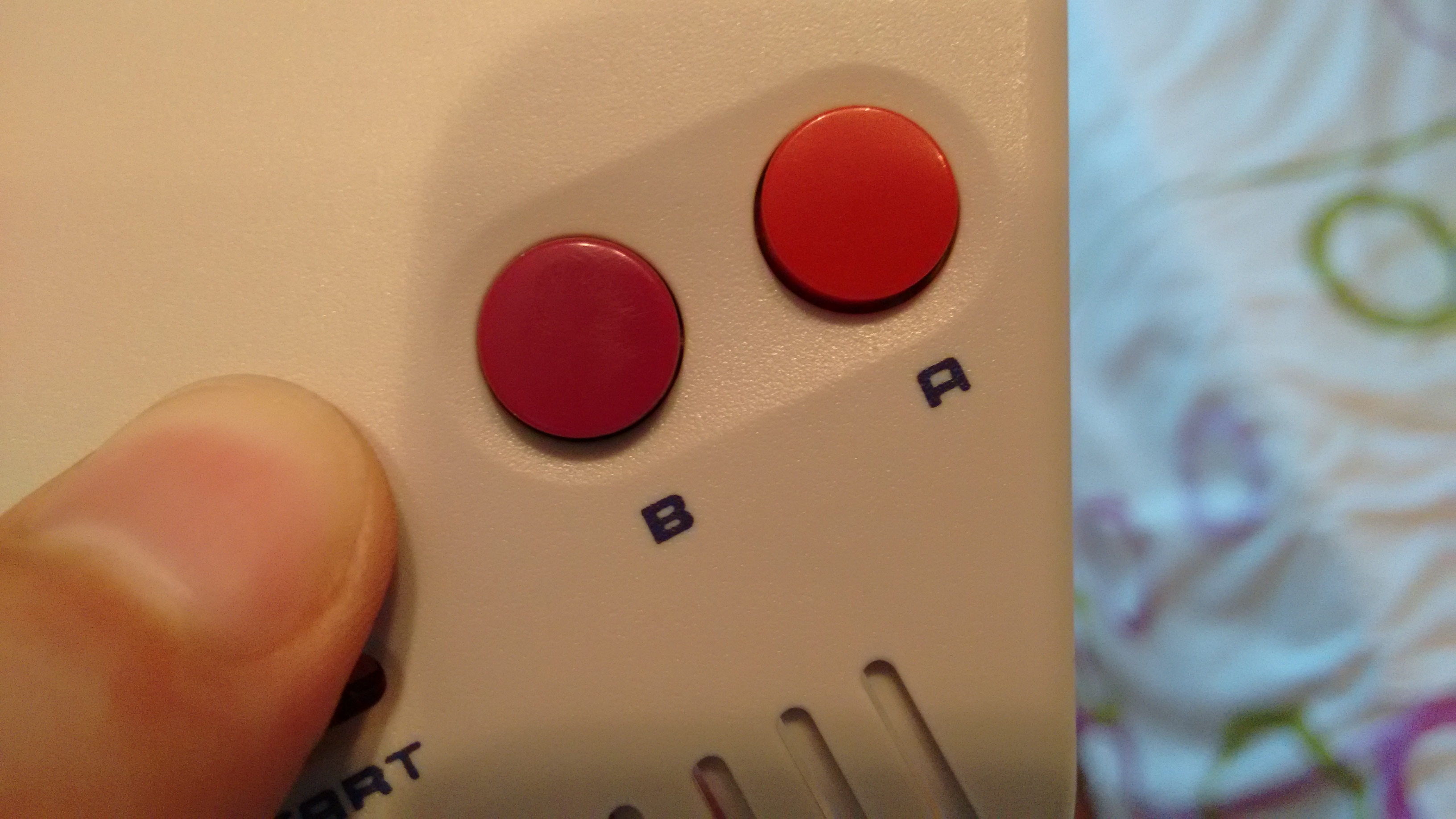

I just looked into my buttons. The SNES ones I linked before, they might be a little, but very little smaller than the original ones. The difference I think is almost inapreciable. The also feel good with the PCB.
Judge for you selfs.
