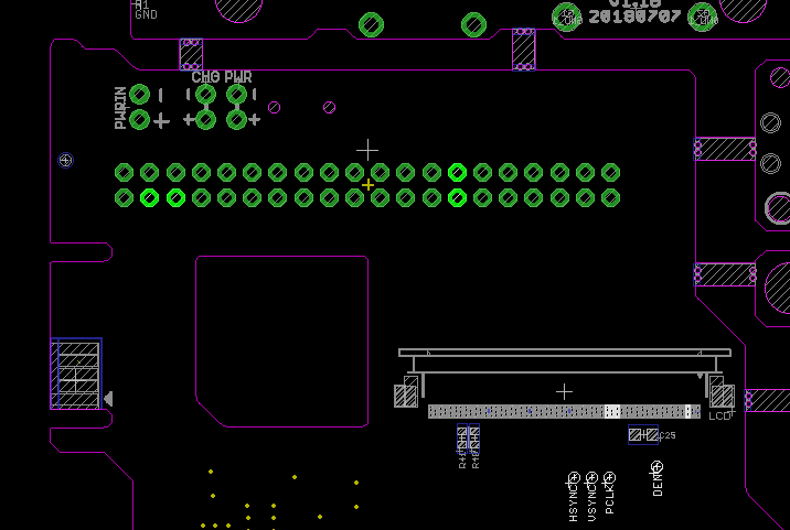

Check the LCD connector for debris, and check the LCD FPC and clean it.
Second, it's likely one of the signal lines not soldered :) you may find pressing the Pi affects it?
Re work the LIGHT GREEN highlighted pins in the pic below. NOTE that this picture is looking at the BOTTOM of the board. Also note how just under the LCD connector are 4x little test pads? They correspond to the 4 highlighted pins (not in that same order, but some probing will get you the ordering)

Got the multi-meter out and tested all 4 highlighted pins from the Pi to the test pads (touched end of the pins on the pi, not the board) and all buzz positive on the continuity test. That says to me it’s not the soldering connections?

From the pictures it doesn't look to have pierced the FPC, just dented it, if you wiggled or pressed that area and suddenly it came to full life then that would show it being that, but from inital looking it looks alright.
I would re-work those pins a tiny bit first anyway, on the Pi side of the board (the pin may well be connected to the main board as you have shown with continuity, but it might not actually be fully soldered to the PI itself, which is pretty hard to actually test.. so best to add some fresh solder and re-heat those pads a little)
