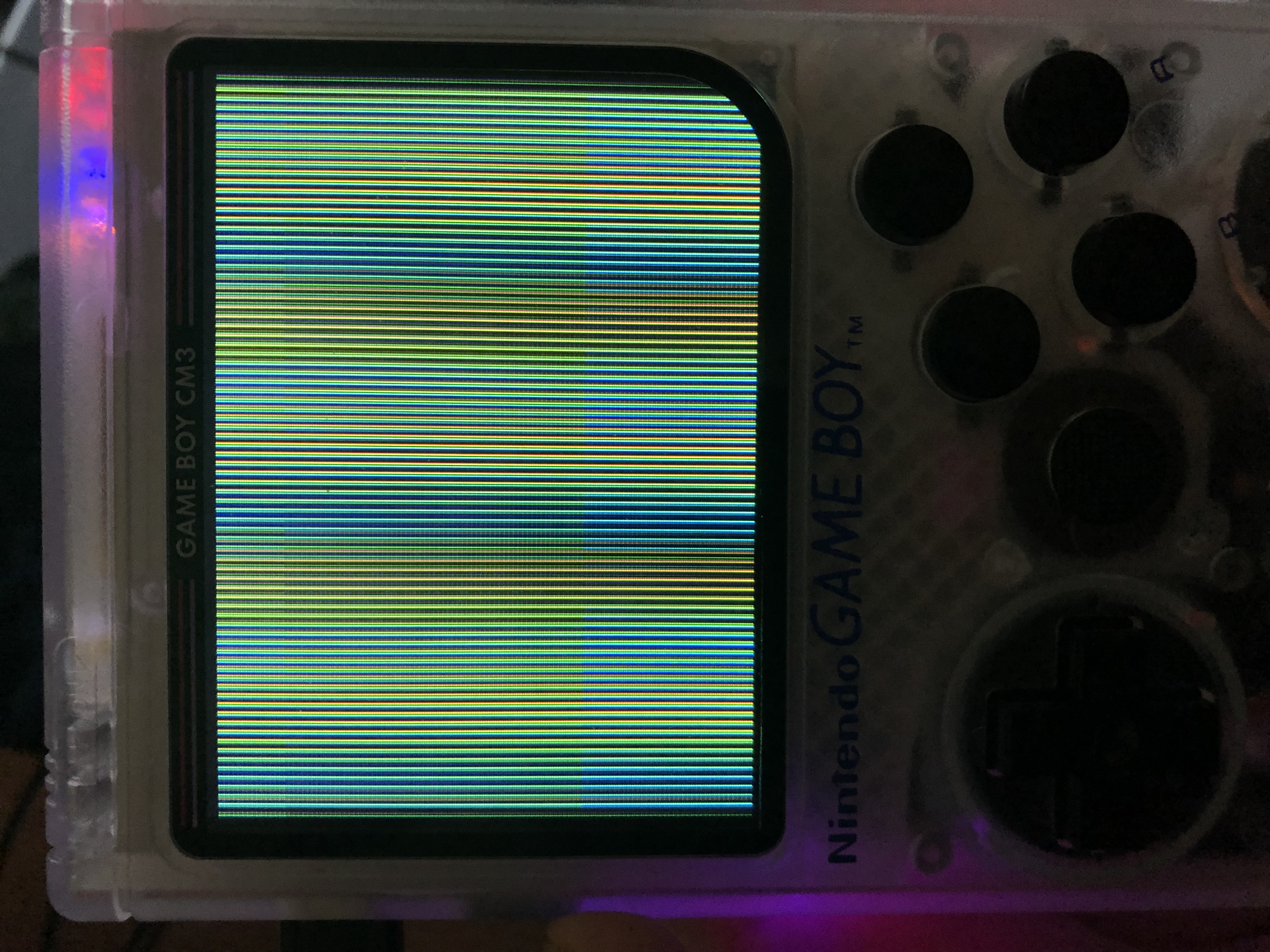

Been trying to get pcsx-rearmed to work on the CSO. I installed from binary and have been trying to load Spyro, a rom I know works. I just get a sort of rainbow screen (see pic) the IR emu doesn’t work either, it just kicks me back to the menu screen.
I first had an issue I couldn’t update the emulation station package or the emulator. I had to update all of retropie first. Then I was able to update emulation station package and the pcsx-rearmed emulator from source successfully. Still doesn’t work
Any idea how to fix this?

Make sure nothing changes the display output mode. Some edit HDMI settings, any editing of those will stop the internal screen working. You may have luck in the 'one time reboot to hdmi' and you might find it works?

On CS board, you can use lr-pcsx version of Playstation Emulator. Can you check if it behaves the same?

Resurrecting this old thread in case someone in the future runs into this...
The framebuffer mode needs to be changed before pcsx-rearmed starts, then reverted back after it finishes. I typically do this as part of the run command.
/opt/retropie/configs/psx/emulators.cfg:
default = "pcsx-rearmed"
pcsx-rearmed = "pushd /opt/retropie/emulators/pcsx-rearmed; fbset -g 320 240 640 480 16 ; ./pcsx -cdfile %ROM%; fbset -g 320 240 320 240 8 ; fbset -g 320 240 320 240 32 ; popd"
