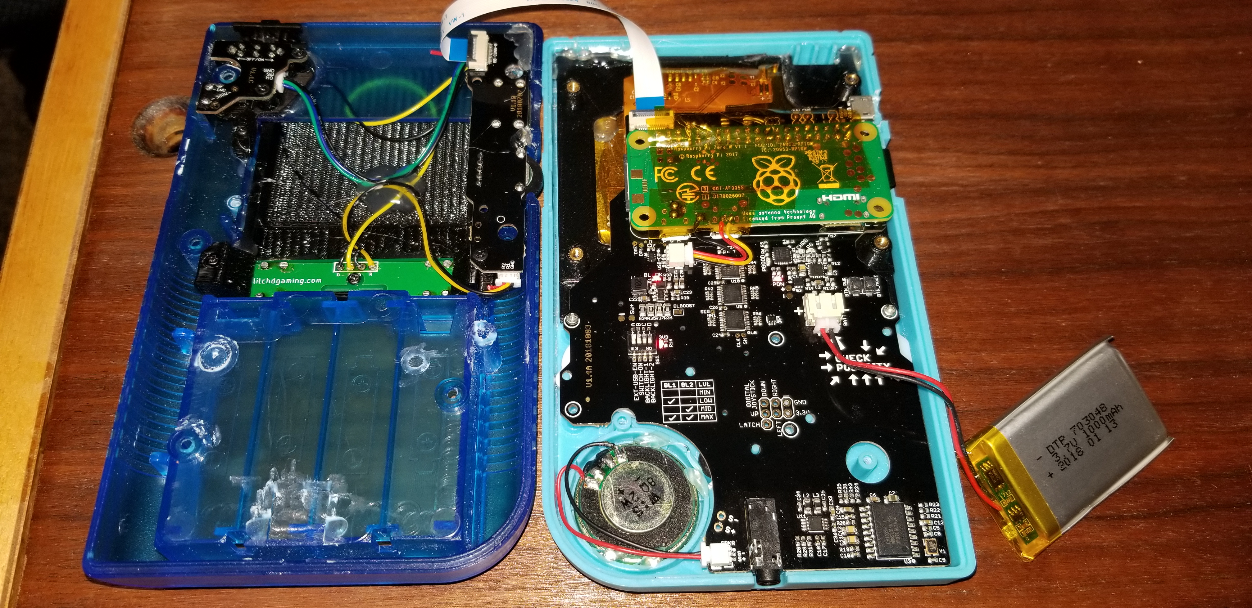

Hey everyone, hey kite.
Seems i've run into an issue assembling my son's CSL, everything is soldered and connected but it won't boot up. When powering the CSL on i get a brief white flash, I hear the audio come through the speaker and the screen then remains at a slightly illuminated state. I wasn't really able to get a good picture of it in this state compared to it off but can try again if anyone thinks it will help. As far as I can tell I get the lights that I should, I just get nothing from the screen.
Things I've tried so far all with the same result:
  • Re-imaging SD card
  • A different SD card
  • A different Screen
  • Touch-up/double check Pi0 solder to board
ImageShow
I welcome any suggestions on things to try or what I can do to resolve this.

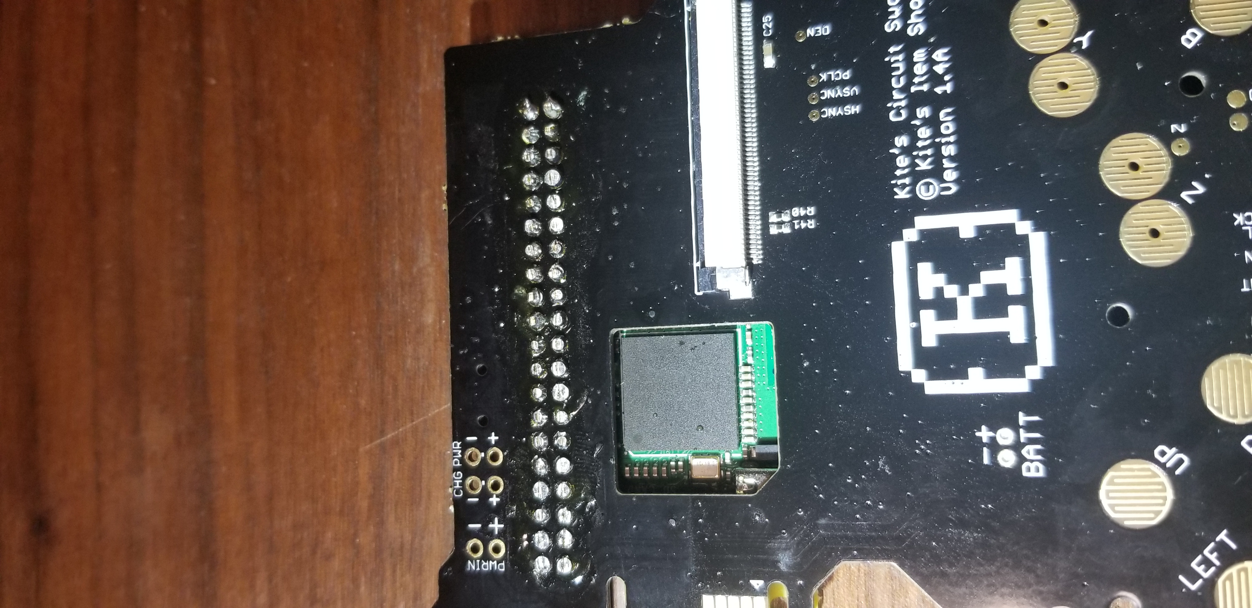

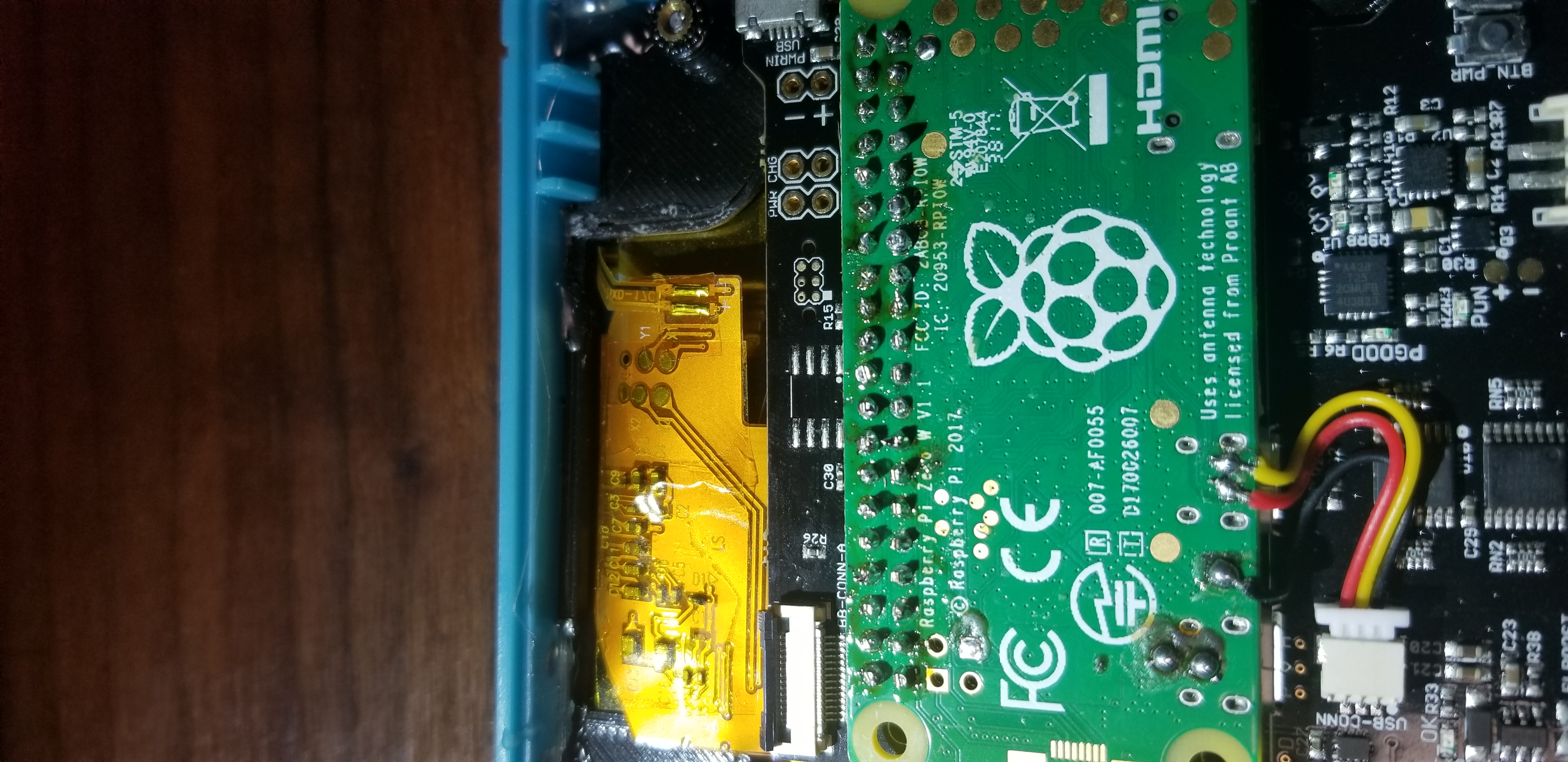

Side 1Show
Side 1
Side 2Show
Side 2

Everything looks pretty good!
Could you using some acetone/alcohol to remove all the flux that is around everything that you have soldered? Ideally something like a small brush or old toothbrush or something with it on to remove it from between the pins..
When you power it on, the Pi itself has a green LED in one of the top corners, does this start blinking after a few seconds, or does it remain off, or does it do like a TINY flash on when you throw the switch?
With the CSL powered on with the switch, if you lookup the Pi pinout and find the GND and 5V and 3.3V pins, can you measure them with a multimeter (so gnd -> 5v, and gnd -> 3.3v). Just remember that the pi is mounted upside down and most diagrams show it pictured the 'right way up' so just remember that when picking out the pins!
