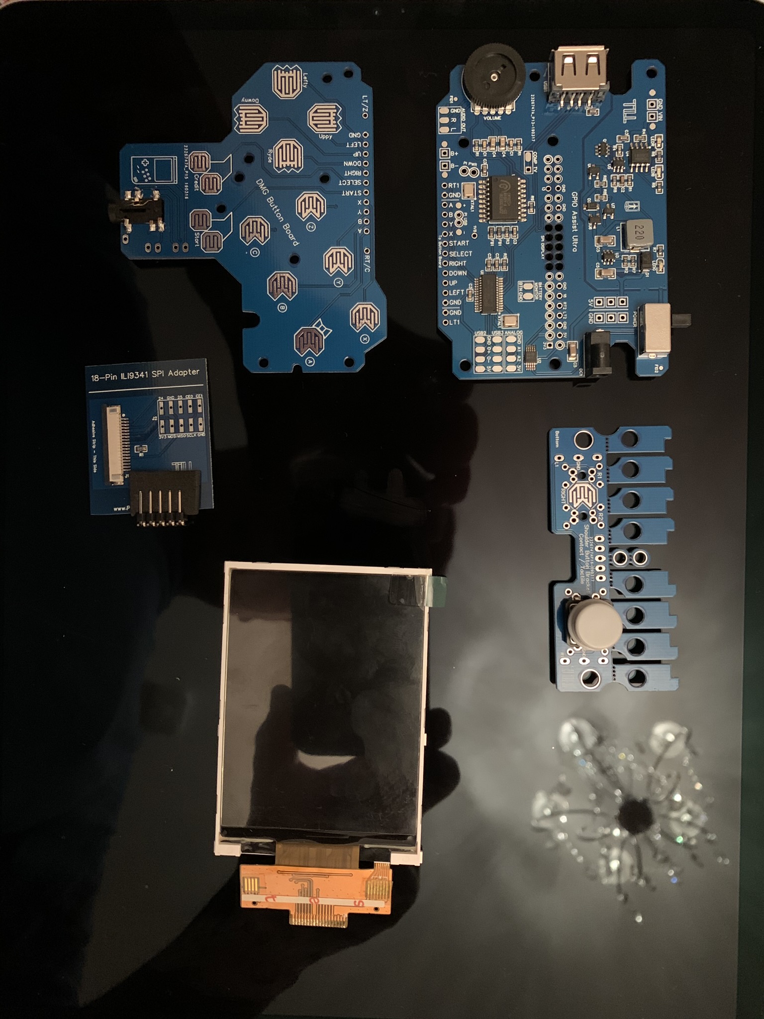

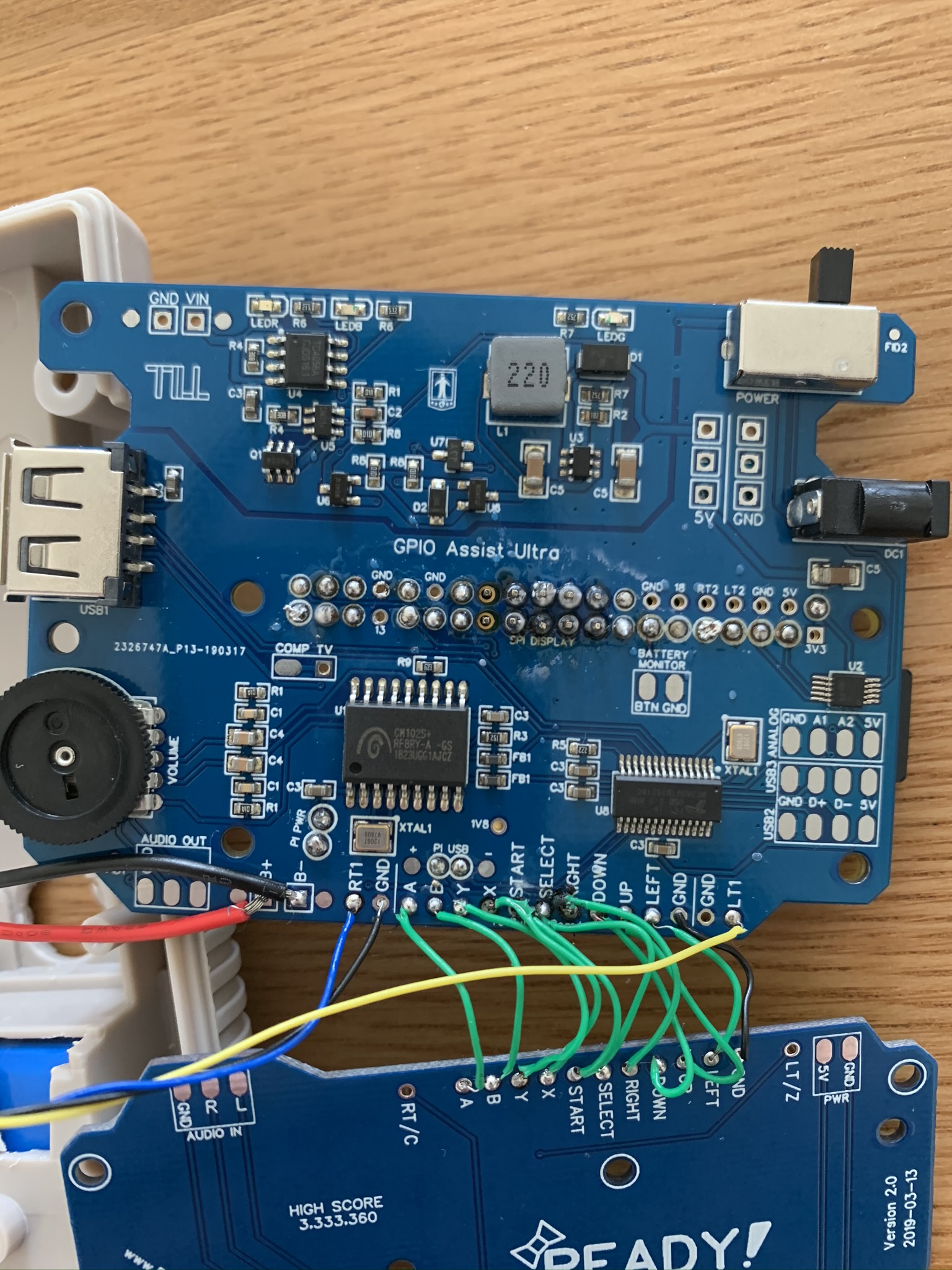

Post by FirstTimeGBZ » Thu Jul 11, 2019 7:06 am
while waiting on my tinkerboy items to arrive I decided to do a pocket adventures one also.
Any wiring guides out there for the pieces below?

Re: First GBZ Build
Post by infinitLoop » Thu Jul 11, 2019 8:38 am
when connecting the pi, just make sure to solder all the circled connections on gpio (at least) as well as the other pads/holes for power, video, and usb
pretty much everything is labelled on the boards themselves (the connections also line up when you have them situated in a case). just line up and connect "X" to "X" and "A" to "A", etc.

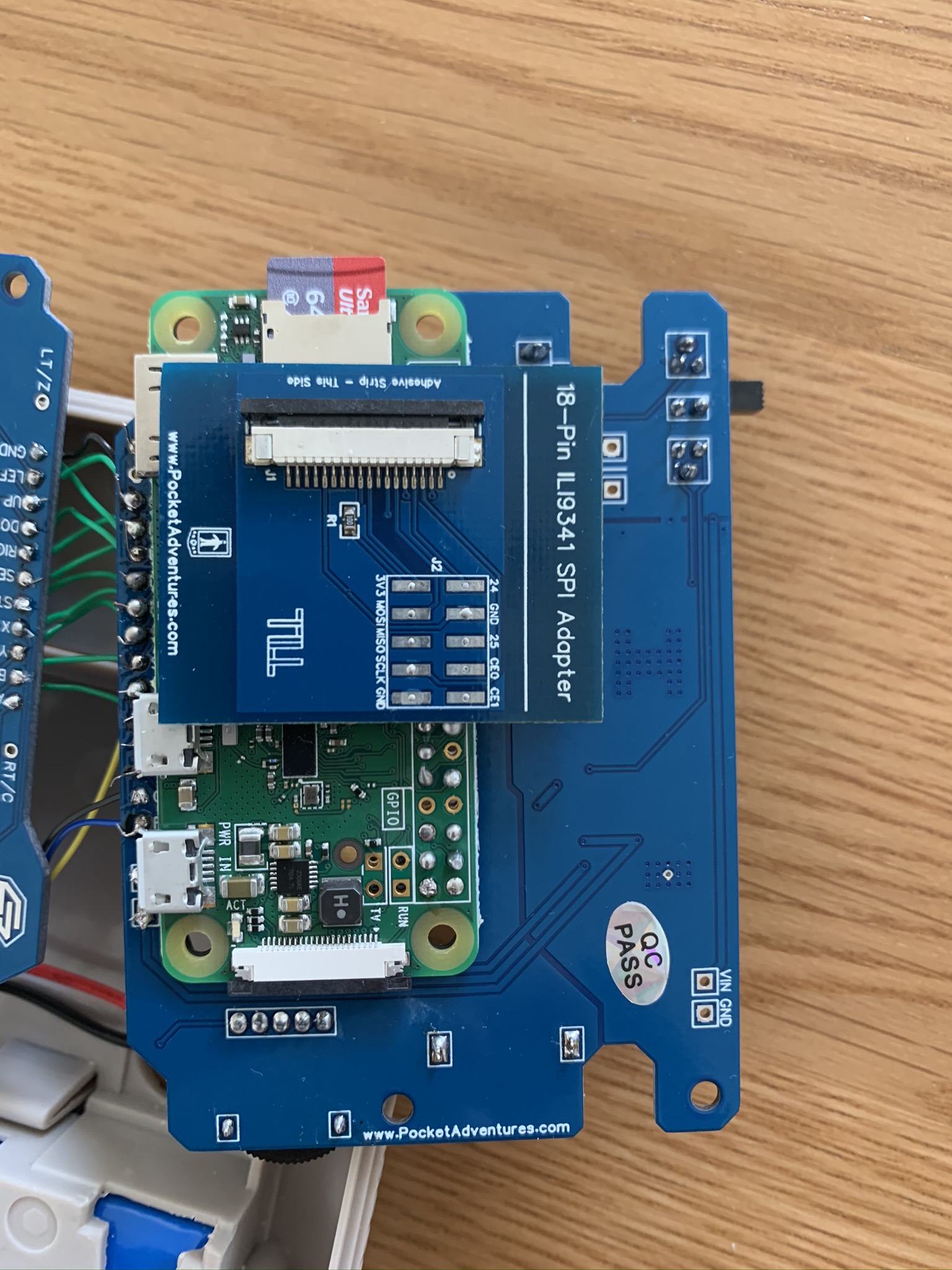

Post by FirstTimeGBZ » Mon Aug 12, 2019 2:20 pm
I haven't mangaged to get the screen to work on the pocket adventures build. Even after following this tutorial: viewtopic.php?f=22&t=2312
Any ideas?

Re: First GBZ Build
Post by infinitLoop » Mon Aug 12, 2019 3:14 pm
Any ideas?
the screen can be tricky. it's probably the flat screen cable not making good connection in the on-board connector. if you can, first check the continuity between the pi and the screen board. then, put a couple layers of tape on the back side, like here: http://www.pocketadventures.com/guide_wiring_spi10.asp it might take a couple tries to get it right. cleaning the cable with some alcohol might help too.
i actually didn't have luck getting the screens to work with the tape trick, so i just clipped that off and soldered the screen directly to the board, but with space limitation, doing that can be difficult. i have gotten the tape trick to work a couple times since those first times, tho. you just need to get it in the right position on there, and make sure the cable isn't bent or anything.
