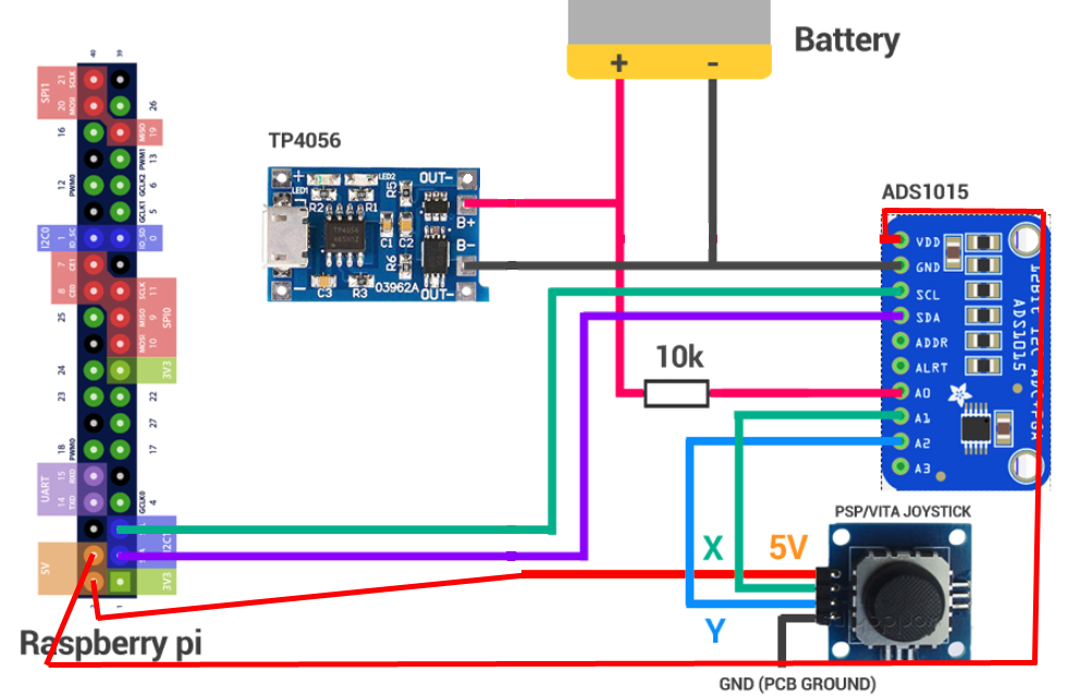

Hi everyone,
Lately I've been trying to figure it out how to connect the ads1015 after reading on this forum and other sources how to monitor the battery and add analog sticks to the gameboy without needing an extra microcontroller.
I will my connect the system in the following way, tell me please if you see any errors:
It is safe to connect the battery directly to the VDD of the ads1015? By not having a switch between the VDD and battery +, will it drain the battery even when the system is turned off?
Where is recommender to connect the VCC pin of the psp/vita joystick? I've read that 5V is the best for reading stability, but I don't know where is better to connect it, it is ok to connect it directly to the tp4056 5V output, or maybe to the raspberry pi 5V pin?
If the ads1015 is powered by the 3,7V battery, will this affect to the readings of the 5V powered joystick? I'm talking about voltage references, for example, the joystick compares under 5V, and the ads1015 battery is reading values under 3,7v, I don't know if I explained myself correctly.
Also, I will use this thread to experiment and give feedback about this topic, I've used microcontrollers in the past succesfully but I think sometimes is a little bit overkill for having two simple analog readings.

Thanks VeteranGamer,
The ads1015 problem is solved now that I've seen that the script can be adapted to the voltage reference of the analog inputs and knowing where to connect the ads1015's VCC, which I didn't like the idea of connecting it to the raw battery input in the first place for obvious reasons.
Now, approaching the powering issue that you pointed:
I've tried in the past the raspberry pi 3 B+ with the tp4056 module and worked fine even powering a SPI LCD screen and PWM audio output, but now I've realized that the output is only 1A, so it suprises me that it worked well in the first place. Now I'm working with the model A+ which fits better and seems to draw less power than the B+.
I really like the retropsu board and I will buy one probably, but I want to approach my builds with more generic components and boards that can be easily replaced and bought from everywhere cheaply like the typical blue tp4056 boards.
You've said the tp4056 is not powerful enough for the rpi3, but the retropsu uses it too, is the charging part of the board. What it changes from the typical blue board is the discharge part, allowing more discharging current through it I suppose.
I've found this board, I don't know if it will work:
https://www.ebay.co.uk/itm/2A-5V-Li-ion ... 3292205661
Looks compact, cheap and seems to be able to draw about 2,5A, which will be sufficient for the model A+ I think. If anyone knows of any power boost boards with more than 2A output will be really appreciated.

The Tp4056 is only used to charge the batteries, believe it or not the Pi 3B is supposedly capable of being powered off of 3.3v and the battery usually delivers about 1500 mAh as max output so it can power some devices but if there is alot of draw it is unlikely to last long or will show the lightning bolt.
The 1A from the TP4056 is only relevant when the battery is being charged and you can't rely on it charging and playing since there is no way the battery can be charged and also power the pi 3B off of it since there is not enough amperage to power both. Using it in this method will only slow down the drain on the battery but not really fill it up.
