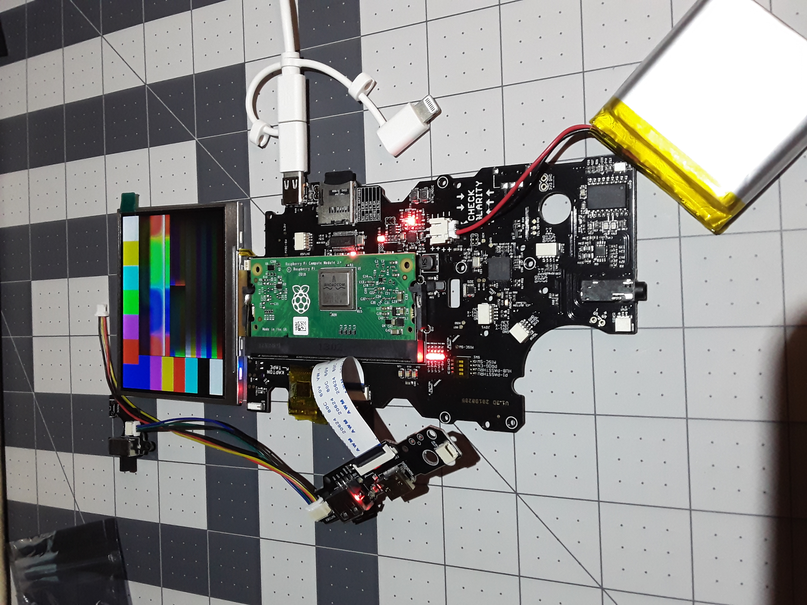

Hey guys. I'm currently testing my CS using Kites guide on Git Hub. Everything tests ok until it tries to test the LCD, then it cuts to the rainbow screen, and then back to the testing screen. This repeats non stop. Any ideas?

Edit the cs-config.txt file back to how it was before (the NORMAL mode, you have put it in TEST mode as per the instructions)
