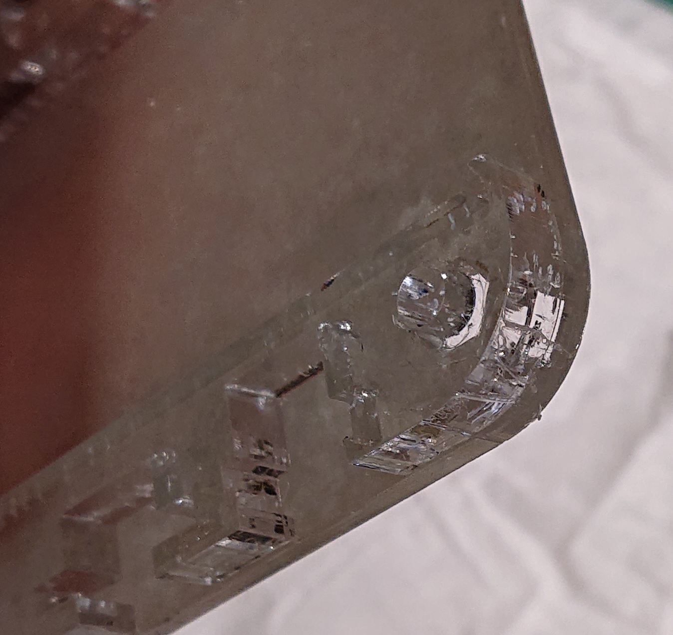

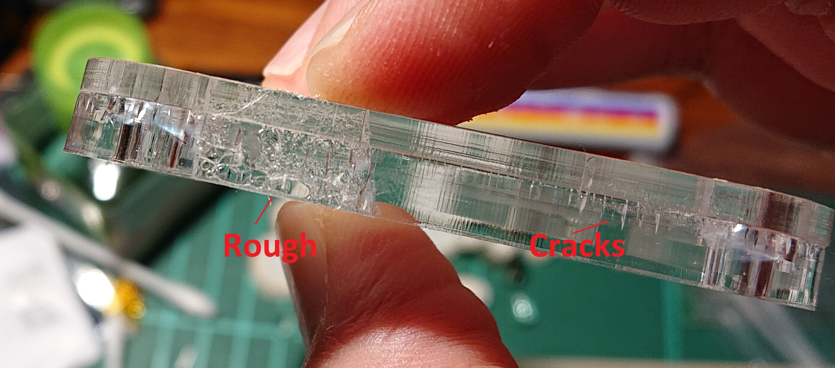

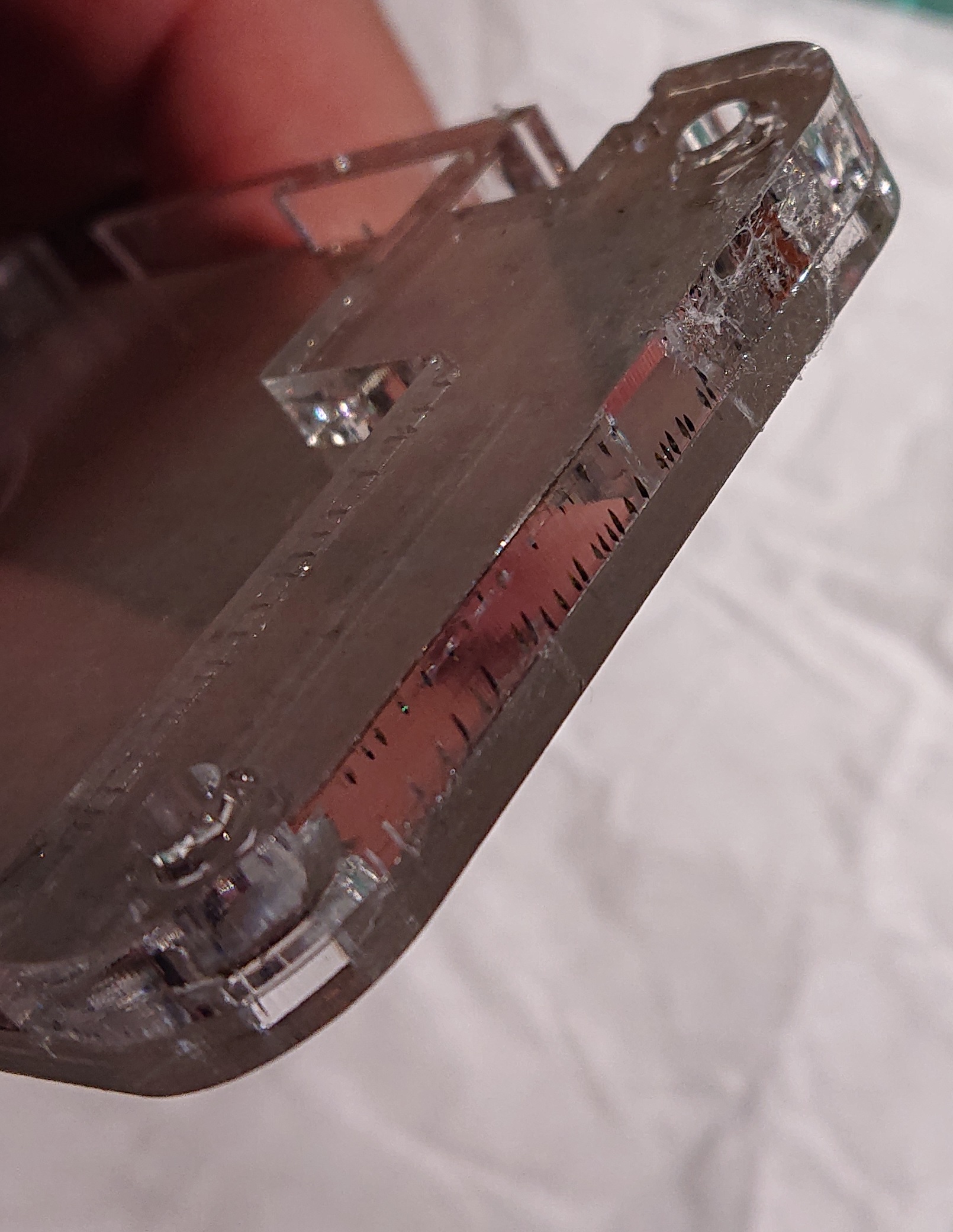

2) Acrylic case wise, I glued it up (solvent-ed it up?). After the solvent is applied I noticed the acrylic developed cracks. Some of the smaller pieces like the buttons had some cracks straight out of the box, but the larger body pieces definitely didn't, but definitely did AFTER I used the solvent on them.
Where did I go wrong?

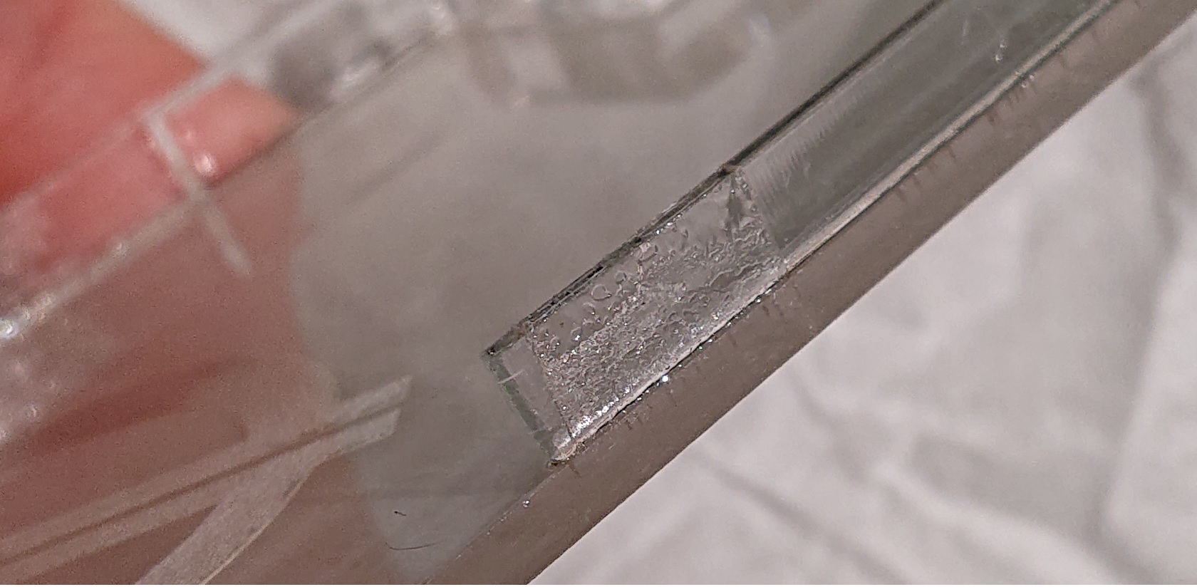

Also, after taping the pieces together (body pieces) in prep for gluing, once the solvent is applied, it soaked along the tape and melted the sides, now I'm left with a rough surface along the sides where the tape was. This is purely a cosemetic issue...but is there anything I can do to fix it? If I sand it it'll become frosted...ideally I would want to restore it as close to the laser cut edge as possible.
Long shot I know. On the other hand ... cosmetic issue... I can live with it.
What could I do next time to avoid the solvent wicking along the tape? Is there a technique that I missed?
Pictures of the acrylic attached....
