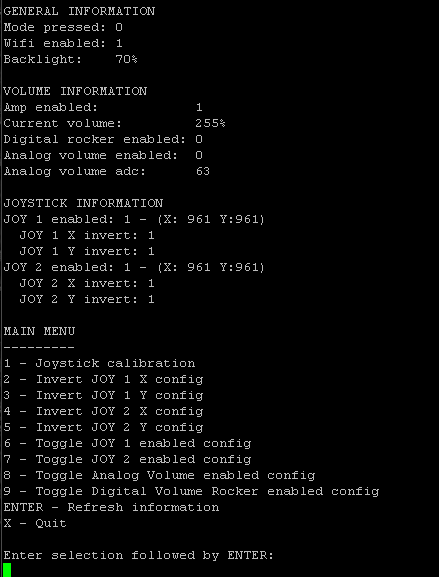

My bad!
Here is the config (attatched)

Re: Joystick 2 not working Circuit sword V1.1E
Post by kite » Fri Aug 30, 2019 1:51 am
Ah, i have a feeling you have hit an issue that was on the early boards :) the issue is that the Arduino code had a bug that didn't enable joystick 2! I only just remembered about it now based on some of the output of that command not coming back correctly (older firmware).
Could you please follow these steps to get it updated: https://github.com/kiteretro/Circuit-Sw ... controller

Post by xaphor » Sat Aug 31, 2019 3:12 am
Thanks Kite that worked perfectly! Thanks for the support I really appreciate it!
