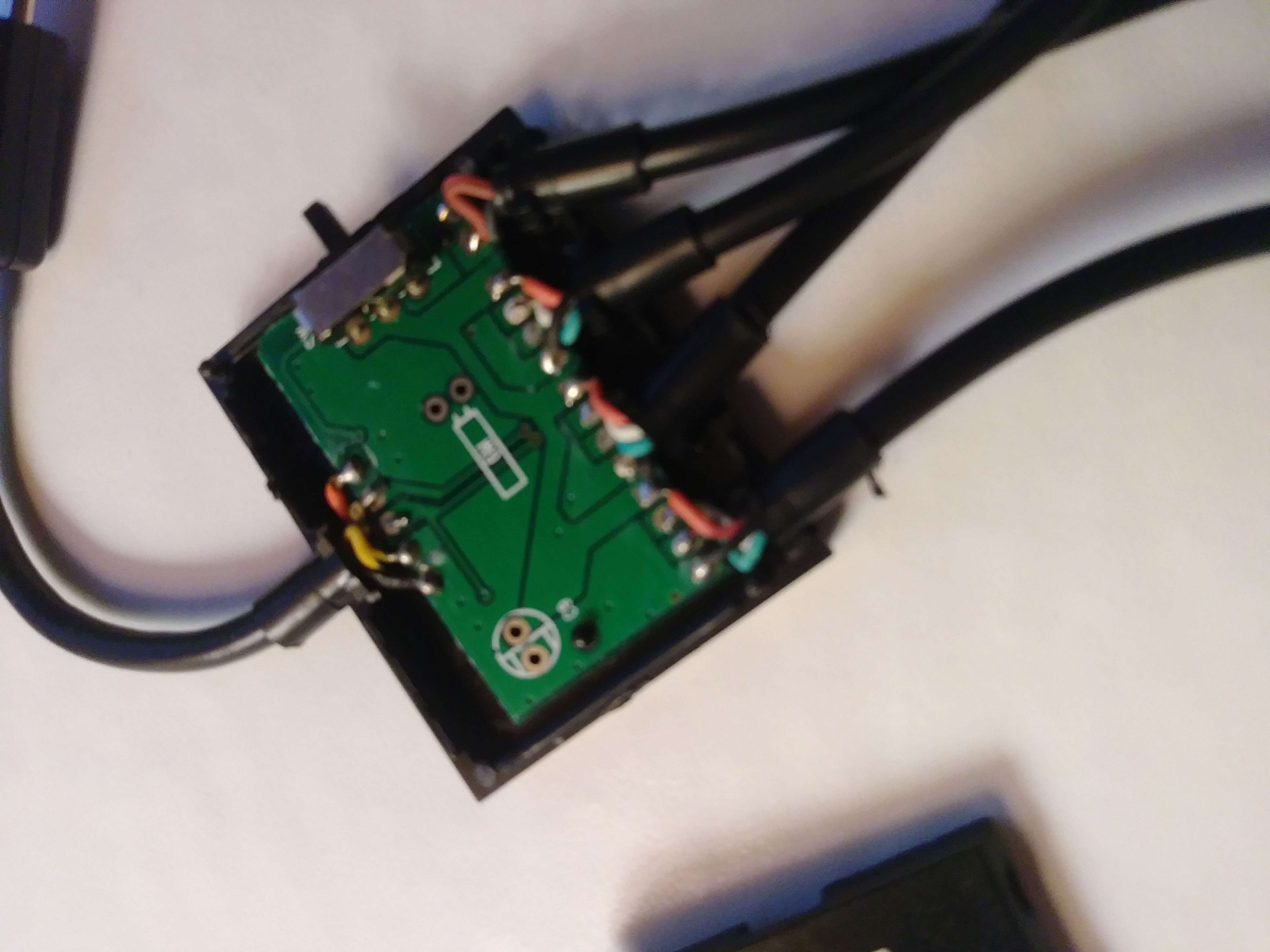

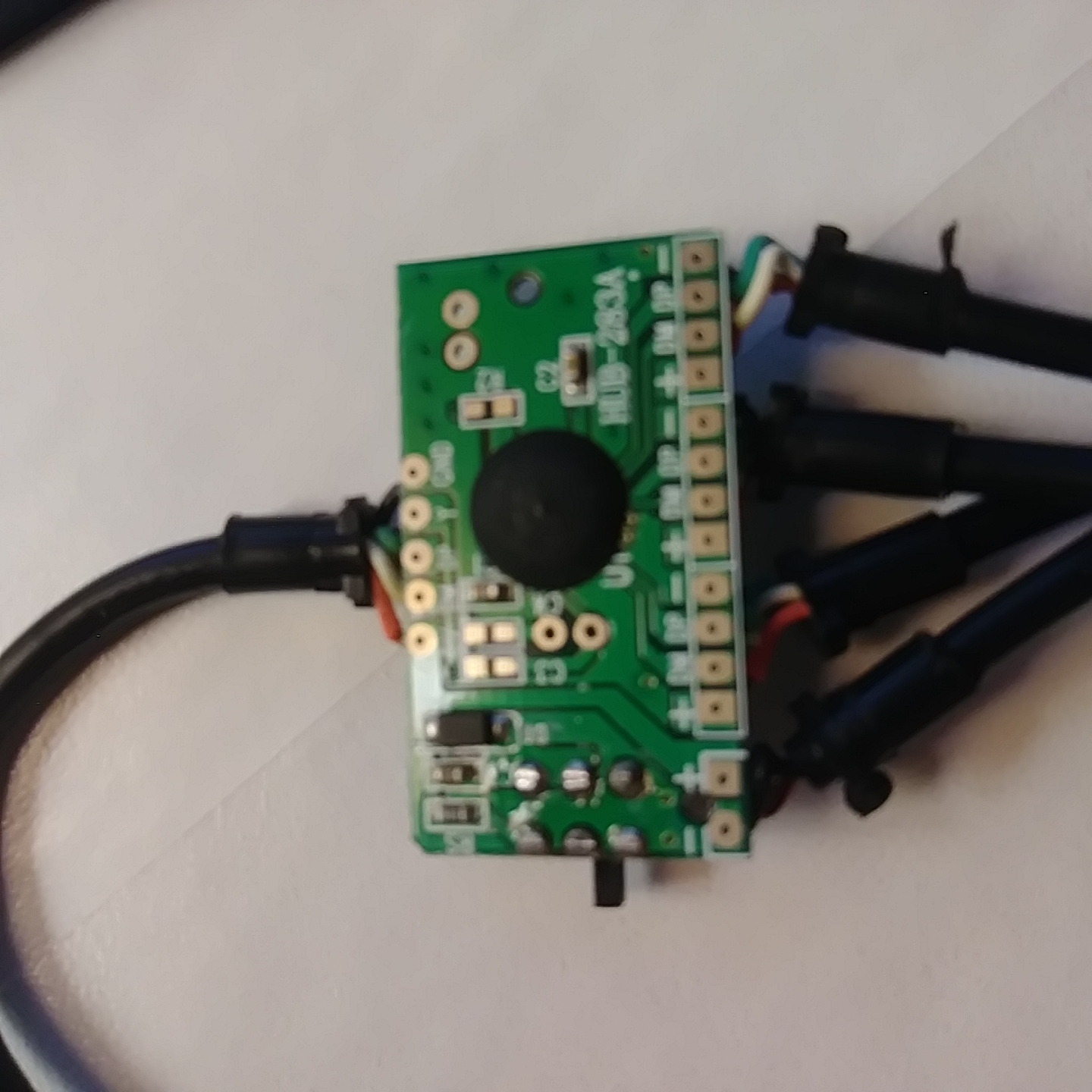

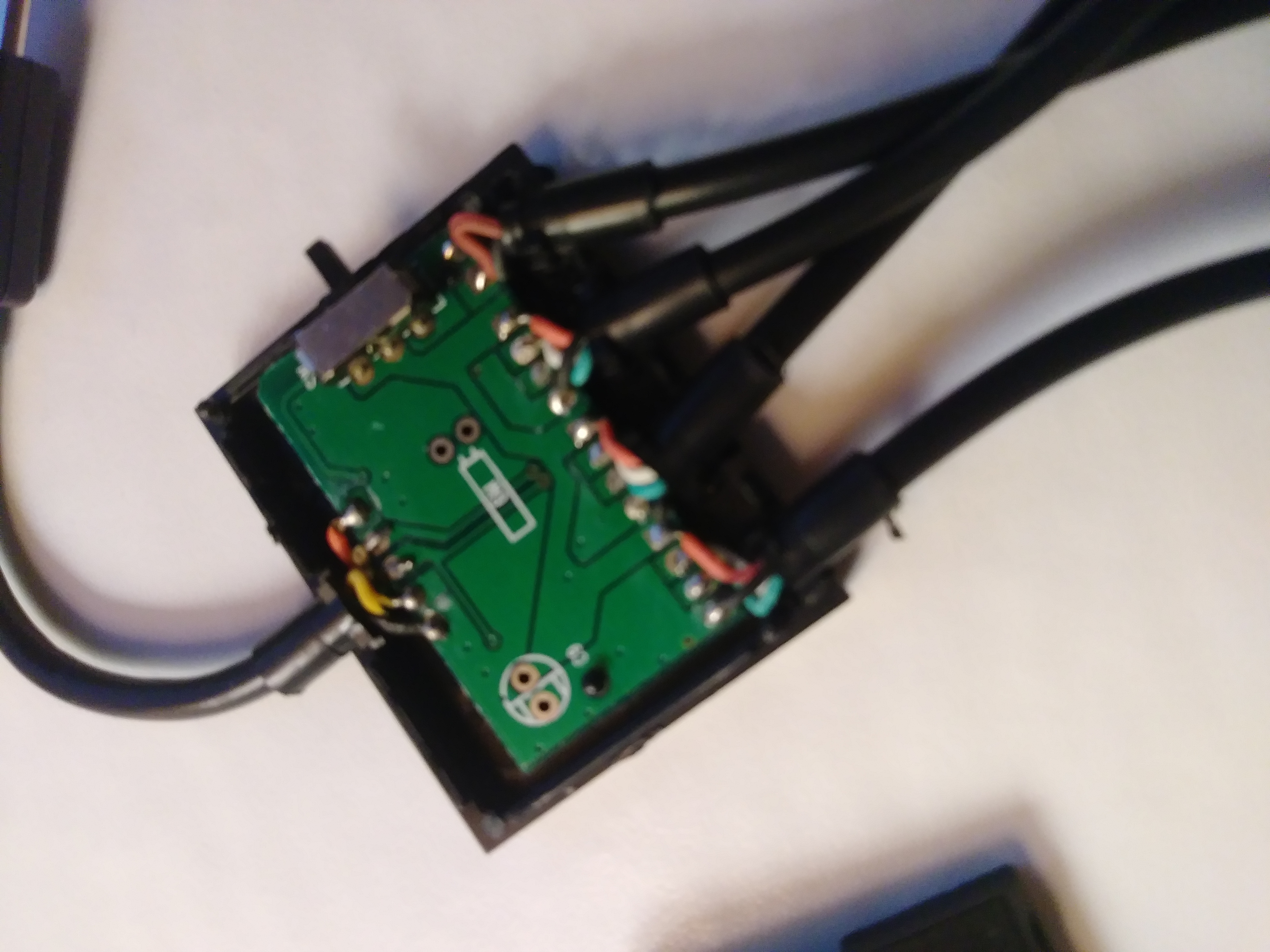

Hello,
I have a Otg I bought off eBay for my GBZ build. I bought a total of three hubs.
1. For inside (wireless keyboard chip, sound card, and Arduino for controller)
2. A two way to give me another port inside for the exterior port.
3. I got another three way so i could put it in the the 4 player adapter like this https://www.sudomod.com/forum/viewtopic ... eap#p15890
This totals a max of 7 ports (4 inside+3 outside) which is to much to power off of the pi itself. So i was wondering if i could convert them to a powered hub by putting the power into my power strip pcb. So that the only thing that goes to the pi is data, power goes in parallel with every thing else (fan, LCD, amp, ect.). I was not sure if this would work since it isn't grounded to the pi any more . :?:
Thanks for any help.
Links:
https://www.ebay.com/itm/Dual-Micro-USB ... 2749.l2649
https://www.ebay.com/itm/4-Port-Micro-U ... 2749.l2649
I says four port but one is a charge port :(
Re: Powering a Otg hub
Post by VeteranGamer » Fri Sep 13, 2019 3:58 am
your best option is to power the hub separately (just have the D+ and D- going to the RPi).....
especially with what you have planned....
I would also seriously consider your power supply options......
as once you also add a RPi and a screen (depending on which screen) to your setup...
I can see that you might run into power issues, where your not providing enough power to everything....
those hub can be very temperamental when they have not been supplied enough power....
you could find that one or some (if not all) of the ports become no responsive (don't work) if power drops....
