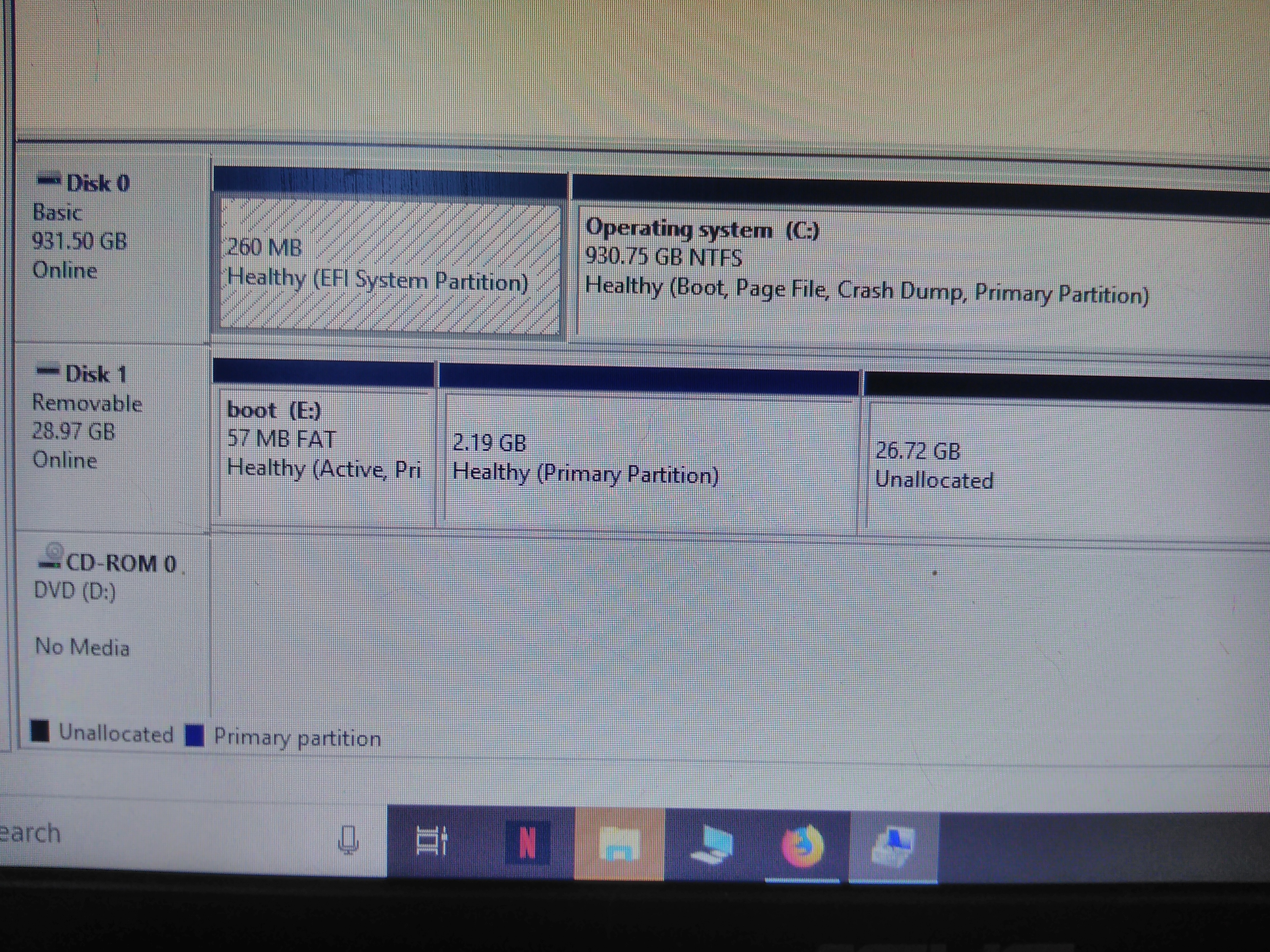

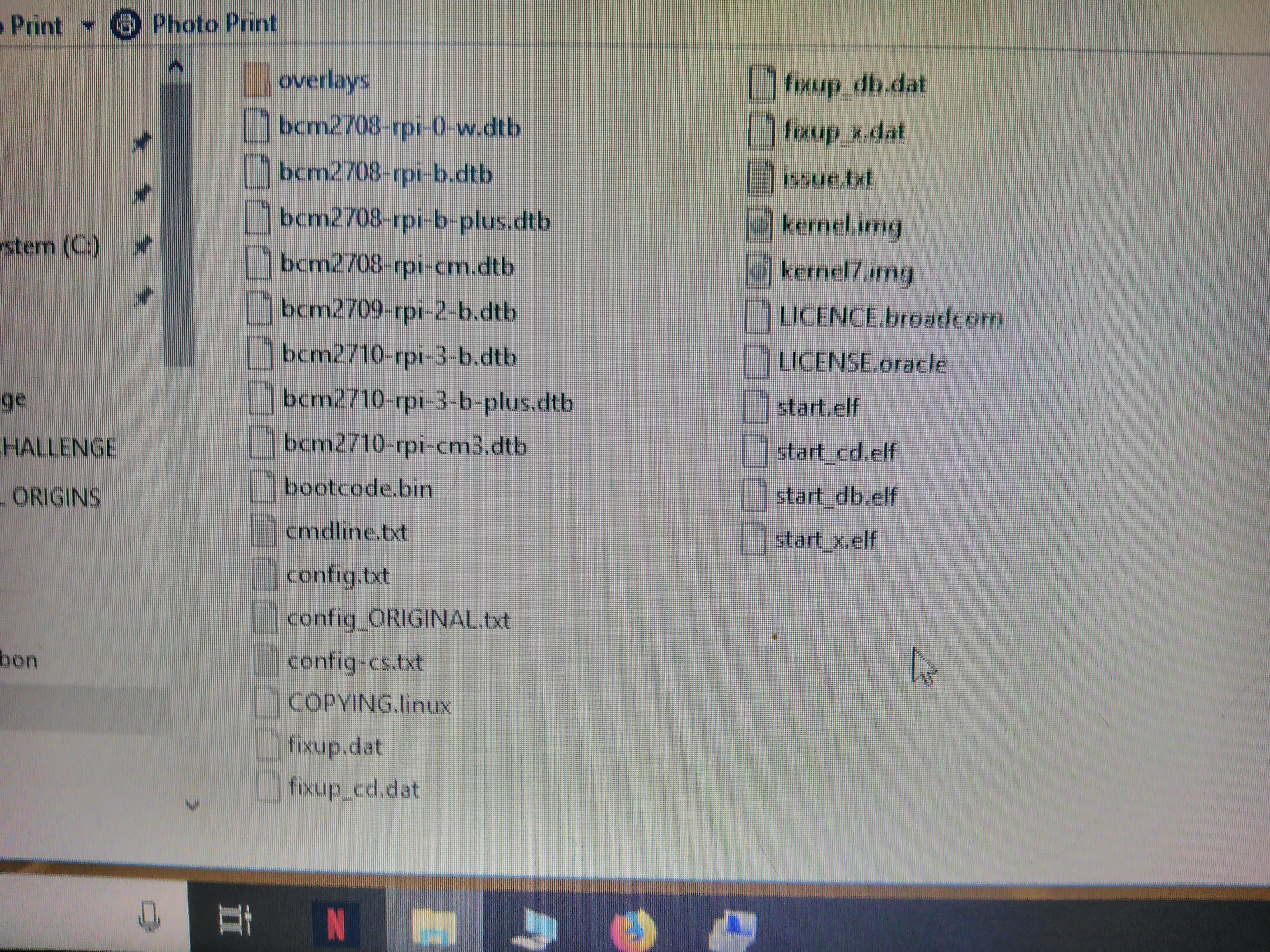

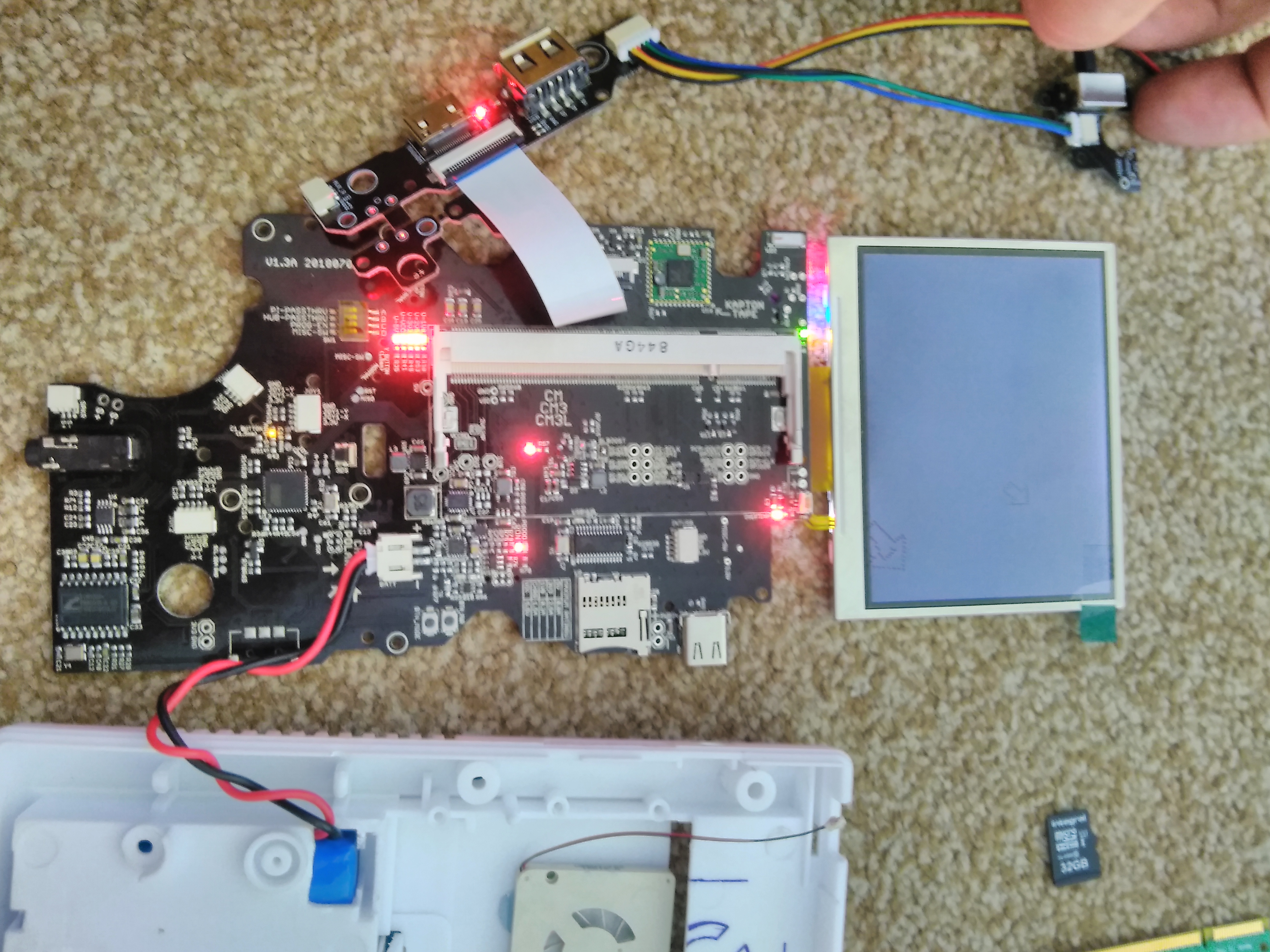

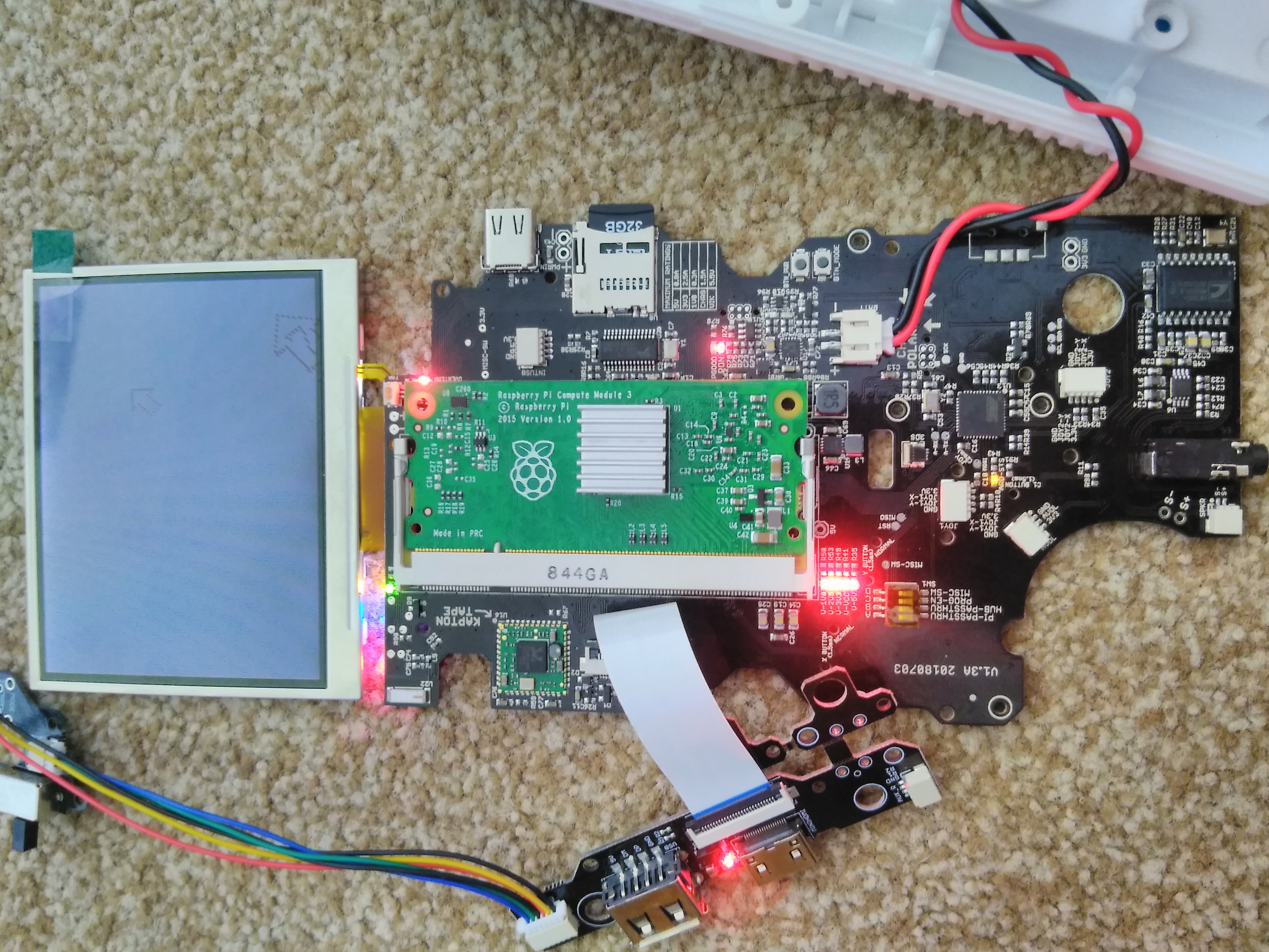

Could you swap to only using the 320x240 LCD for now until it is successfully booted. Can you post some pictures with it powered on showing all the LEDs? You don't need to 'format' the SD card at all. After you have 'imaged' it with win32diskimager, when you put the SD into your PC does it appear as a 58MB usb drive? And if you open it up does it contain a bunch of files, one of them being 'cs-config.txt' ?

Yes the SD card shows as a two partion removable storage 57mb odd labeled boot and a 2 gb with the rest the card showing as unformatted.

- Contents of SD
- 1568977592819-355012235.jpg (5.77 MiB) Viewed 6001 times
- SD card format
- 1568977502158-305234752.jpg (5.59 MiB) Viewed 6001 times
- With SD and cm3
- 1568977360252-1159272446.jpg (3.3 MiB) Viewed 6001 times
- Without SD and cm3
- 15689772708851116198913.jpg (2.73 MiB) Viewed 6001 times

Re: No boot kites curcuit sword v1.3a
Ok great all looks good, I suspect it is the SD card holder or the CM3, I've emailed you with return details and I'll sort it out for you

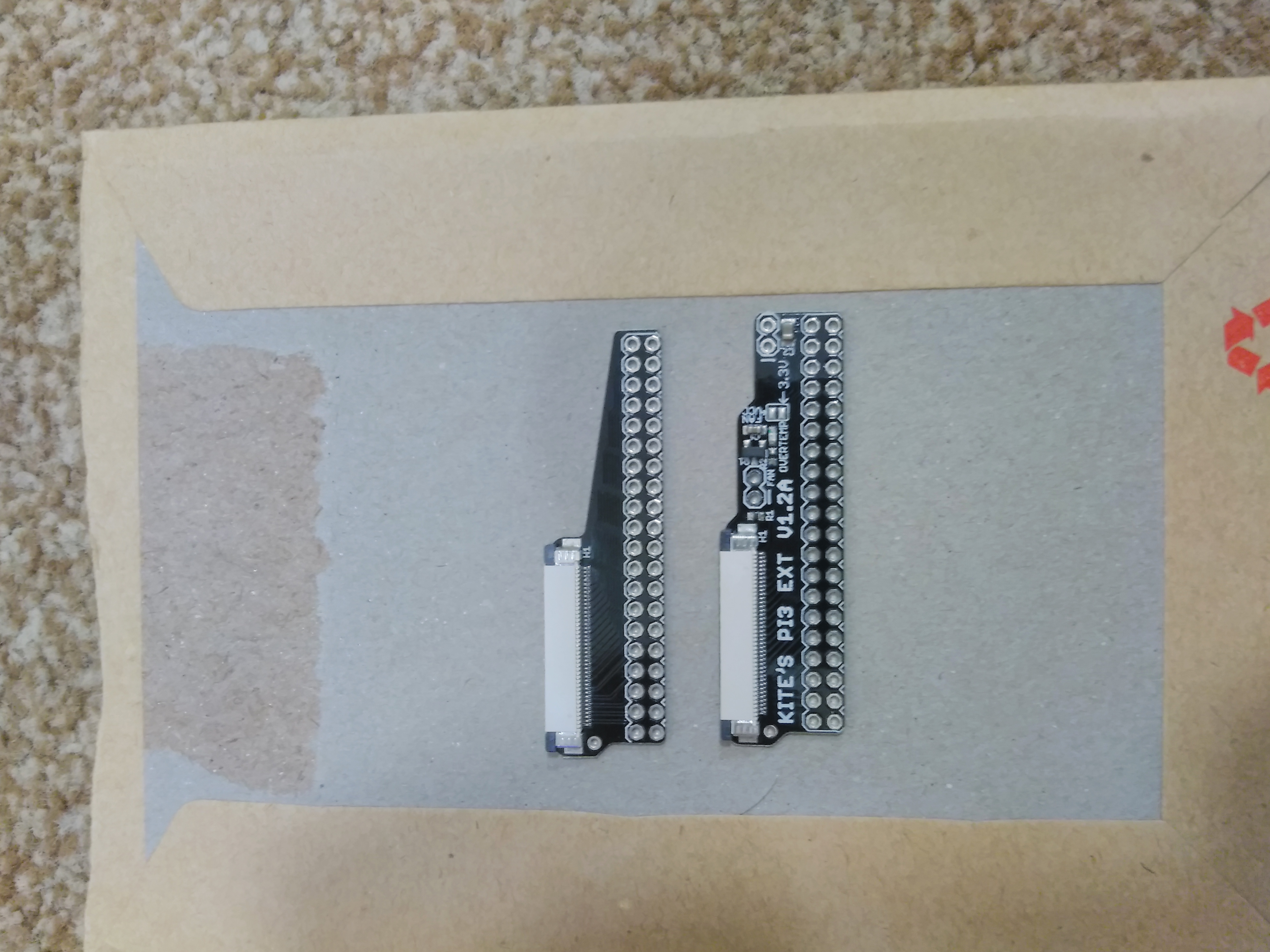

Another thing can you tell me what I should be using here ? I have a pair of pi3 extenders that I'm a bit lost on what to use in a separate build.
https://github.com/kiteretro/Super-AIO/ ... PI3ADAPTER
and
https://github.com/kiteretro/Super-AIO/ ... /PI3/PICUT
It's for fitting a Pi3 to a SAIO. I wouldn't recommend as it is difficult and error prone and I don't have any spares!
