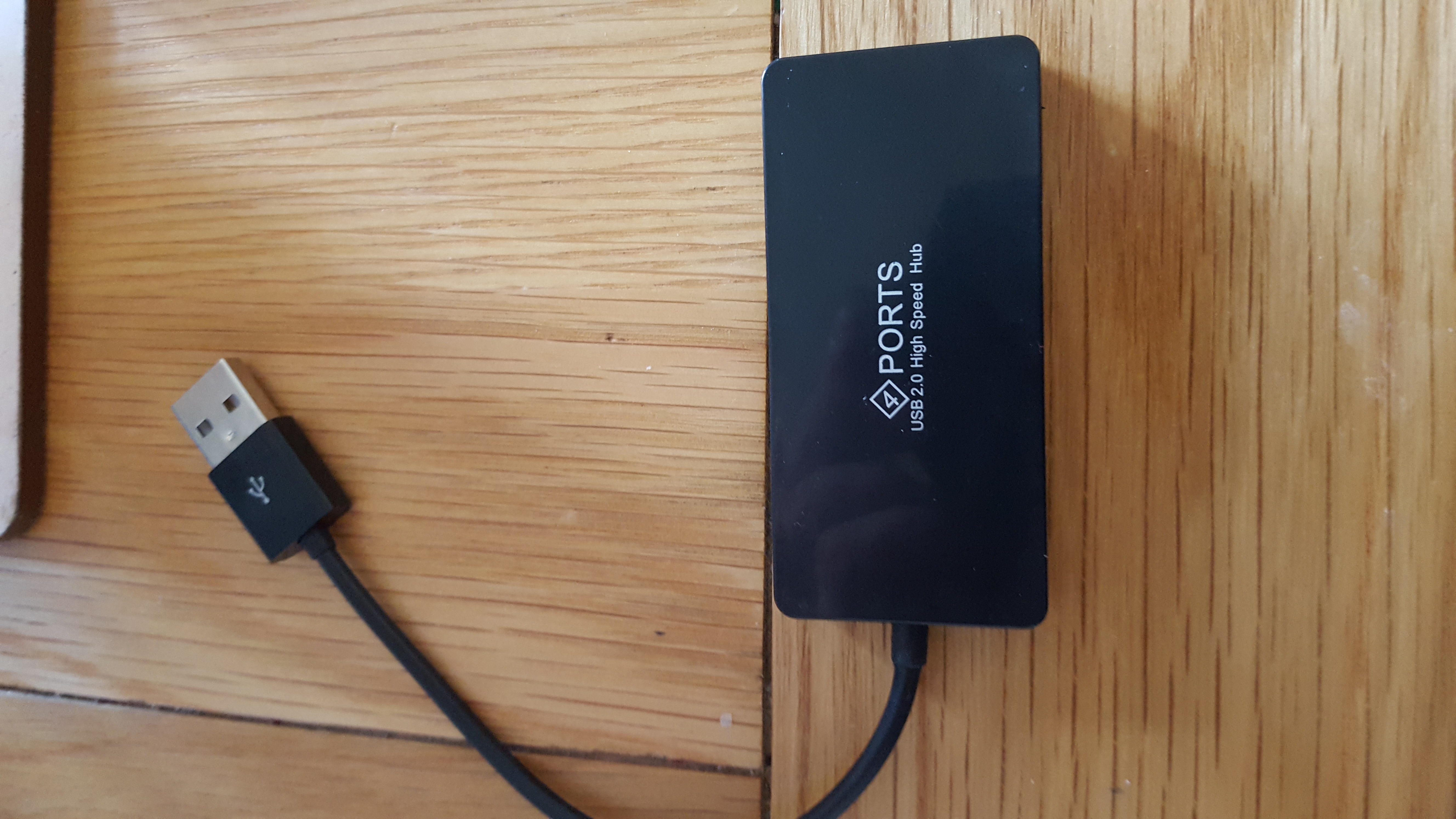

Has any one got this usb hub to work properly I can only get one port to work at one time e.g you plug in the key bored that will work plug in teensy it will work. Have them both plugged in only one will work.

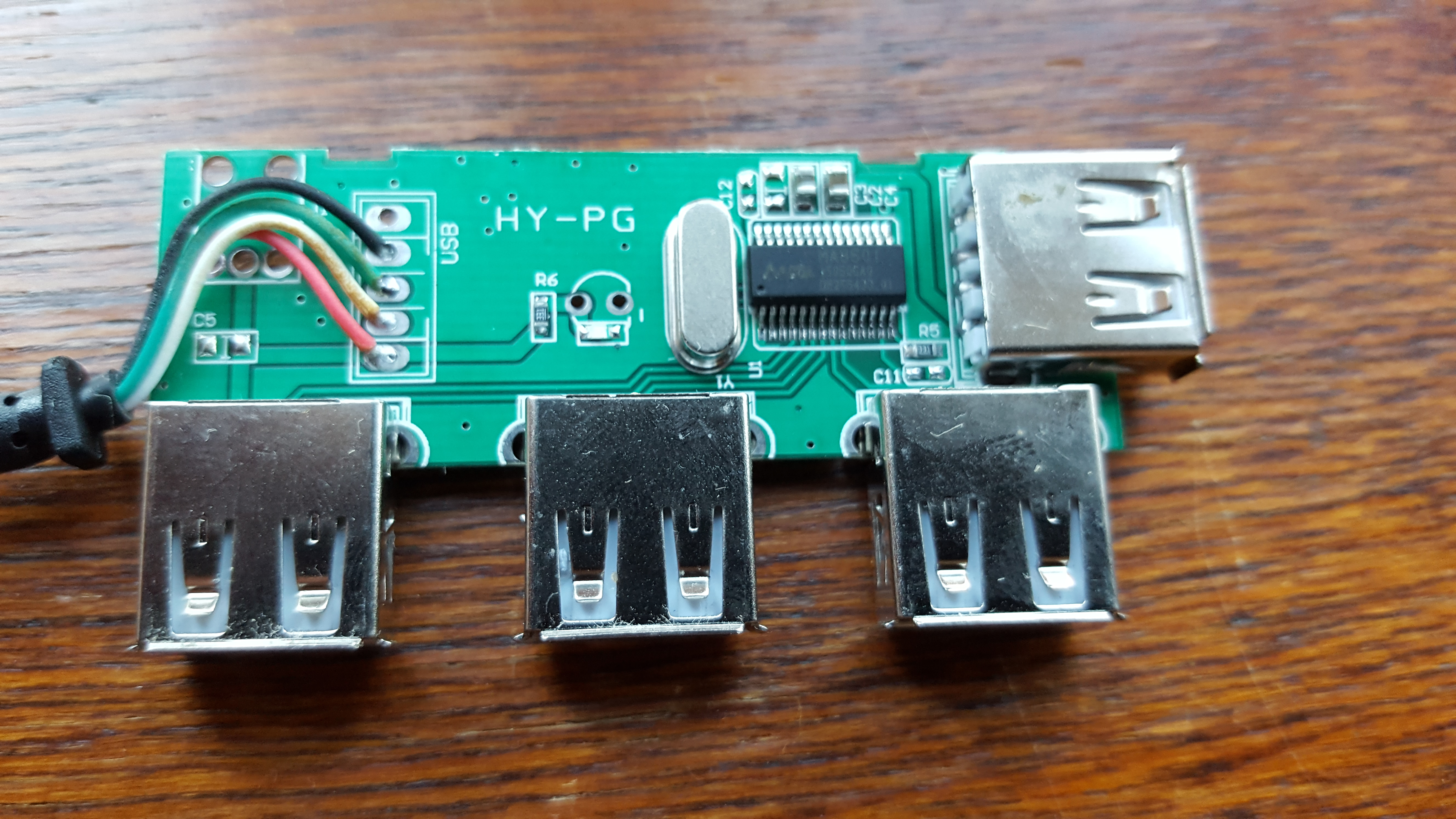

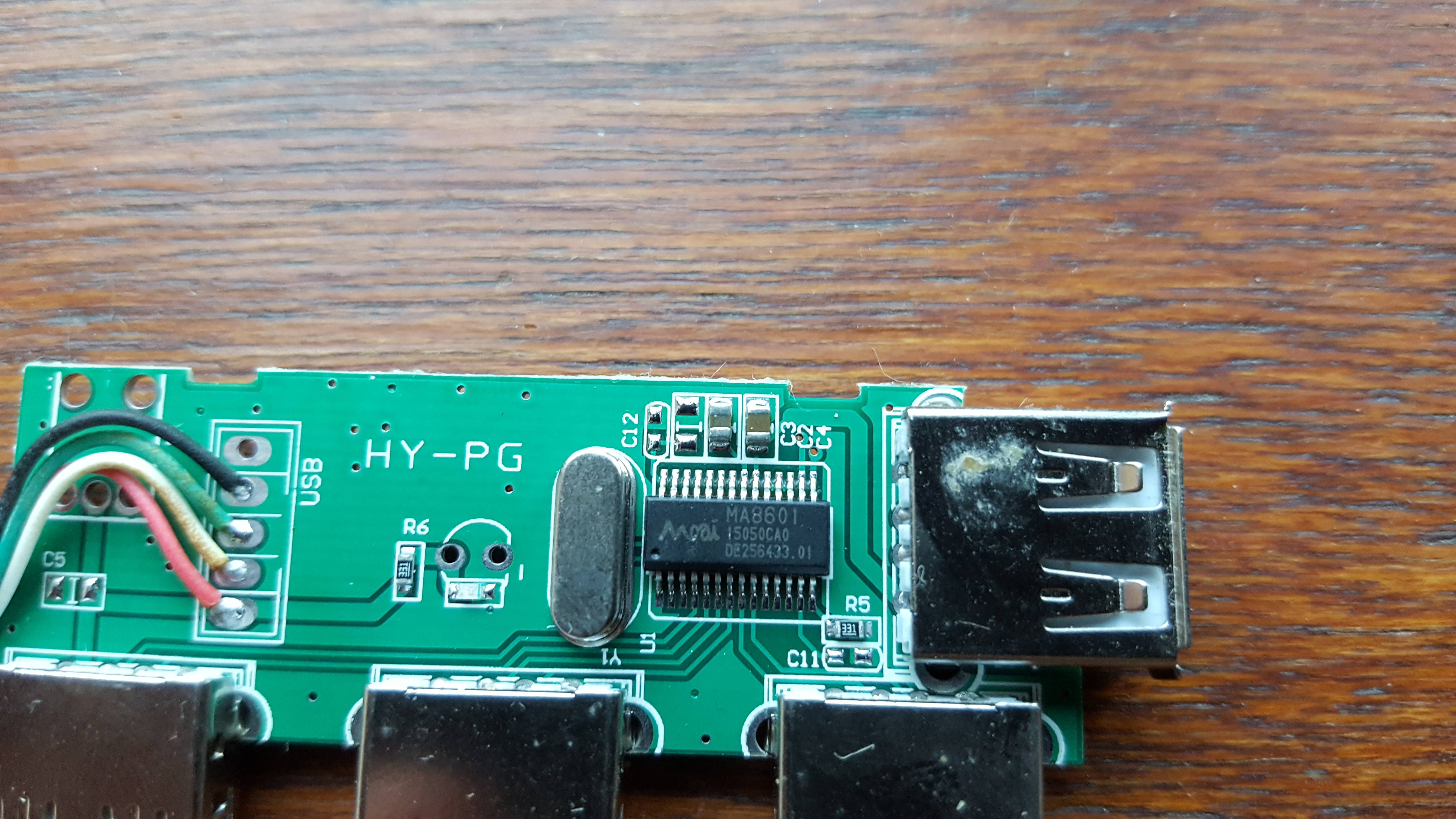

Post images of it's insides especially the chip inside and we can track down a data sheet with more information on it's operation.

This should be a good picHelder wrote:Post images of it's insides especially the chip inside and we can track down a data sheet with more information on it's operation.

The datasheet on that chip is garbage and no real useful info on it but I did find a raspberry pi forums thread on the same hub, maybe that can help a bit.
https://www.raspberrypi.org/forums/view ... 6&p=785153

I got that hub and it didn't work.
When I opened it up, the four USB wires were shifted over so the open pin was the one closest to the USB ports.
...and I suspect that hooking it up in that configuration may have fried my Pi Zero.
