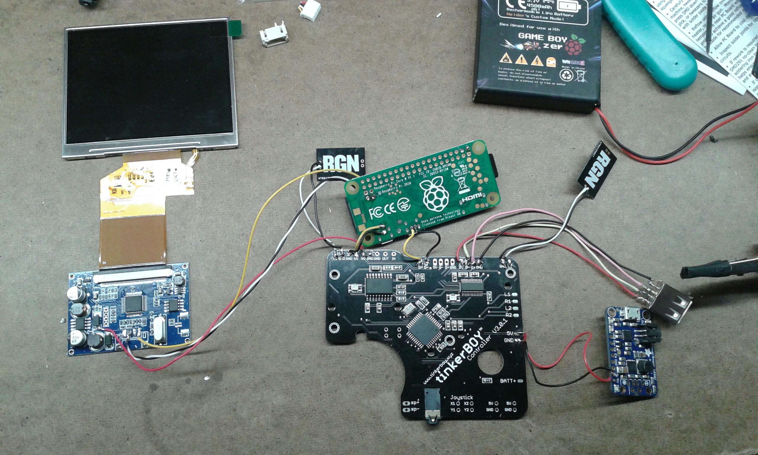

Hey everyone,
So I'm attempting to build a few GBZ's I wanted to gift to my brothers, but it seems every build guide I read is contradictory to the 1 before it. If someone could/would assist, I would be over the mood.
Here's what I'm working with:
tinkerBOY Controller V3
Adafruit Powerboost 1000C
3.5" Gearbest Screen Board

Thank you, VG! Before I run to try this out, could you please clarify what you mean when you say "Substitute the AIO point to your Tinkerboy V3"? I'm very much noobish and a lil confused by this.

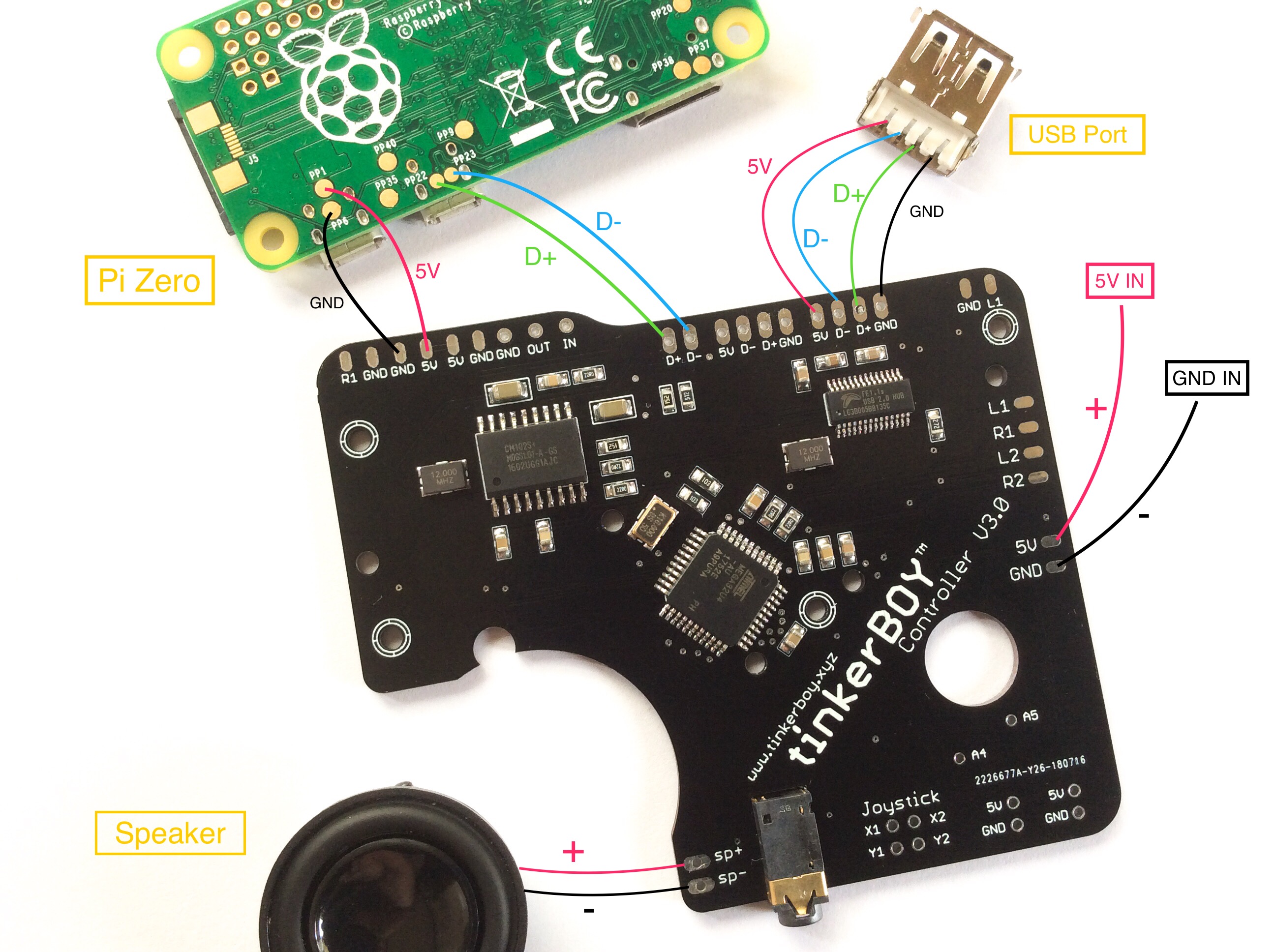

the power in and out points are different on both boards so wire/connect/solder accordingly.....
also the Tinkerboy audio is done via USB,so you just ignore the PWM connections and Volume wheel
https://www.tinkerboy.xyz/setting-up-us ... nd-output/
