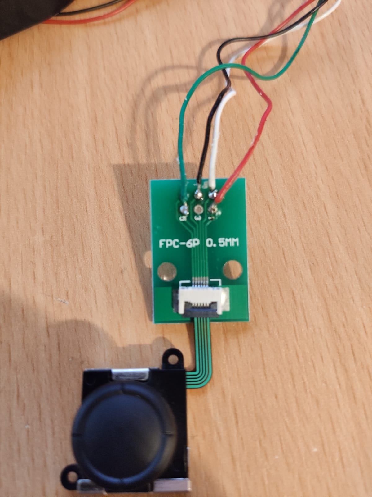

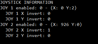

I would like to replace my PSP Joysticks for those joycons of the Nintendo Switch, but they are not recognized. PSP is working good but I would like to have real Analogsticks.
I bought 0.5mm 6pin FPC adapter that Kite recommended to me:
https://www.aliexpress.com/item/3290886 ... 4feeOWPYya
joy config.png (5.3 KiB) Viewed 12684 times
Any help would be really appreciated

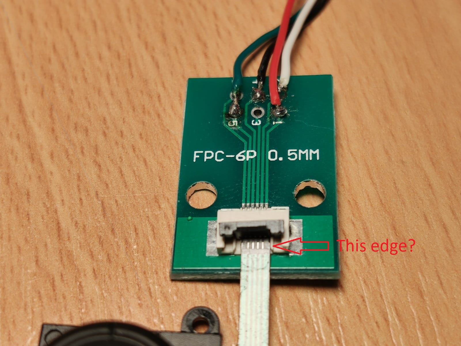

Is the FPC inserted against the EDGE of one of the sides of the connector? You need to be careful because the FPC is 5pin and your adapter is 6pin! So it needs to be moved 1pin to the side. From the pic it looks kinda in the middle

I have tried both edges and i tried to take a photo, is it like this what you mean?

Just in case you were still willing to try, flip the ribbon upside down, it's in the wrong way. I made the same mistake and now it works great!

Hi dont know if you have this figured out yet or not. But you have your joystic wired in pins 12456. You have a 5 pin ribbon cable pushed all the way to one side pin 1 on your board. It is impossible for you to use pin 6 in this configuration. If you double check your pinout and pretend pin 6 doesn't exist you should be fine. So wire to pin 12345 only. Hope this helps you. I just made a circut sword using joycon sticks and the exact same boards. So I know they will work for you. Good luck 👍
