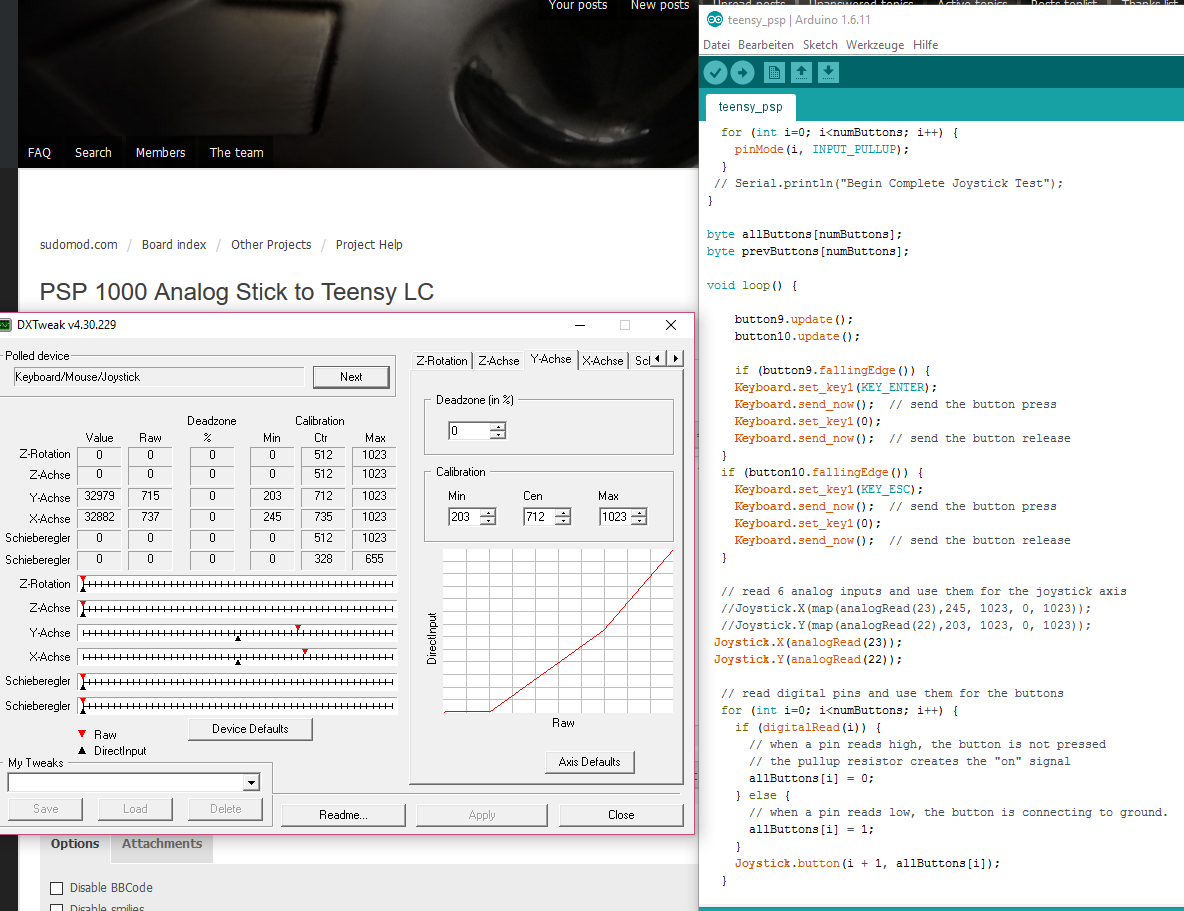

Hi, can you please tell me how you calibrated your Analogstick? The axis are not recognized probably. In Windows I was able to calibrate the stick using the driver properties in printers and devices. Is there any way to hardcode this onto the teensy? I noticed you added some calibration values, but those dont work for me. How did you obtain them?
I got through max values by printing out to serial terminal the values as I was moving the pots to the max positions.
But there is another way to automatically scale them. You can read the center position while powering up, then double that number and use it as max. It's easy change to do if you want autocalibration on power up.
Thanks
Thanos

Post by fdeluxe » Sun Sep 11, 2016 5:50 pm
[mention]tronicgr[/mention]
the map function only seems to remap the upper and lower bounds. But to calibrate my joystic I also net to remap the center postion. That means the mapping must not be linear. Here's what I mean:

Post by tronicgr » Mon Sep 12, 2016 4:22 am
The potentiometers are not completely linear, that's true but the travel distance is too small to make much difference.
You can see the piece of code I used to scale the values I read
Joystick.X(map(analogRead(0),170, 853, 1023, 0));
Joystick.Y(map(analogRead(1),170, 853, 0, 1023));
The lower value I use is 170 which is same as 853 (low and high position of that axis). This is then scaled to full range on the output 0-1023 that the Joystick needs.

fdeluxe
Posts: 71
Joined: Tue Aug 23, 2016 10:16 am
Been thanked: 27 times
Re: PSP 1000 Analog Stick to Teensy LC
Post by fdeluxe » Mon Sep 12, 2016 6:24 am
@tronicgr
My problem is that the max raw value of my stick for both axes is 1023, while the lower values lie somewhere near 200. When I remap like this
map(analogRead(pinX), 200, 1023, 0, 1023 )
the Stick is way of center. My thought was to add 1 maxValue to the low value and use it as fromHigh
map(analogRead (pinX), 200, 200+1023, 0, 1023)
Now the stick is centered, but it doesnt move over its full range.
Did you have a look at the screenshot I posted? The high and low values are noted in dxtweak
