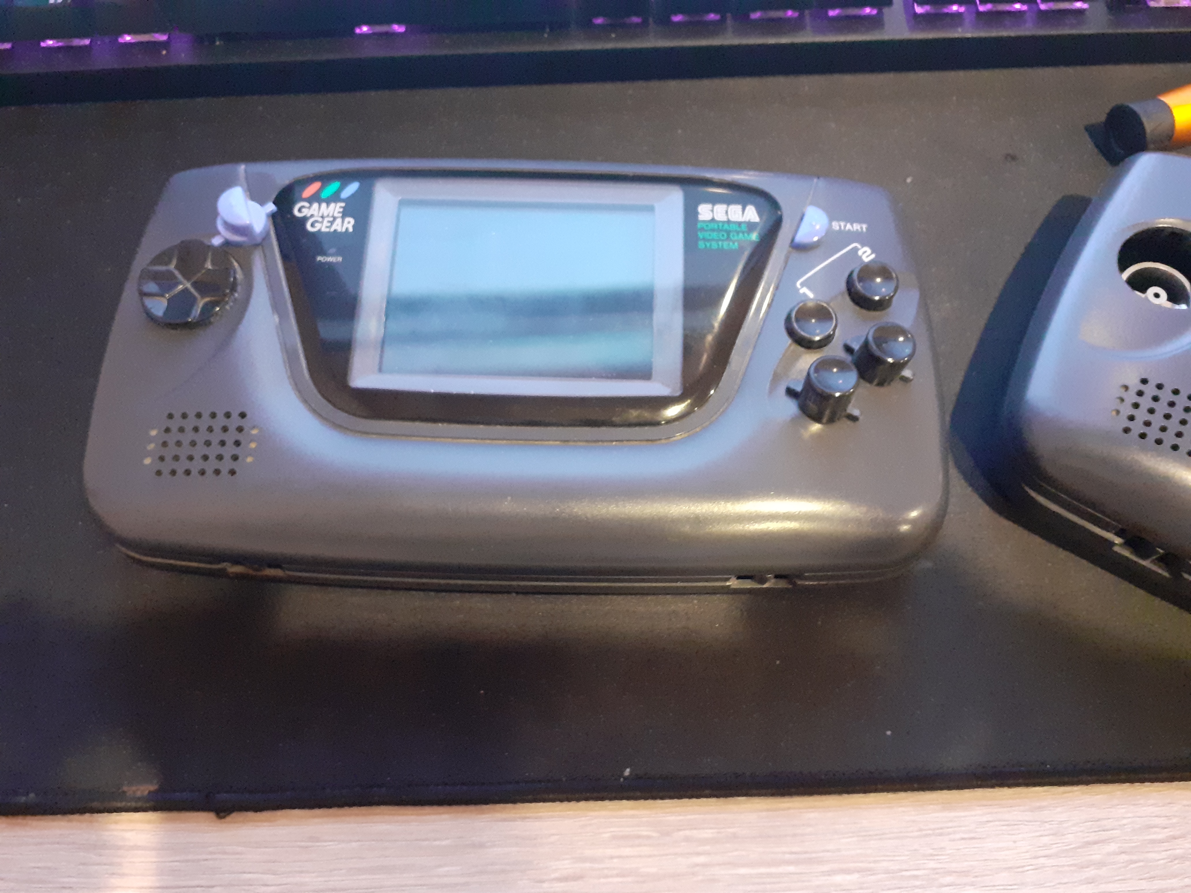

Here's a picture of the game gear with the additional buttons sitting where I think I want them, will also add left and right shoulder buttons. Apart from that I shouldn't have to make any other modifications to the case hopefully.

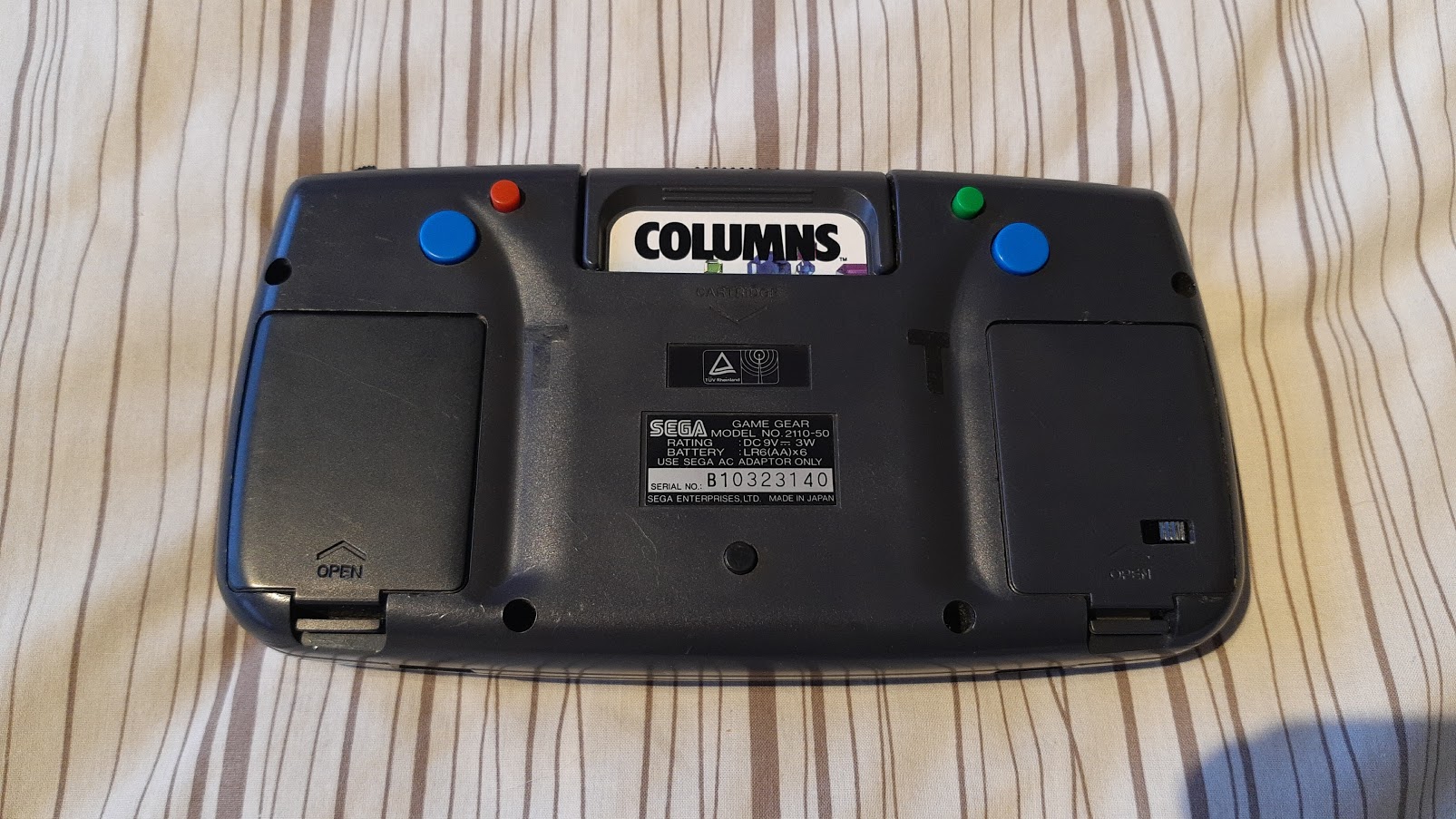

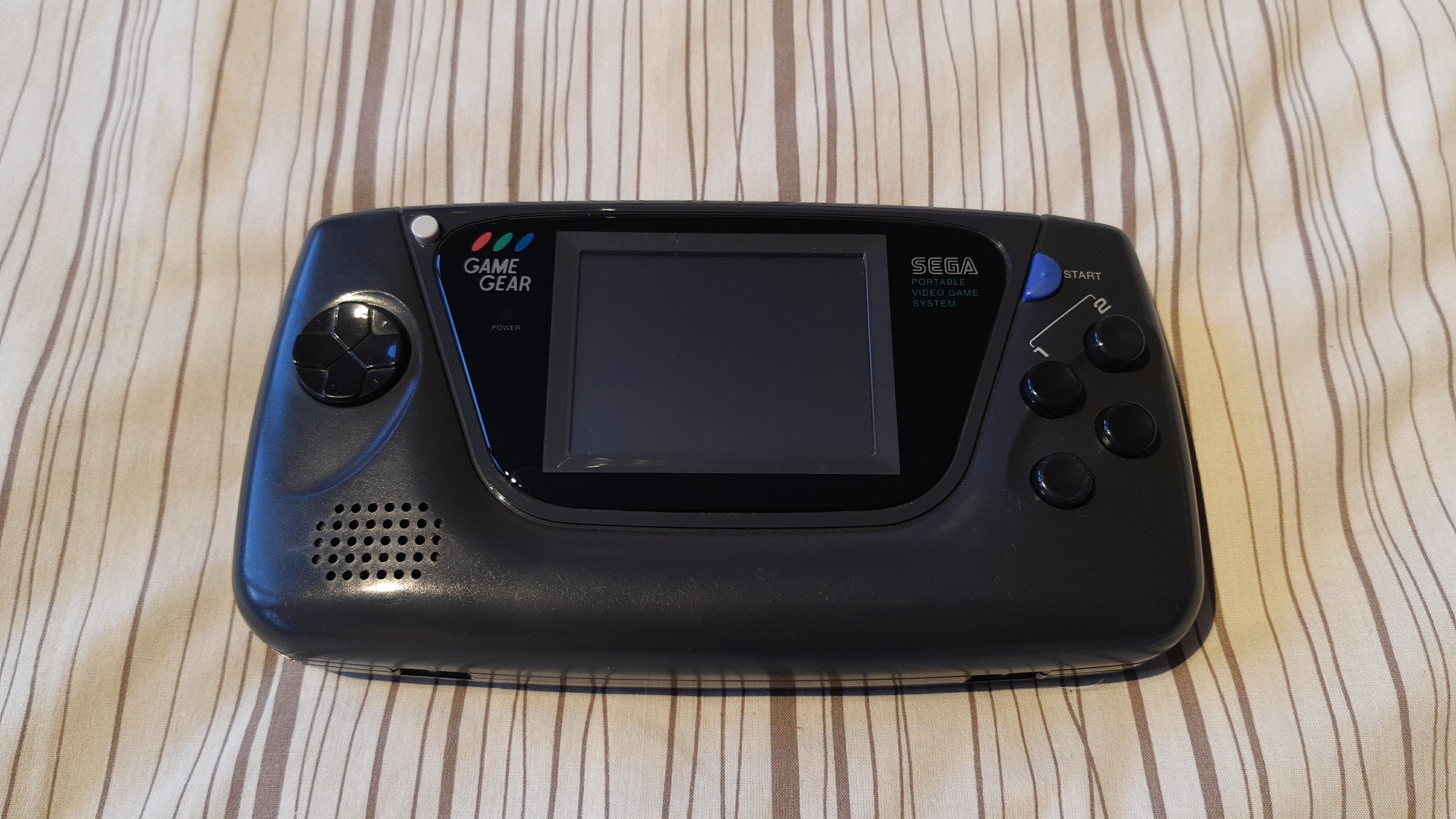

Ive made two of these myself, and i can personally say, you have a lot of work ahead of you.
I found HDMI ribbon connectors/headers and it made everything "easier" but i found the only way to make a display fit well is to install it upsidedown and change the settings in retropi. the drawback is the viewing angles are a bit odd and take a little bit of getting used to, the effect can be reduced by increasing the brightness, but in my experience its just something to get used to.
You will also need to remove the coating from the inside of the game gear shell, its entirely conductive.
I can recommend the adafruit button boards to use in this project, they work with the original buttons and rubber contacts, spare official buttons are very rare...
Sorry if the images are big...
Good luck, let me know if you want any help!
(This one is for sale if anyone is interested, let me know!)
Nick.
Nick.

As to power, im using a powerboost 1000c to good effect with 2 2000mah lipos giving 4000mah, ive also set up osd power meter with a cobled together ADS1015 from a tutorial somewhere in the sudomod DMG-01 build (hoolyhoo?)
I never did get the "headphone plug in turning off the speaker" thing, so the slide switch in the rear battery cover is to turn the speaker on and off (its just a audio jack splitter, plugged into a usb sound card with a switch inline with the standard speaker)
nick.
nick.
