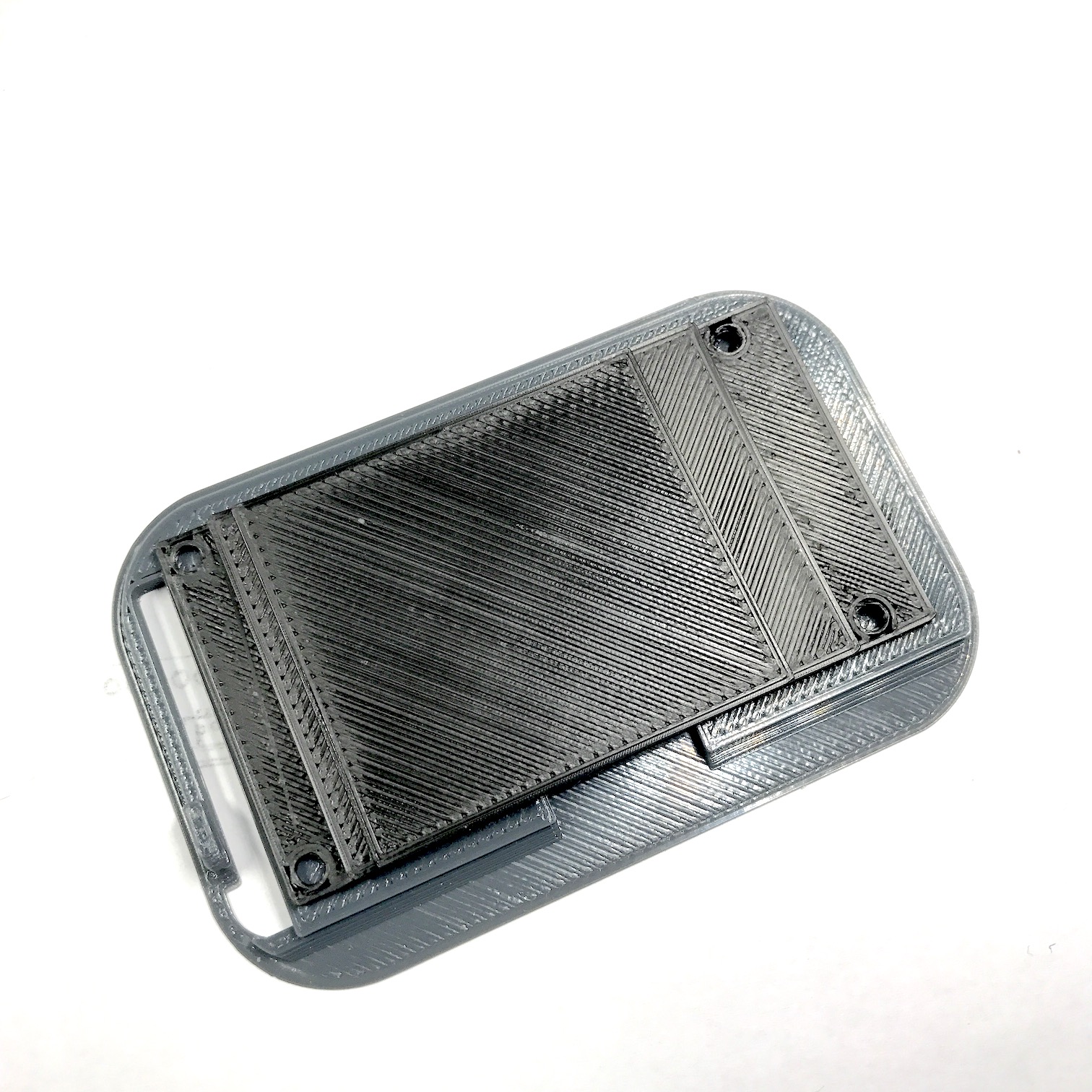

  • 2.4” screens are much easier to get ahold of, but the board that comes attached to those screens is just too big to fit in the parts I designed for the lid.  I could make it just barely fit, but the screw holes won’t be symmetrical, and the screen will be off-center, which is gross.  There’s just no way around it – here’s a 3d-print of one of the 2.4″ screens as I don’t have one in-hand yet:

  • The bare 2.4” screens (meaning no pre-attached board) are widely available and can be bought cheaply, even in bulk (as well as one at a time).  It should fit very nicely (even better than the 2.2” version) with some slight modifications to the bezel design.
  • The solution Helder and I came up with was to use the bare 2.4” LCDs, along with a small custom board.  He and I both have 2.4” screens on the way for testing, and should have the designs for the screen board finished in the next few days.  This will let us connect the screen to the pi using a nice, clean ribbon cable.
