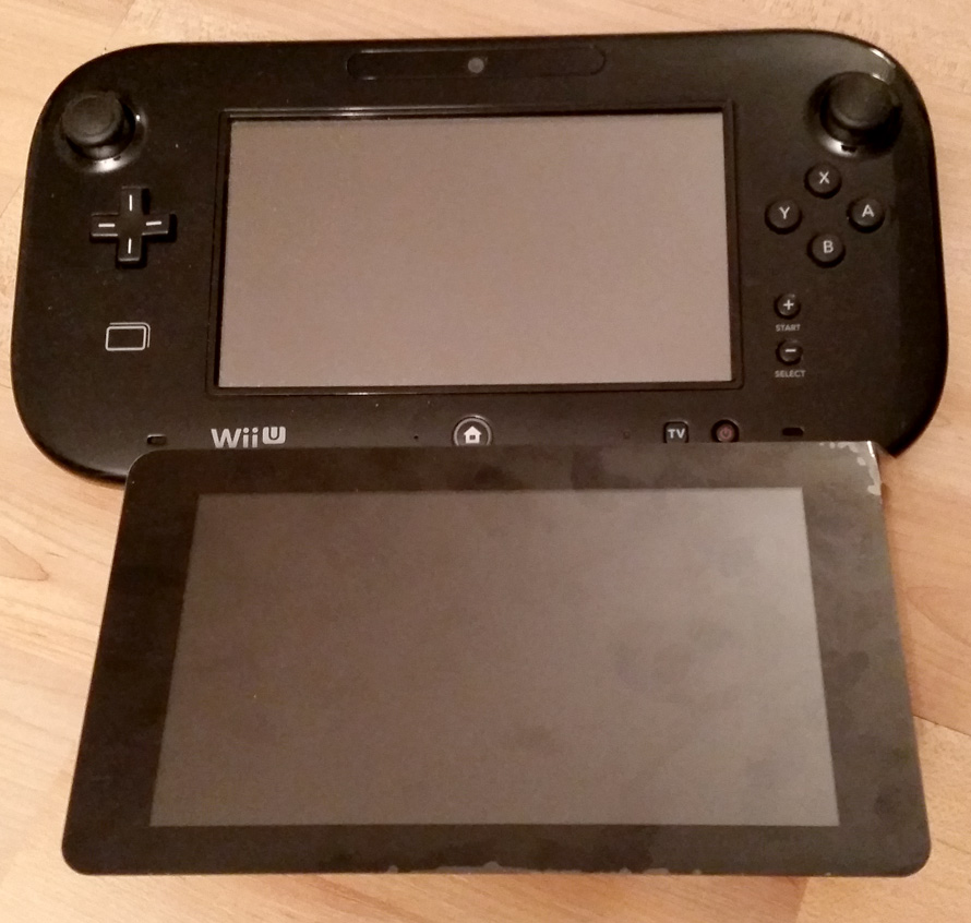

Just wanted to compare the gamepad to the official raspberry pi display. 6.2 inches vs 7 inches. Probably too big right?

Flowlance wrote:Just wanted to compare the gamepad to the official raspberry pi display. 6.2 inches vs 7 inches. Probably too big right?
Well, either cut it down if possible and trim the visible area to match the cutout of the wii u case or make a bigger cutout :)
