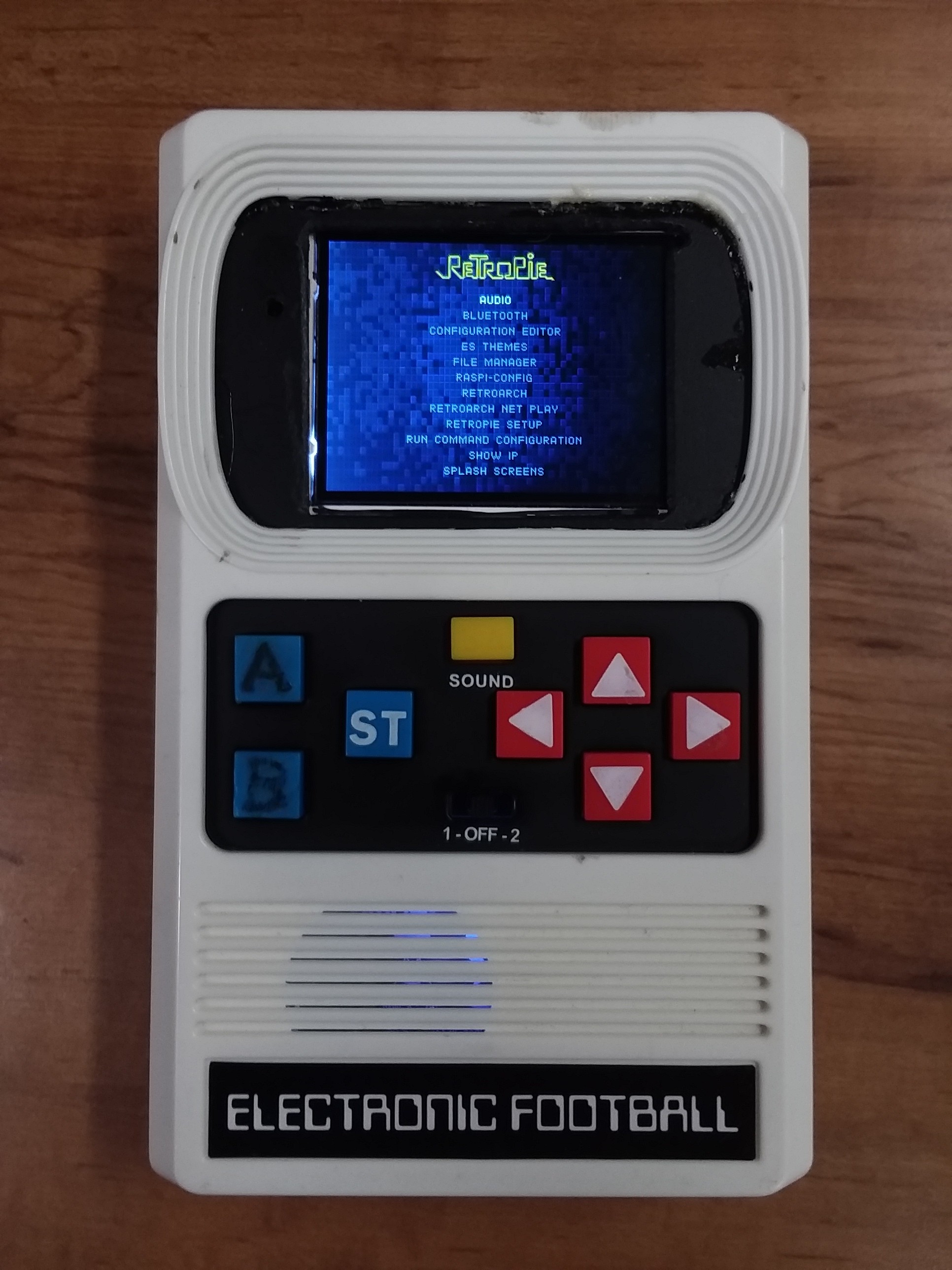

Found this handheld game for $10, made it into a gameboy zero.

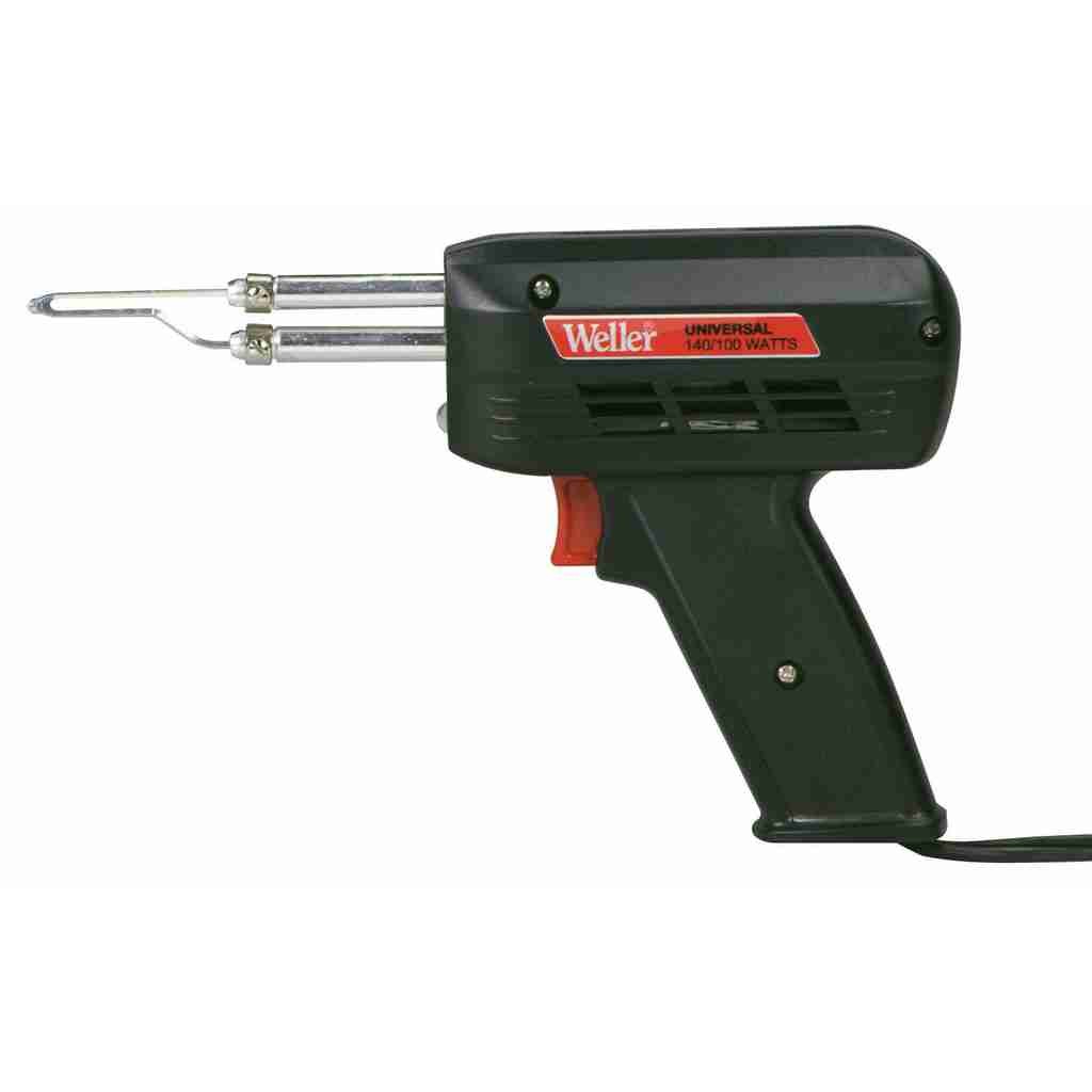

my resources are limited, i didnt have a fine tipped solder gun at my disposal so i was using one of these, a real headache but with much patience it worked!

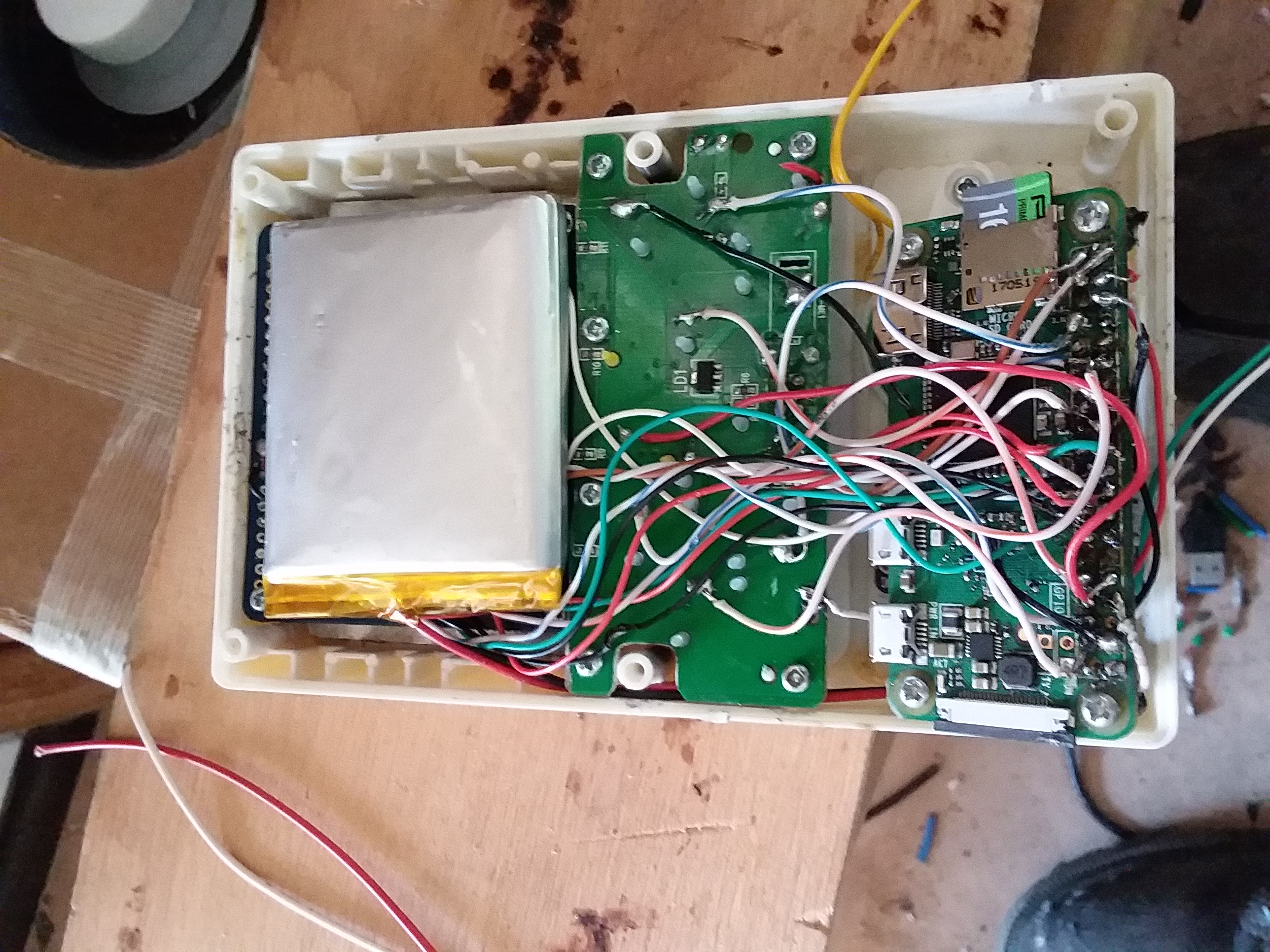

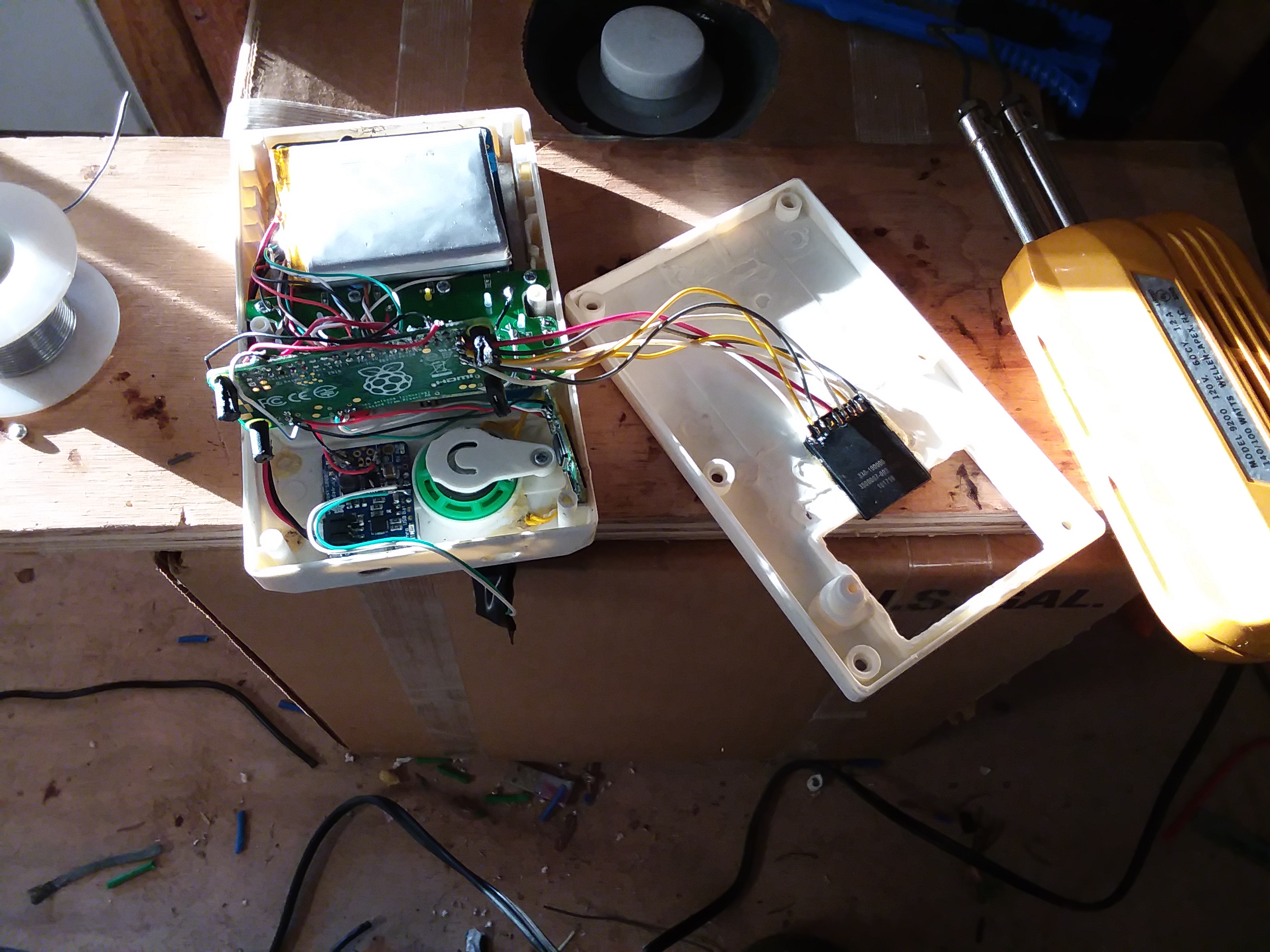

some more pictures of inside and how i put the sd card reader
