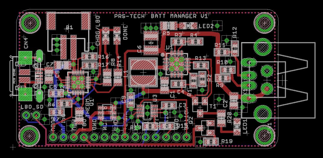

Here is a demonstration of the Power-path controller working with the Pi. This is without the battery, but everything will work the same with a battery. PCBs have already been designed and ordered with the Button/switch controller integrated with the battery charger and boost controller. It is a little bigger than the powerboost to accommodate the extra components. Ill be looking for a couple people to test the boards in the US once they arrive and I have them built. I will write a tutorial on how to wire them up and how to configure Retropie to work with them once I have the proto-boards in house.

Count me in as volunteering to test. How much do you think these would cost? And it does the same thing as the powerboost including playing while charging?

Ganreizu wrote:Count me in as volunteering to test. How much do you think these would cost? And it does the same thing as the powerboost including playing while charging?
Yes. All other functionality will remain the same.
