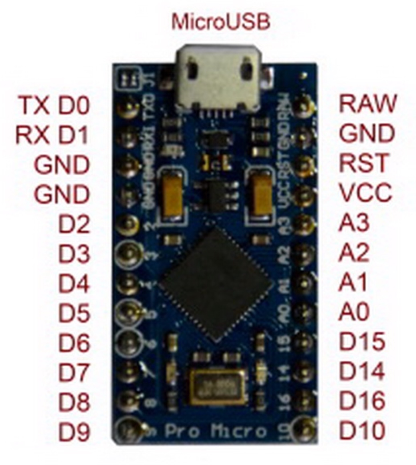

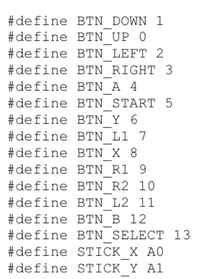

So if i load your hex files to a teensey LC, they will work without modification? Sorry, I'm really new to this.
looks like on the teensey, I need pins 10 (CS or any pin I read) , 11(MOSI), 12(MISO), and 13(SCK) for the usbasp. ADC0 is just Analog pin 0 right (pin 14)?
and lastly, is there a way I can tell which pins helder used as to which pins I need to use on the teensey to make sure Im using the correct pins for control input?

The pinouts would need to be adjusted on the hex file. These are the pinouts Helder uses on his board.
And this is the pinout of a Leonardo pro micro
As you can see the there is no 11, 12, or 13 on the micro broken out. So that would need to be adjusted as well as ADC0 for the battery monitoring. I test on the Leonardo all the time. It's not an issue. Just adjust as necessary.
