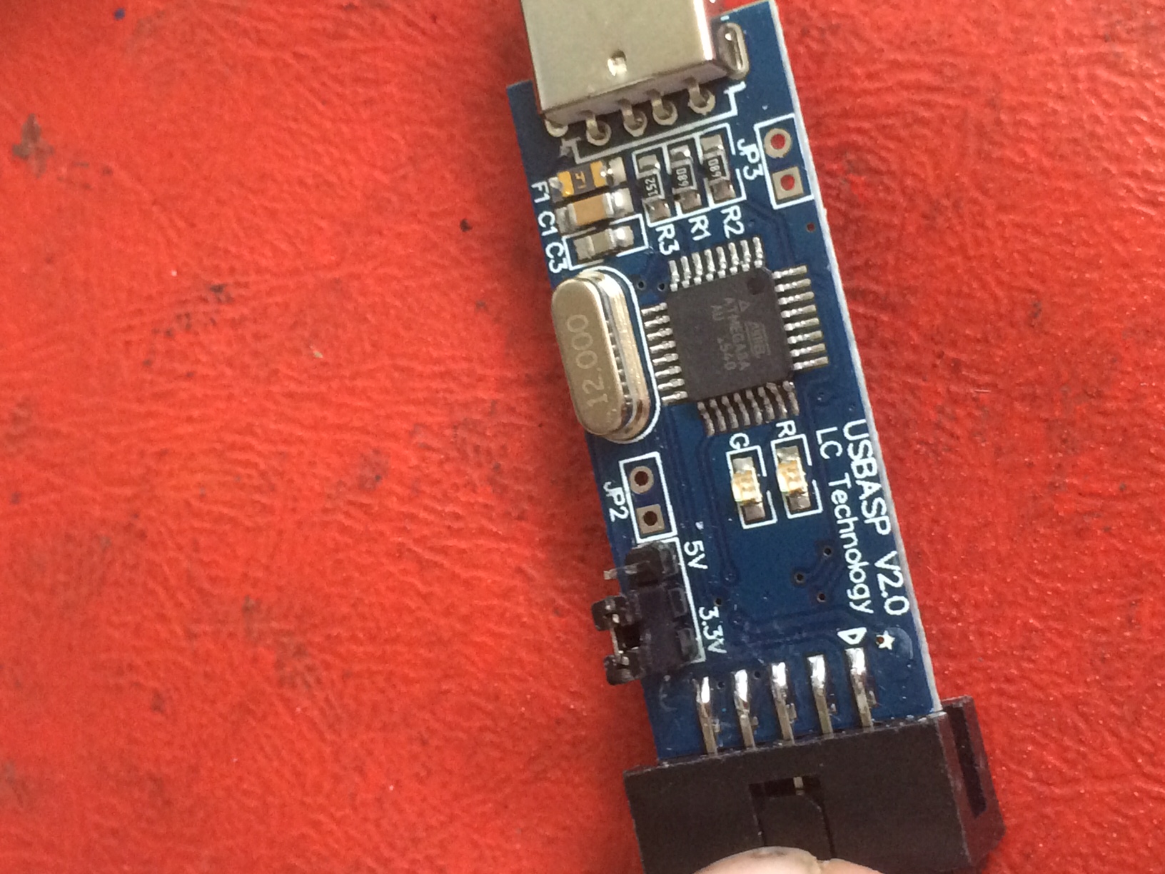

PotaTox wrote:@Helder Will this USBasp programmer work?
I'm having a hard time, because it always gets out of bootloader mode before it finished uploading. It happens in less than 8 seconds for me.
It should work, if it says USBasp in the title it's all good. I ordered my first one as some generic AVR programmer and it didn't work with AVRDude or many known programming apps so I ended up reprogramming it as a USBasp.

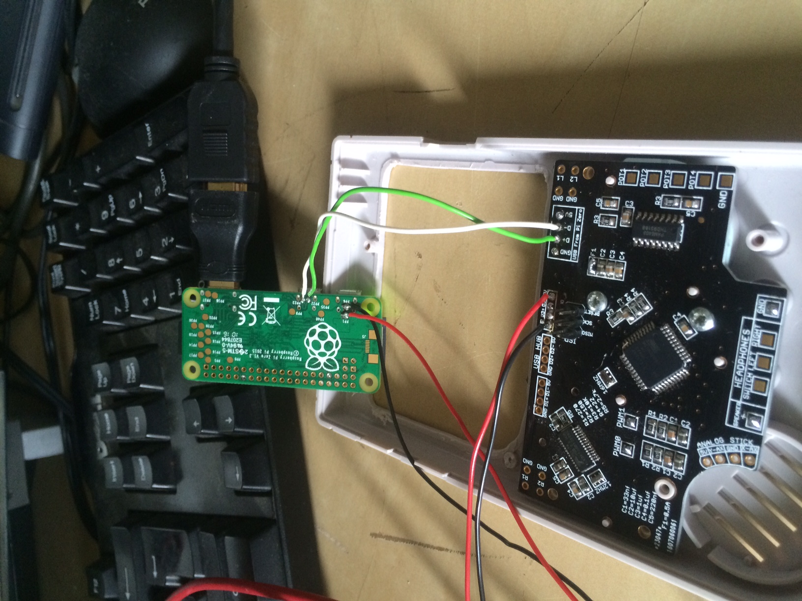

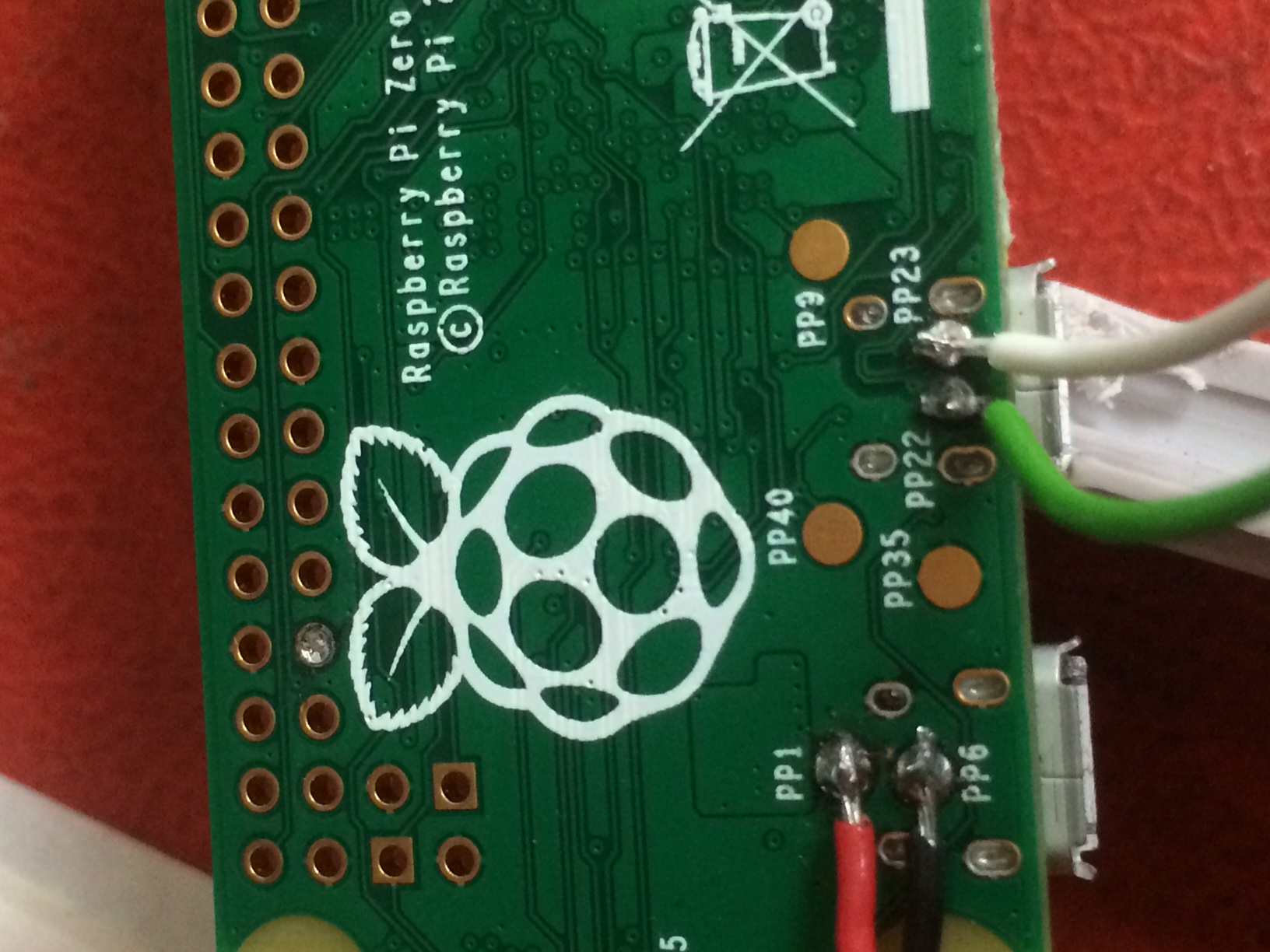

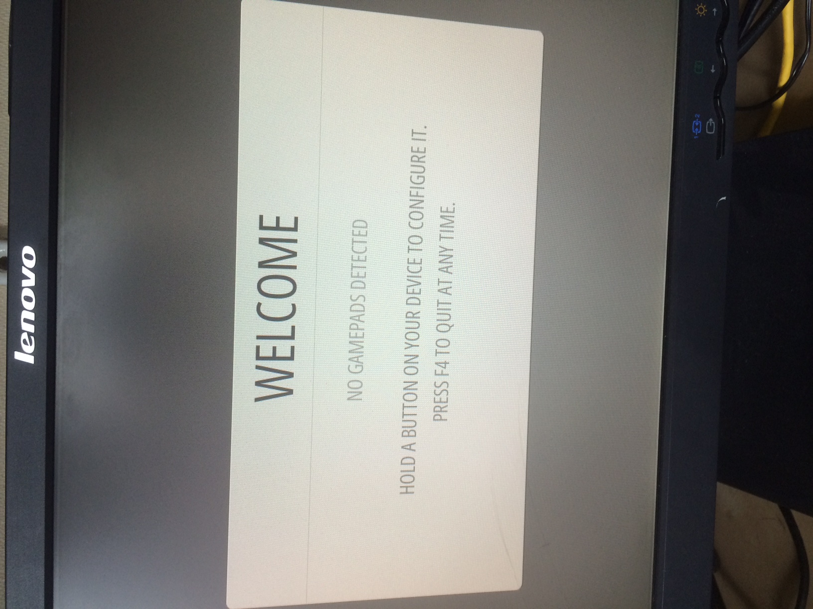

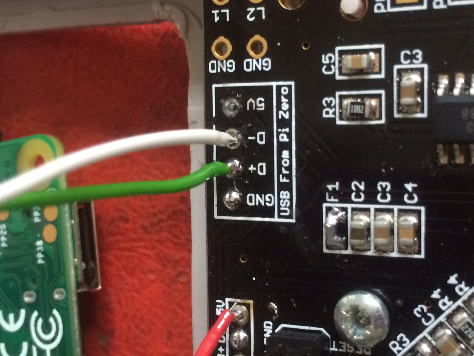

My USB programmer arrived today. I have loaded the no analog gameboy sketch and uploaded using programmer option.
It compiled and seems to have transferred ok. I'm not sure what if anything I have to do about the boot loader?
I connected back to the pi
D+ (green) to PP22
D- (white) to PP23
I have an exteral PSU (4 amp) which I have connected to the USB from pi zero +5v and ground and also the pi zero itself PP1 and PP6.
I have clean install of retropie but still can not recognise any controller connected :-(
Maybe this is something to do with bootloader?
[color=#8000BF][b][size=85]https://www. ... b][/color][/size][/size]
Re: How to Program Helder's All in One GBZ PCB with Arduino IDE
Post by Helder » Thu Aug 11, 2016 7:27 am
I'll post a mini guide later and plug the 5v and GND in the same Boxed area that says USB from Pi Zero that has filtering for the power and you want the power as clean as possible, the hubs get filtered 5v from that location.

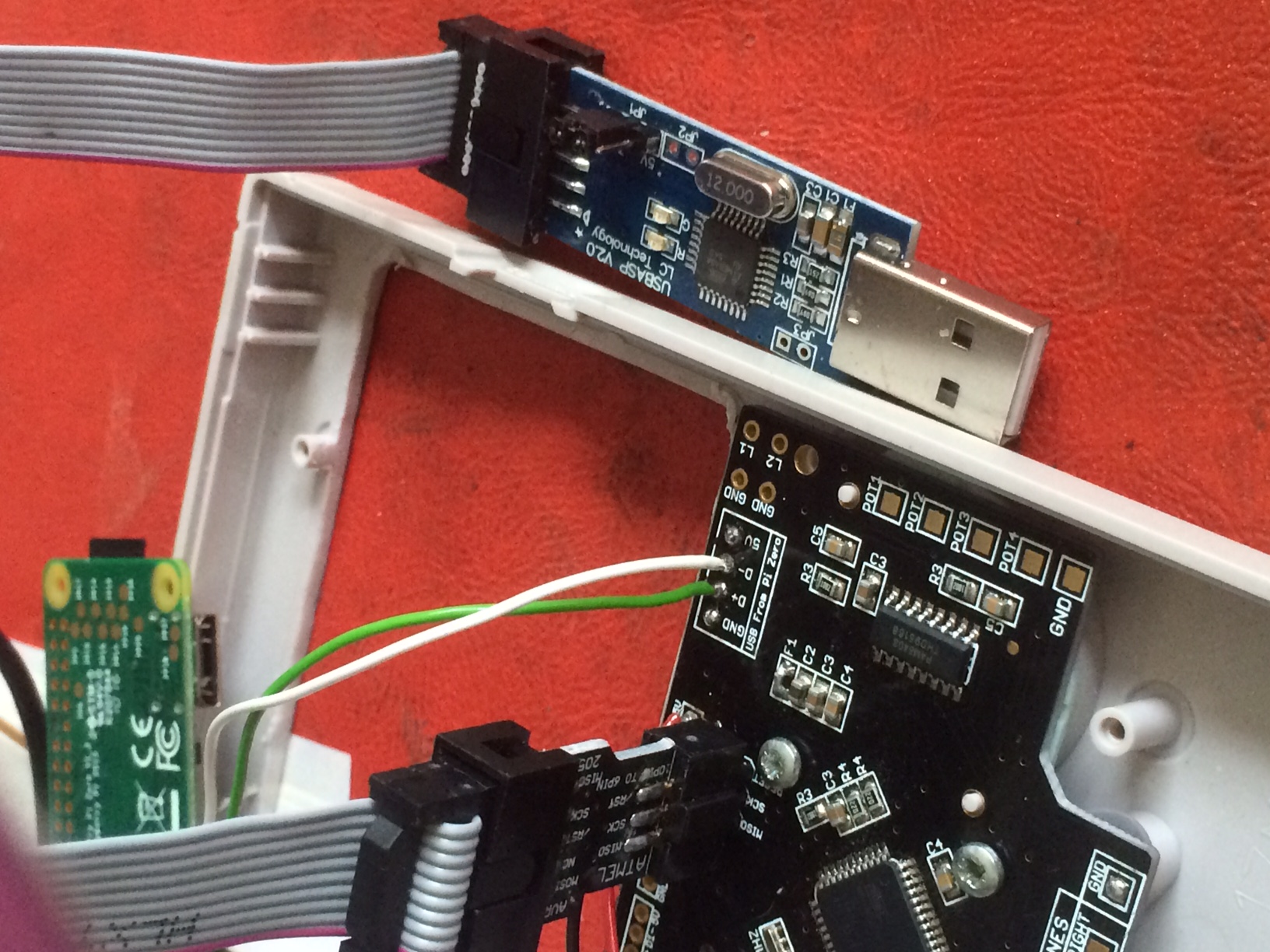

Here is the Guide with USBasp:
http://www.sudomod.com/forum/viewtopic.php?f=25&t=1228
