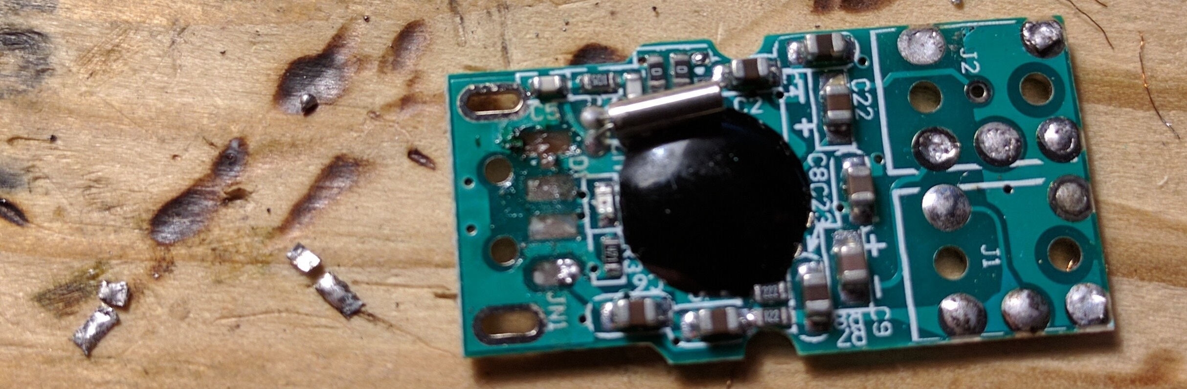

I was desoldering the USB connections and I got it off but these little ting strips came off with it. Looks like they were glued down (you can see them in the pic). Can someone tell me these are? It does not look like I can re-solder wires back to the endpoints so I am assuming they are copper strips? Can I repair it or is my sound card trashed now?
Thanks for the help!

@dirtybeagles it does look like those are the copper pads where you desoldered. I've had this happen before when I left the iron on for too long. It might be salvageable if you can scrape the area around those pads a little and see if you can expose the circuit to solder the wire to it.
This is similar to what is done in @wermy tutorial with the existing gb circuit board.

razor wrote:@dirtybeagles it does look like those are the copper pads where you desoldered. I've had this happen before when I left the iron on for too long. It might be salvageable if you can scrape the area around those pads a little and see if you can expose the circuit to solder the wire to it.
Ultimately I ended up purchasing another USB sound card that [mention=]chiz[/mention] showed pictures of in his post. This time I was a lot more careful and how I was pulling off the components and I think I was successful in keeping all those pads attached. One thing I did try is attached little copper tape to wear those copper pads work I'm not sure if that works because I tested it with a multimeter and I could not get a solid connection. I'm wondering what success other people had in the soldering components and any tips when it comes to the USB sound card it seems to be very very difficult.
