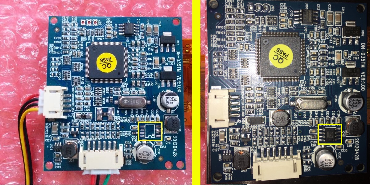

oomjan wrote:I imported two of these screens from Alibaba
http://sudomod.com/wiki/index.php?title ... te_Display
I know users have reported running this off 5V, but I can't get it to run on 5V. I've tried a USB cable directly and a raspberry pi zero through the gpio pins. I did get it working on 9V and 12V.
Any ideas, or ways I can get this to run on 5V?
Regarding this board from ZIANJIE. Pictures below shows the exact same board, but for some reason mine has an added step-down converter which I think is causing the issue. The board on the left runs on 5V out of the box, my board on the right does not.
I'm going to hotwire 5v power to the SW pin of the step-down which I think will work.

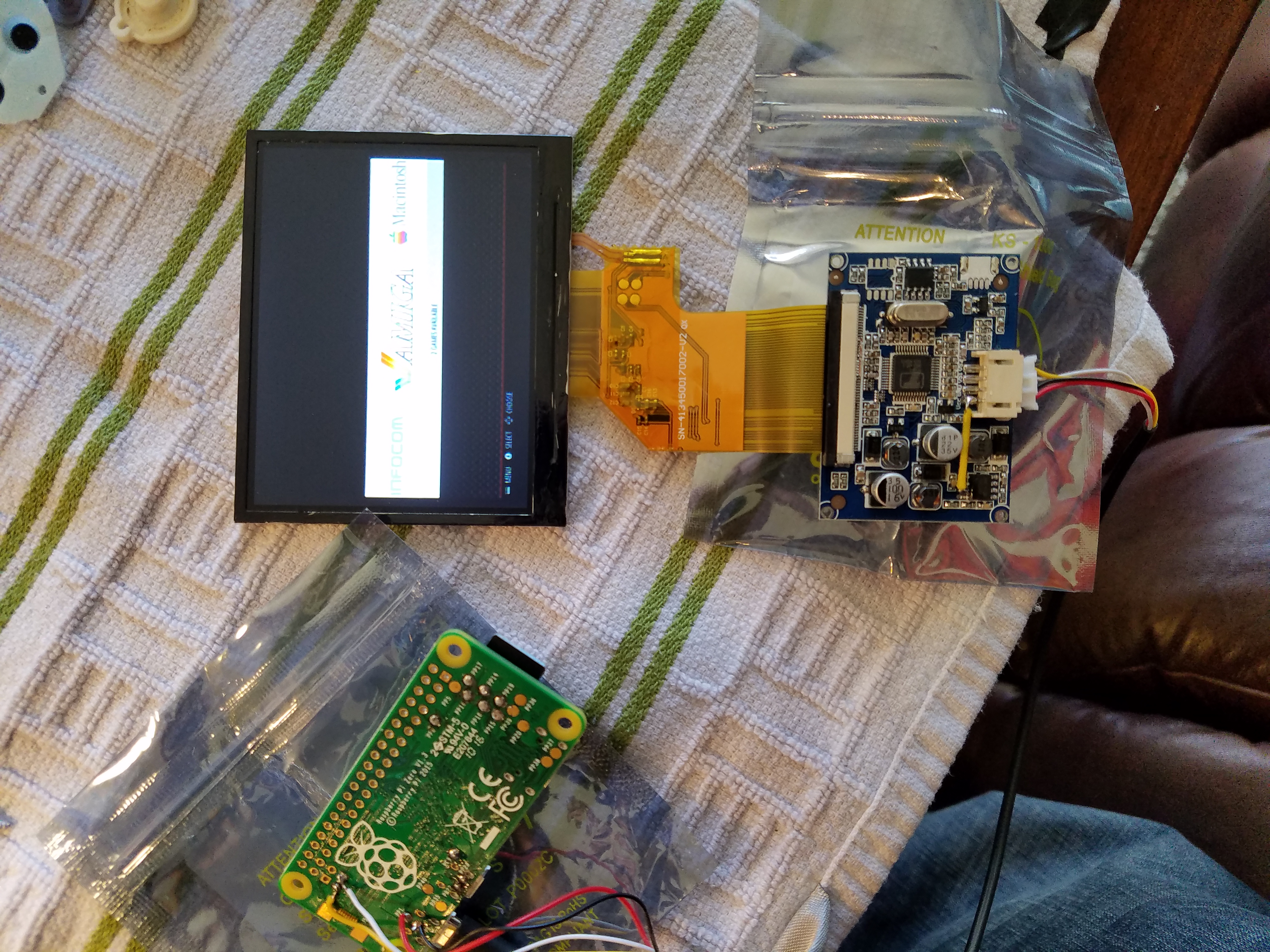

I just received the BW 3.5" screen sold by e-life and can confirm that it supports 5V without any modifications. Additionally, it just requires desoldering the 4 cables and wiring it to the pi zero right away. .
I remembered to take a photo shortly after i began desoldering.
