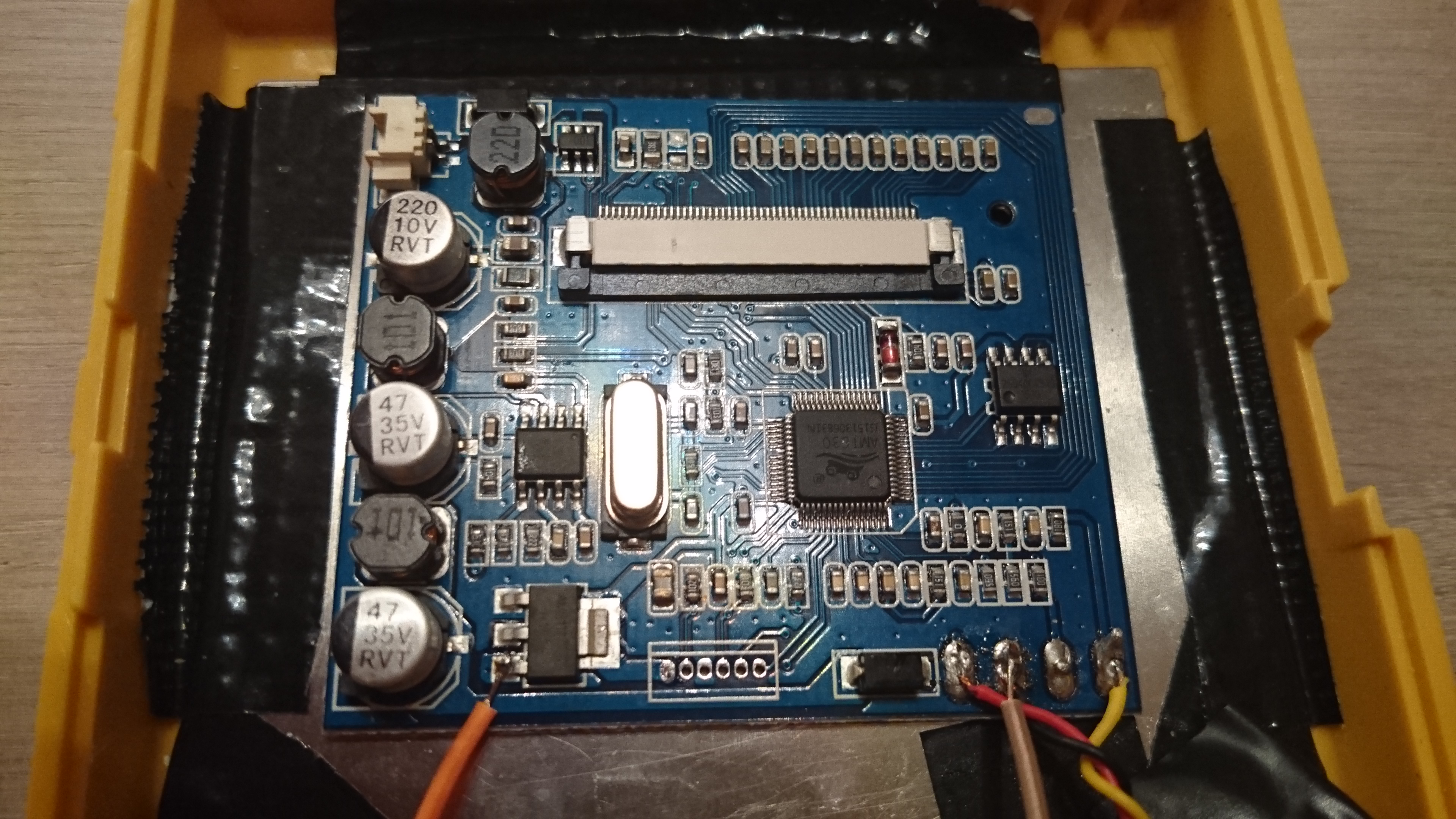

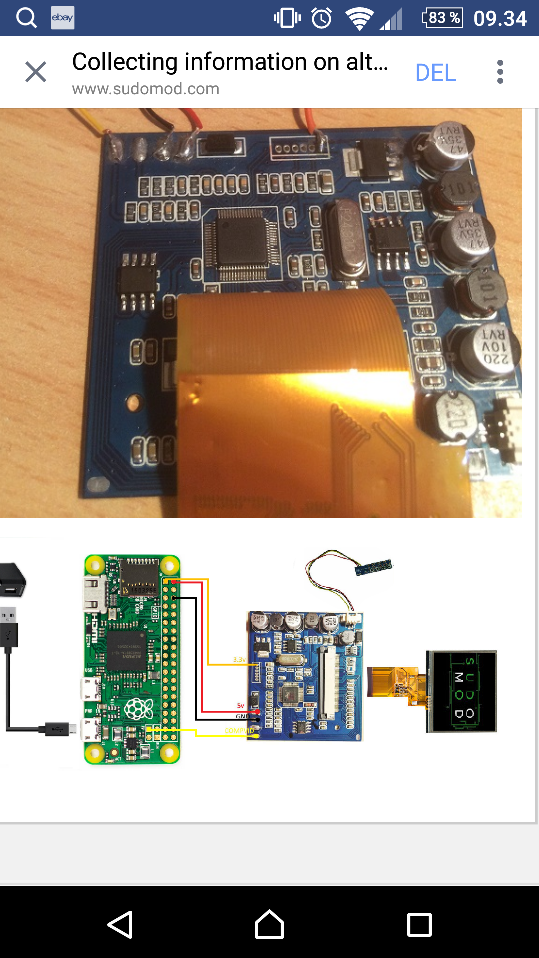

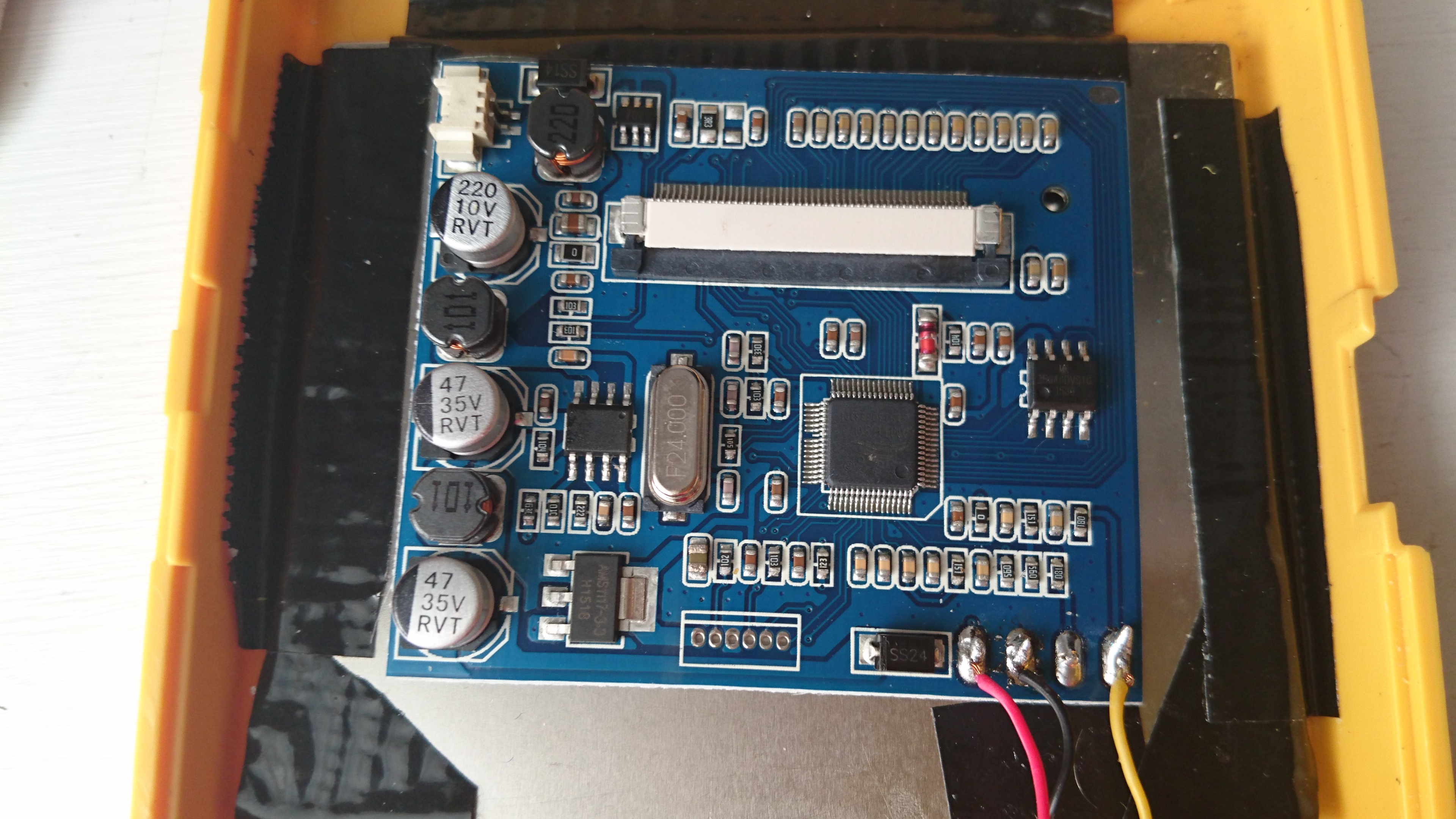

Bought this screen.
Have tried 2 different ways to get it running on3.3/ 5v but seems impossible.
Anyone have same screen and have sucsess running on 5v?
First pic hav 5 volt on orange.
Second 3.3v on orange.
Last is original

Post by chaosratt » Fri Aug 26, 2016 11:47 pm
No-go on the native 5V, had to place a jumper to the 3.3 regulator's input. See pic:
