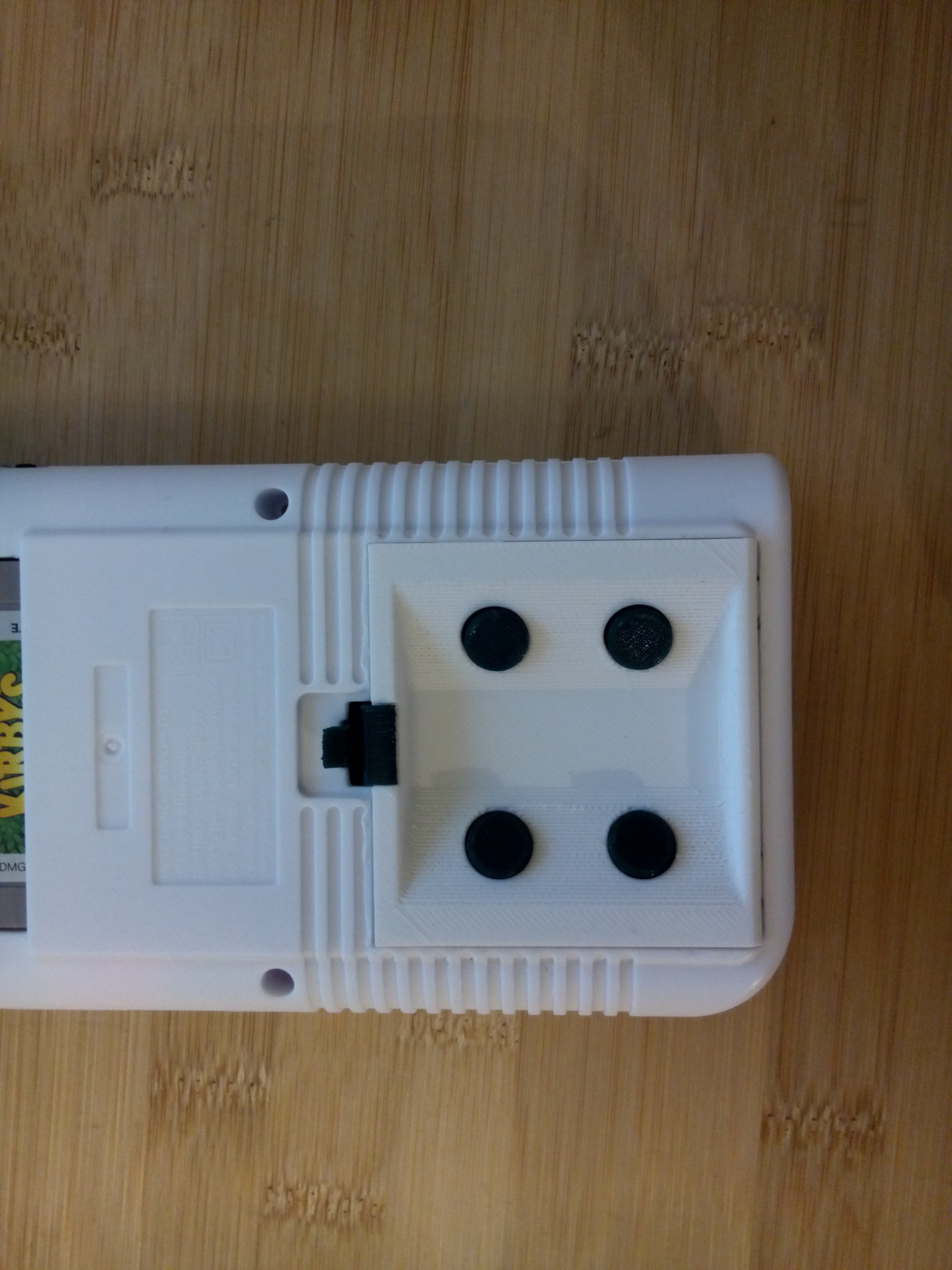

SNES shoulder buttons were my fave. I wonder if I could gut and refit them to work?
its nice easy, here are some build with SNES L+R buttons.

I really want to go the SNES button route. Part of the reason is I don't want to buy 100 switches that I won't use! I really like the larger buttons on the back, but it's too bad it eliminates using a cartridge reader which I really wanted to do. :(
I don't want the click noise and feel and I have big hands and the larger buttons above the battery appears more comfortable.

http://www.sudomod.com/forum/viewtopic.php?f=43&t=2455
Look in a SNES pad. Its very simple.

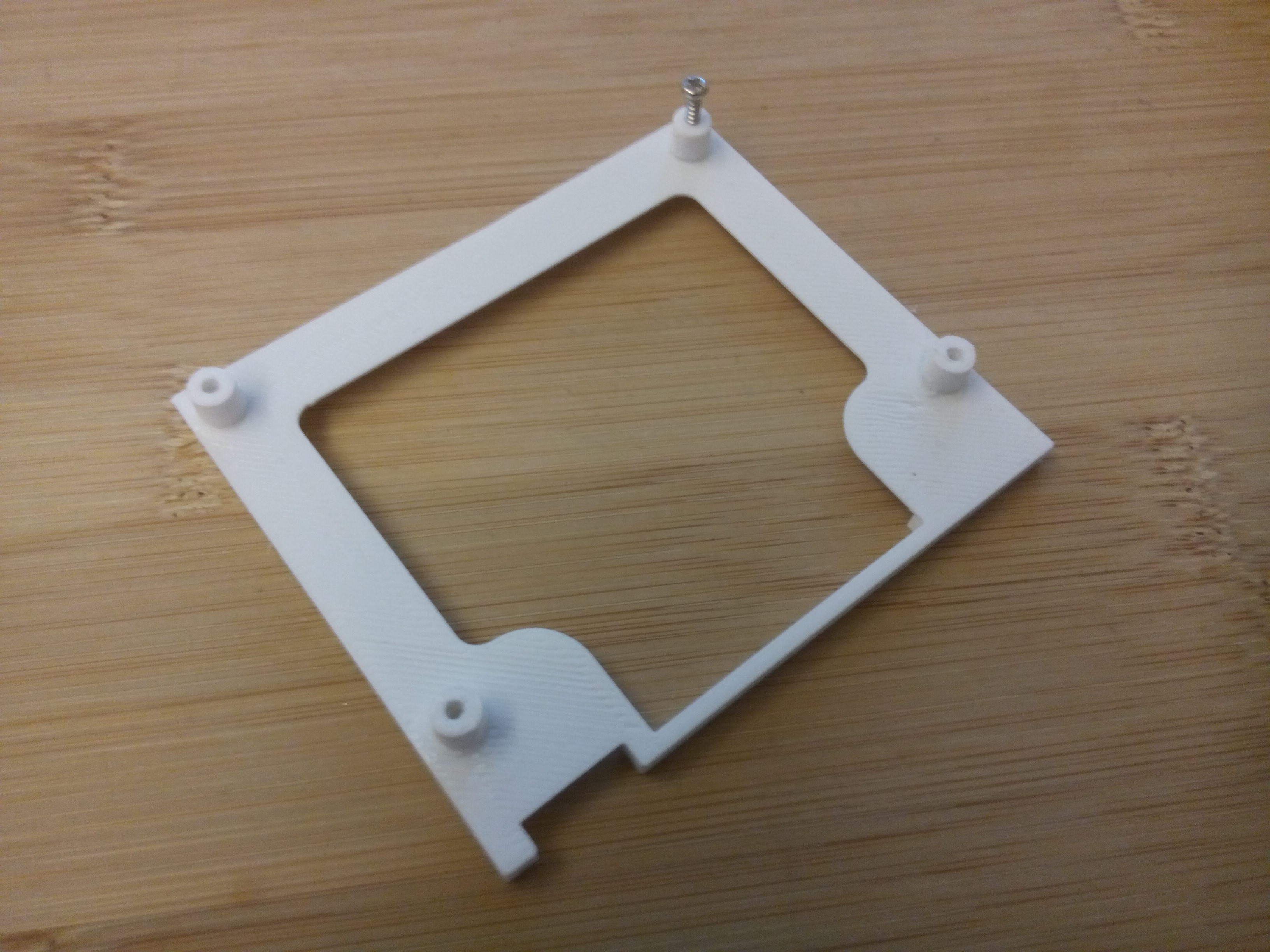

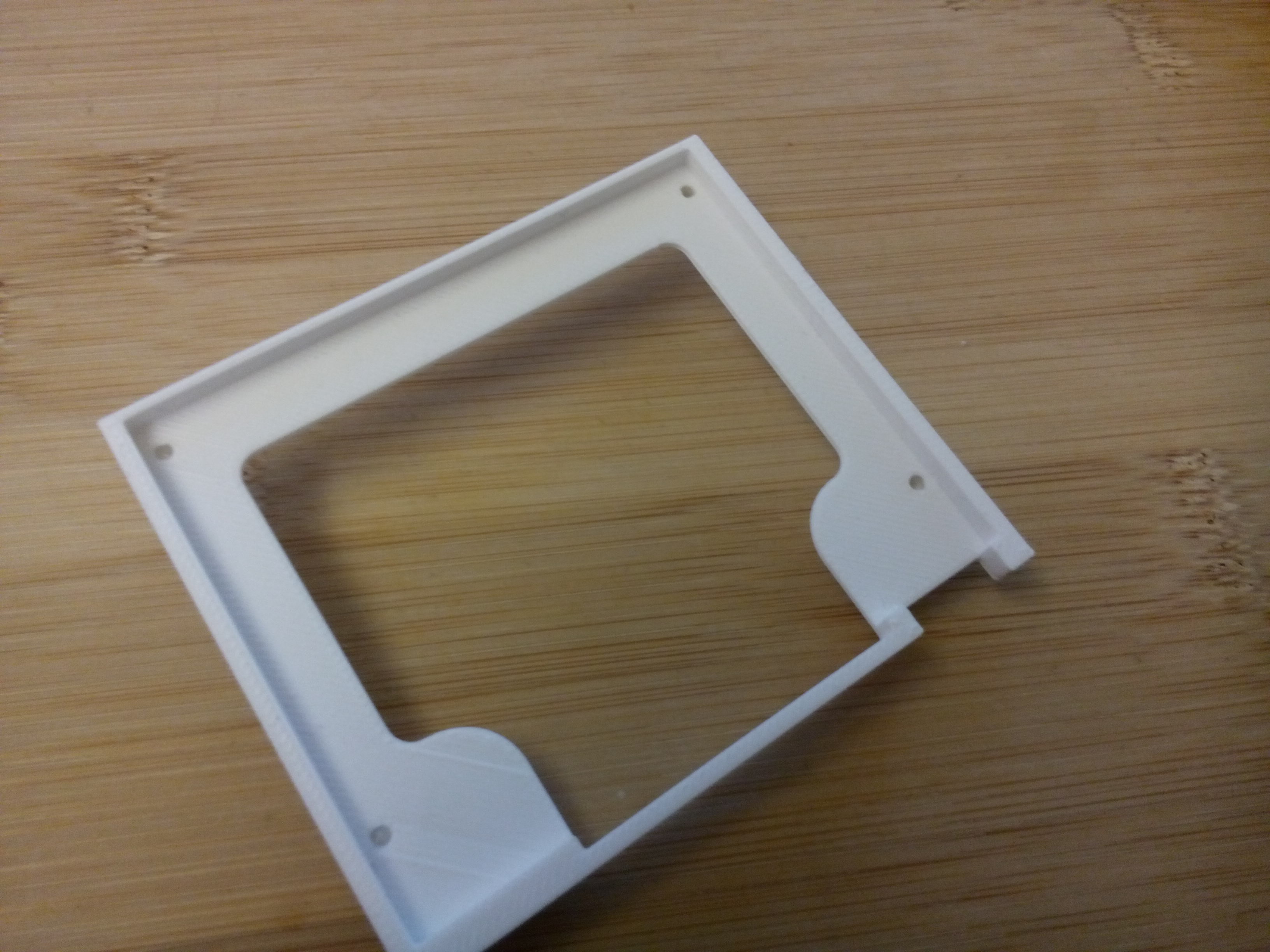

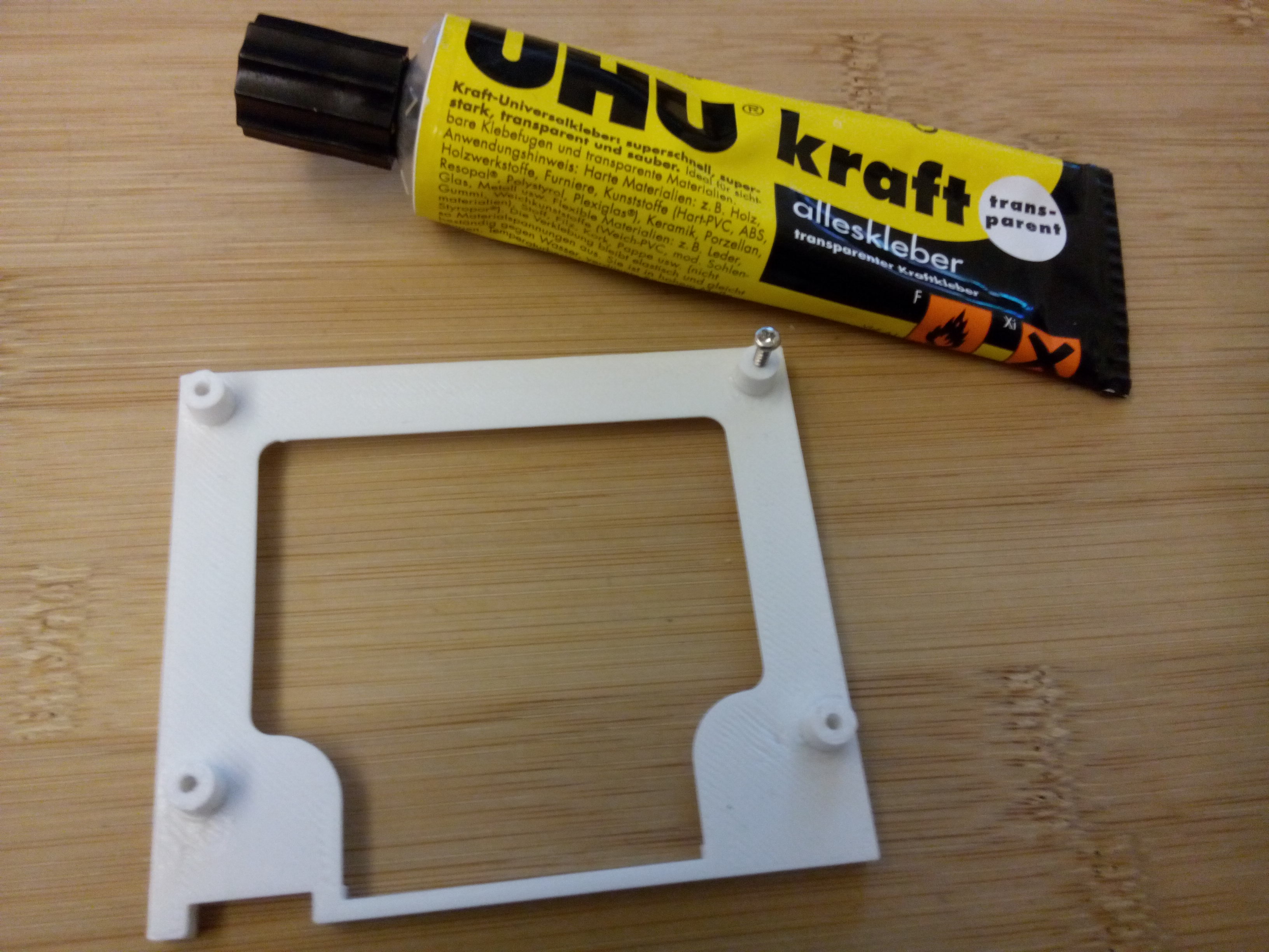

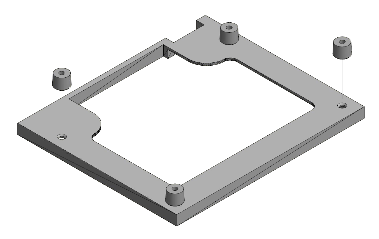

Screen bracket for 320x240 from HoolyHoo cuted in two parts. So I dont need support material for printing.
The part 20-027-01 is the frame and 20-028-01 are the holes
20-027-01-HH-MB.stl
(449.95 KiB) Downloaded 389 times
20-027-01-HH-MB.stp
(440.43 KiB) Downloaded 320 times
20-028-01-HH-Hole.stl
(697.92 KiB) Downloaded 307 times
20-028-01-HH-Hole.stp
(7.64 KiB) Downloaded 313 times
To "cut" threads into the holes, heat the screws with a soldering iron. Screw in, let the screws cool down and unscrew again. Works perfect.

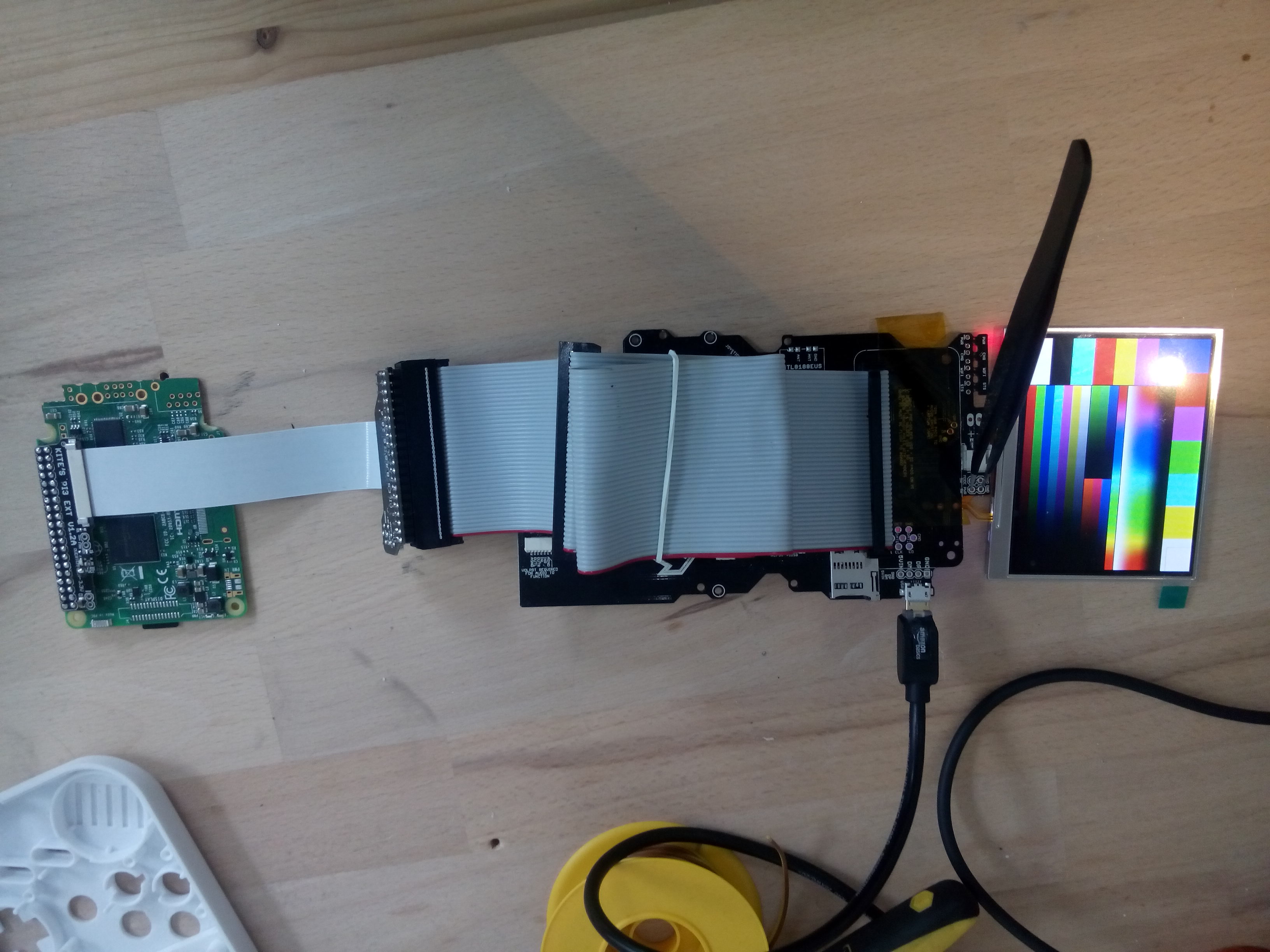

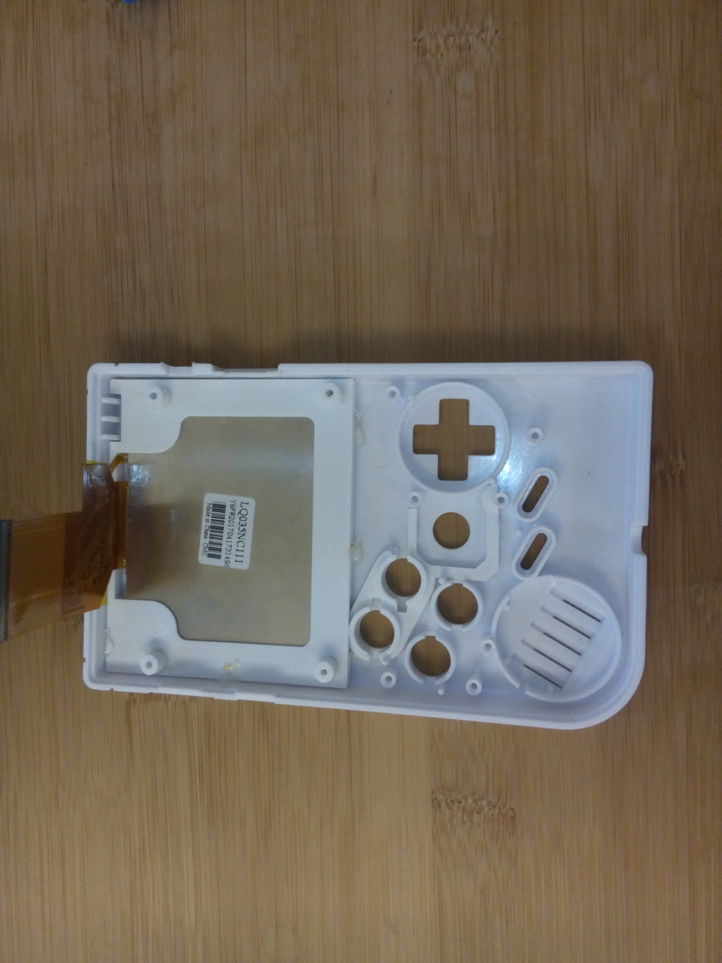

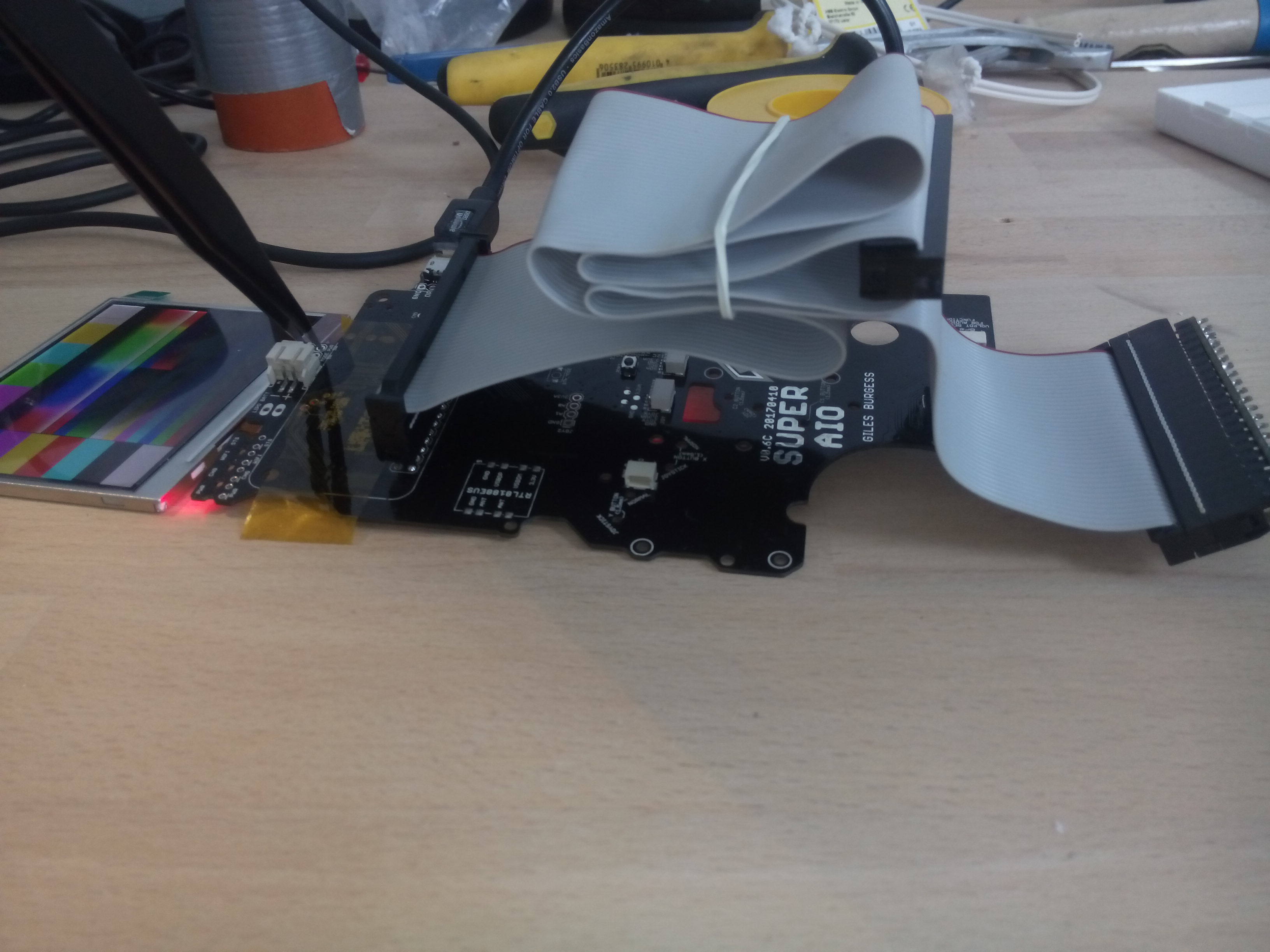

Last week i bought a SAIO with Pi3ext, Pi3, Buttons etc... from one guy in this board for a very fair price. On saturday I build the YaGz. After six hours, I hold a working GBz in my hand. Kites system works like a charm.

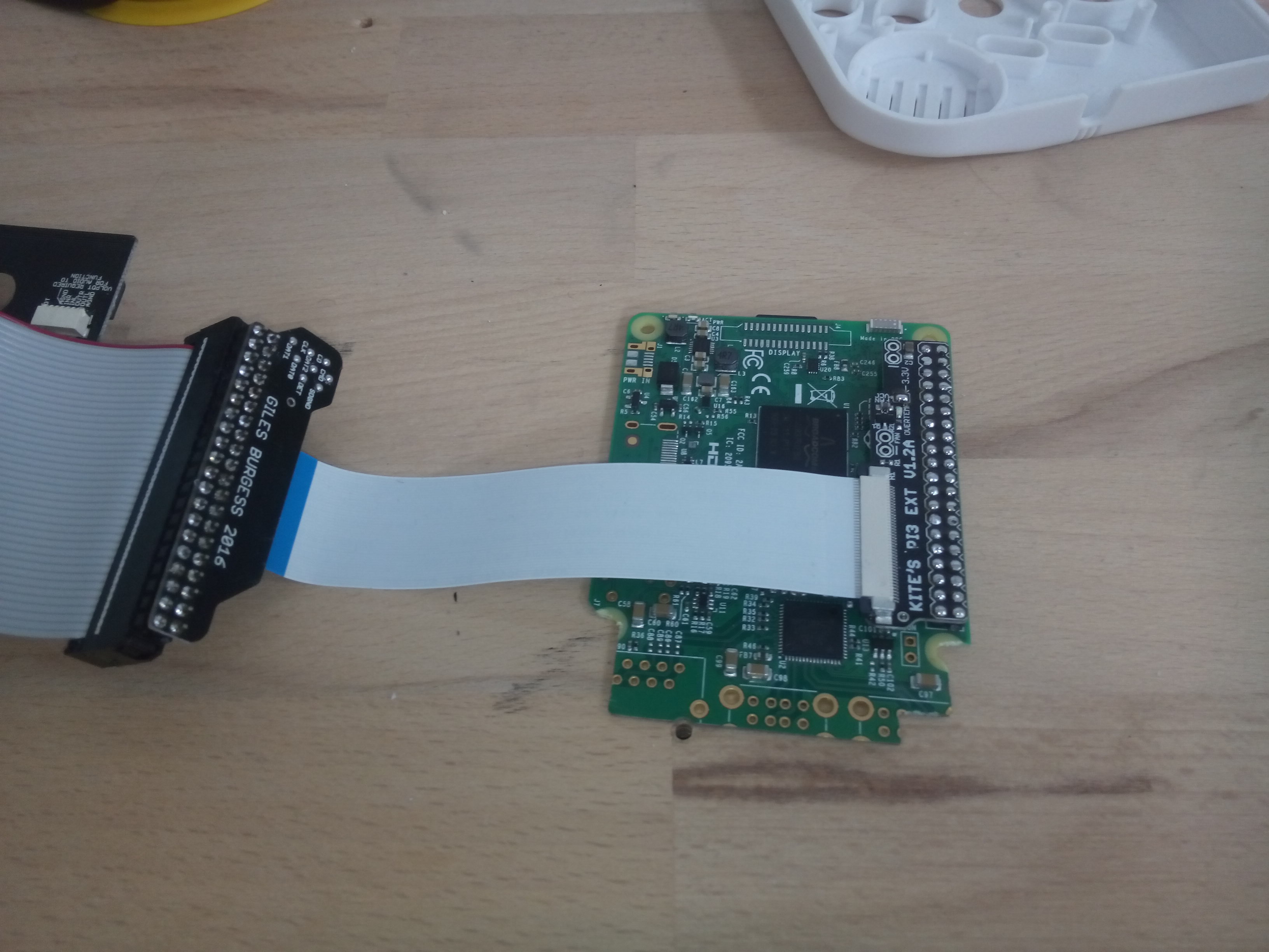

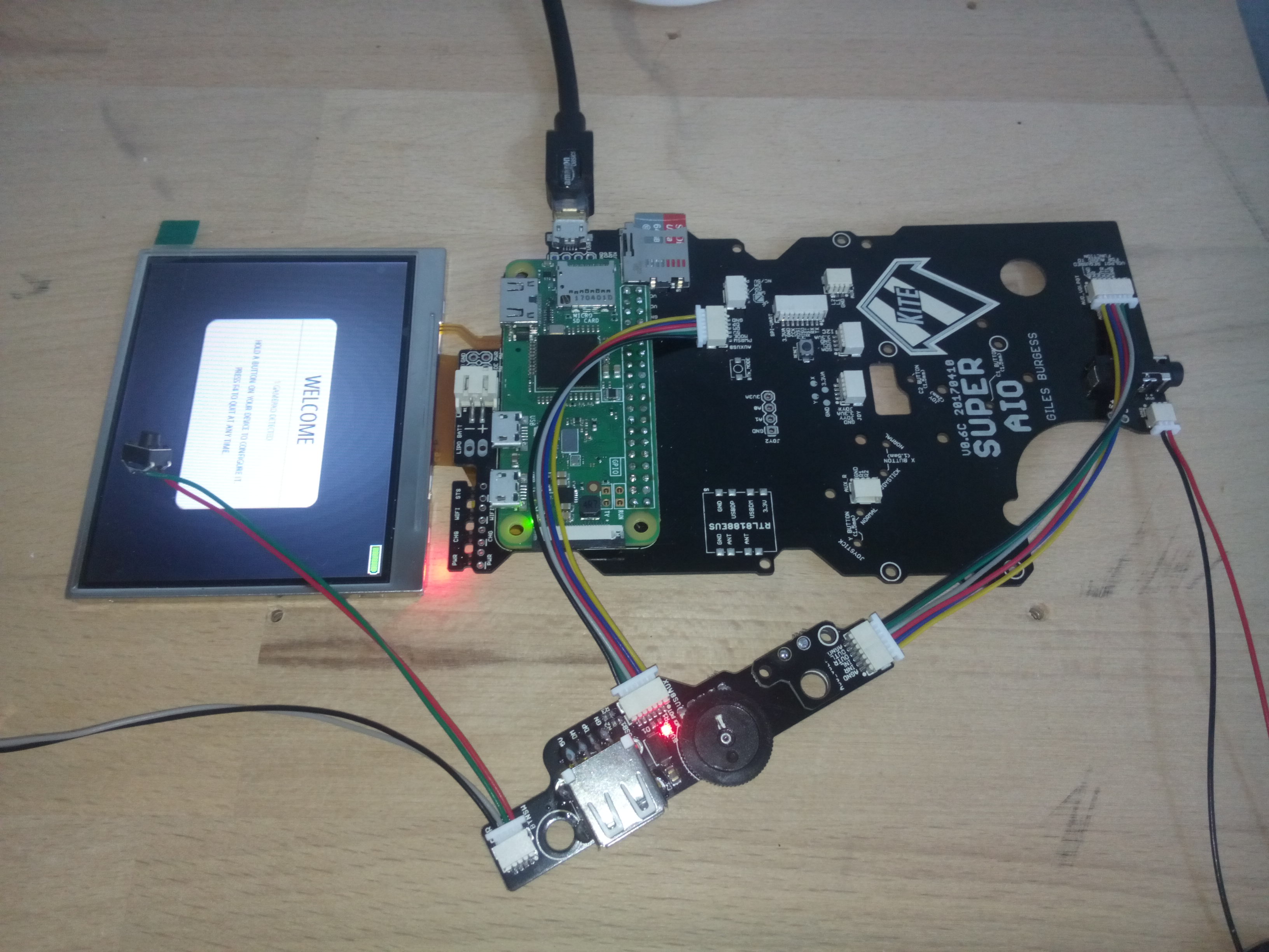

First I want to test the Pi3 and Pi3ext. The Pi3 was bought without ports, so I only have to cut some edges. I soldered pin headers only to test it with an IDE-cable. It works, so everything is fine for a Pi3 build someday.

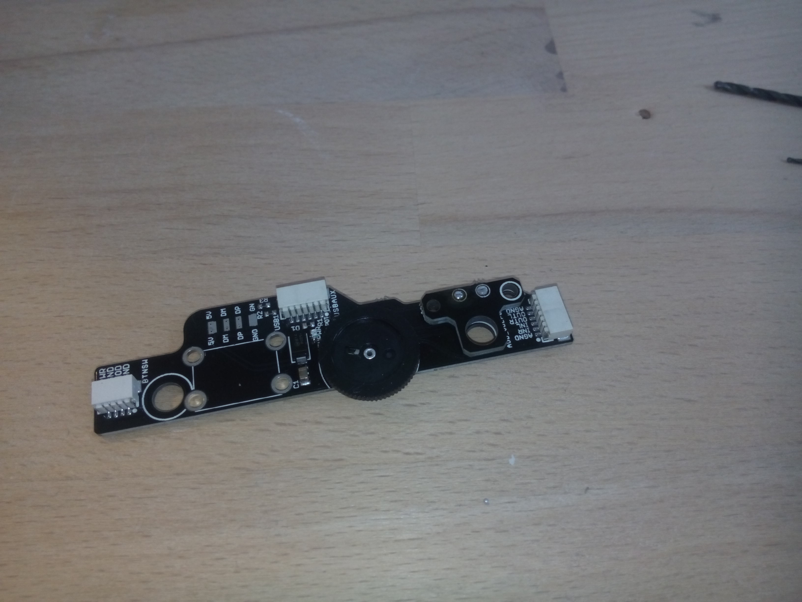

The little board. For positioning the spacers I have used drills. Fits perfect.
Testing the soldered board.

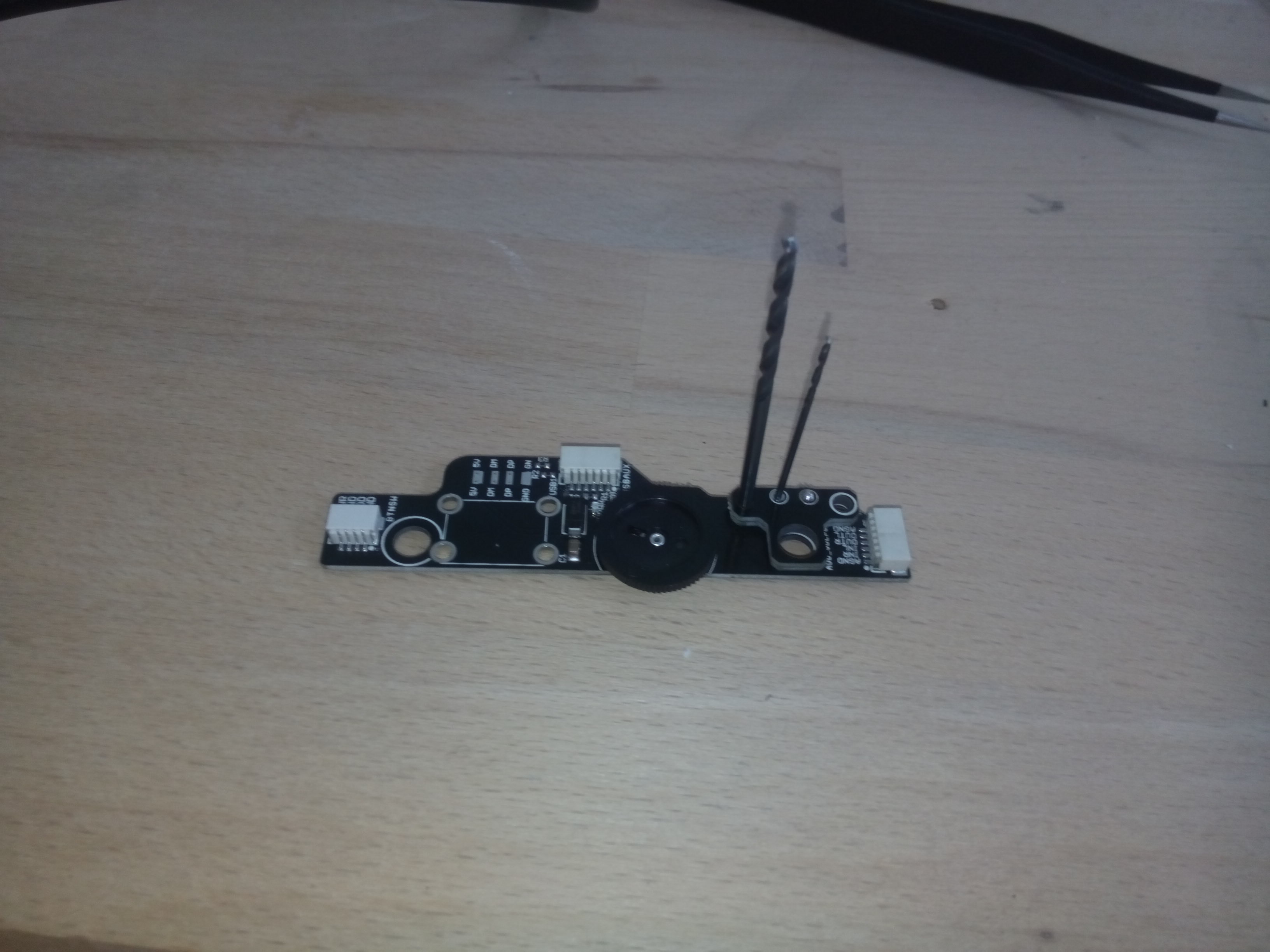

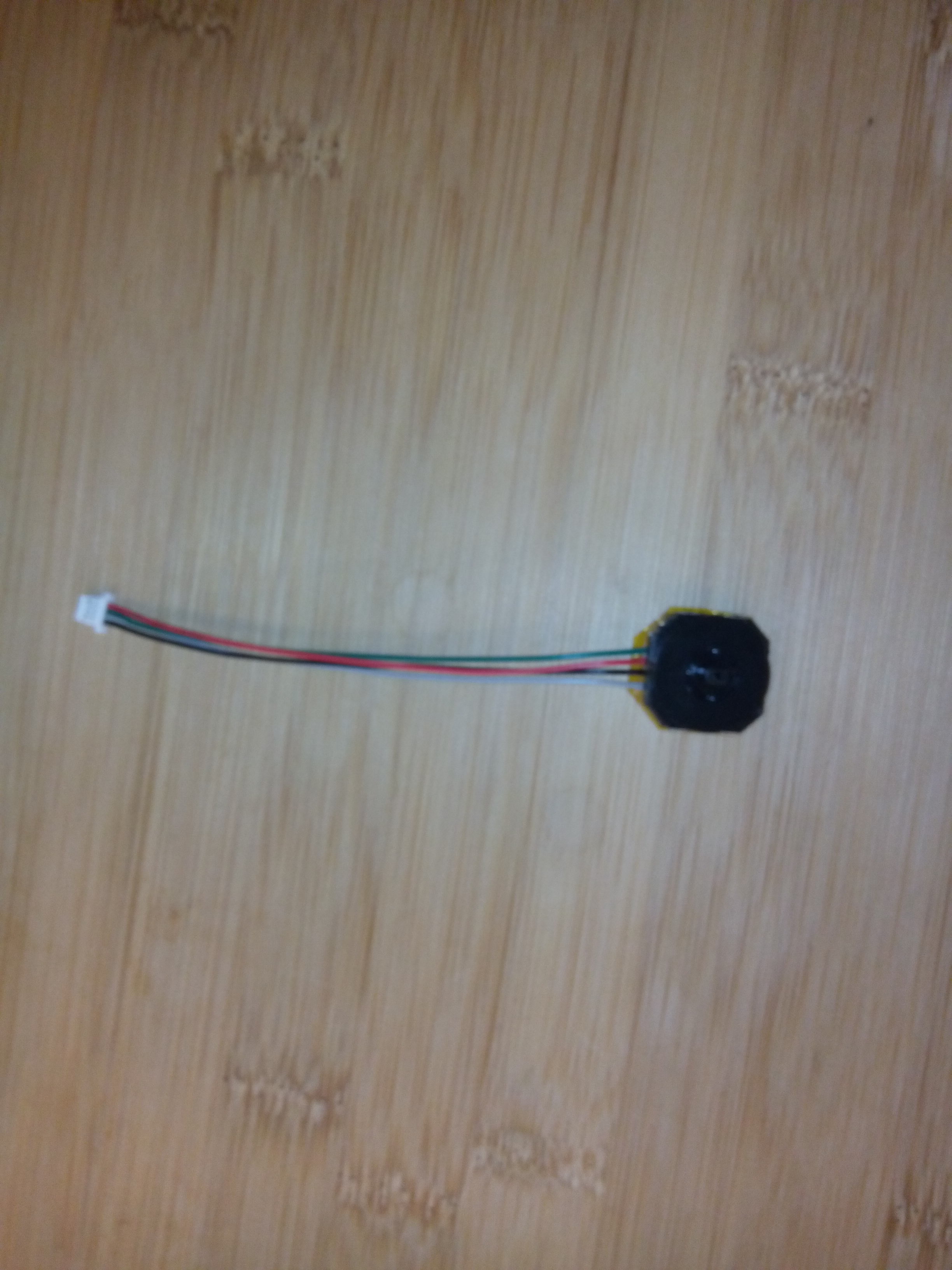

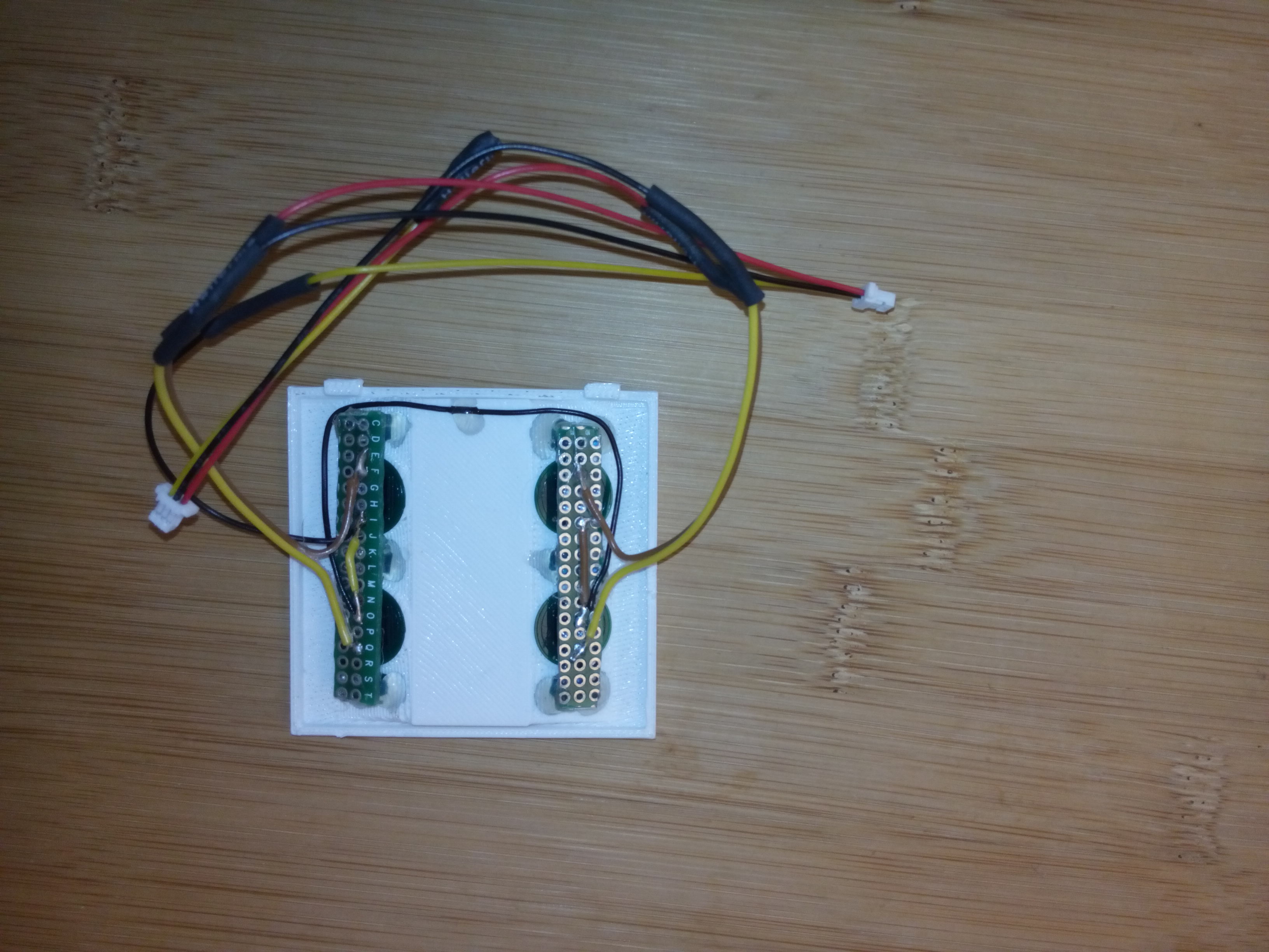

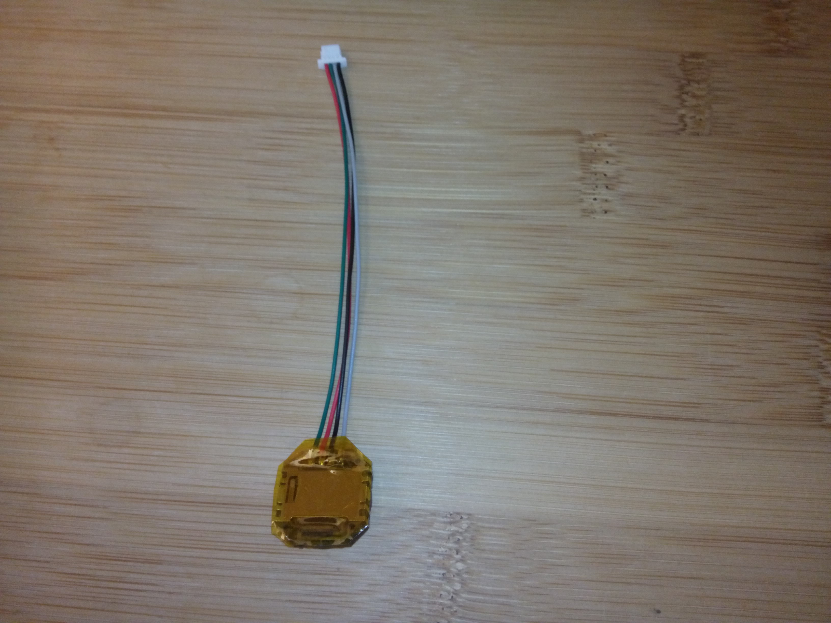

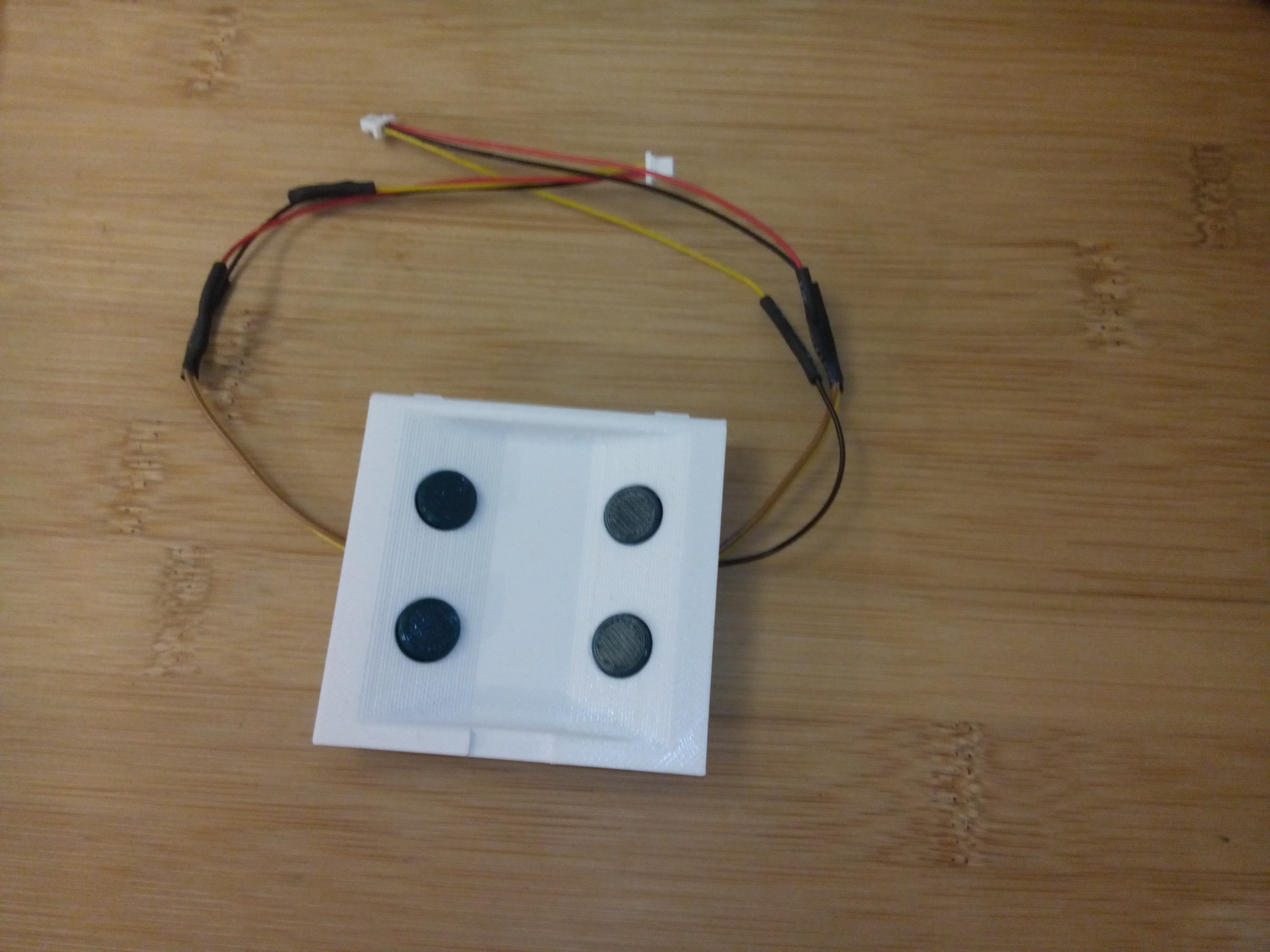

My shoulder buttons and the psp joystick.
I have to cut the screen bracket a little bit. For my next build there will be the joystick support in the screen bracket intergrated.

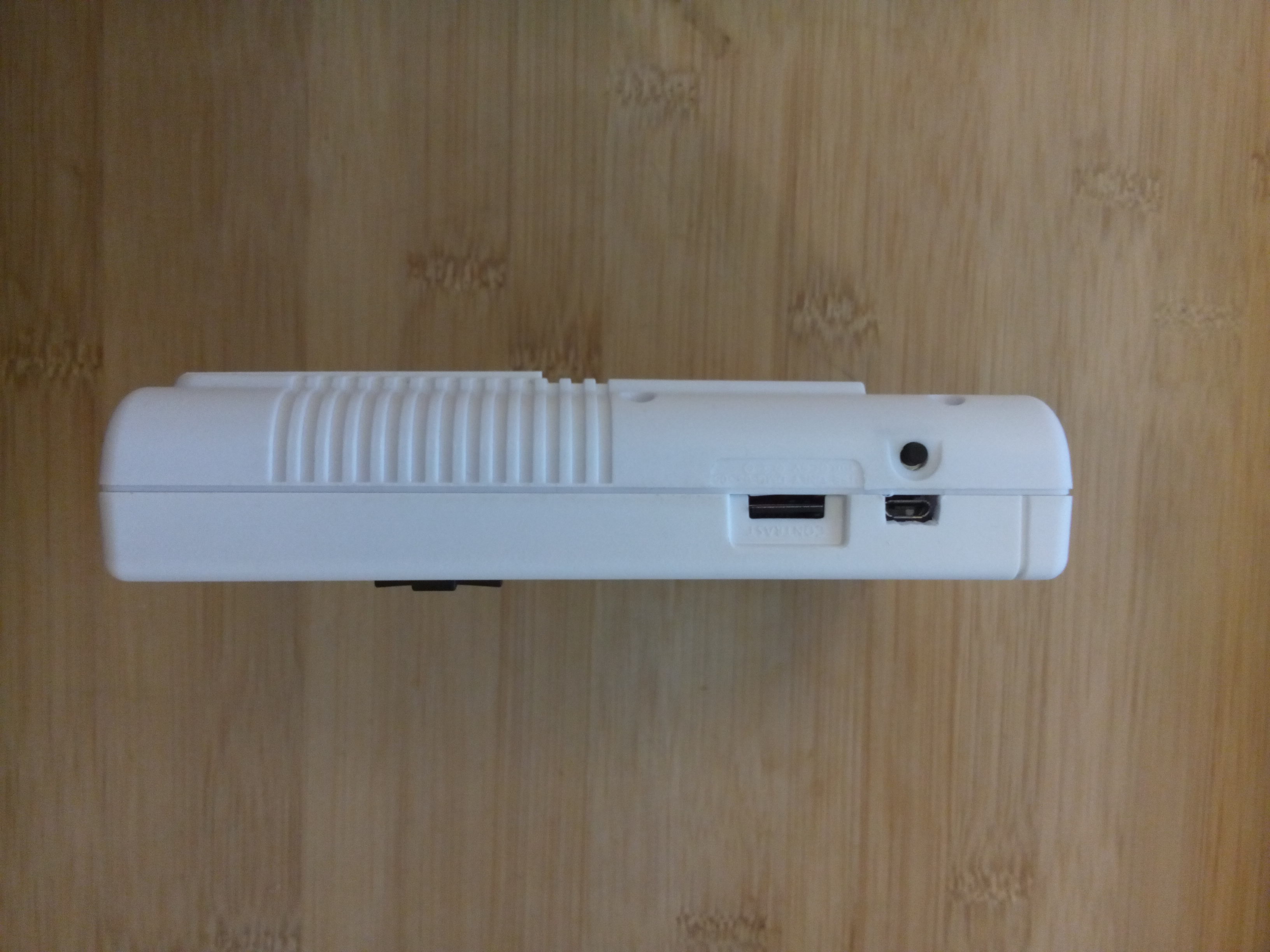

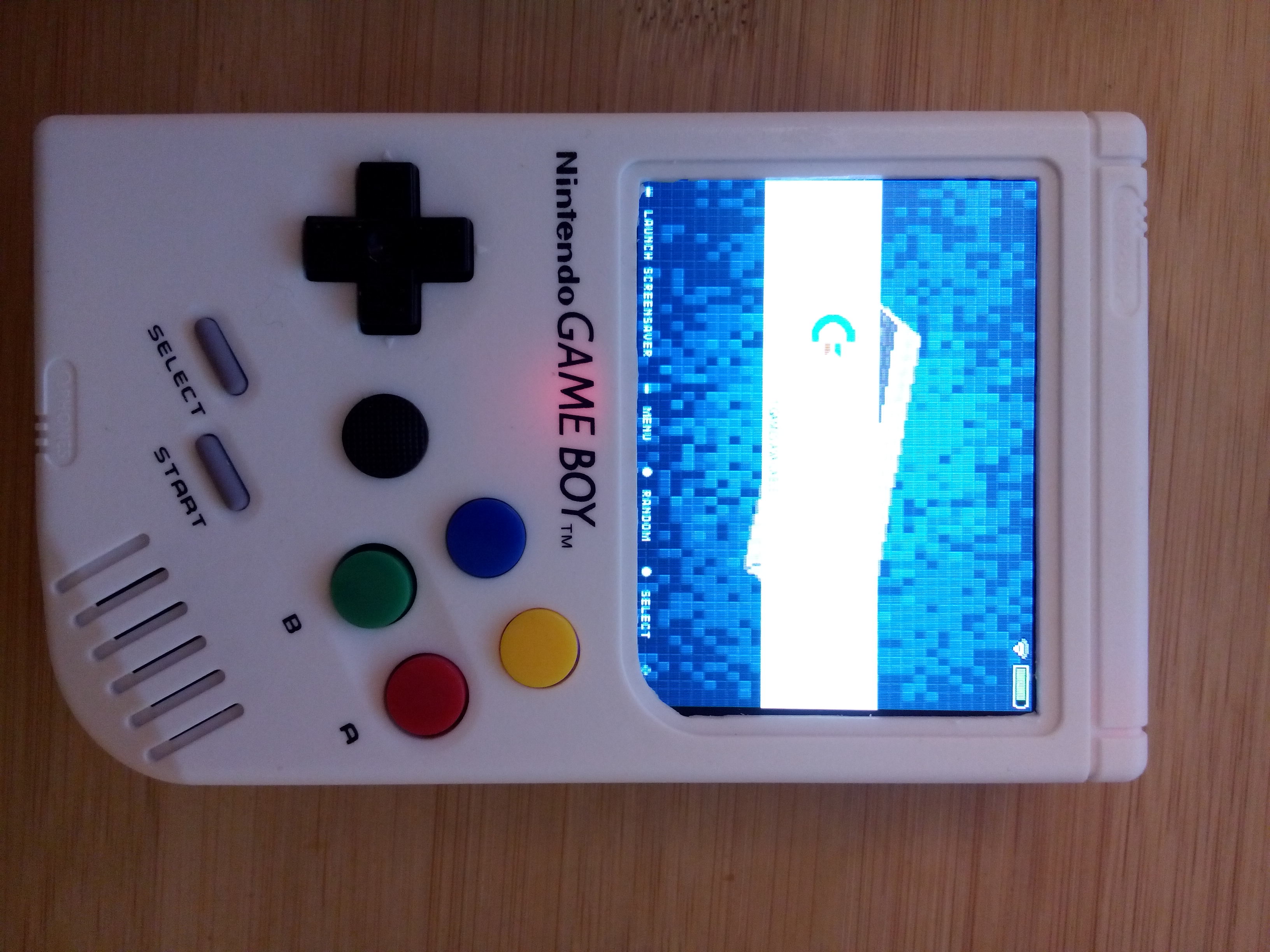

This is the current state.
Next steps:
- Add two buttons to the Pi to flash the 32u4 on the fly with different "keyboard layouts". For playing adventures I need the joystick as a mouse, for C64 spacebar, for Kodi others.... etc.
- One or two extra button on the 32u4
- Add an DC-Jack
- Making some internal pictures
- Maybe WS2812b for glowing buttons
Conclusion: 10/10 would build a GBz again.
