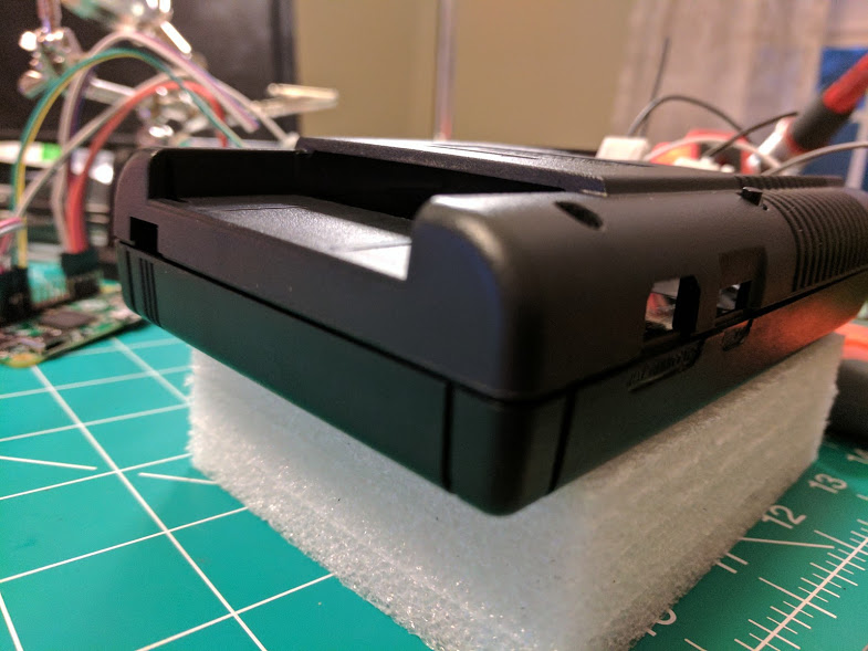

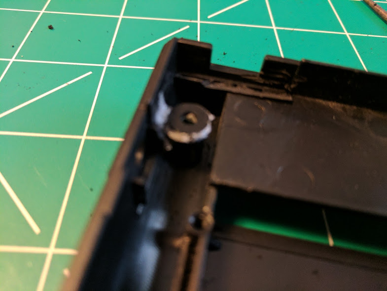

Thank you! The screen is being held in by a heavily modified bracket from wermy. I have been fitting the back cover as I progress and I had to shorten the screw brackets on the DMG case. I cut the top of the post off and shaved them down, then used gorilla glue to put them back together so they are the correct height. I'll snag some more photos tonight.

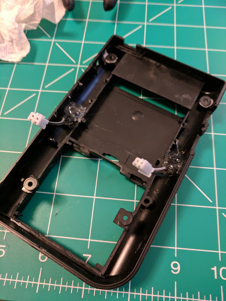

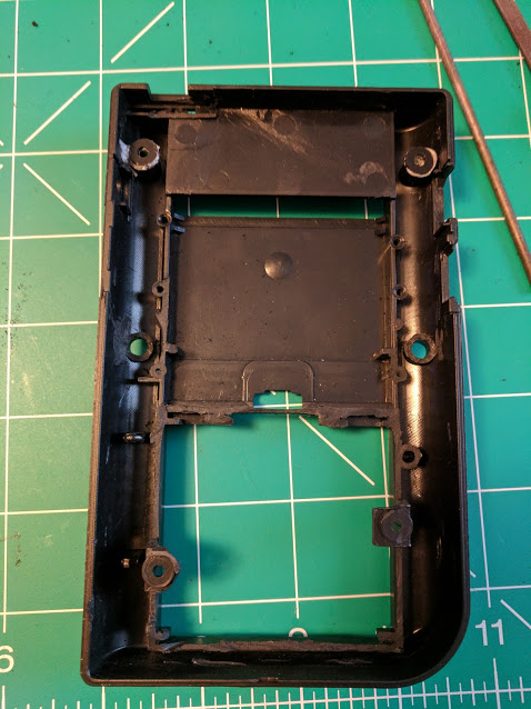

Here are the case screw ports shortened
Back inside.jpg (94.34 KiB) Viewed 10440 times
Close up
Back inside close.jpg (76.48 KiB) Viewed 10440 times

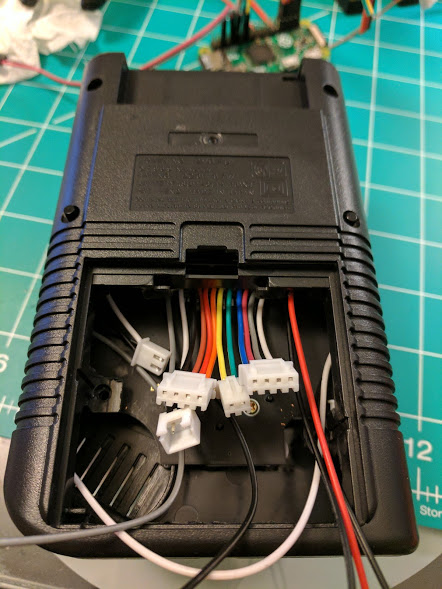

Tactile buttons in
Tactile 1.jpg (81.52 KiB) Viewed 10440 times
Tactile 2.jpg (73.72 KiB) Viewed 10440 times
And the case closed up
Case closed.jpg (100.88 KiB) Viewed 10440 times
Another... you can also see what I'm doing with the GPIO items too. Used JST connectors for all the buttons.
Closed 2.jpg (89.9 KiB) Viewed 10440 times

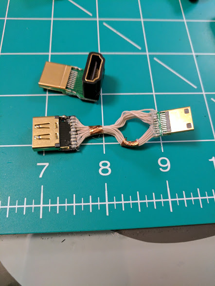

Now its time to Destroy some HDMI cables for the greater good...
HDMI destuction.jpg (69.36 KiB) Viewed 10440 times
Really tricky to get them apart. I even had my wife help... haha.
Then I discovered the answer to what I was looking for...
https://www.aliexpress.com/item/10pcs-l ... 4.2.Tcag8z
Another parts order from China awaits...
