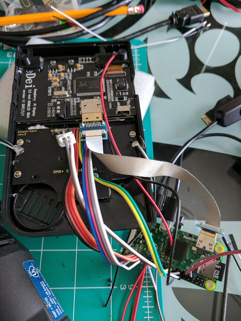

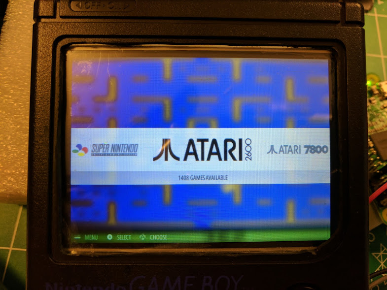

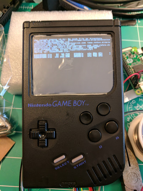

More progress...
I got the screen installed and moved around to the right spot. Got it centered. I think it looks good (screen protector still on!).
Overscan settings
overscan_left=0
overscan_right=30
overscan_top=0
overscan_bottom=0
HDMI settings (copied from McGyger)
# uncomment to force a specific HDMI mode (this will force VGA)
hdmi_group=2
hdmi_mode=87
hdmi_cvt 480 320 60 6 0 0 0
Wiring up my buttons to GPIO next.

Thanks, can see the pictures now :)
Great build! How did you connect this screen to pi zero? I see only one red wire which is not enough for power and video signal :)
mark memory
Posts: 28
Joined: Fri Apr 21, 2017 9:02 am
Has thanked: 14 times
Re: 1st GBZ build- HDMI Screen
Post by mark memory » Sat May 06, 2017 2:55 pm
silentjames wrote:
Sat May 06, 2017 1:11 pm
The red wire connects the power. The screen grounds itself through the HDMI cable I have.
Its a HDMI to HDMI mini camera cable of some sort. Not sure if I will be using it in the end though. Looks to be tough to package in there.

Post by BadBert » Mon May 08, 2017 12:53 am
That looks great!
What is the visible resolution now? (overscan settings)
Because others have the screen edge on the richt further to the right so they had to cut into the case more, so the original (Bw screen type) screen protectors would not fit anymore.
If i look at your photo's, it seems that screenprotector will fit perfectly?!
And can you get the audio of the stereo jack of the screen now? So no audio card (usb) needed?
Still need an amp?
