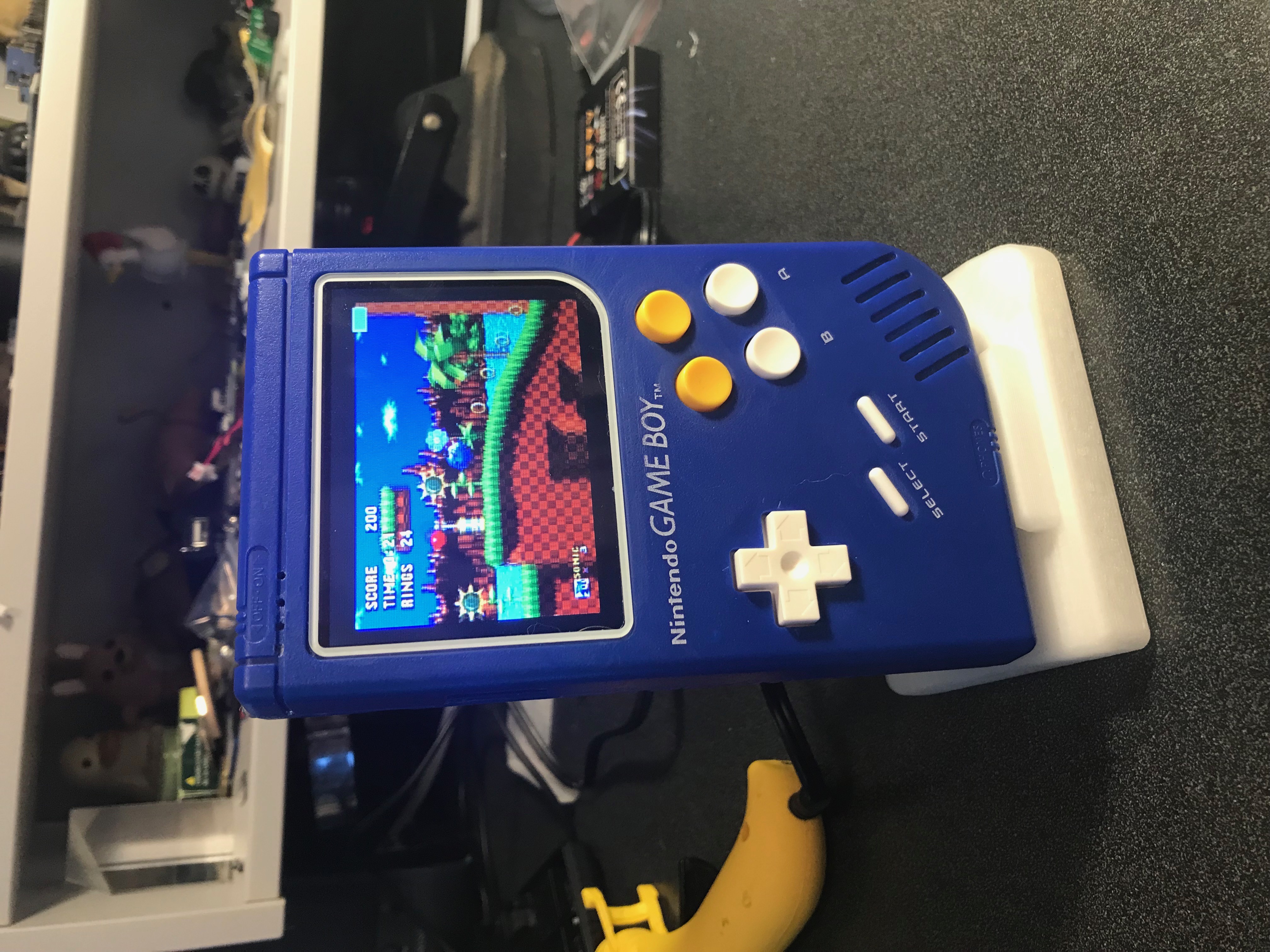

Behold, the Blue Boy

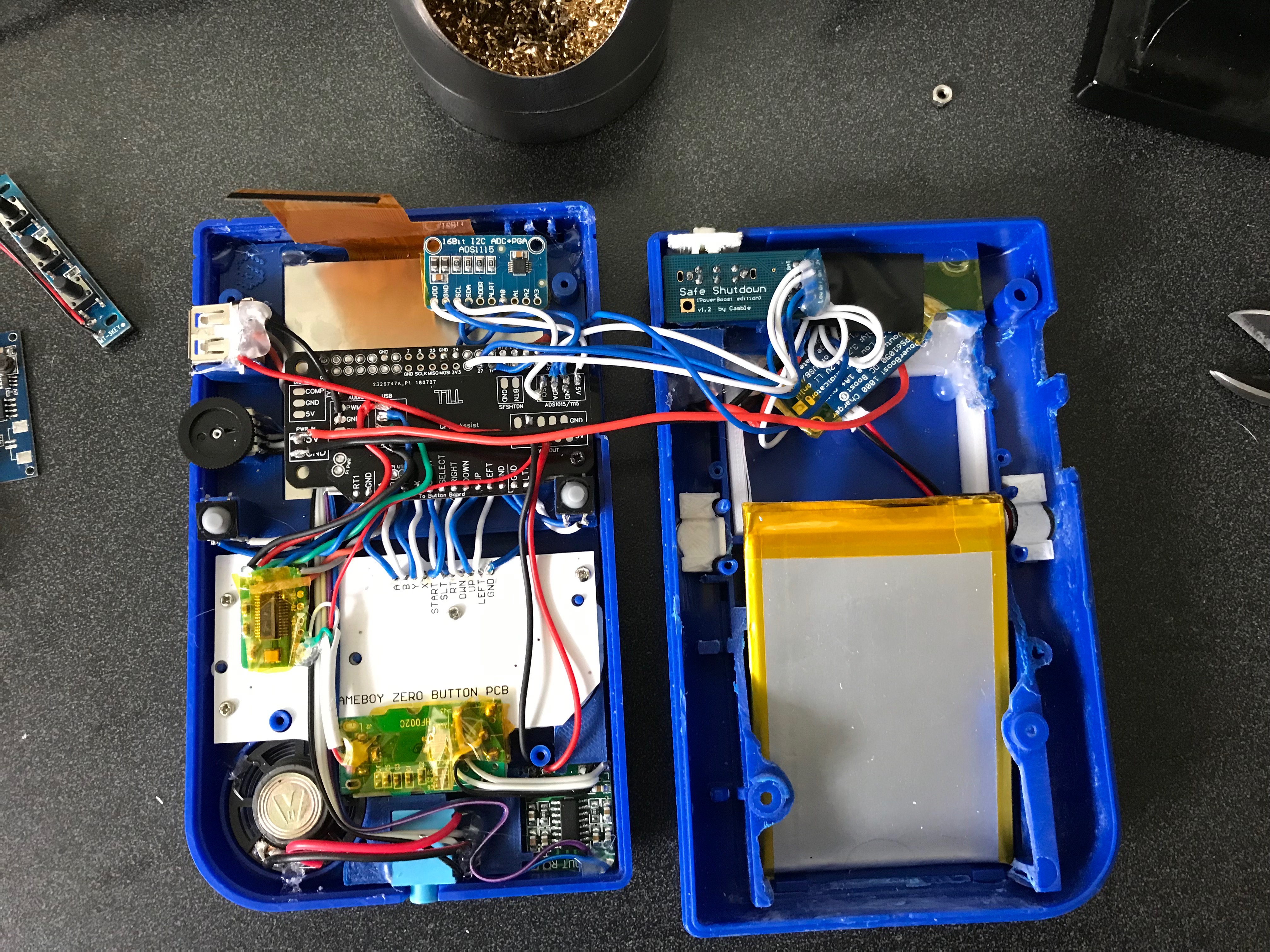

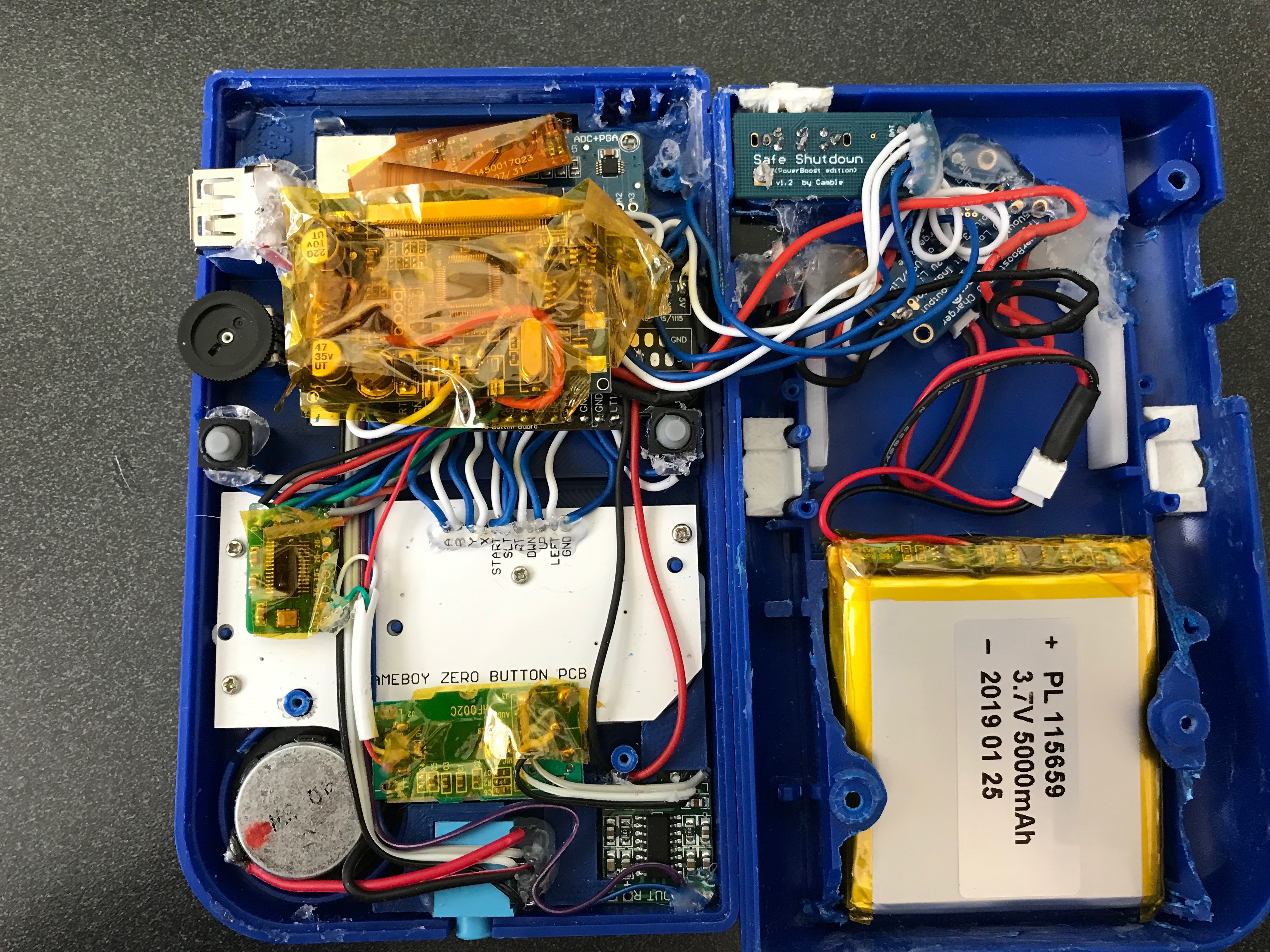

Been trying to wrap this one up for weeks. Hardware seems to be good now that I have the assist board in there, but I'm still working out some kinks in the software. Camble's safe shutdown script and retrogame do not want to play well together at all, and there's no obvious reason. It's basically working, but the battery monitoring needs adjustments - the minty script shows the icon, but doesn't seem to register the correct level, and I'm skeptical the low-battery trigger is working on the safe shutdown currently... but I'm pretty sure I can work it through it's kinks eventually. I'm also trying to get this all running (efficiently) in retropie 4.4 which is its own batch of headaches.
The GPIO Assist from Pocketadventures.com is the biggest draw here - the rest is pretty standard gbz stuff, i think. The assist board is really great at keeping things organized and brings the chance of screwing up connection spots down a lot (assuming you don't mess up soldering it to the pi itself). Also - these buttons are my absolute favorite for playing games, so far.

inside shot - with gpioassistShow
inside shot - with screen board, covered in tapeShow

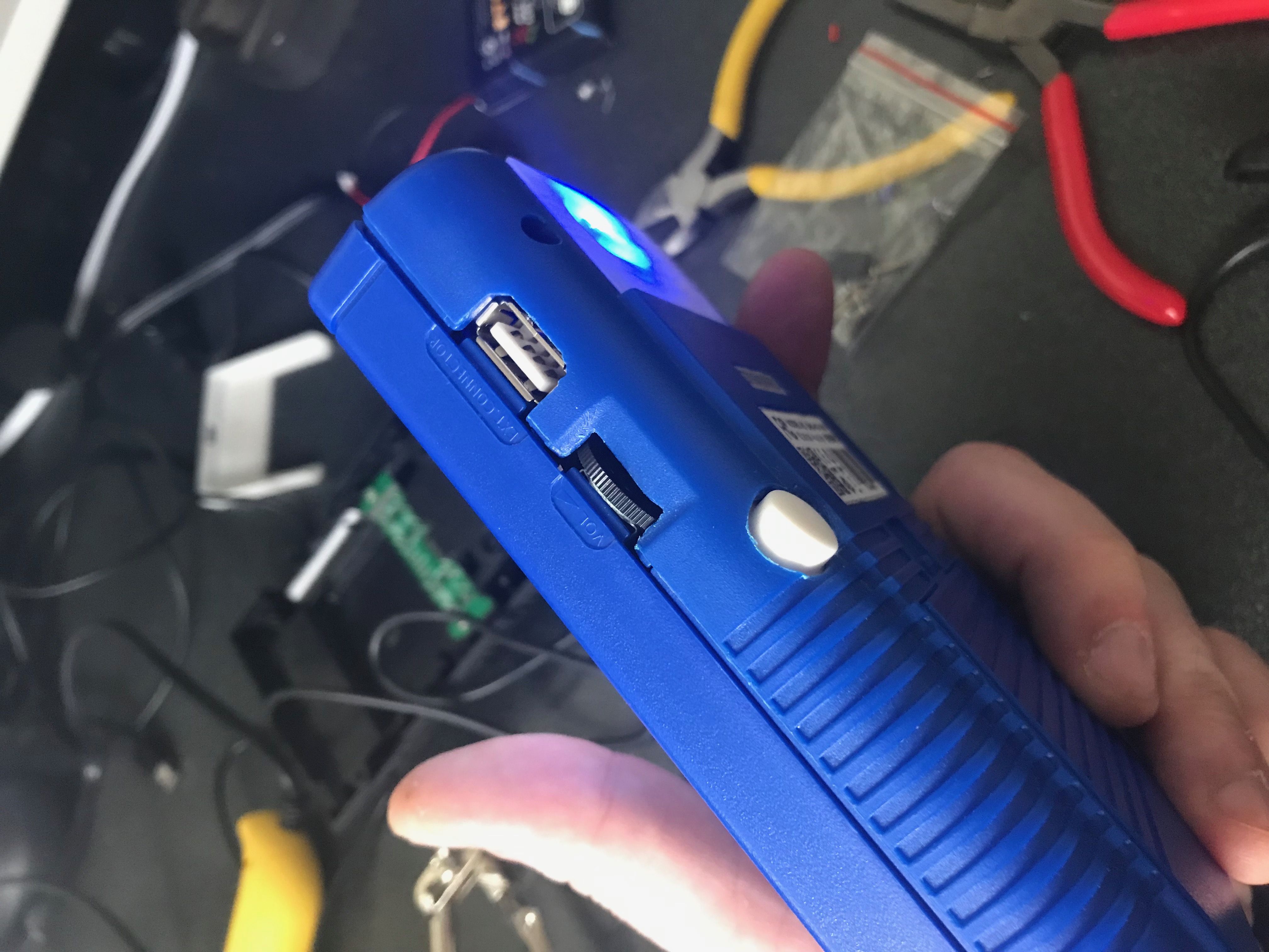

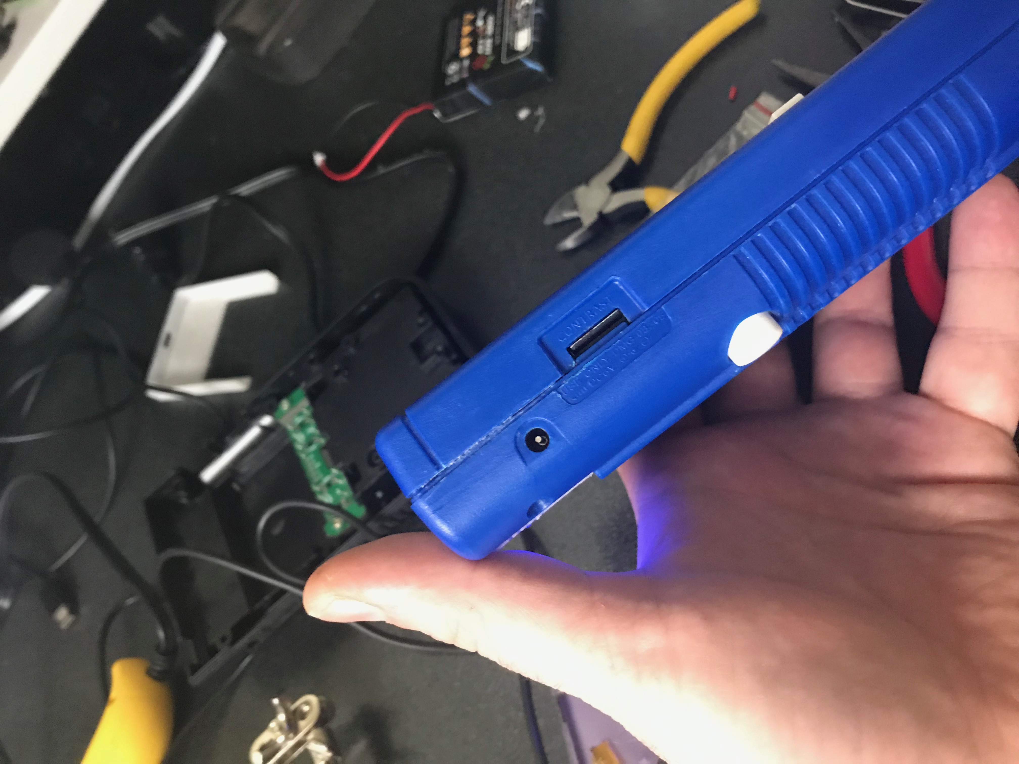

side - vol wheel and usbShow
side - barrel jack and sd cardShow

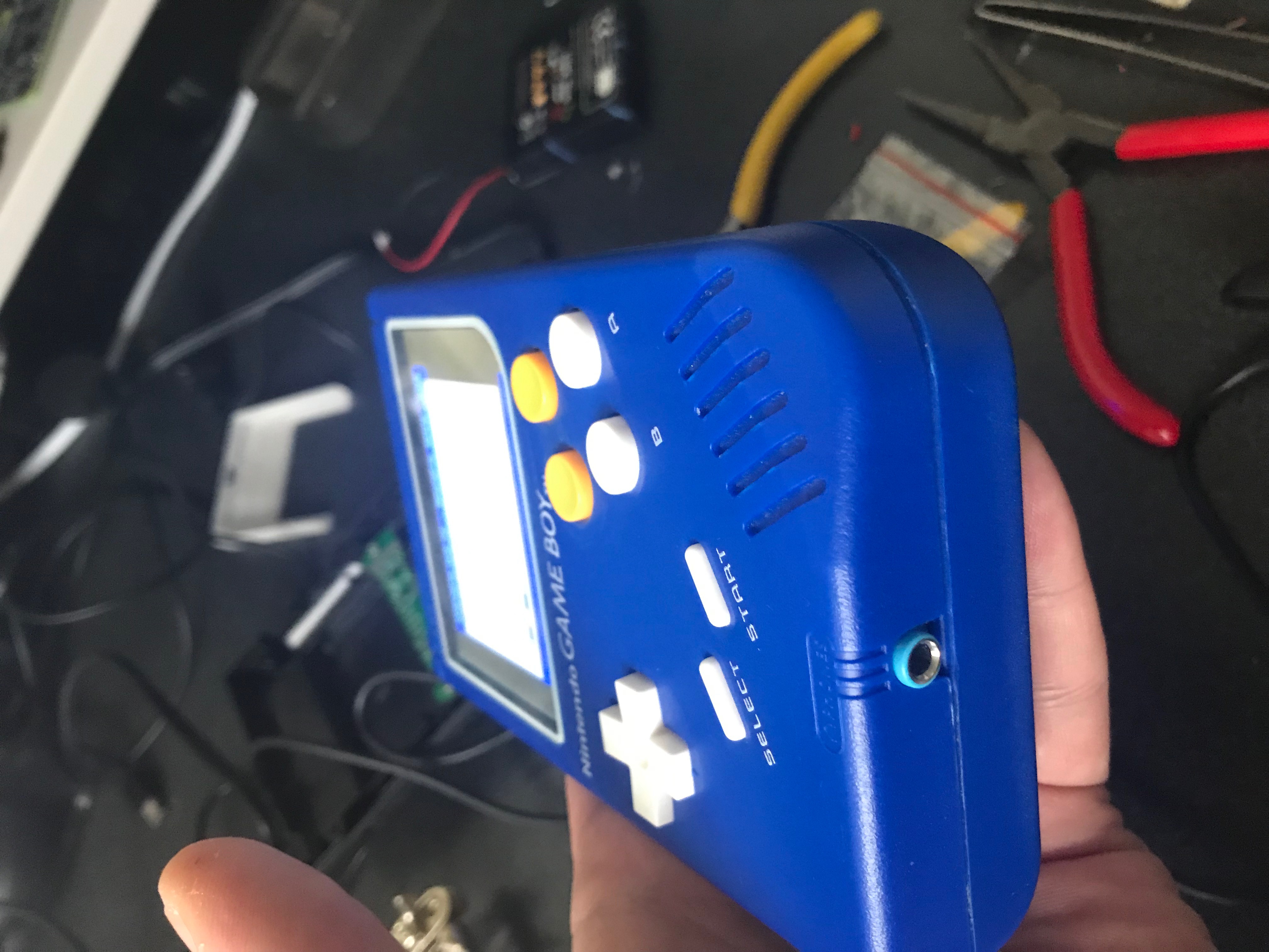

bottom - audio jackShow

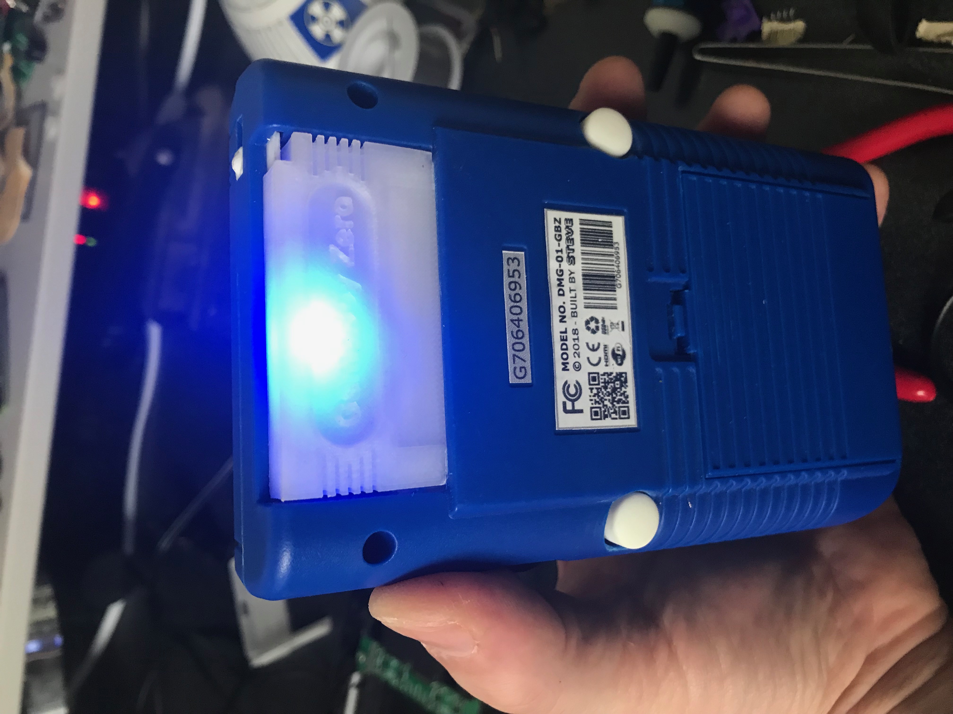

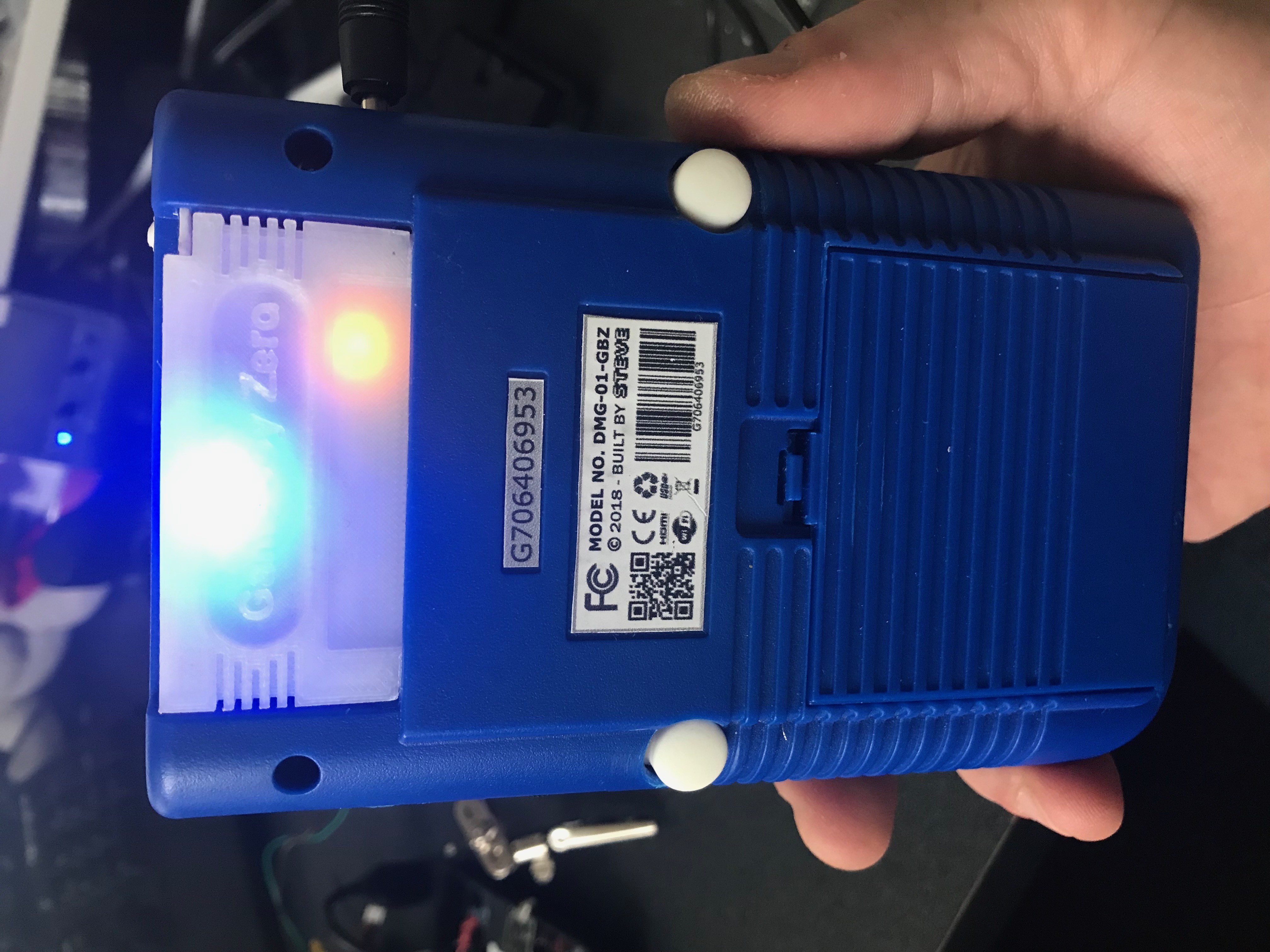

also - the other really neat thing on this one, which is hard to tell from the pictures - I printed the cartridge in semi-transparent plastic, and so when its on, the powerboost blue led basically causes the whole cart to glow blue. Charging/charged leds glow-through as well, nearer to the power jack.
rear - power onShow
rear - power on - chargingShow
